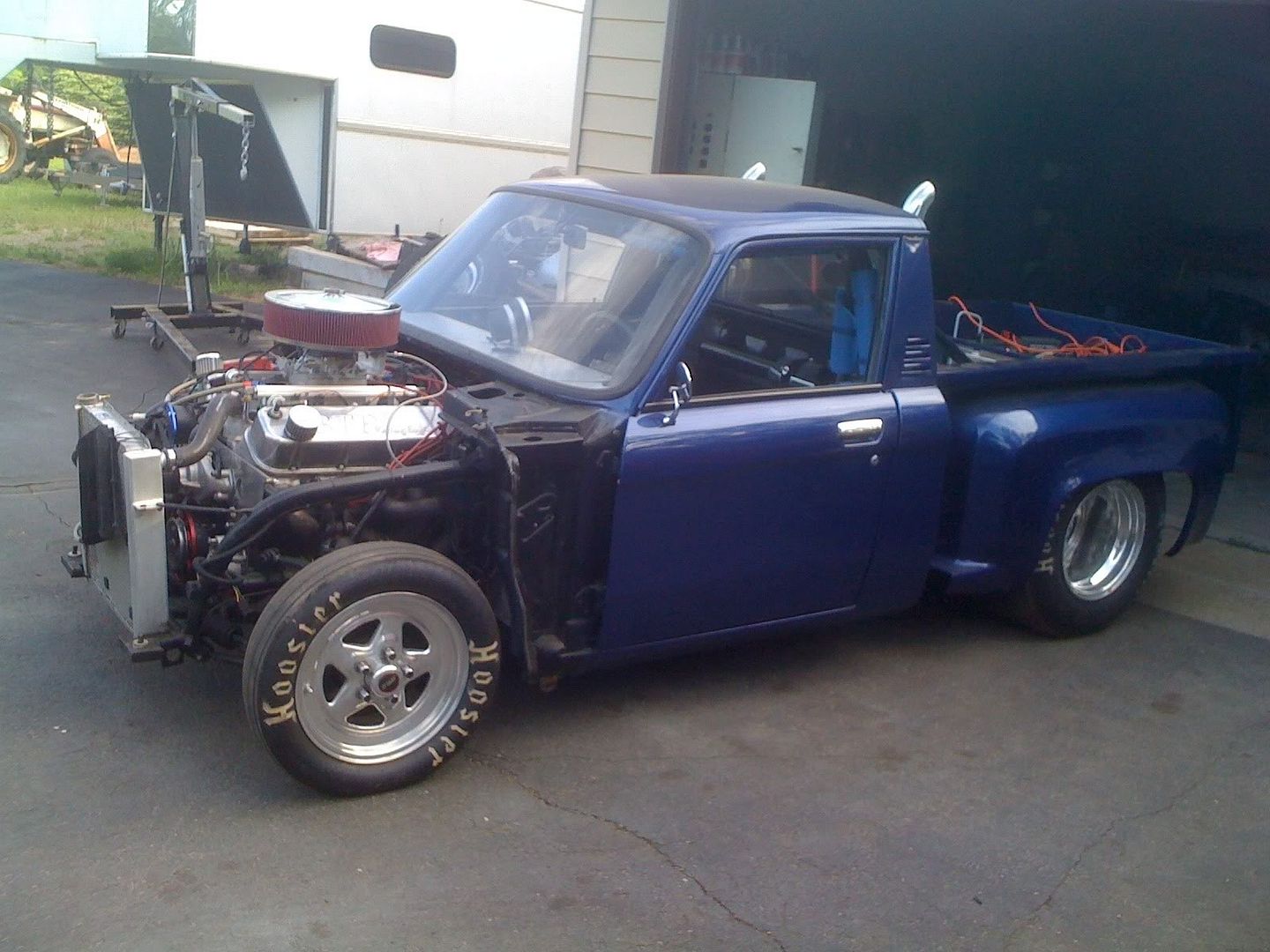

Well I've been busy over the winter and I'm in the final stages of fitting the new motor in the truck. Its a 9.3 liter (565 ci) BBC, 10:1, hydraulic roller, pump gas motor that dynoed in at 732 hp 719TQ at 6100rpm. It fits and looks the same as the old 461. It has less compression and cam than the old one, so it should be better for the street.
My MSD box crapped out on Monday just after I got it running, but before I got the seats back in it sooooooo instead of taking it for a spin I got about another week of down time waiting for warrenty work. :evil:

I was able to upload one with my phone.....I think
PostPosted: Wed May 26, 2010 8:02 pm
Wow...
PostPosted: Wed May 26, 2010 10:49 pm
Posts: 453
ugh ... holy shit? man thats awesome
PostPosted: Thu May 27, 2010 7:30 am
Posts: 634
Location: Northwest, 'MURICA!
I have 1 thing to say.....GOOD LORD!!!!!! where did you get a shoe horn that big?
zyanug
76 fleetside 350hp 1968 327cu
___/__l____
[_@l__l__@_]***
TILTED wrote:
Boobies!!!!! 8O
PostPosted: Thu May 27, 2010 4:02 pm
Joined: Wed Feb 13, 2008 10:59 am
Posts: 76
Location: Central MN
Its a tight fit no doubt. The headers are the real challange. 8 individual tube and you have to install them in a specfic sequence. When I went from stock heads to aftermarket heads (which raise the exaust port a 1/2 inch) I had to start all over and rebend them for a total of 4 hours of rework.

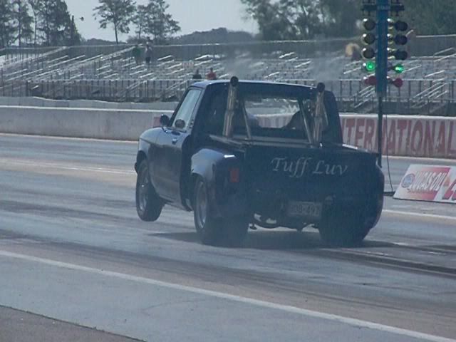

Dispite some torque converter issues, blown shock, and bad air the truck still made a few 9.96 1/4 mile passes at 131mph at BIR's show-n-go. I was hoping for a little more but still not too bad for a street legal pump gas truck. It got more it's fair share of attention.

60 ft is in the 1.40 range. I launch it at 4500 rpm and it ramps up to 6100 instantly. It bunny hops a little until I pull second (which doesn't take long with a TH350) The motor is driving through the converter as peak torque is at 4800 rpm and the converter stalls at 6100. I'll have to pull the converter and send it in to have it tightened up.
