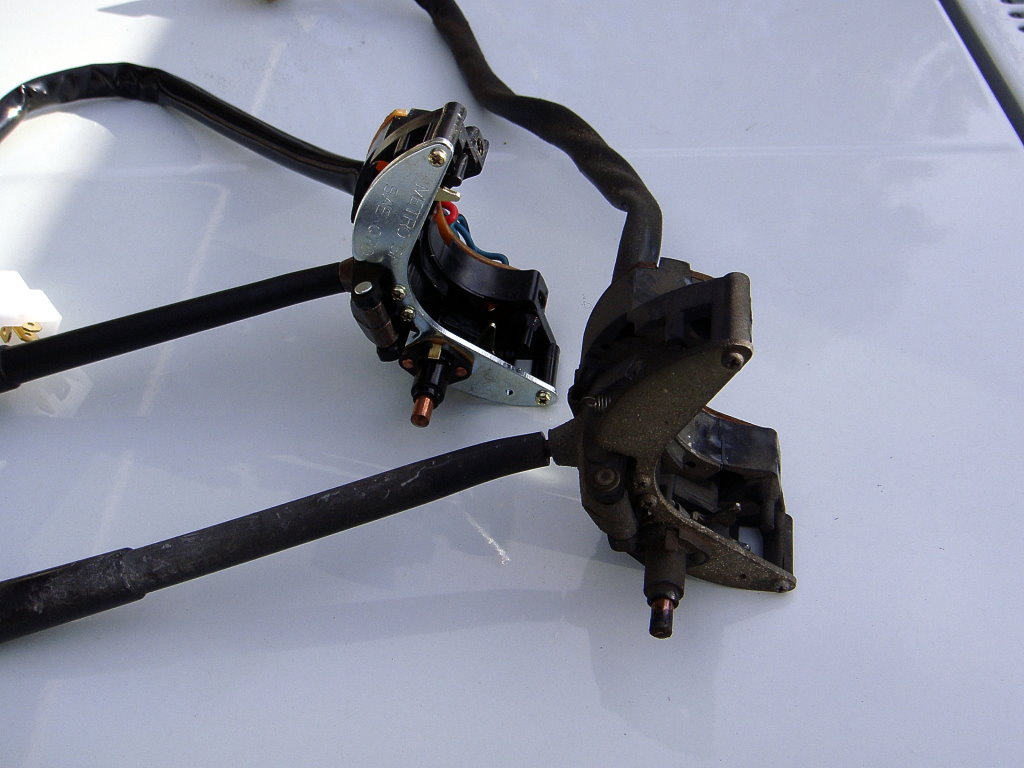

Let's start with the good.
I bought a turn signal switch because mine didn't work. The detent was gone and it would often go to "left turn" after a pot-hole.
The new unit is practically an exact replica of the original, and for me, works exactly like a new one.

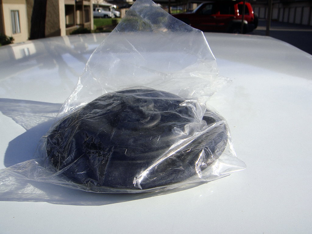

I also bought window seals and a shifter boot. Although I haven't tried to install them, they look good.

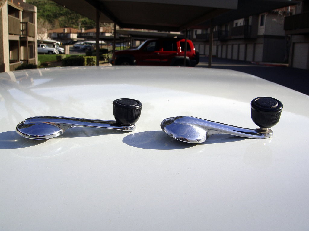

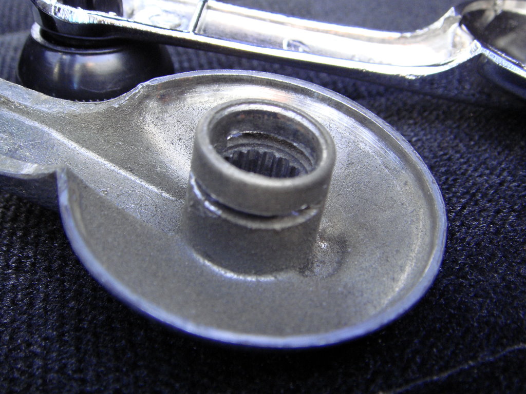

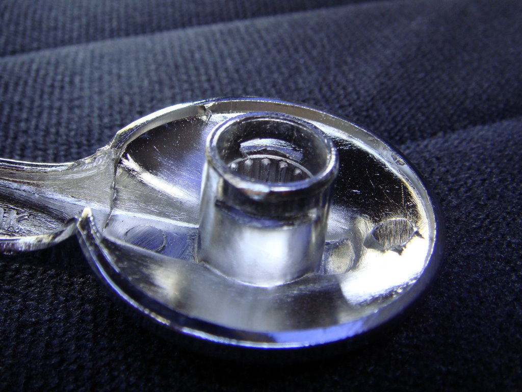

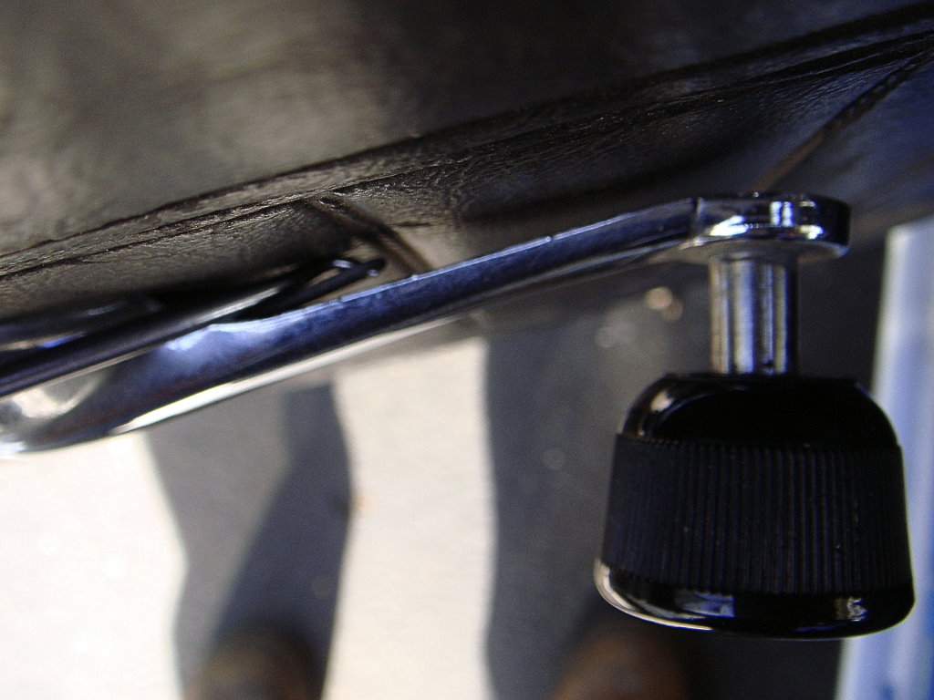

Window cranks:
When I saw the new ones in the package I was impressed.
I removed my handles using my handy hook and compared them for you guys.
I imagine most of yours are in similar condition to what mine are. New on left, old on right.
Unfortunately, when I installed the clips and tried to install the handle, it wouldn't stay on the shaft. I looked closer and noticed that the slots in the sleeve don't go deep enough to let the clip grab anything on the window crank shaft. Although this is an easy fix with a band saw or a cutoff wheel, it was a bit disappointing.
Old
New - Notice how shallow the slice is made compared to the original.
After I get a chance to fix these, I'll repost with the results.

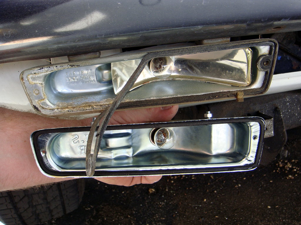

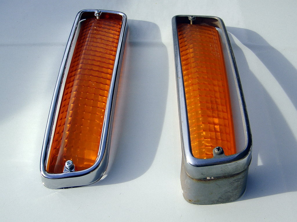

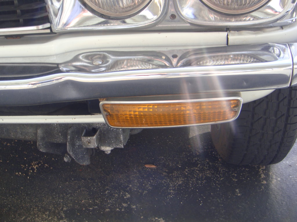

Front turn signals - pre 76
Admittedly, my existing lights were in pretty good shape.
However, these new units put mine to shame when placed side by side. (Notice the missing sheild on the chrome ring that seems to serve no purpose anyway)

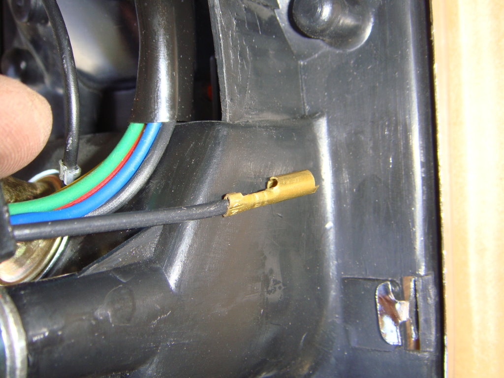

The first thing I noticed is that there are no plugs attached to the wires. This can be easily remedied with butt connectors or whatever your preffered splicing method is, but new plugs would have been nice. There is also no clip to hold the wires to the housing like on the originals. Not a big deal, but worth mentioning.
Since I was in a hurry, I decided to skip the rewiring for today and just swap the front lenses. Internally the new units are identical to the originals, except for the missing reflector behind the bulb (new bulbs are included by the way).
The good news is that the lenses are an exact match for the original. Some of you may opt for just the lense replacement like I did.
If someone installs the whole housing, please post about the bolt alignment.

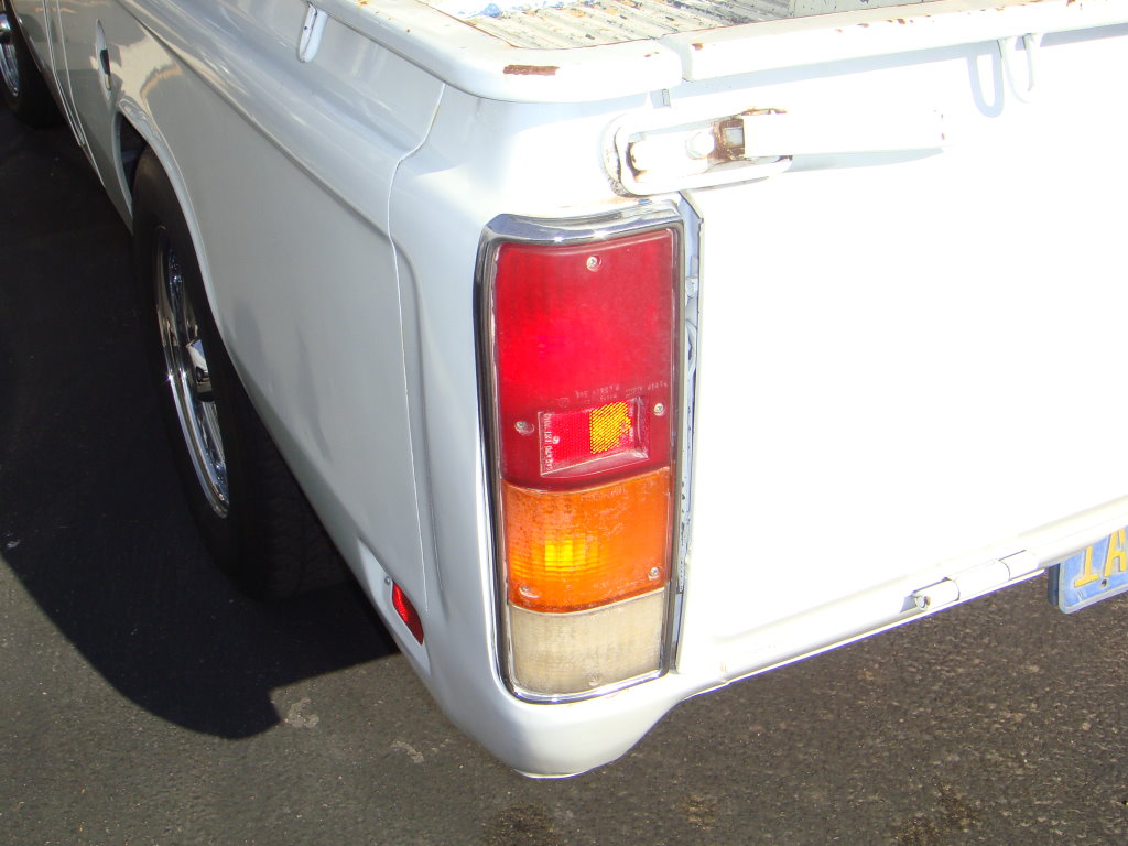

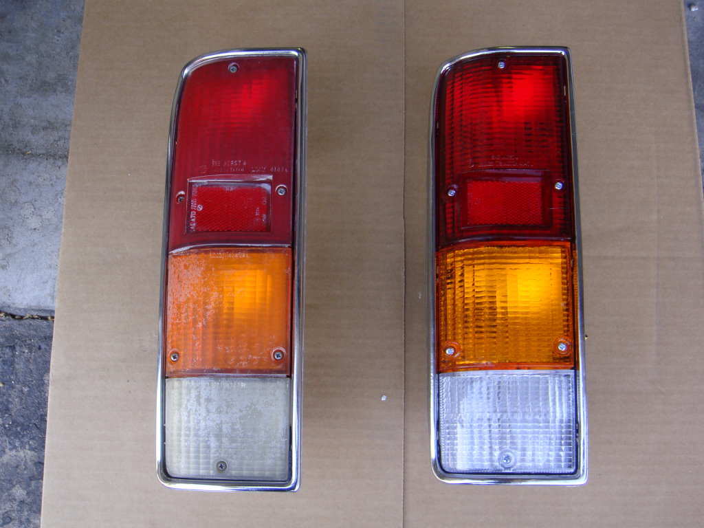

Finally, the tail lights.
Again, my existing lights were in better shape than most.
And again, side by side with the new units, my old ones start to look like do-do.

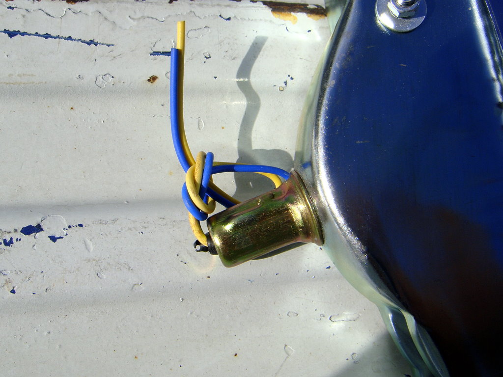

The first thing I noticed is how nice it was that a new plug was included, complete with a pig tail for the marker light in the bed. Unfortunately, the plastic cover on the pigtail is missing on the new units. I covered mine with electrical tape to prevent any shorts inside the tail light bucket.

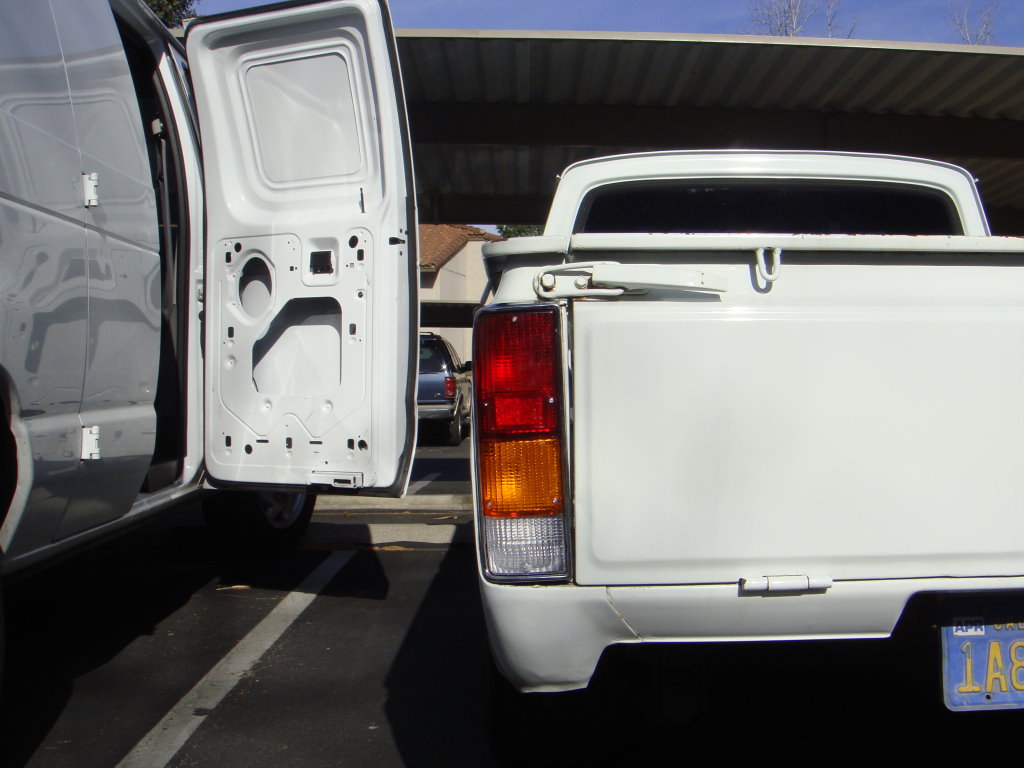

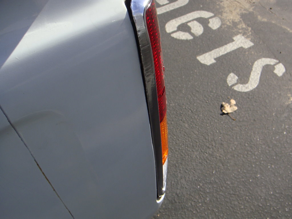

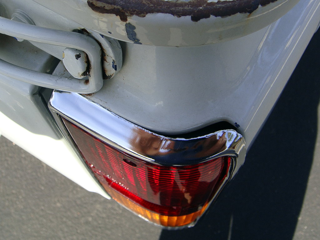

As I installed the light on the right side, I noticed some strange alignment issues with the bed. It isn't too bad, and I think I can live with it, but the original didn't have this problem and it seems like someone could have done better with some trial fitting on the prototypes.
The inside edge of the ring is touching the paint, but the outside edge has a huge gap. Just to double check, I refitted my original light and it fits fine.
After installing the left side, the problem becomes obvious. To me, this is almost unacceptable.
If your bed is in good shape, you might be able to compensate for this. If your bed has collision damage like mine does on the left side, you'll probably be unable to get the light to line up. Notice the left tilt of the light and the difference between the top and the bottom distance to the tailgate?

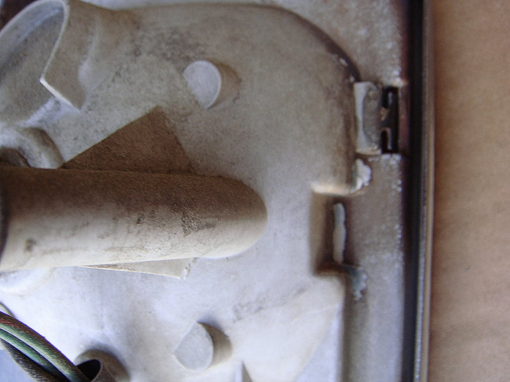

After further inspection, I noticed a difference in the location of the stand off on the new lights. Somehow the location got shifted a bit to the side on the top mount.
I could always elongate the mounting holes and use fender washers, but I don't think I should have to.

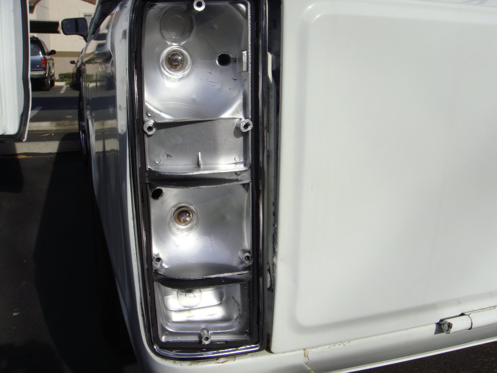

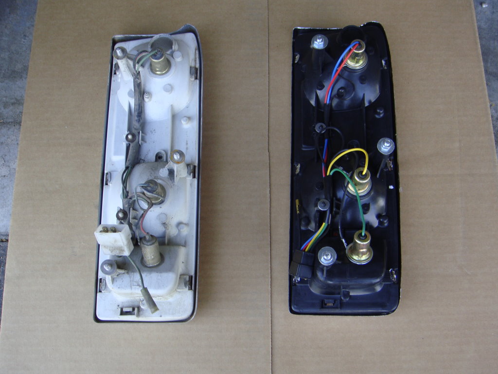

I also removed the lenses to have a look inside.
The good news is that the lenses will fit on the original housing if you would rather go that route.
The bad news is that behind the bulbs is simply painted silver on the new units, rather than providing an actual chrome reflector like the original. This DOES make a noticeable difference in the brightness of the lights. If you need to replace only one side for some reason, you may need to buy both sides to keep the brightness equal. New bulbs are also included.

Ben, are the mounting posts off as much as they look in this pic or is it just the angle, and are the chrome trims rings as wavy as they look in the 2nd pic??? Let me know, I am about ready to cancel my order for the taillights.
 Post subject: Re: ebay parts
PostPosted: Sun Feb 22, 2009 2:50 am
The posts are a bit off, which is why the tail light will not line up with the edge of the bed properly. However, I think the angle in the picture makes it look worse.
The chrome rings are wavy, like it looks.
Like I said, the quality is not what GM or Izusu sold. These parts seem about in the same category as the cheaper imported body parts you come across that look close but never seem to fit right. If you have a show truck, your probably not going to be able to take them out of the box and just bolt 'em on.
