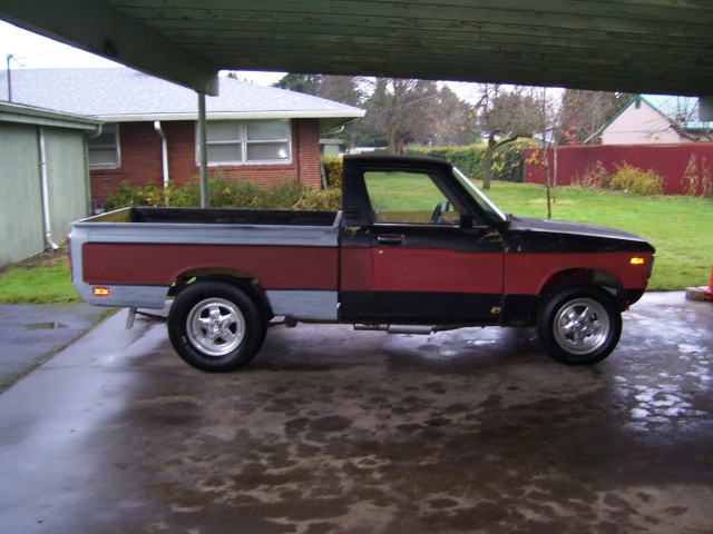

I WEIGHTED MINE YESTERDAY,IT IS 2540LBS. 1410LBS ON THE FRONT AND 1130LBS. ON THE REAR. IT HOOKS JUST FINE WITHOUT TRACTION BARS.
