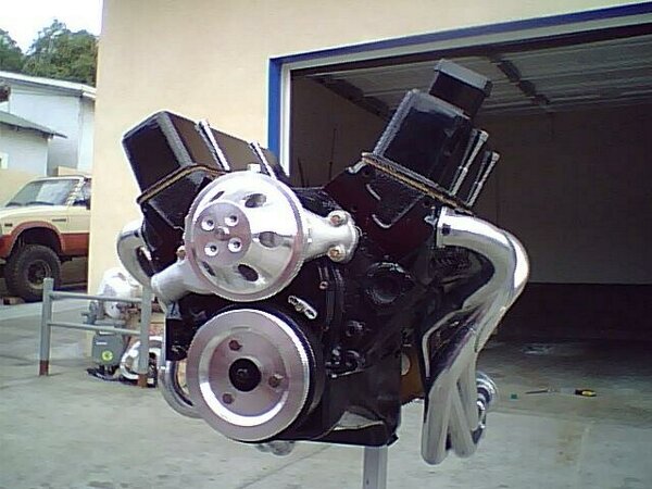

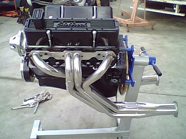

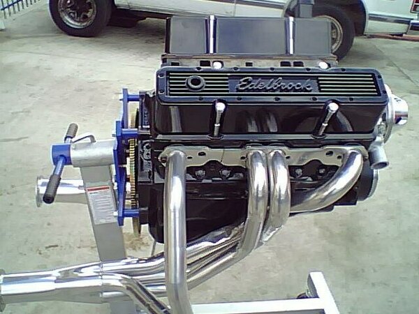

the luv open his Christmas gift early this year. here it is.

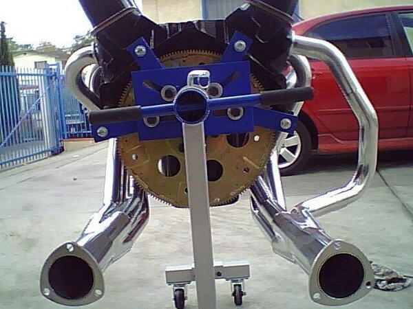

its 383 10.7:1 trw piston stock rod with arp bolts. 400 crank. world sportsmanII heads with some bowl work. isky nitrous cam if i remember right its .244/.254 @ 50 550/555 lift 282/306 adv. and @ 112lobe angle im going to be using victor jr intake with 750 speed demon carb and probably 200 shot. see what happens.
I just finish putting the motor and trans in. man those headers are no joke they are real tricky to get in. all the bolts are in but one of the bolts on the center tube on the driver side header i cant get in. so ill give it a try again tomorrow see if i can get in.
