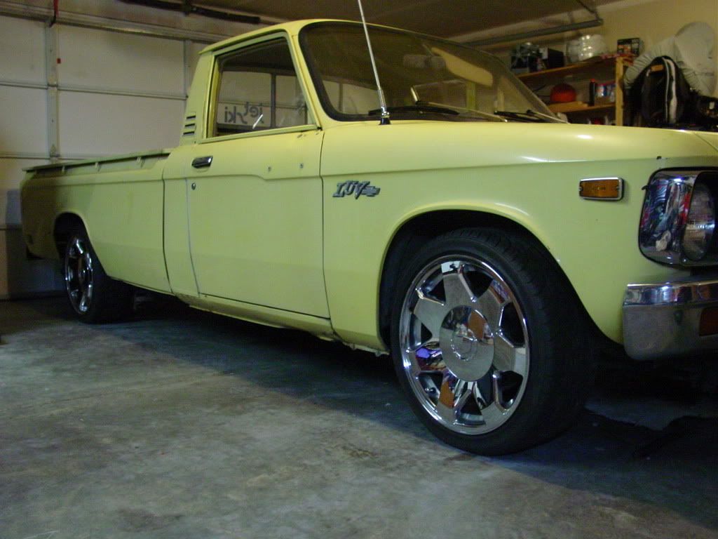

Hey guys - Test fitting these Escalade wheels and my spindle makes it a bear to get on the center caps. I've seen other guys run these, wondering how they are keeping the caps on....thanx guys.

yes they will work you need to get 1/4 inch wheel spacer and then make sure to get the right lug nuts they have to fit the wheel perfect i had put the GMC ones on my luv and i even had to cut the end of the spindle stud just a bit and the loose the dust cap or bang it in a bit ok i hope this helps

BTW, those wheels do look sweet, and I was thinking about how you got those on with the spindle, the dust caps have a lil room to be smushed in so you could get by with that, or dremeling just a bit of the plastic from the back of the cap w/o breaking through the metal overlay.

I etched out the front of the cap until you get to the aluminum, then cut off some of the spindle, haven't had no problems. Fit perfect, and tuck fine
