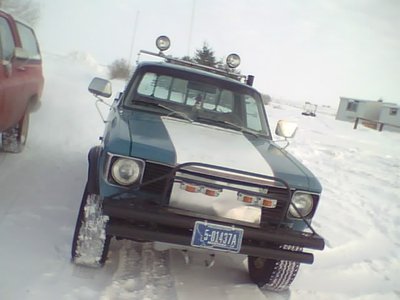

Ok my stock ignition has pooped out now ,no spark to plugs for some reason what is a good upgrade that i can go to without to much tech stuff ?The darn thing just wouldnt start after i drove it into my shop and shut it off and went to start it back up agian shortly after that.
