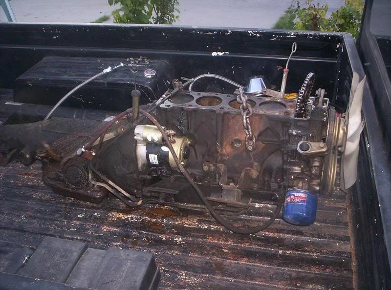

Swap Specialist Mod
Posts: 2831
the luv th200 have a case thats made for isuzu. there were no adapter plates to put them on the motors. they just simply bolted to the engine.
heres a pic of the th200 that came out of lees 80...
