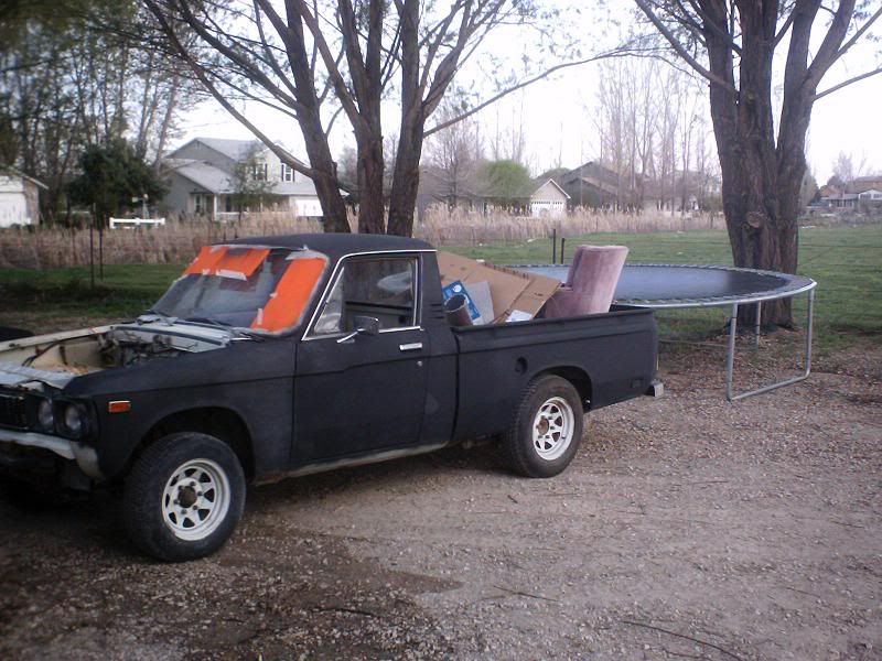

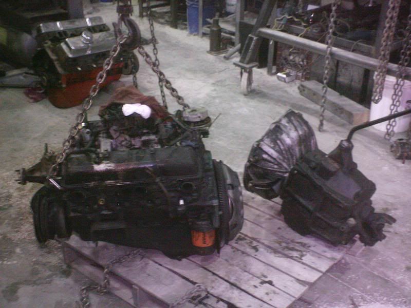

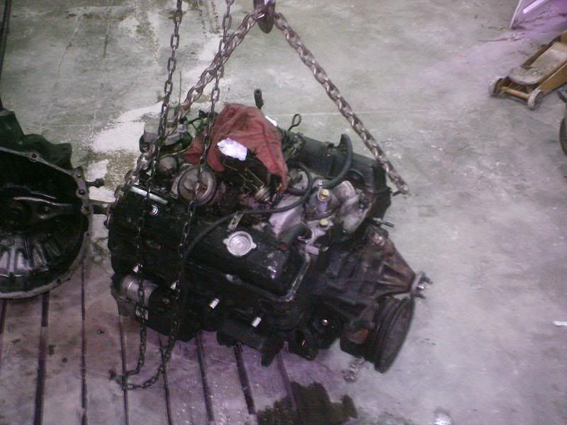

well i went over to ezekiels house today and we pulled the donor motor from his beater truck. its just a plain jane 350 that had a granny geared 4 speed on it. it was kinda goofy gettin it out, but we got it, and its sittin on a pallet now. i also took some pics of the luv itself.
so heres the pics.
the beater truck
the 350 and 4 speed

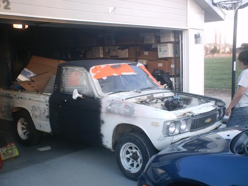

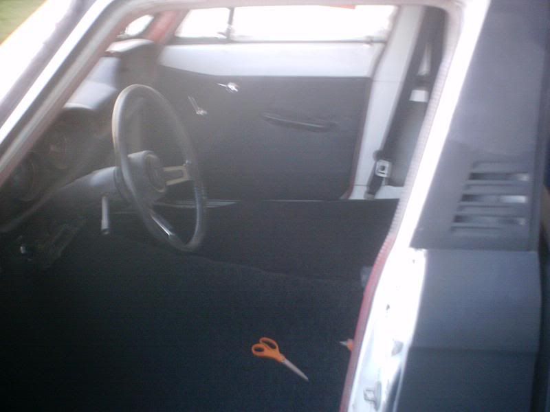

heres some shots of the luv
im prolly gonna be goin over there tommorow so that we can get the luv ready for the fab work.

Is that a new process box???? Its huge.
PostPosted: Thu Apr 20, 2006 3:51 pm
Swap Specialist Mod
Posts: 2831
i think its a SM 425. im not sure on that though. its for sale!!
PostPosted: Thu Apr 20, 2006 7:01 pm
It's either a NP420 or a NP465.

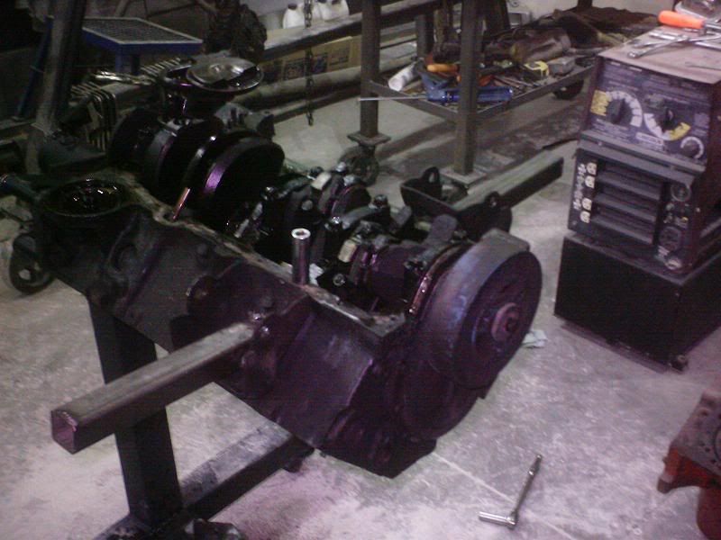

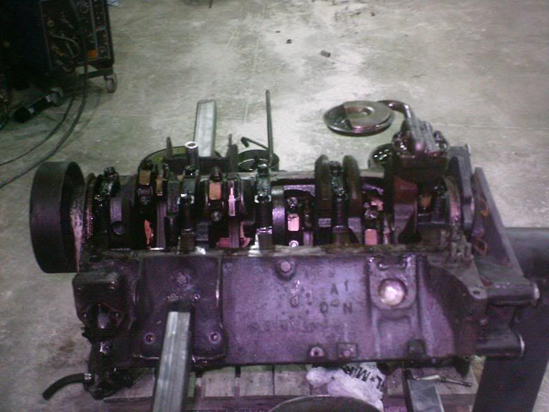

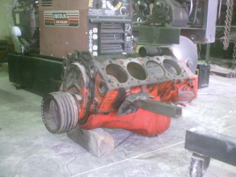

well we tore down the new motor at its a 3970010 block with 2 bolt mains. the cylinders look good. the was quite a bit of carbon in the cylinders though. the heads are 624s so were gonna look for some better ones that arent gonna crack. i think we have some othere heads scoped out for this motor.

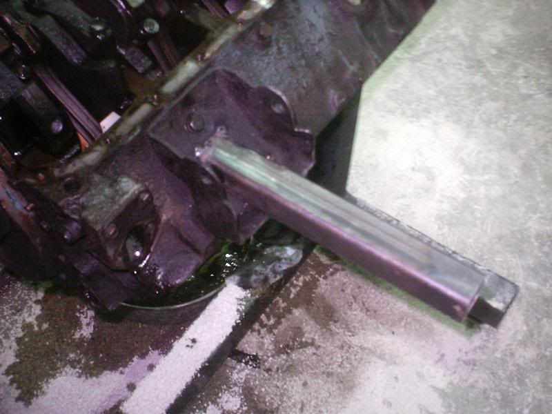

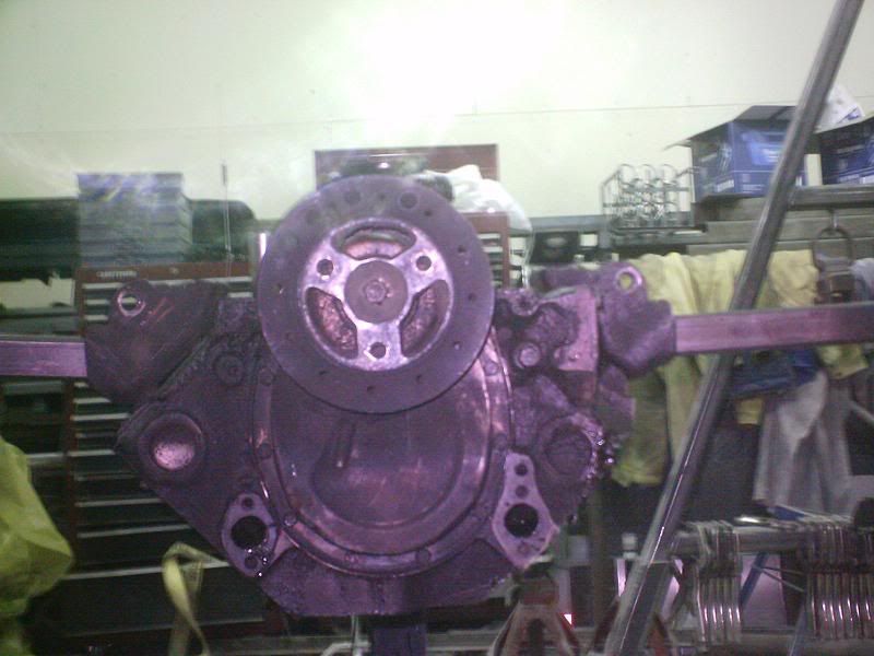

i started on the motor mounts tonite too. i got the main pieces cut and tached, but there still some minor tweakin to do to get em right.
heres some pics of the current work.
the bottom end

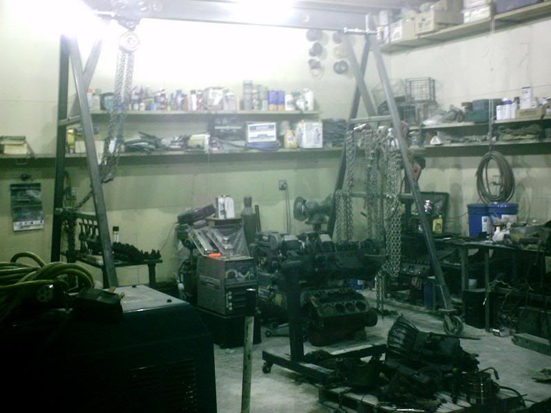

ezekiel's kick ass shop. (the pic only shows like a 1/4 of the whole thing 8O )
im gonna finish up the mounts tommorow, and if anthony is alright with it we'll test fit the motor in the truck.

What is the wall thickness of the sq. tube you are using? It looks like 02thin to me, I would want .120 or so. what are you planning on attatching the square tube to and are you planning on solid mounting or rubber?
PostPosted: Sat Apr 22, 2006 7:19 am
Swap Specialist Mod
Posts: 2831

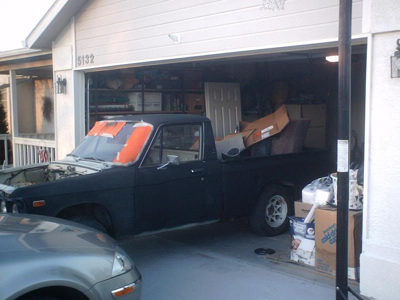

it 1/8in thick. its more than likely gonna be weld to the frame.
i did finish up the mounts yesterday though. wire wheeled em up all nice lookin too. heres a pic of them on the mock up motor.
that really all that got done yesterday other than some this and that stuff on the luv. i did get a decent shot of the little guy out inthe sun though.
im gonna be goin back over there today with lee, and anthonys got a lead on a ford 8' rearend, so were gonna look at that. were gonna try and get that stock motor mounts on the frame cut off too, along with the battery tray.
