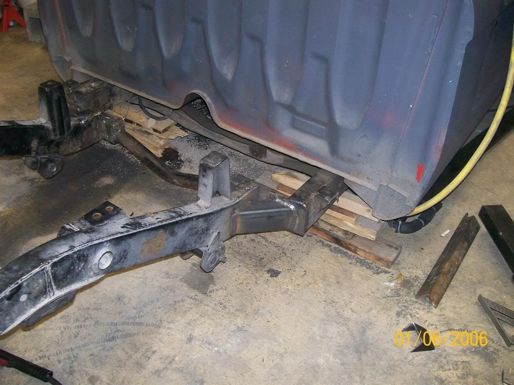

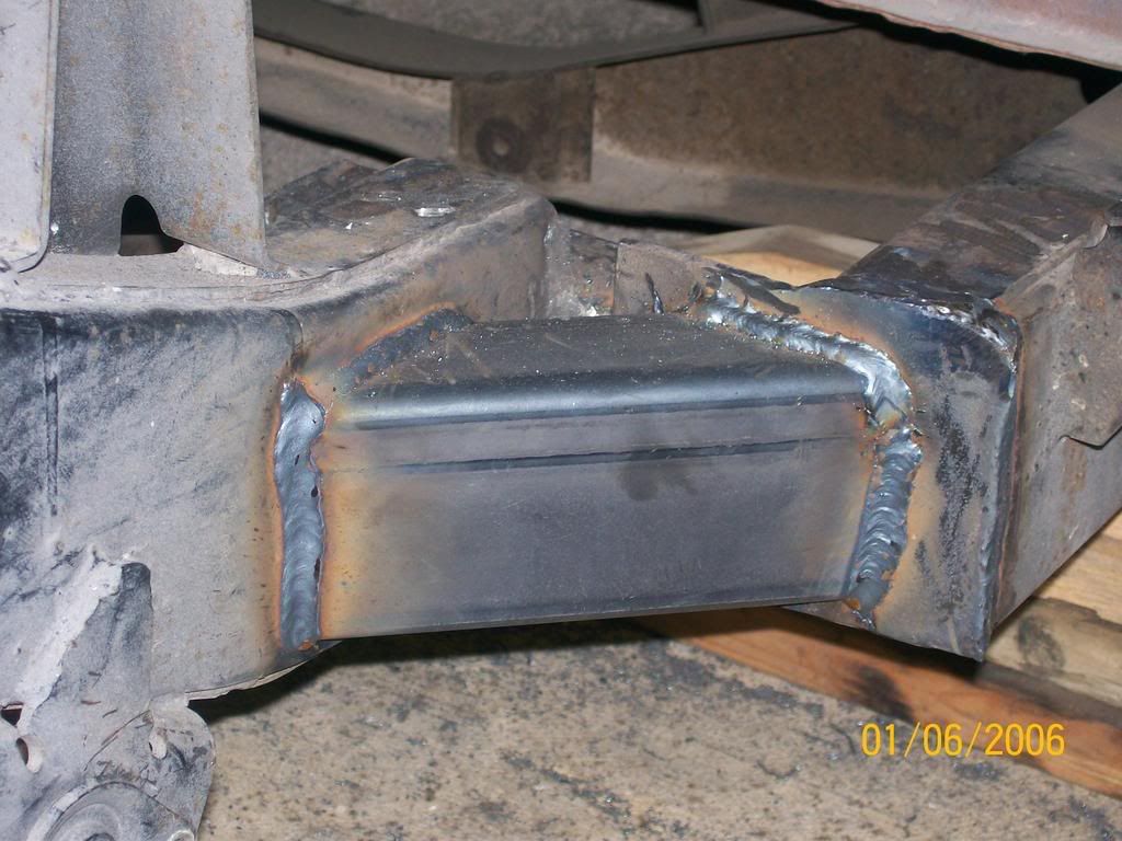

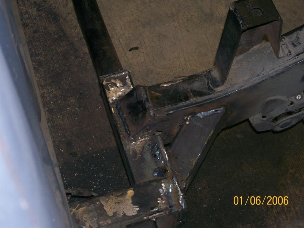

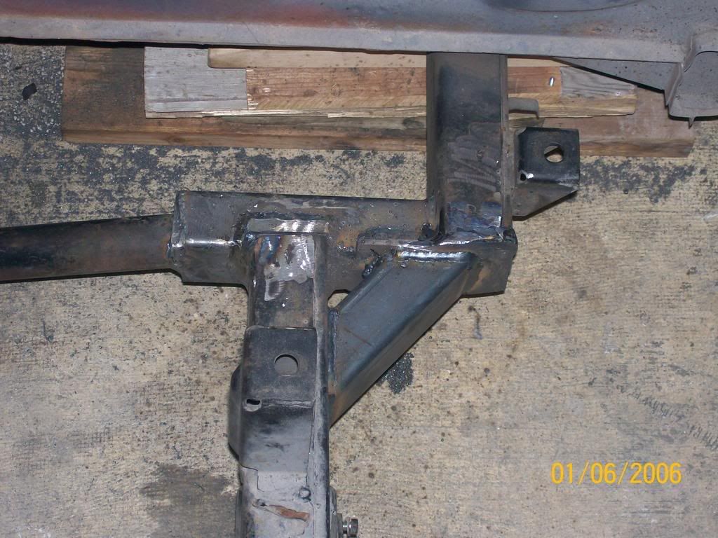

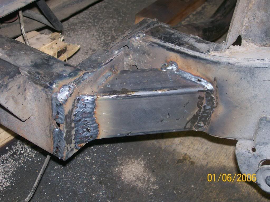

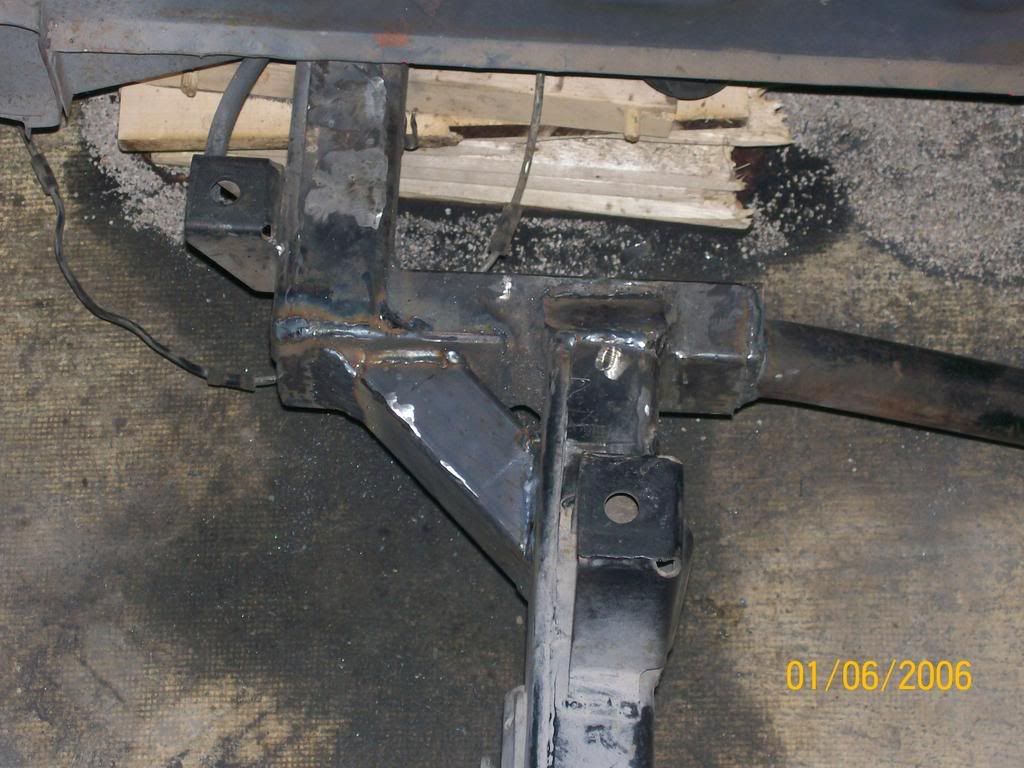

got some gussets done today.
remember my wrench turning exceeds my welding and cutting abilities by a long shot :lol:
forgot to mention batteries went out on camera and i didnt change the date when i put in new ones.
right hand side
left side
another shot at the x-member
AINT RIGHT MOTORSPORTS
PostPosted: Mon Feb 05, 2007 7:51 am
I see you are get it done,a word of advise though is put a gusset on the inside corner as it will help with twist and strengthen it allot more.
PostPosted: Mon Feb 05, 2007 10:15 am
Posts: 194
Location: SAN ANGELO TX
its gonna get a gusset eveywhere a gusset can go lol

well that turned out good awesome it makes me want to go do the work on my Jeep Frame.
About the gusseting issue well I am kind of wondering about totally gusseting the whole frame I would think you need a little bit of give in case you break some drivetrain????

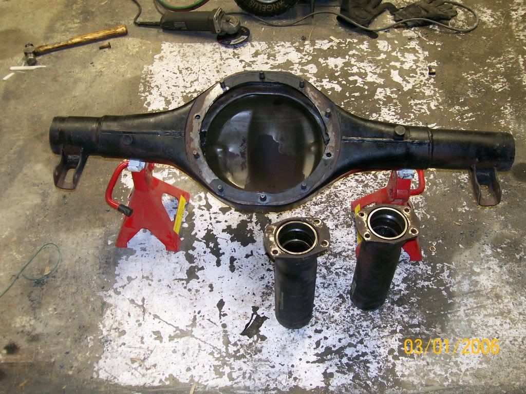

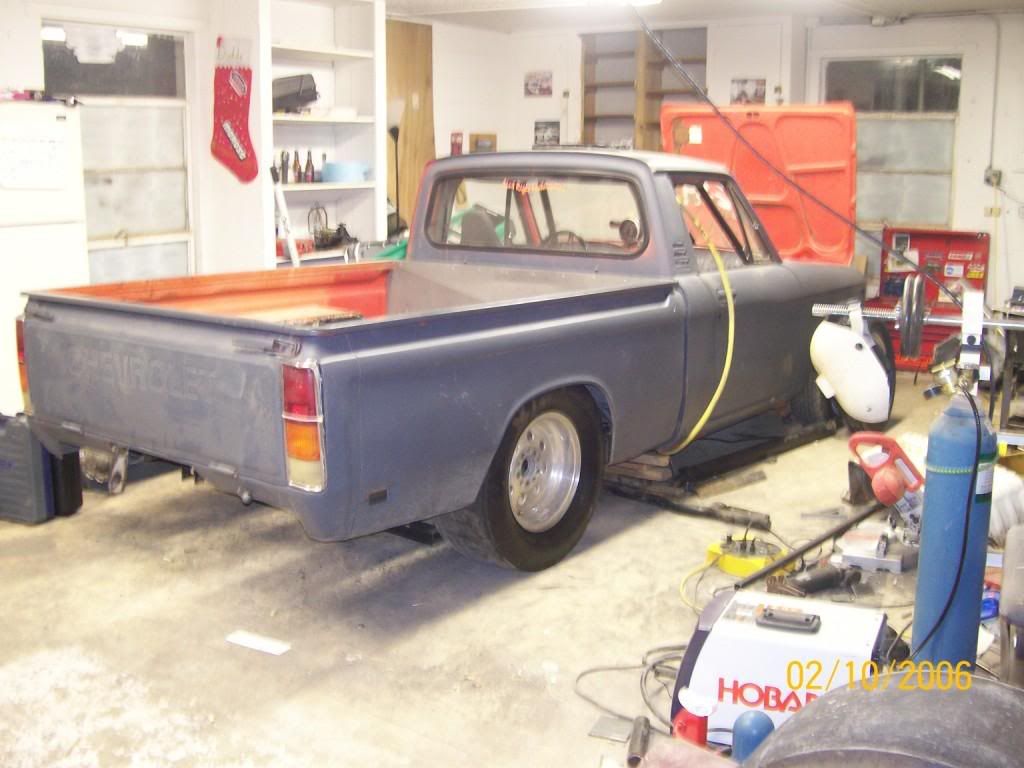

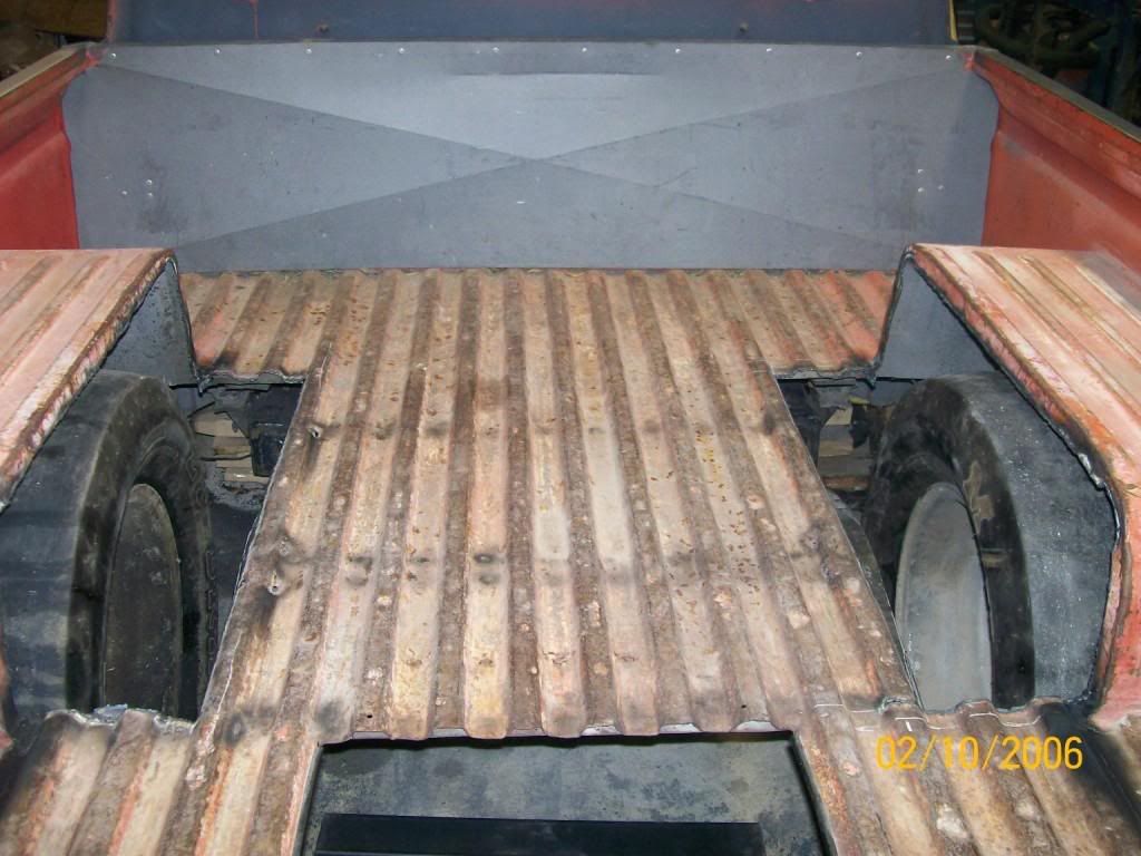

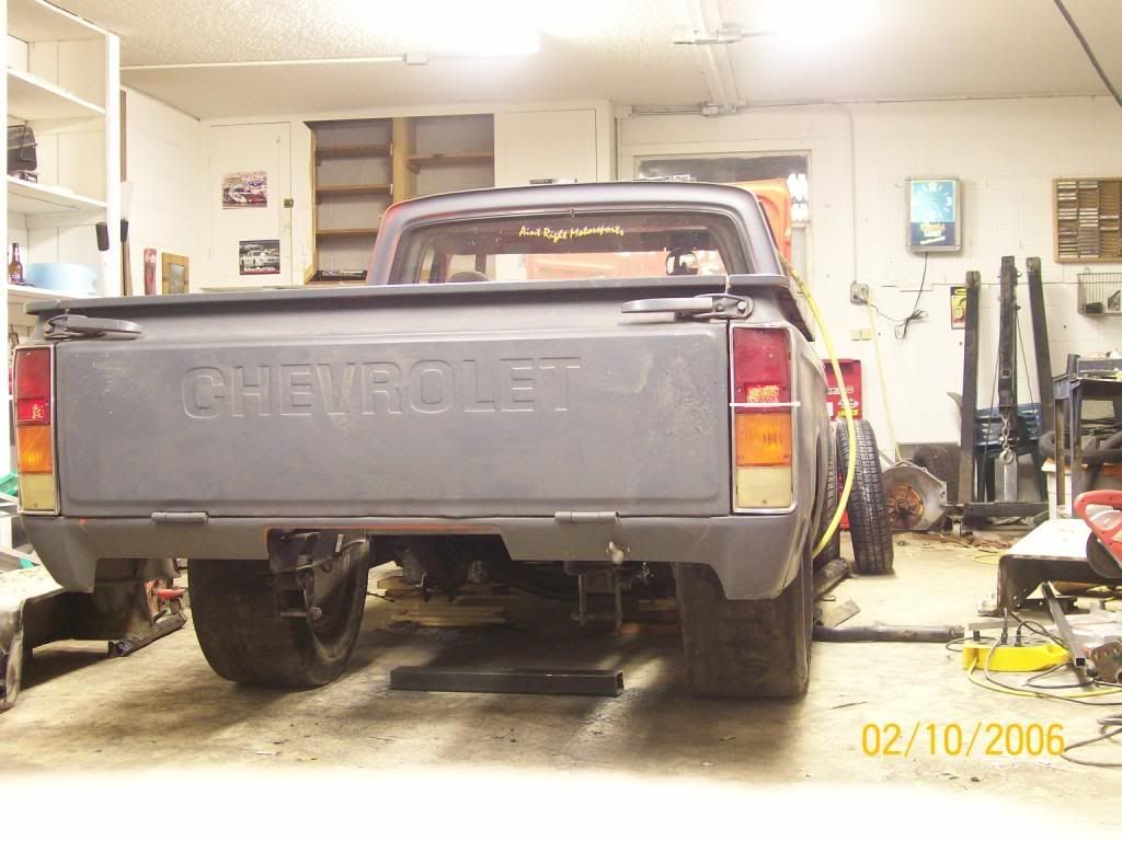

a few before pics for the hell of it.
now for some progress pics
still need to cut the 9 inch down to fit and order the axles. hoping to be back on the track by march.

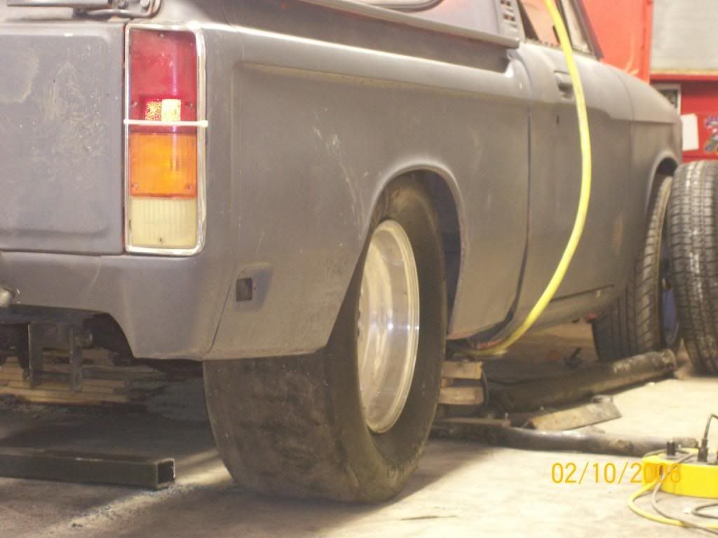

In your first pics what size tire was on it. They looked like they fir the wells like I want mine to. My 315's I bought I think are way too big to fit the stock wells.
PostPosted: Fri Mar 02, 2007 10:58 am
Posts: 194
same slicks that are goin back on it. 28x10.50x15

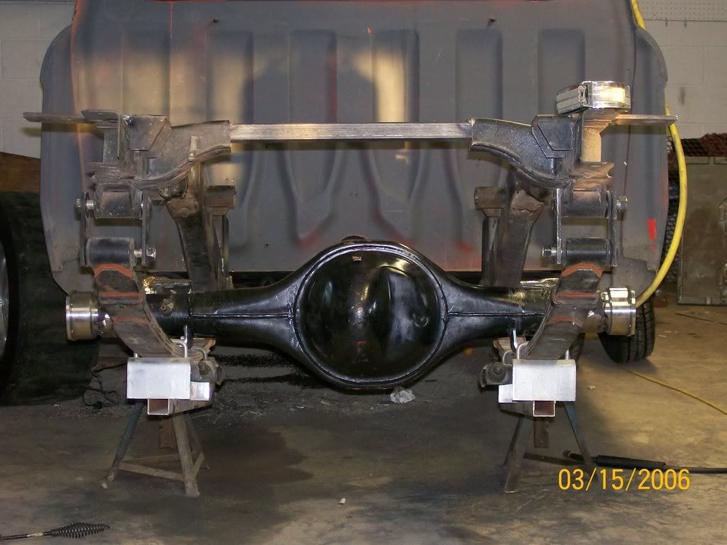

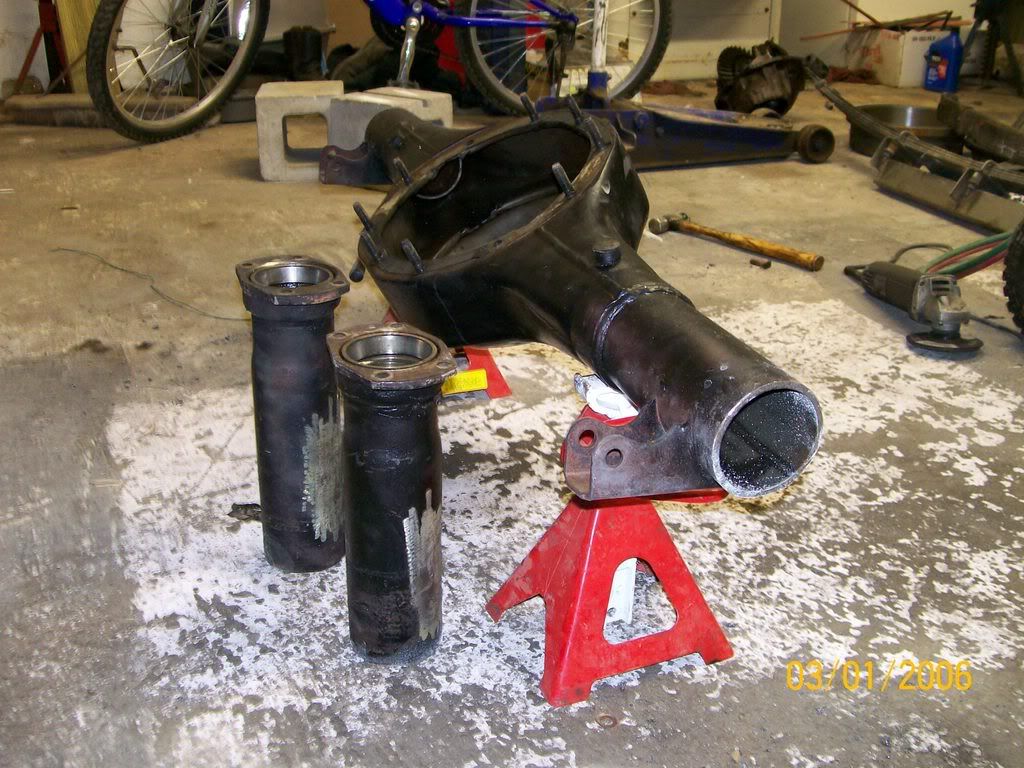

been a while so here is more stuff.
axles should be in next week.
gotta get the lowering blocks and u-bolts yet.

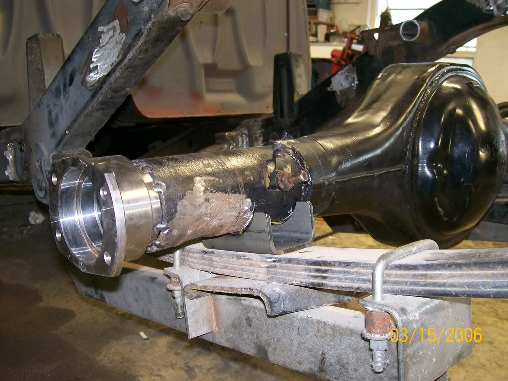

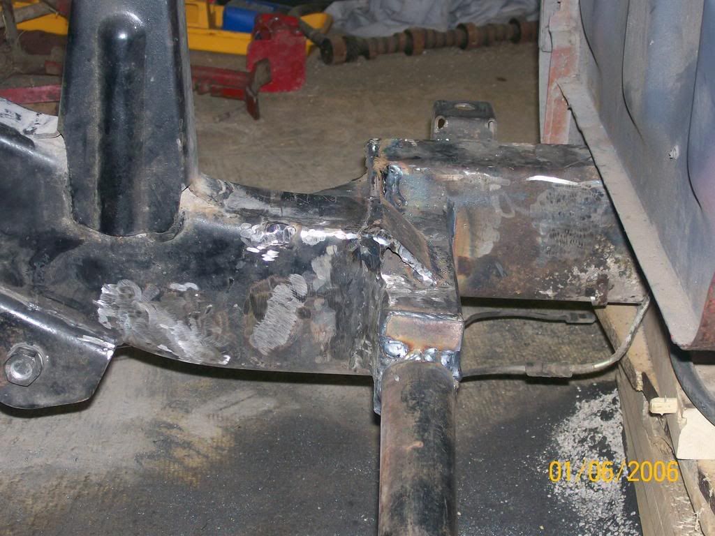

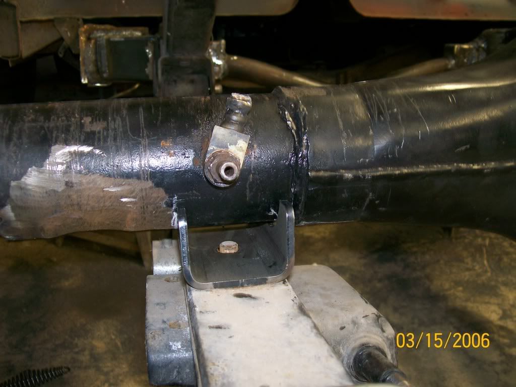

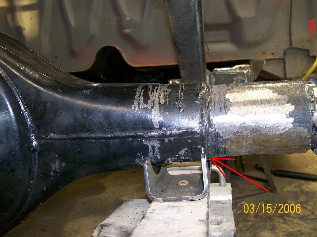

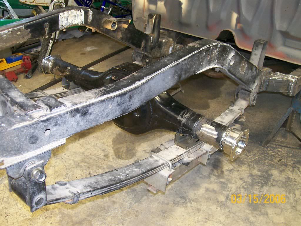

i wanna know what you guys think of this pic. the u-bolt is goin to be close to the weld here. im not sure what to do exactly yet.
im thinking it will be ok just get a bigger u-bolt and go with it.

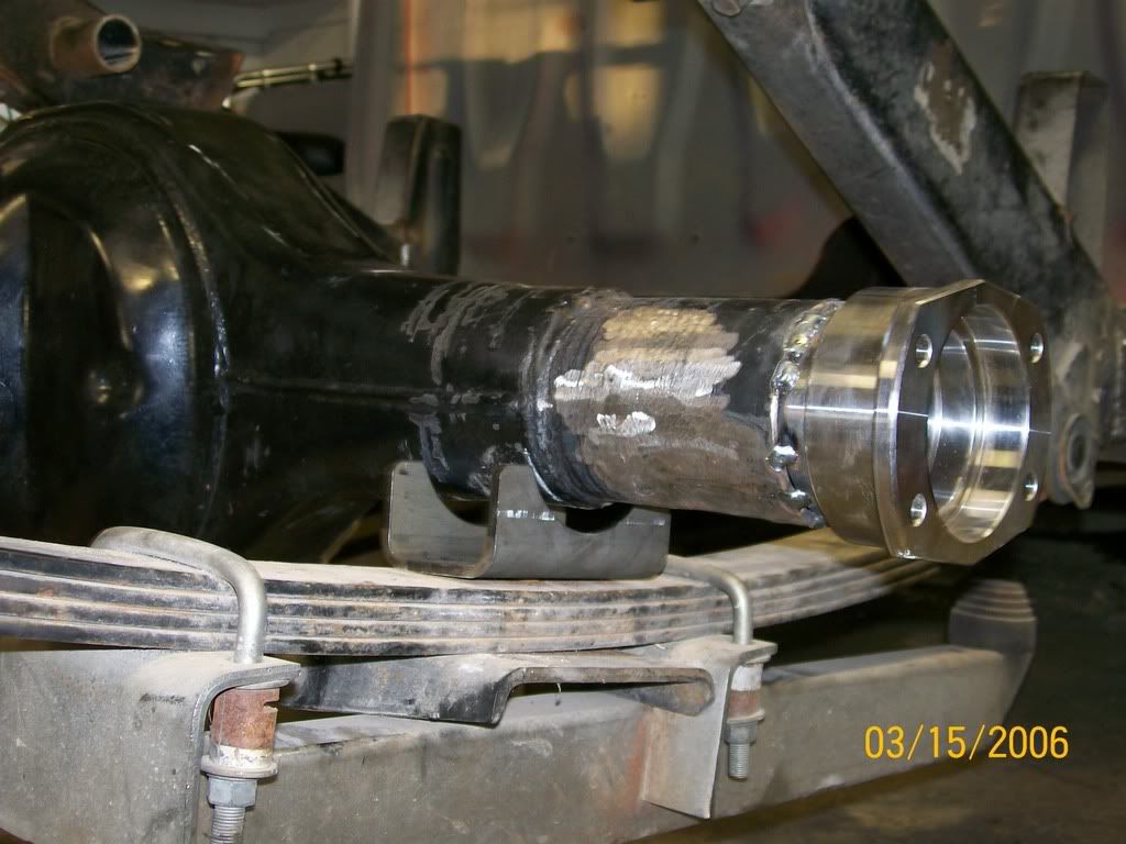

the right side is the same way.
i need to notch the leaf perches to fit better.
PostPosted: Thu Mar 15, 2007 7:09 pm
Posts: 194
im thinking i can build up the area where the arrow is with weld and grind it down smooth so the u-bolt has a better place to grip. lot more work but thats how it goes lol.
but im not sure if that would be as good as some sort of sleeve welded around it either.
no matter what that is where the rear is setting on the leafs fo rsure. i cant move that.

forgot to add measurements
frame rails inside are 24 1/4
housing end to end is 42 1/4
that should put me at 47 1/4 axle to axle which is 1 inch shorter than i figured, but isnt a problem.
