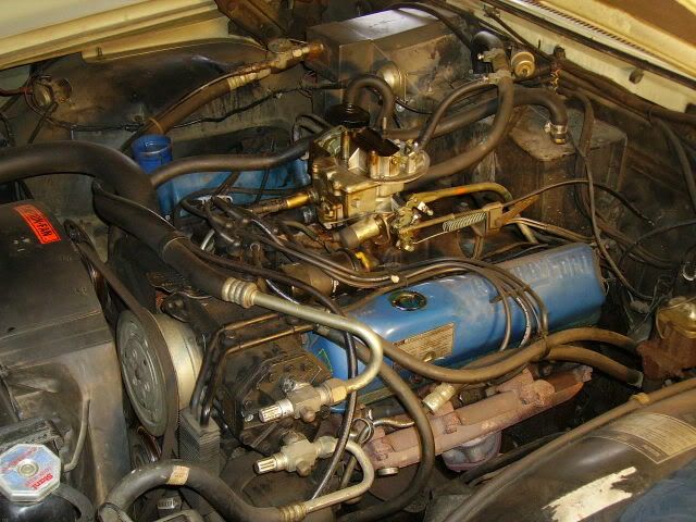

I just looked up the HP and TRQ ratings for the motor, HP-265, but the FT/LB-is 390, wow, i'm gonna have fun for a while! I might just end up keeping this car, and when taxes come back and I save up a bit i'll buy another "economical" car, no beeters though, unless I find a TD PUP..... mwahhahahha

thats a perty sweet deal man. And 390 Fords are good engines too, lots of power and lots of potential for even more power...

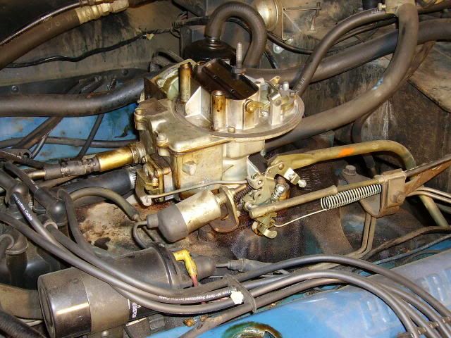

Well, picked it up today, it needed a new power valve, accel pump, and cleaned out the carb thoroghly, got it put on and it cranked right up, but idled pretty high, so we messed around and the choke isn't working correctly on it, some nylon peice connected to a rod is busted on the choke... so I'll be looking into that. Found out the vac. advance diaphram is bad so we got a new one, along with oil & filter, some trans fluid, and odds n' ends. So tommorow i'm putting new plugs in it and I might just go ahead and put the spark advance in it as well. I love this car.

Yes the 390 will pass every thing but a GAS pump just like todays 454
great for the GAS company

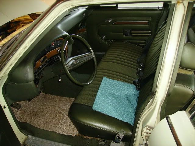

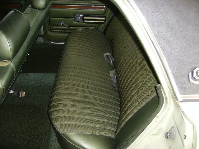

And the seats are "springy" too!

That is a clean old car!!! Just hope you never have to remove the distributer. On the 390, they are known for getting seized in there and sometimes have to come out in pieces.

Before I put the vac. advance in, my dad warned me about lossing the c-clip that holds the little arm onto the points thing inside, he said if it when down in the dist. we'd have to pull it out, if we tried to pull it out, the geared rod that drives the oil pump has to be taken out, if it falls off the dist. then we have to drop the oil pan.......... so I made sure to use a magnet when I removed the clip, a little $1 investment in a telescopic mag. at harbor frieght made the difference in a $20+ mistake.....
BTW, had to put a new fan clutch on, and I bought a holley 2bbl from a guy w/ a 67 galaxie 500, I went to the guys place, picked it up for $50, but when I drove off (by this time he was way on down the road) I realized... the manifold the carb was on was from a 302.... different jets, so i'll see about getting the right ones and putting the holley on, the web says it gets it 40hp just with that. It'll have dual exhaust on it too somtime next month.... BWAHAHAHa
