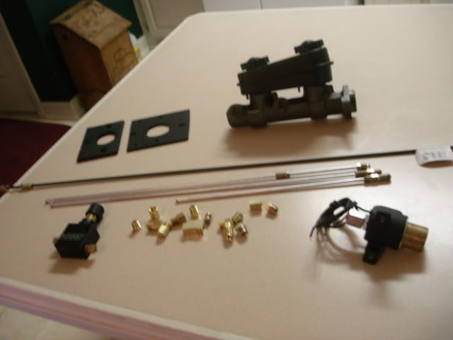

Ok, my truck has never had really good brakes. It has the factory discs on front converted to 5 lug and the factory Lincoln Versailles discs on the 9 inch. The brakes had the factory proportioning valve still plumbed and a Ford (of unknown lineage) master cylinder. It stopped OK, but not what I would call a real world setup. I generally operate on the 'If it ain't broke, don't fix it' theory. The last trip out the master cylinder died. So now I can upgrade. I got a Chrysler master cylinder from Napa, (this is the same as the one that Strange and Willwood sell). I also got a line loc and an adjustable proportioning valve. I also ordered a line an fitting kit. The plan is to do away with the factory valve also. This should give me a pretty good upgrade over what I had. I made a plate for each side of the firewall, the sheet metal is pretty thin in that area. The one for the front side isn't strictly necesssary from a strength standpoint, but it worked out that I wouldn't have to shorten the rod for the pedal if I used this thickness, plus I can access the rear cap of the master better...
 Post subject: Re: truck pic's
PostPosted: Mon Sep 15, 2008 7:10 pm
Well, the install was pretty straightforward. Unfortunately, no one around here carries the Sae to metric adapter fittings. I got a local hydraulic supply house to order me some. They will hopefully be in at the end of the week, just in time for me to be back at work. The plates came in handy. In order to get the correct predal ratio for this set up, I needed to move the master cylinder up from stock. It turns out the holes to mount the master are the same distance apart as the top set that held the brake booster on when it was still stock. All I had to do was cut out a little sheet metal in the center for clearance for the center of the master, and it was good to go. The plates were long enough to cover the existing hole. All in all, this is about a 4 on the skill level scale of 1 to 10. Braking should be MUCH improved, and the new stuff totaled weighs less than half that of the old cast iron master.

Can you list the parts used for the brake change? Including the fittng sizes? I am looking to do that brake master cylider swap in about 2 weeks and I am going to use the brake booster from the same truck as the master cylinder
PostPosted: Tue Sep 16, 2008 3:52 pm
OK, The master is from Napa. The part number is 39476, cost was $38.00 plus change, no core for a NEW United one. The fitting size on the master on both ports is 3/8-24 inverted flare. The stock LUv lines are 10mmx1.0. I didn't run a booster, not sure if the one I listed used one. The adapter fitting is part # BQ-50. This is a Brake Quip part number. My local Parker hydraulic hose dealer is the suplier. Cost is $6.81 each. I got the line lock and the proportioning valve from Jeg's. I also got a fitting assortment, but ended up not using enough of it to justify the cost. I used a short piece of premade brakeline from the master to the proportion valve, it was 3/8-24 inverted flare on one end and 1/8 npt on the other, the proportioning valve is 1/8 npt on each end. Hardpiped 1/8 npt to 1/8 npt to the line lock. Out of the line lock with another premade brakeline to a tee that came with the assortment kit. 2 adapters (the tee was a 3 way 3/8-24 inverted flare) then to the 2 front brake lines after removing them from the favtory valve. This is for the front brake set up. Yes the proportioning valve is on the front. Willwood and strange both recommend this, as you will be stopping with the big back tires and not so much the skinny front ones, in a drag racing application. Street rides are usually the other way around. The back line is removed from the factory valve and the adapter fitting is used to hook it to the other brake port. Bleed everything and enjoy...

No problem, hope it helps. You can flare your own lines and avoid the adpaters, but I don't have any fittings on hand. THe 3 I need were almost $8.00 and I would have to buy the flaring tool. It would have cost more, So I am doing the adapter route...
