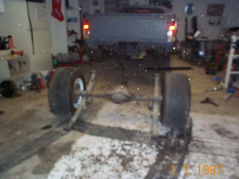

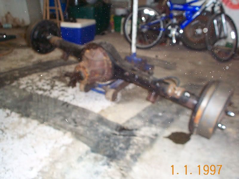

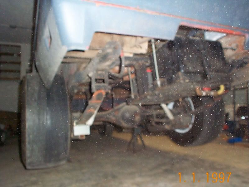

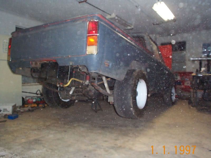

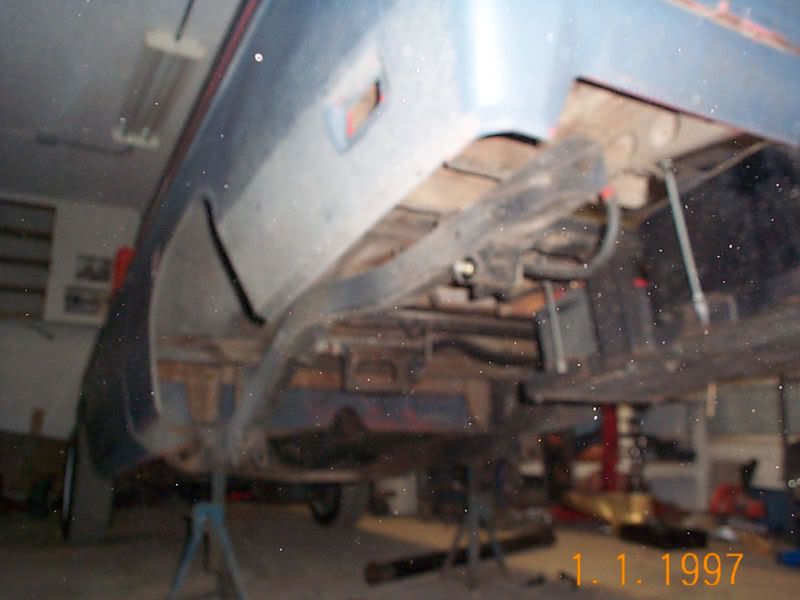

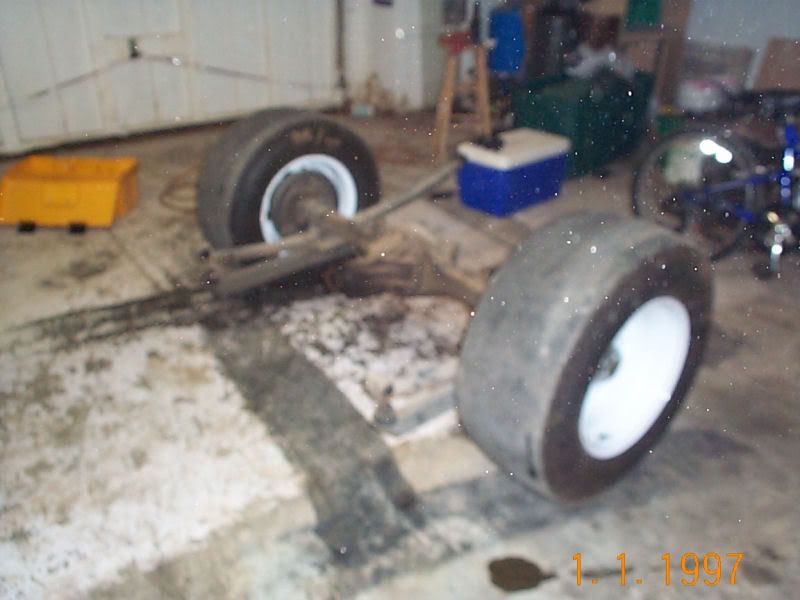

ok i guess this will be the first installment of my documented 9 inch swap. if it gets boring just let me know, i can take it lol.
this will be my first 9 inch ever owned, and my first shot at narrowing the frame rails and the housing. i do mechanic for a living and love doing fabrication on just about anything. and i got a cople buddies here that have done this a time or two that are gonna help me out.
right now im 35 1/2 inches inside frame rail to frame rail. so far the plan is to squeeze them together 10 inches. cut most of the bed floor out and cover the top. leave a hinged area at the back for access to batt and fuel cell. like i said, thats the PLAN right now. lmao that could all change in a day or two!!!
and remember my camera was dropped about 4 yrs ago so some pics come out great and others not so great. and i cant change the date unless i photoshop it.
and the one thats goin back in soon i hope lol
