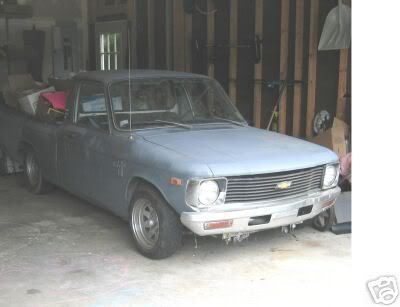

Check out my new ride direct from e-bay!

Good Score!!!! looks like a pretty straight little truck. *thumbs up*

Drove it home with no repairs! Needs a tune-up and some brake work! Runs pretty nice down the road and very lively! Only thing i can't figure out is the reverse lights work in 3rd and 4th but not reverse! Any ideas?

There are two switches on the trans, one is for the coasting richer circuit on the carb that comes on in 3rd and 4th, the other is the reverse switch. Sounds like you have the reverse light wiring plugged into the 3/4 switch, probably vice versa too. Prior owner probably had the trans out at some point and plugged them back in the wrong places.
