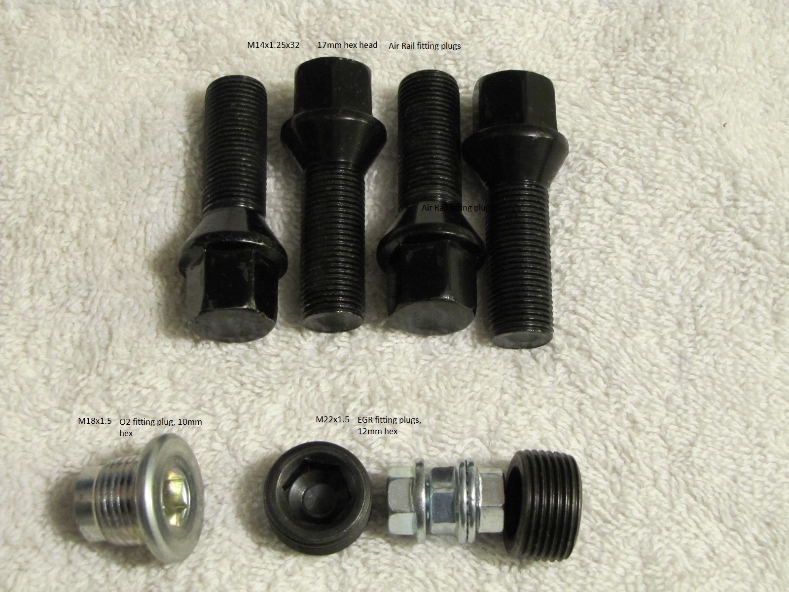

I have this smog delete plug kit for $20 shipped, payable via PayPal. PM me.
A 12mm installation tool for the EGR plugs is included & you may not need the O2 fitting plug.
Fits G180Z, G200Z, 4ZD1, 4ZE1 engines.
