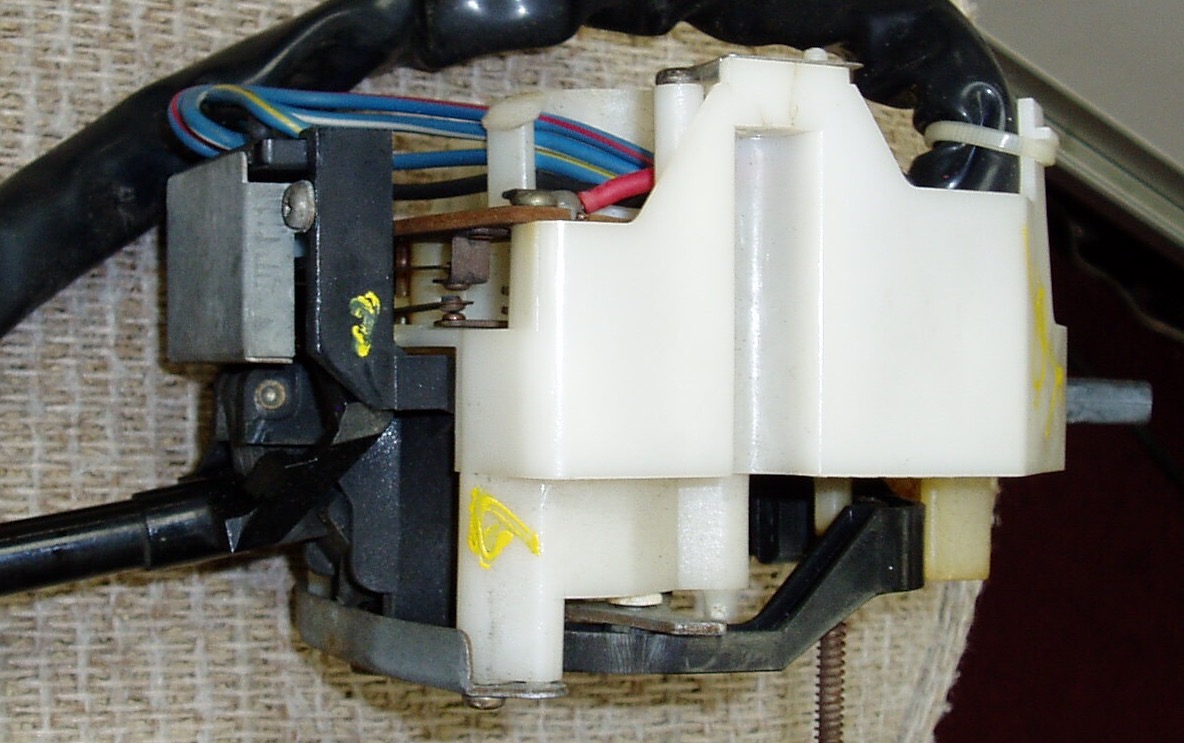

Ok, that should be repairable. There are some contracts in the signal switch that look like distributor points. They're on springy metal tabs that eventually get where they don't return to their original positions. If you have some slender needle nose pliers, you can bent them back. Unfortunately, you might need to remove the steering wheel and the switch.
I'm using my phone, and I can't get more detailed than that while at work, on my phone. But when I get home to a real computer, if you haven't fixed it, or if nobody else has helped, I'll try to follow up. I have a spare switch, so I may be able to include some photos.

Ok, found a photo. This is exactly how the switch is oriented on the column, looking from overhead (the steering shaft goes through it). Click to zoom in, and notice the contacts that I was referring to. They're to the right of the uppermost yellow paint mark. You just might be able to access them without removing the wheel, but the plastic cover must come off. I think there are four sheet metal screws that attach the top and bottom cover halves together, and one (maybe 2) machine screws (all screws here are Phillips head and pretty small).
Incidentally, I had this problem when the truck was about 10 years old. After re-bending those tabs, it went maybe 15 more years with no trouble. I eventually replaced the switch because my intermittent wiper feature wasn't working -- but the high/low beam switch was still working fine.

Which way should those tabs be bent ? Are they in the proper position as we see them in the picture ?

Posts: 1702
Without having one in my hand, I'm not sure. But if you cycle between high, low, and pull all the way back to the "flash" position, you should be able to watch the movement if the contacts, and see which ones are almost-but-not-quite making connections.
