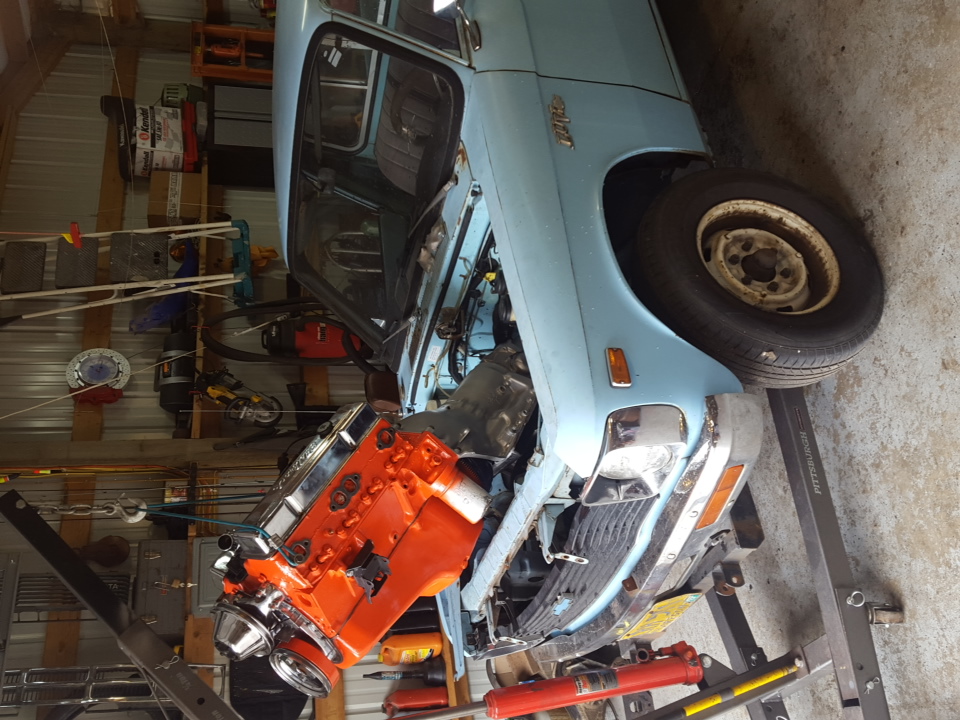

Just registered member, always used this site for references and troubleshooting, awesome guys on here decided to join and share some experiences. Just put a 327 in a 78 luv I picked up a couple months ago and the whole project has been trial and error breaking new ground. Just want to share some pics and see if anyone has some questions on a similar project. The motors not built, stock besides carb and intake but scoots the luv how I imagined. Th350 tranny, stock 2wd rear end (for now) northern radiator, manifolds of late 70s nova, flowmaster super 10s and ACE motor and trans mounts. I still have a couple questions of my own like hooking up the speedo, and getting the stock oil light to stay off, or actually function properly. Does anyone know if you can make the stock temp gauge work accurately? I'm also not sure about a where and tire setup, I'm having a real hard time hooking up and not spinning. Again, and questions or comments I could love to hear thanks.
