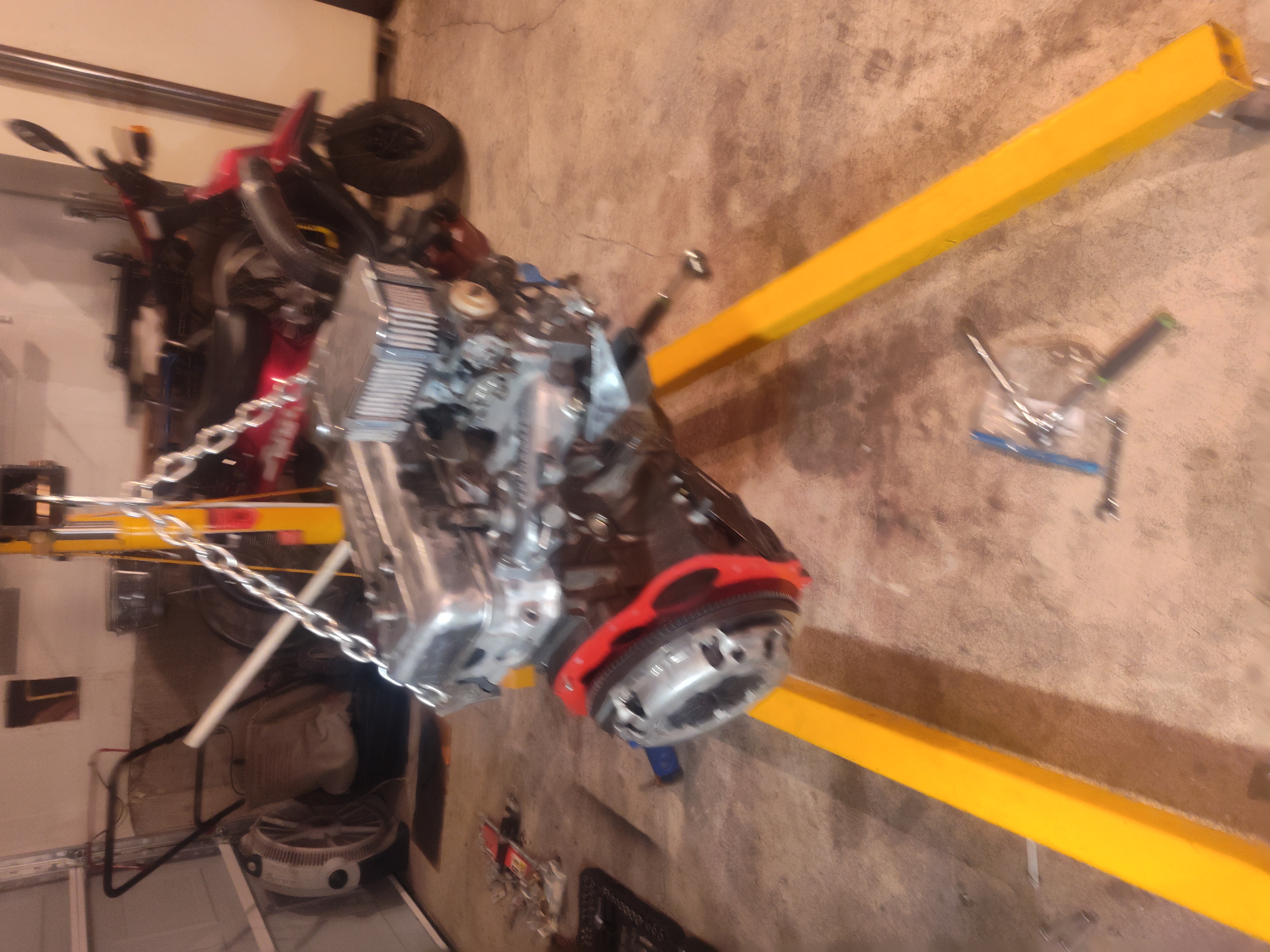

Hey all I completed my rebuild yesterday and am going to start a pictorial guide from start to finish of my build.

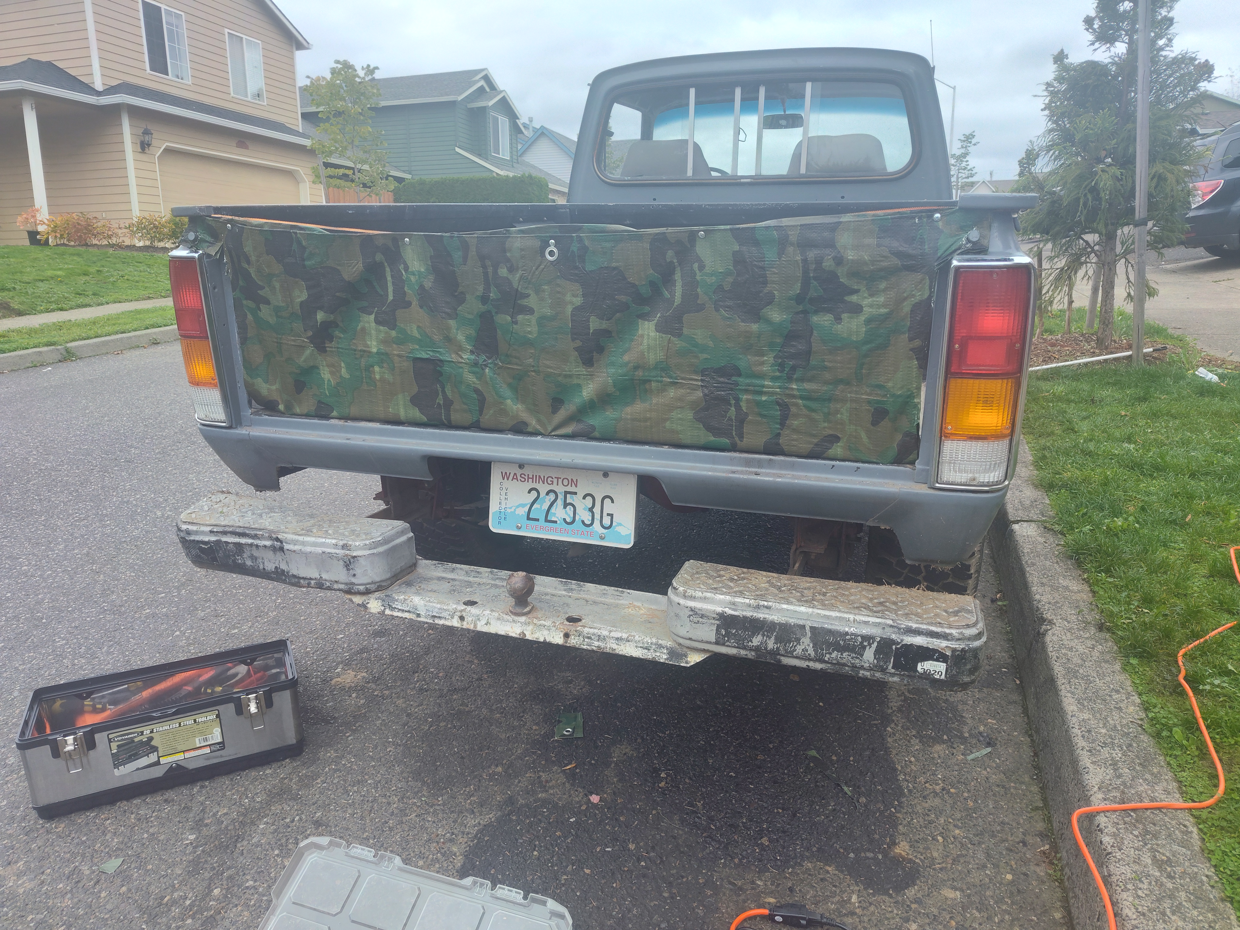

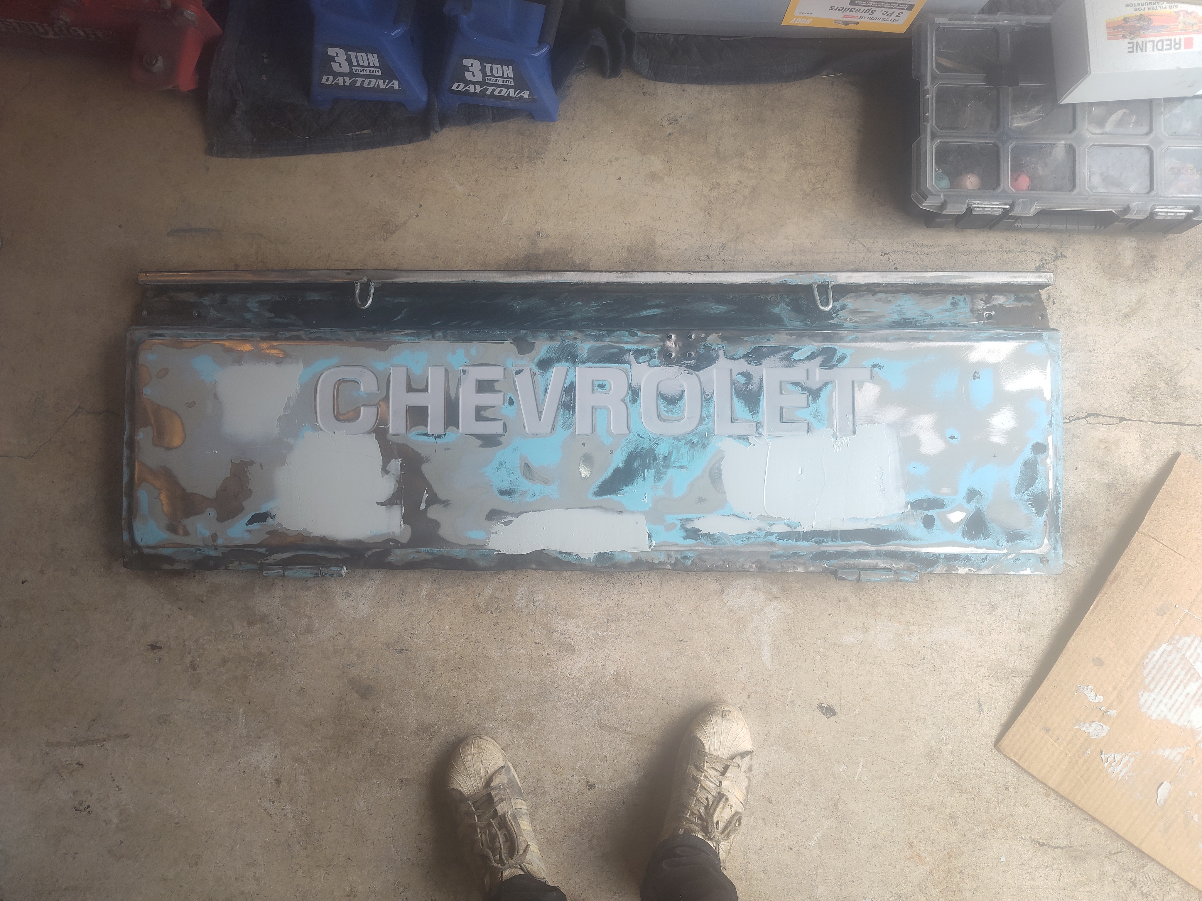

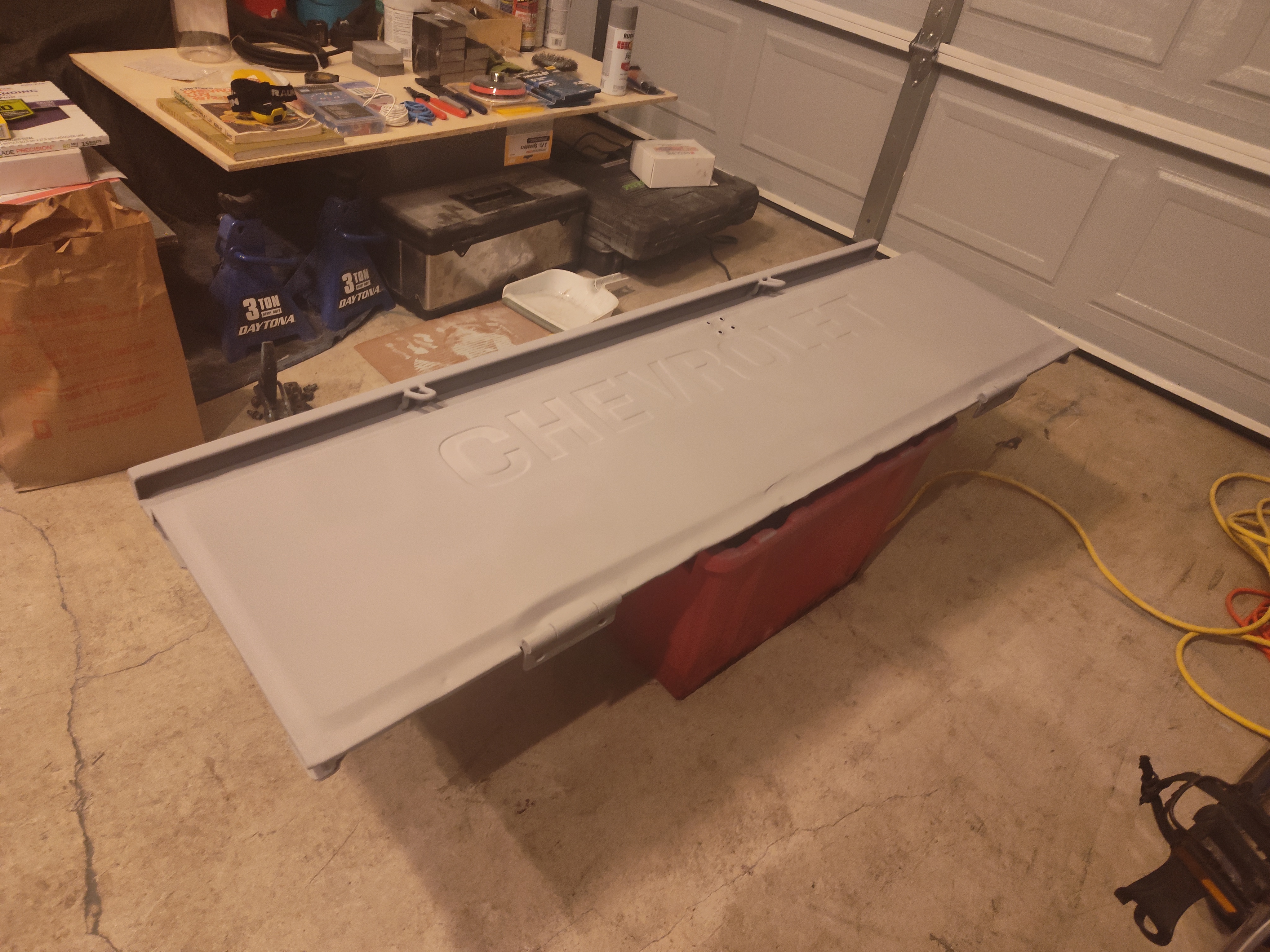

File comment: Interim tailgate

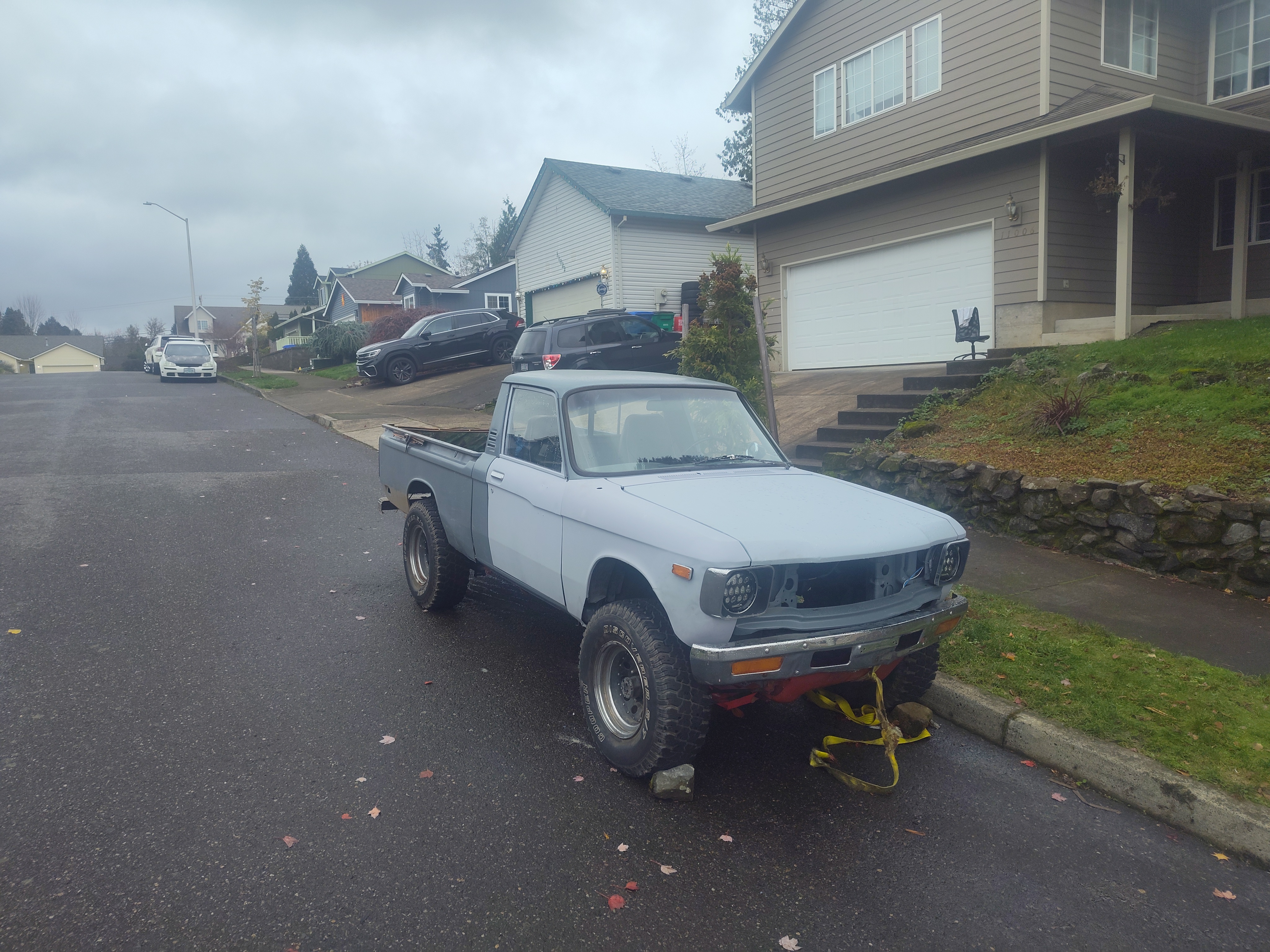

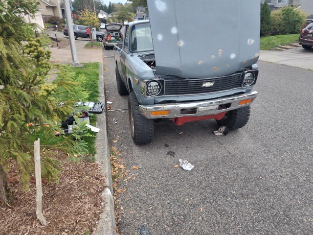

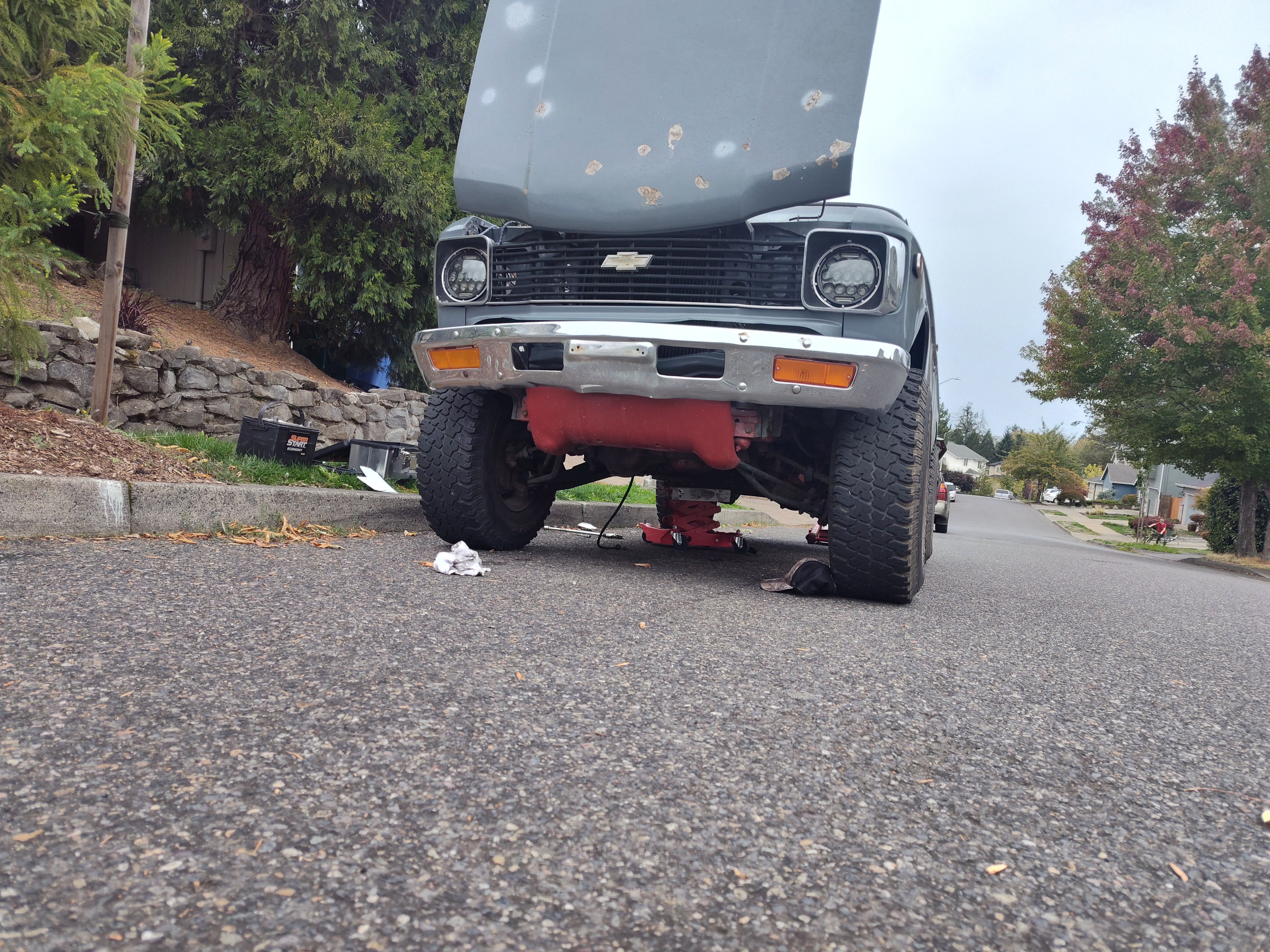

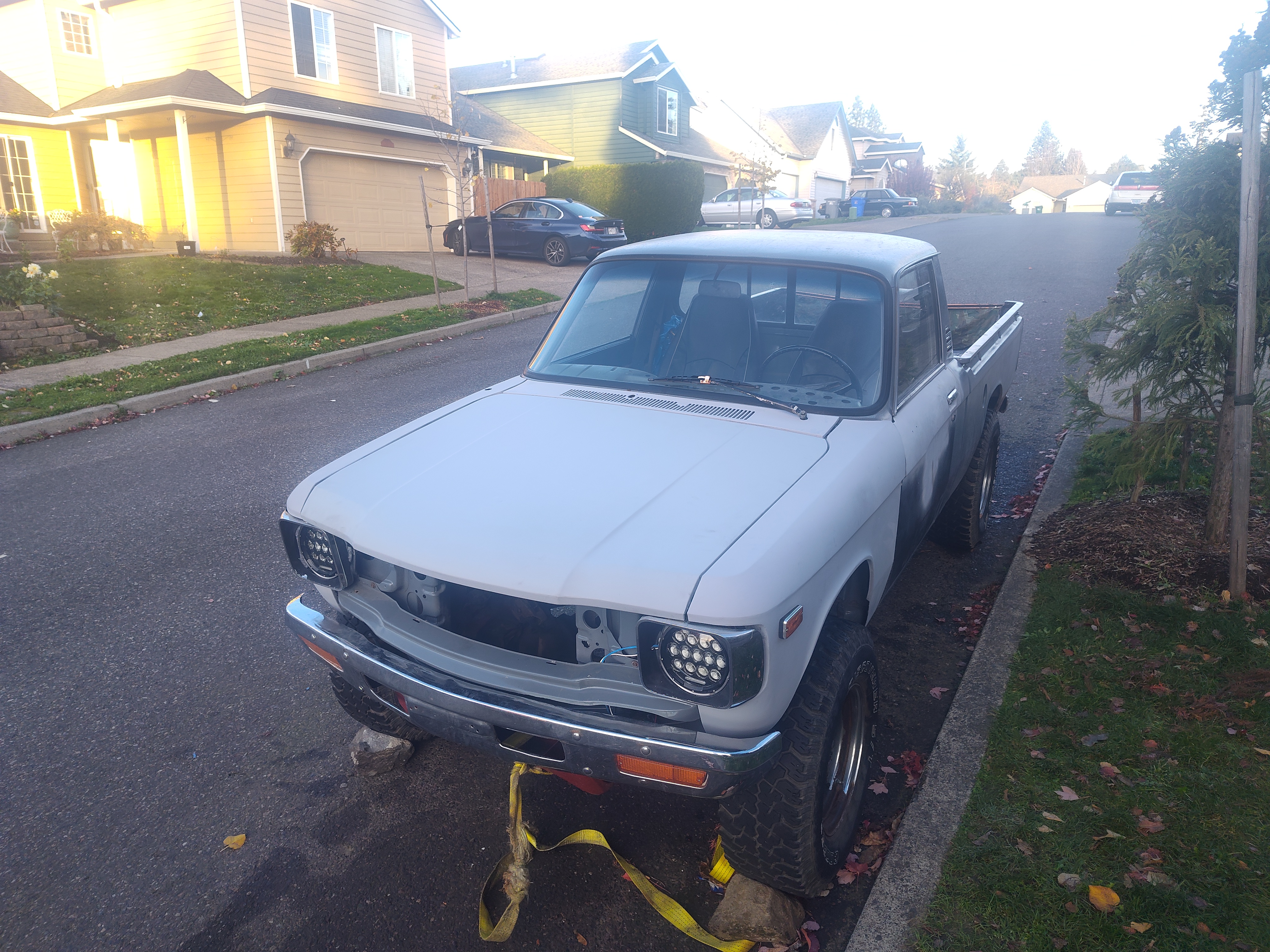

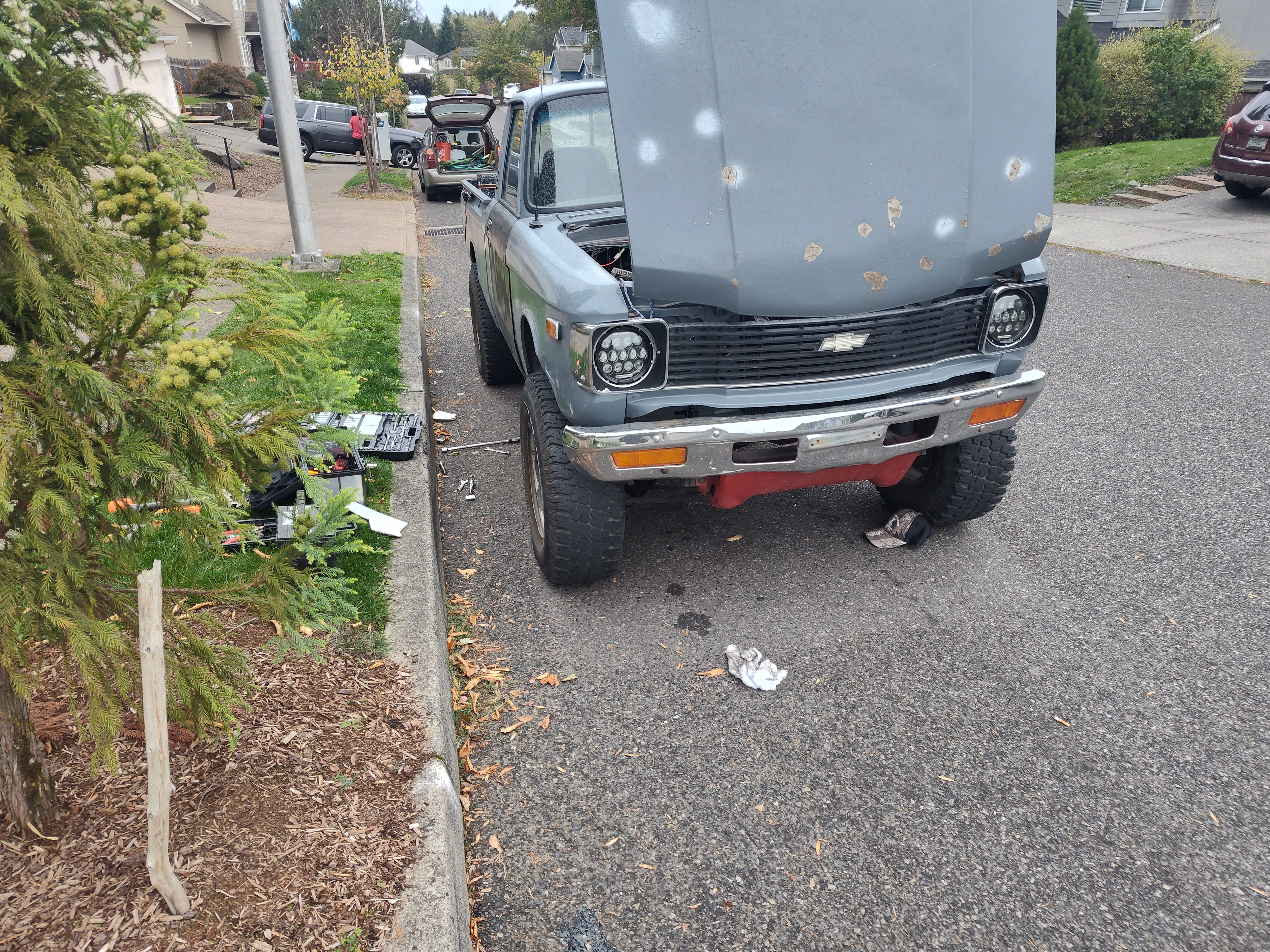

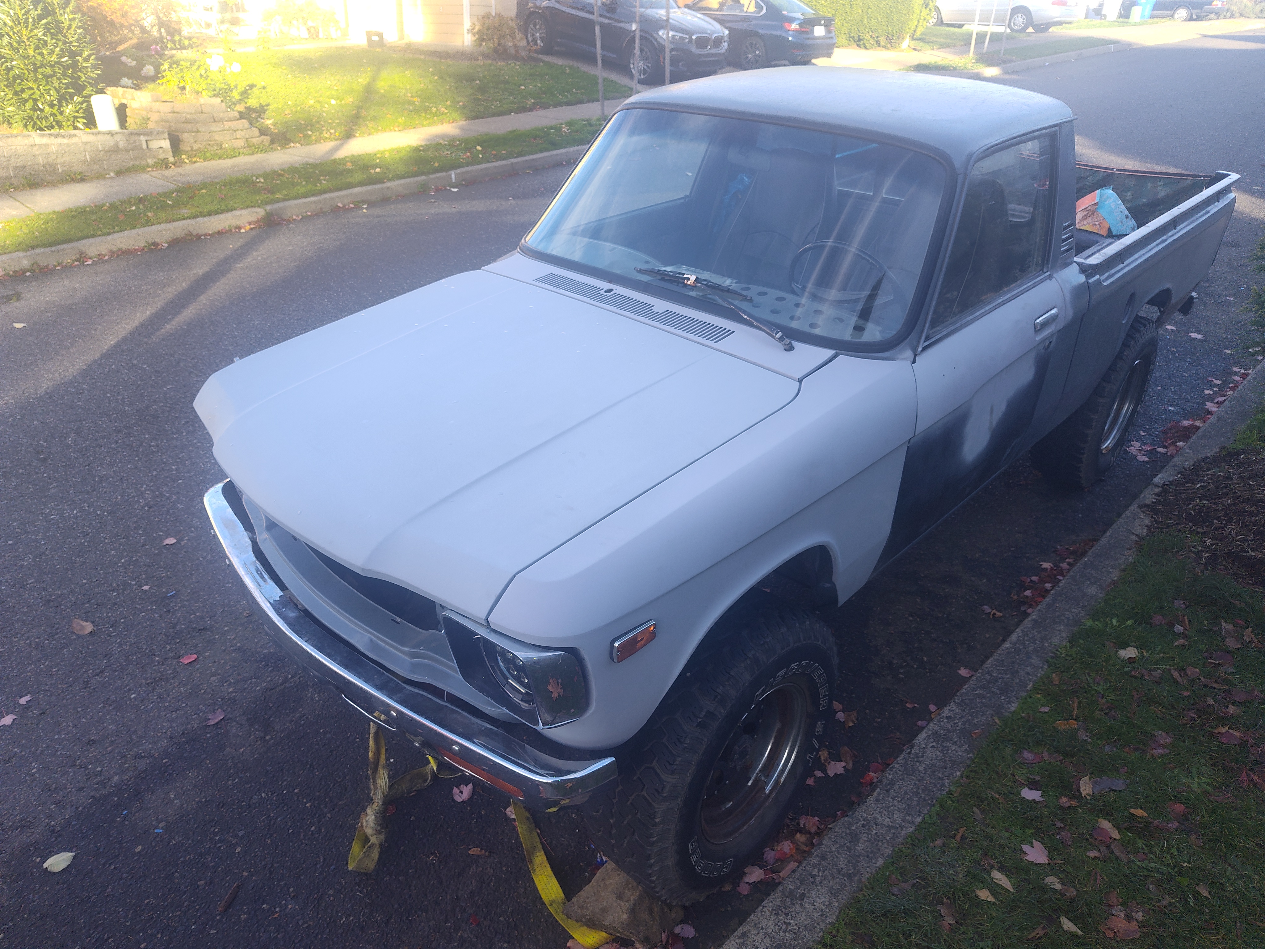

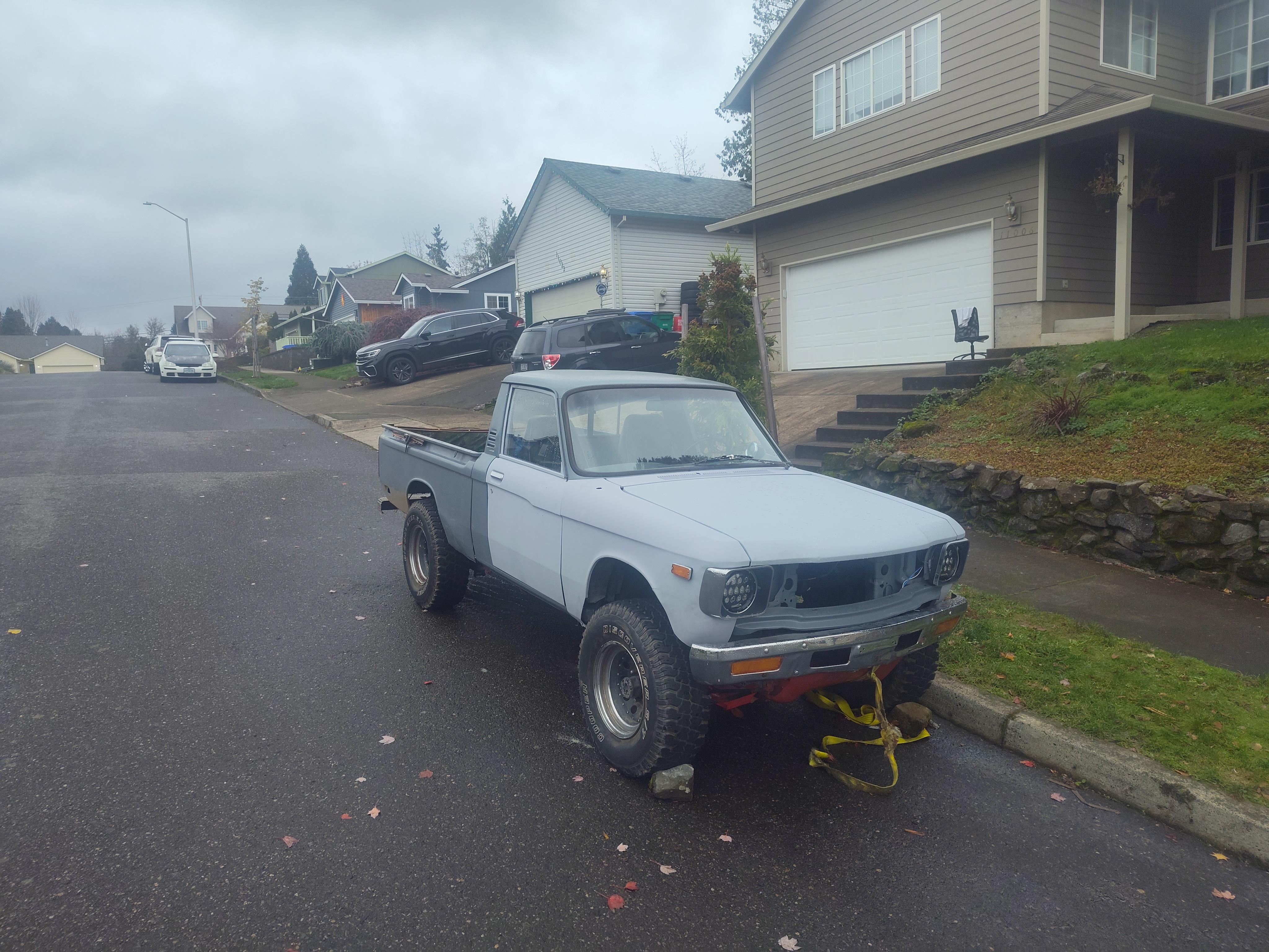

File comment: Truck as I bought it

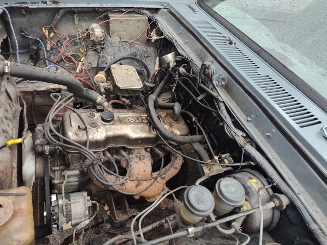

File comment: Original engine bay

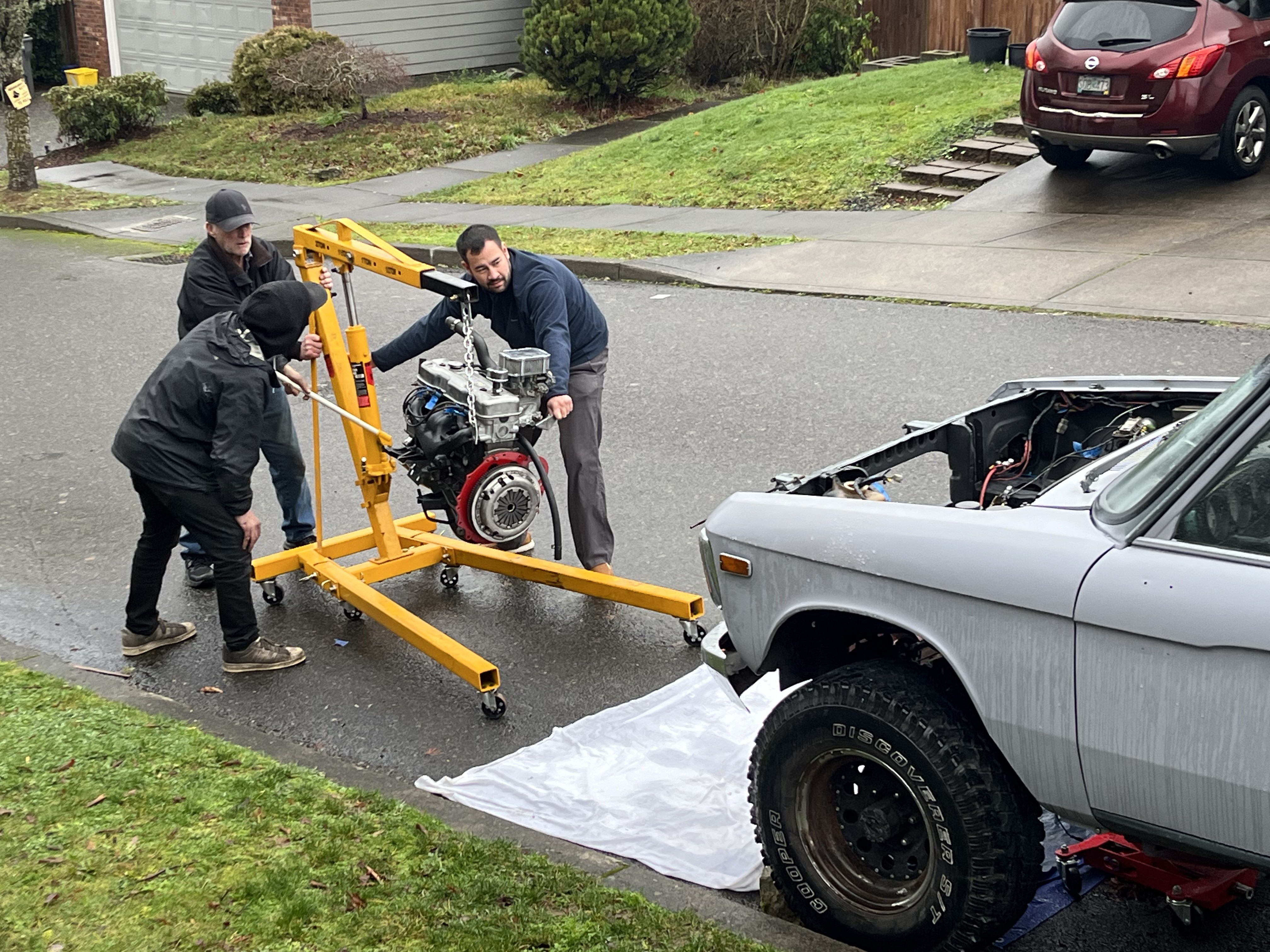

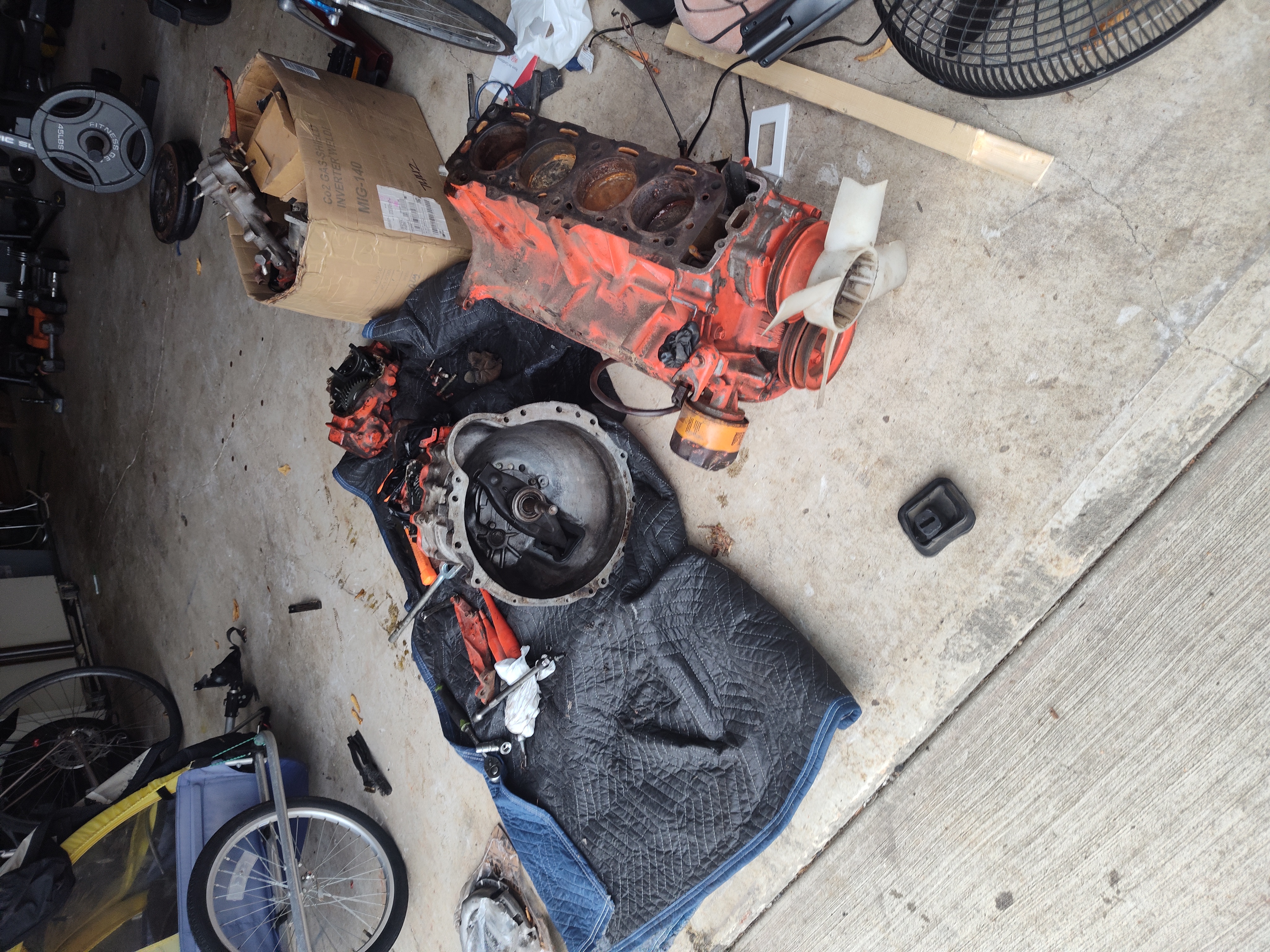

File comment: Donor engine and tranny

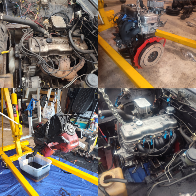

File comment: Before and after.

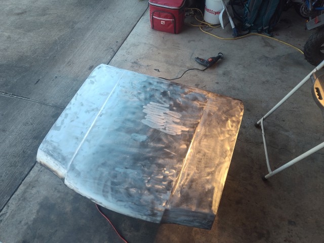

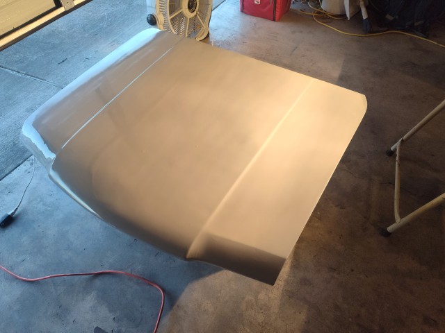

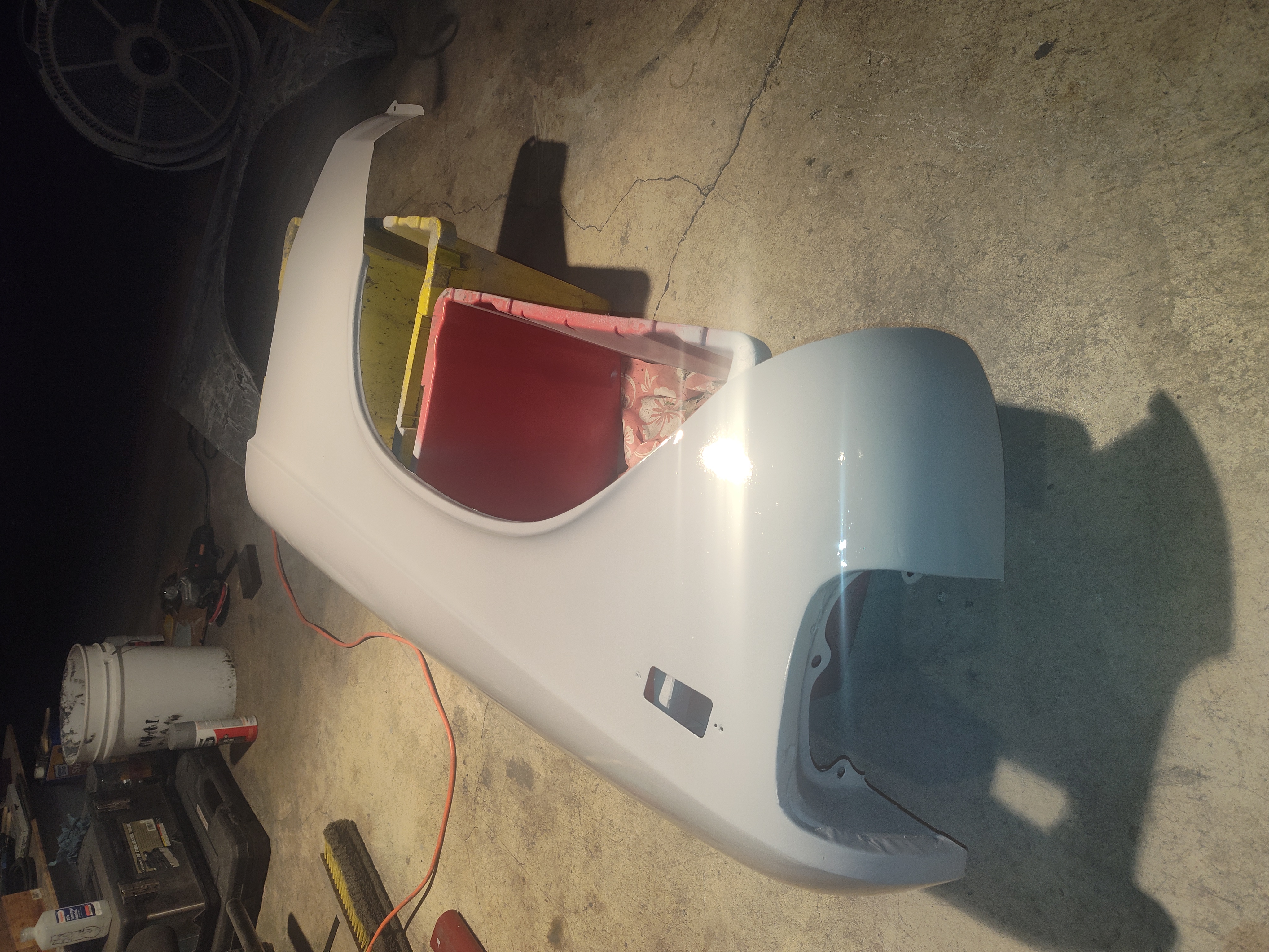

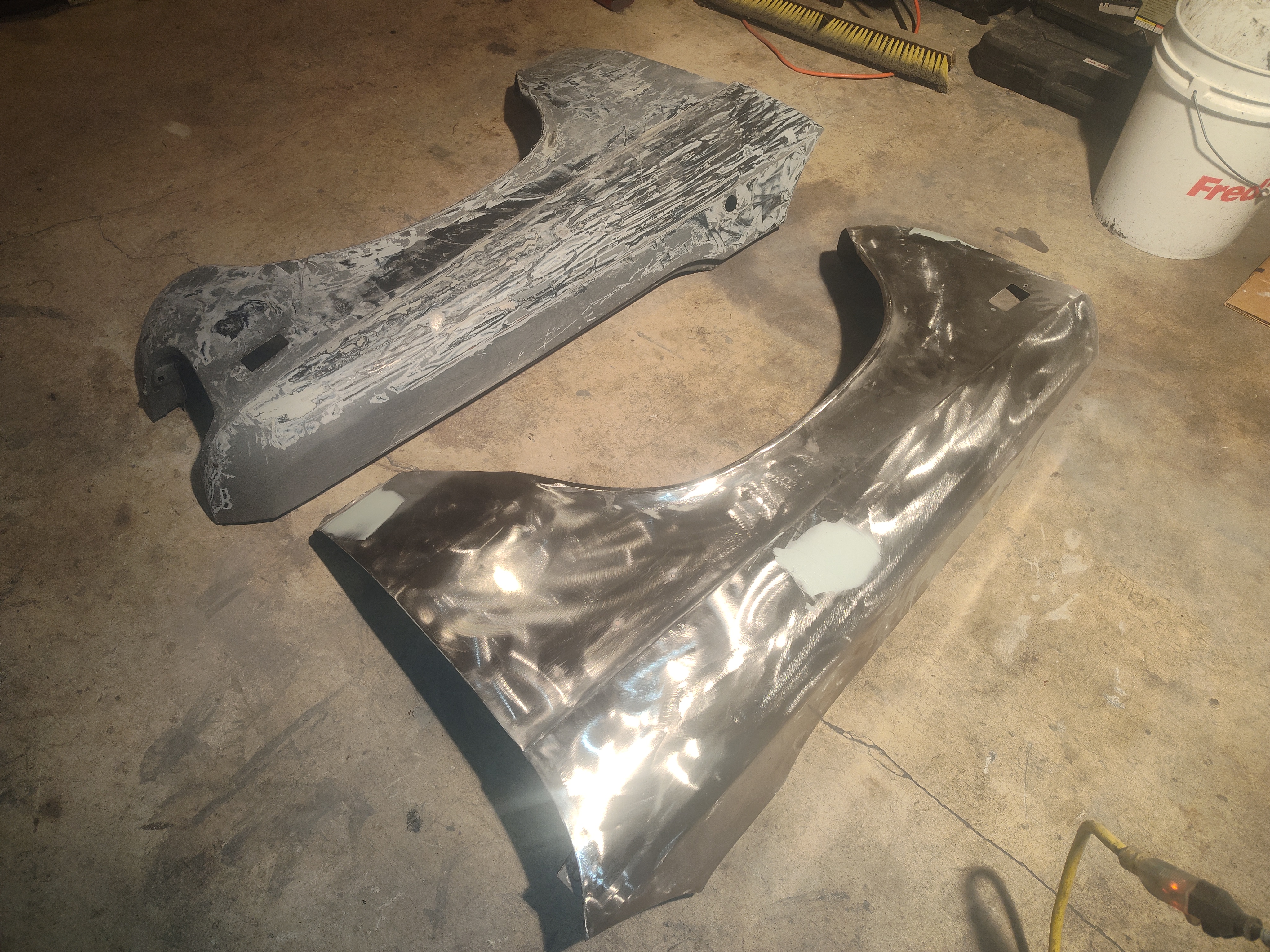

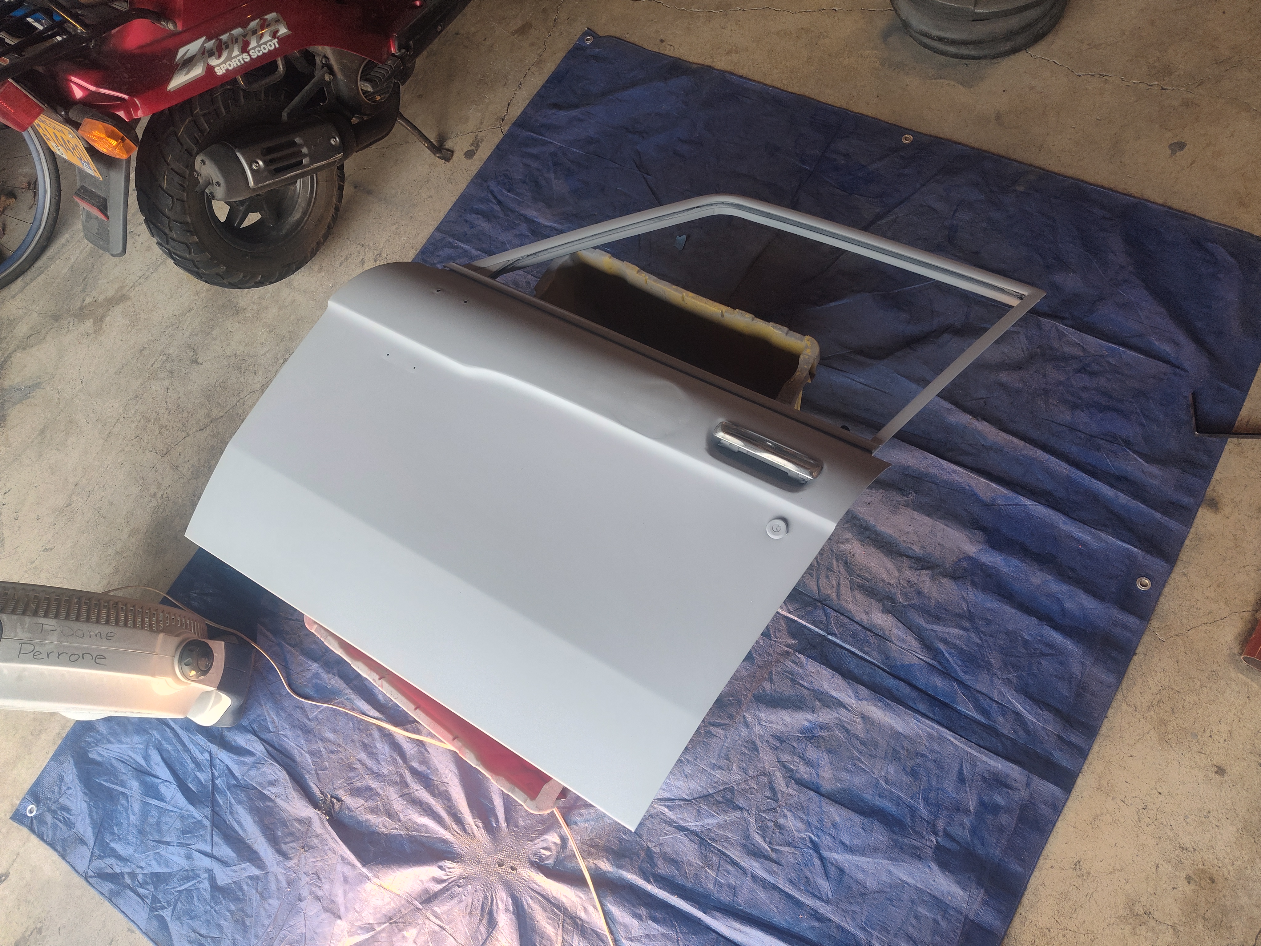

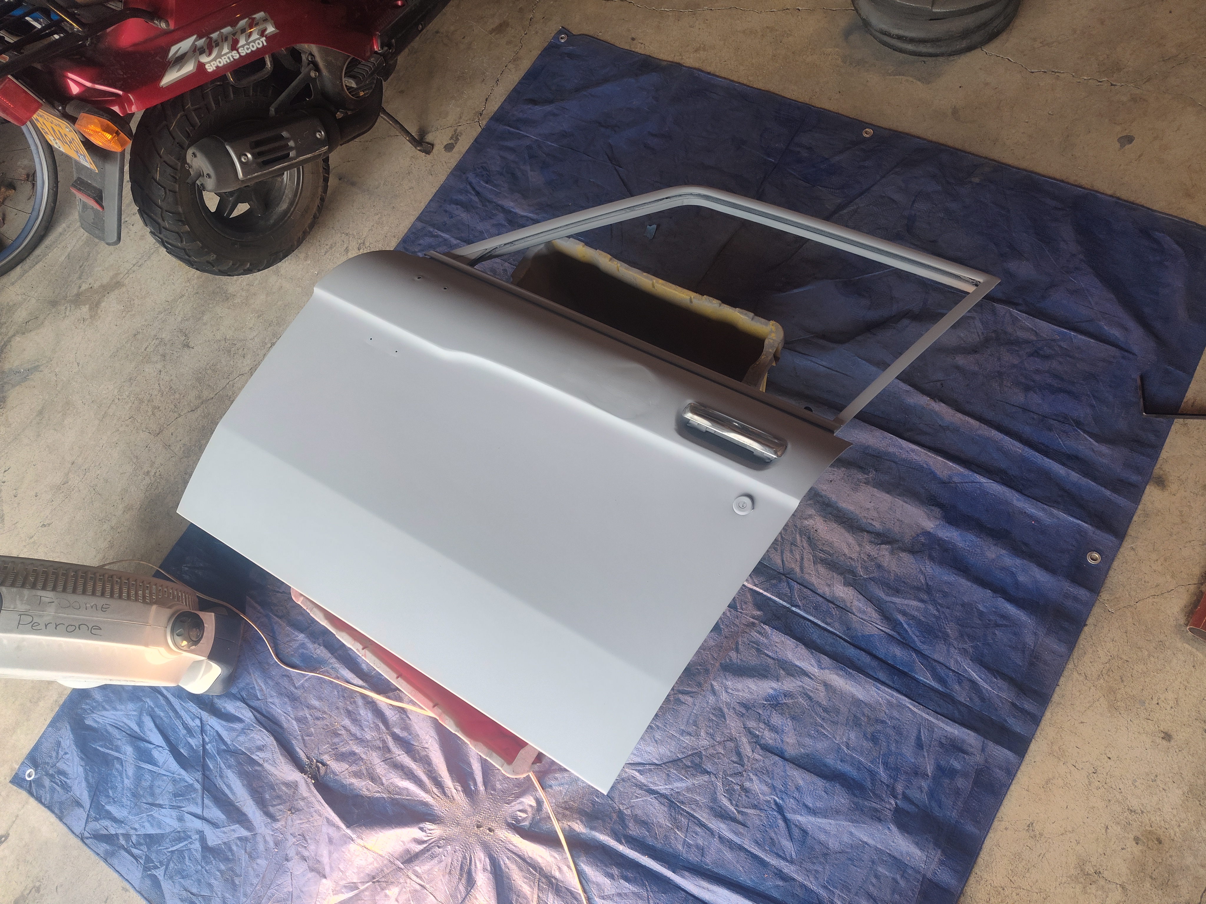

Body and paint

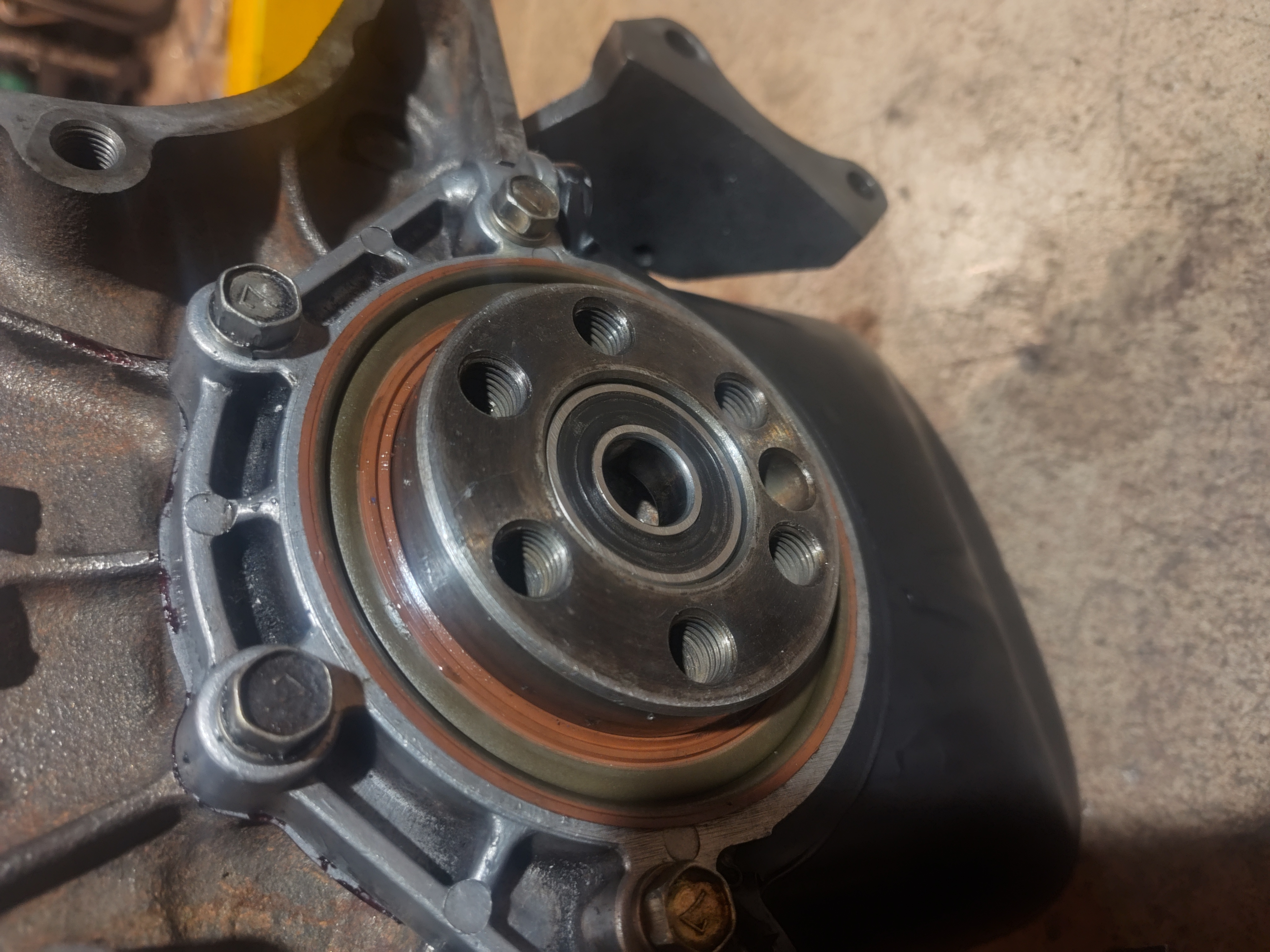

File comment: New pilot bearing installed

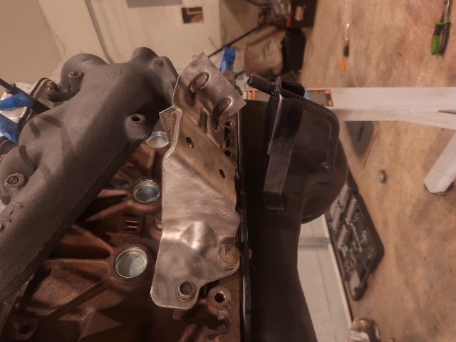

File comment: Primed, painted heat/splash shield

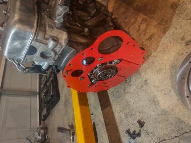

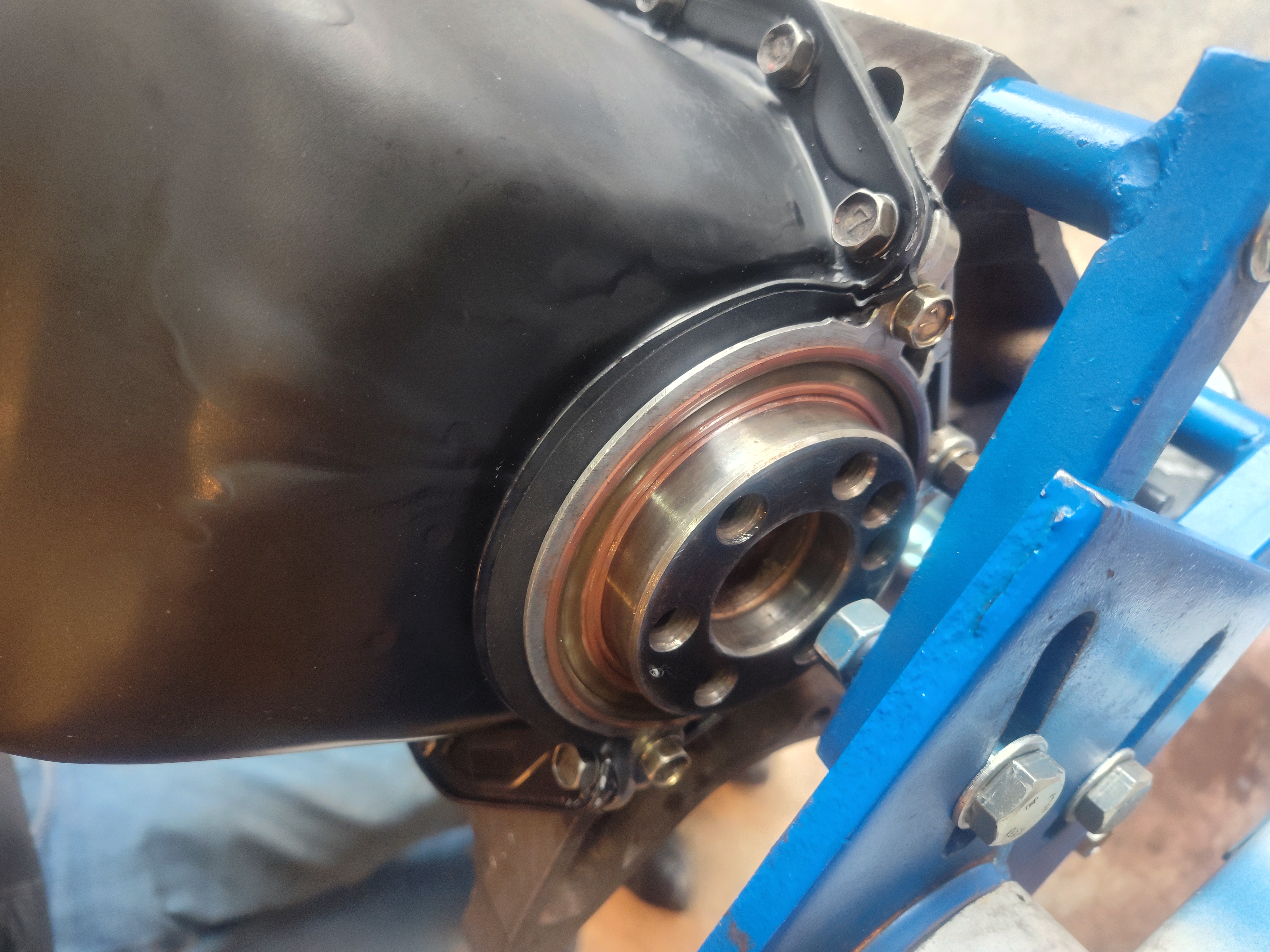

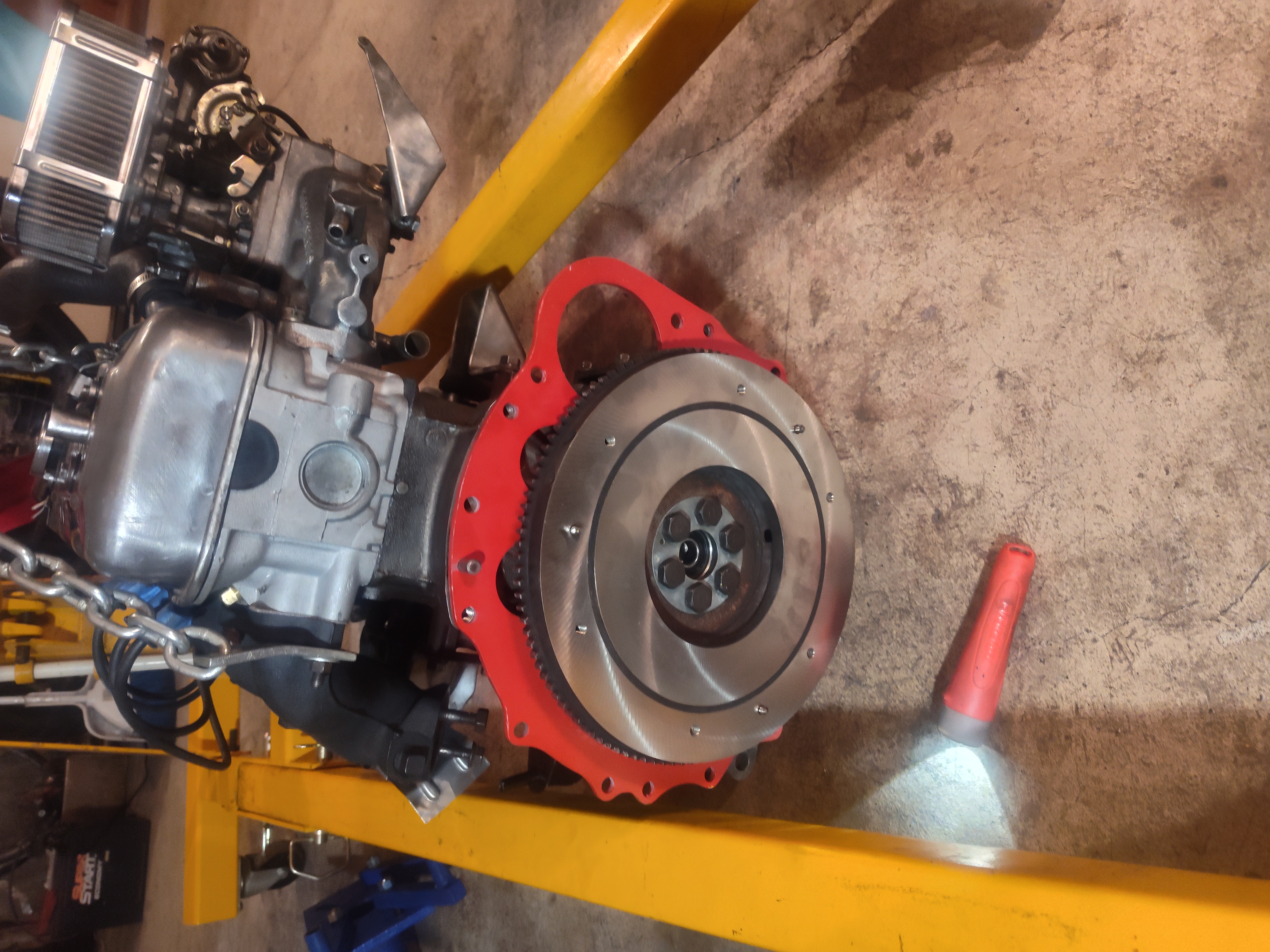

File comment: Resurfaced flywheel

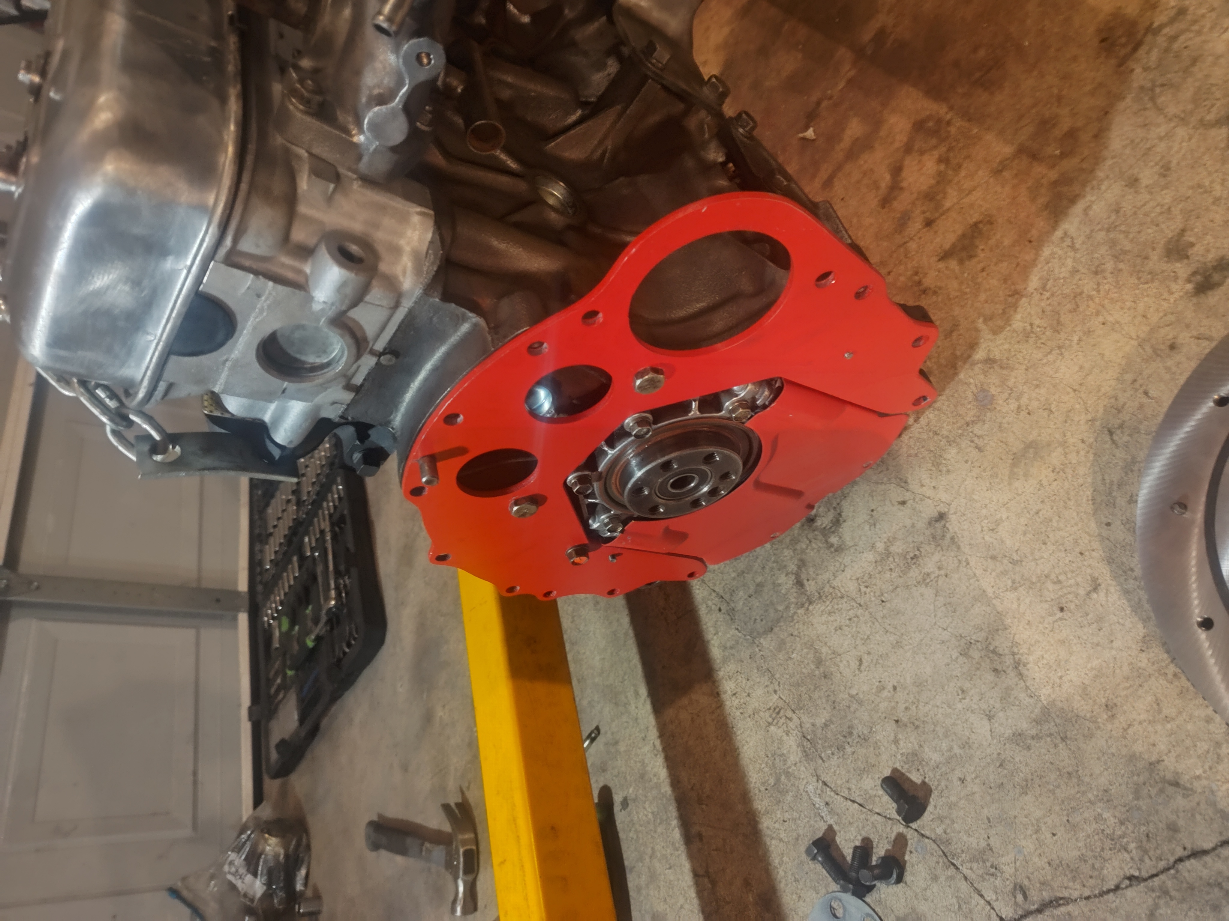

File comment: Clutch and pressure plate installed

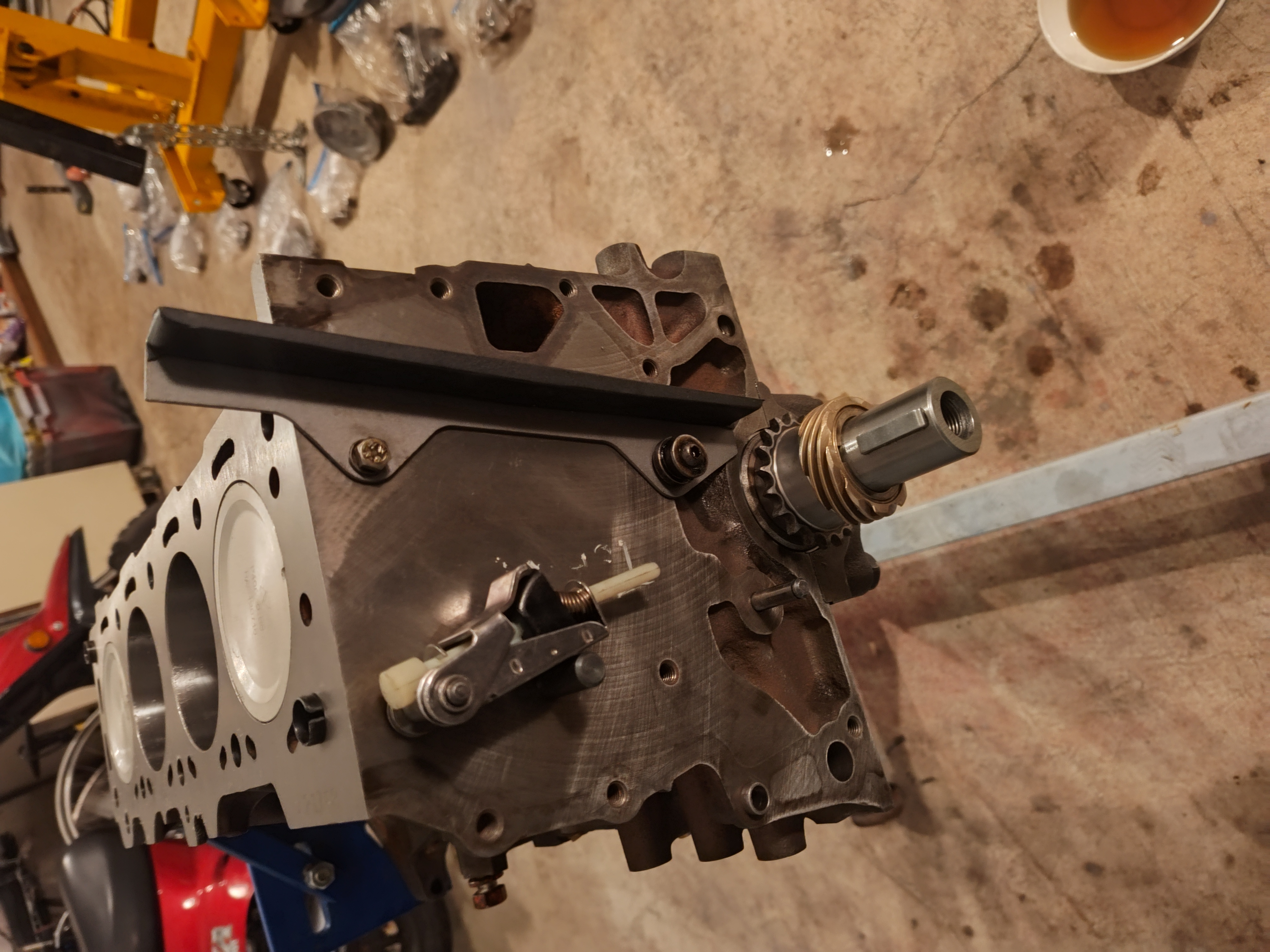

Rebuild

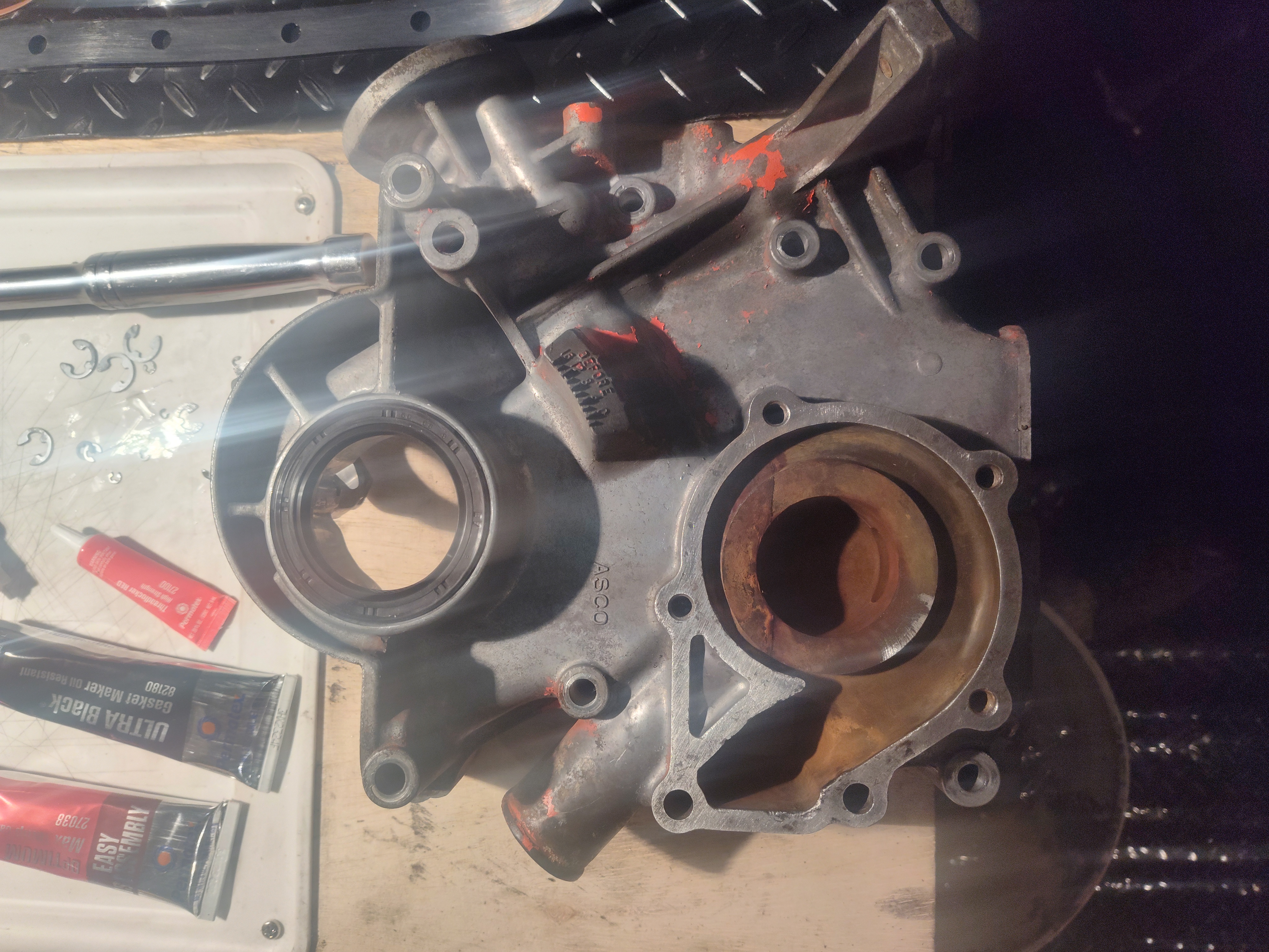

File comment: Timing cover installed with new seal.

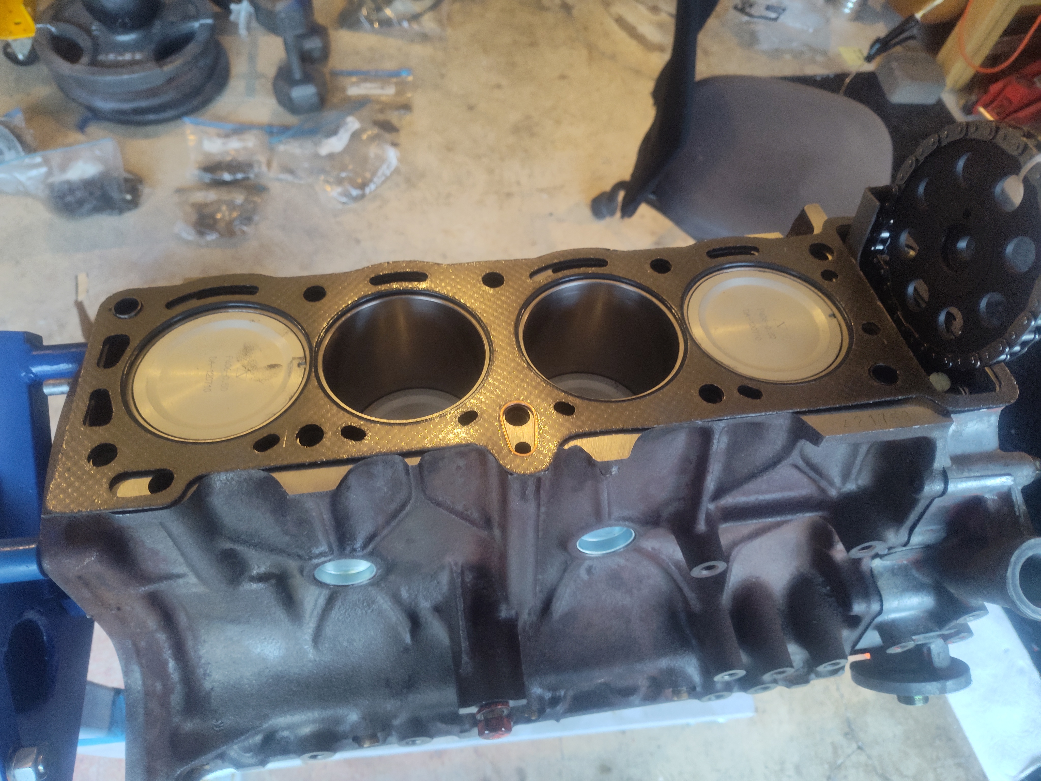

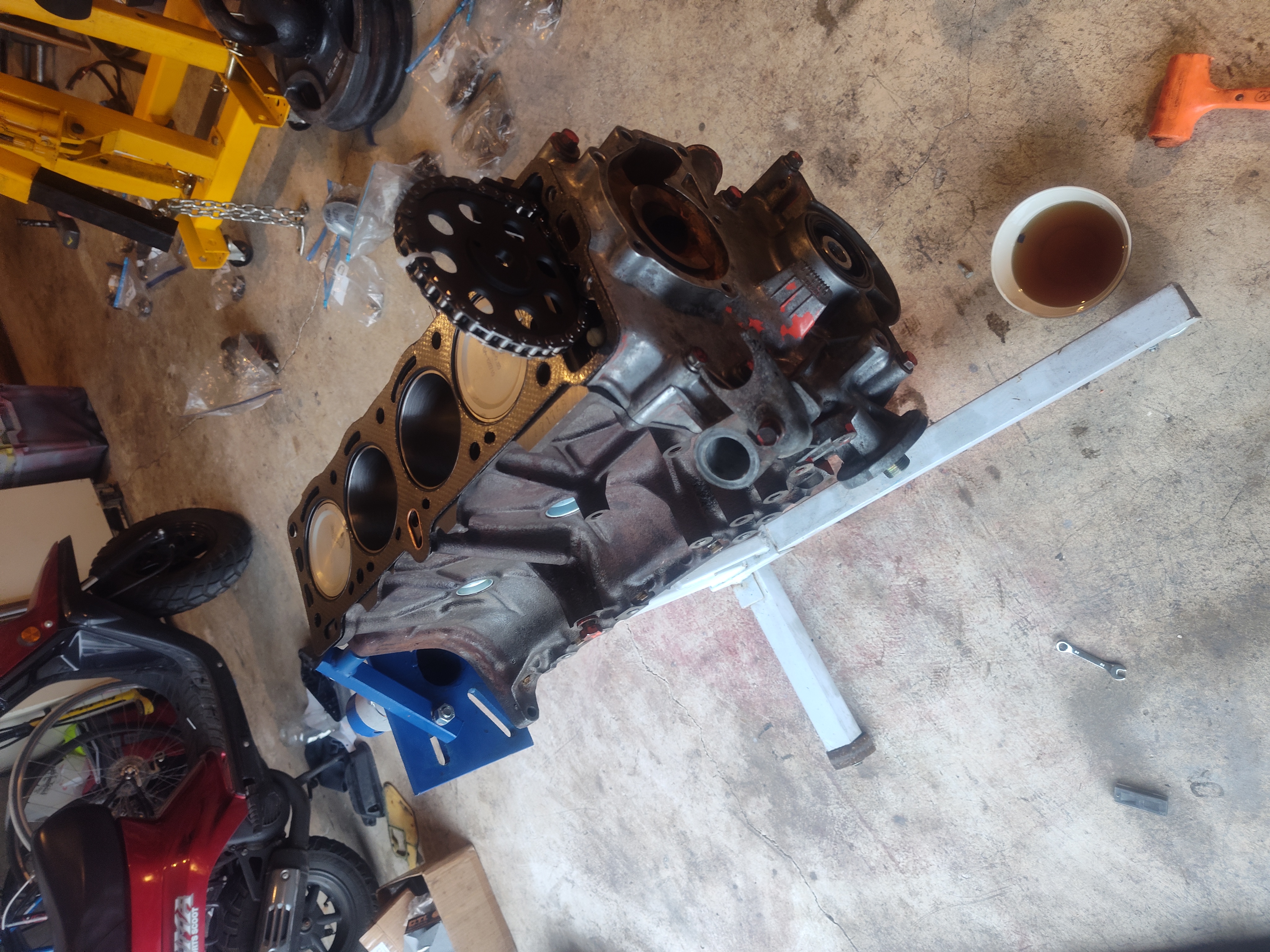

File comment: New head gasket

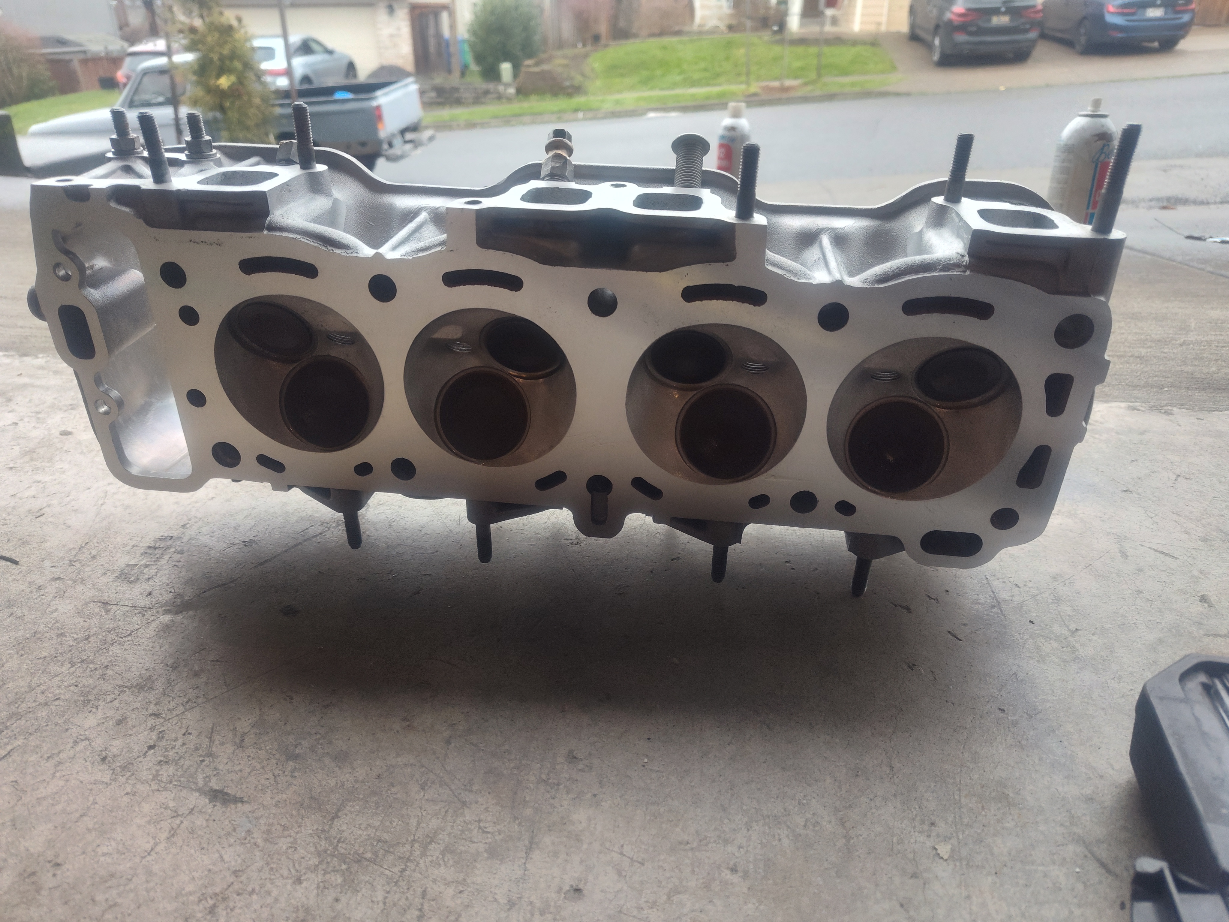

File comment: Machined head looking very nice

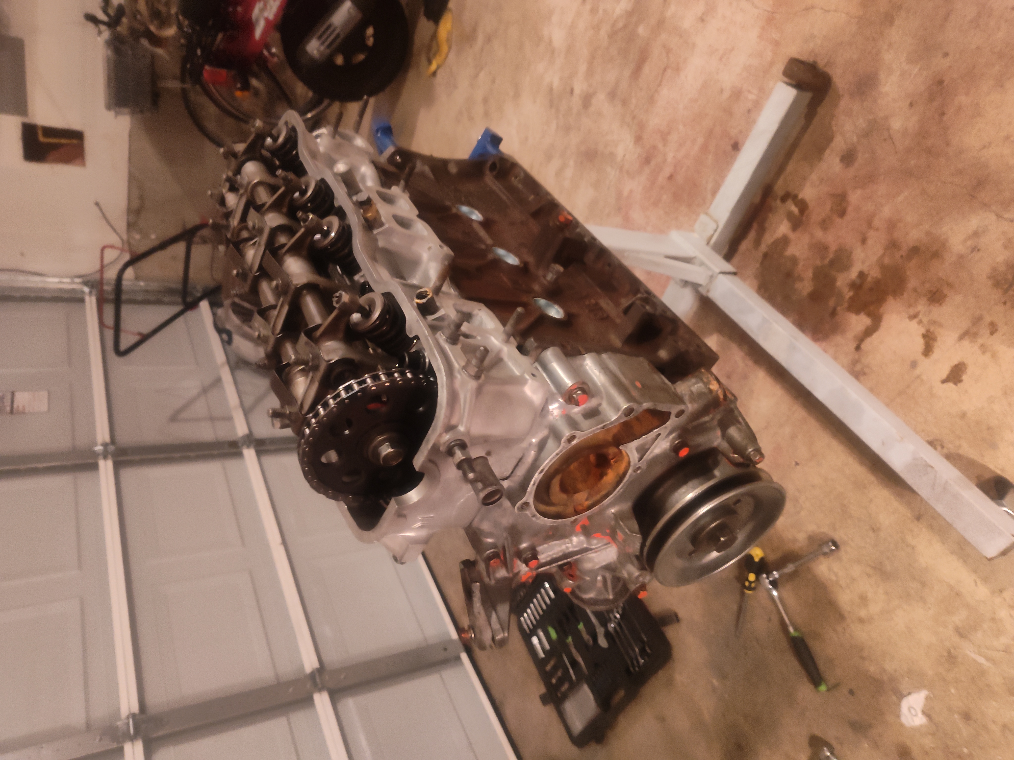

File comment: Head with new cam mounted torqued to spec with new head gasket.

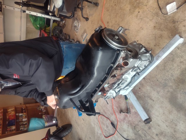

File comment: Cleaned the inside of oil pan meticulously, steel wire brushed exterior/primed painted, mounted with new gasket, put a little bit of oil resistant gasket sealer near base of rear main seal and at timing cover where it meets the block.

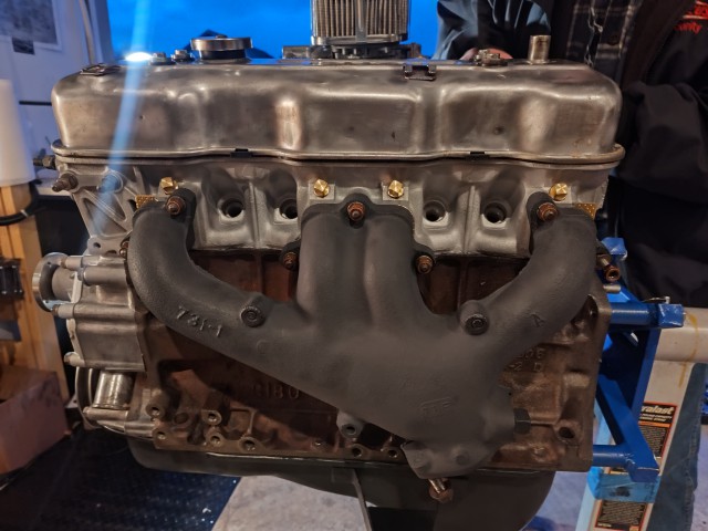

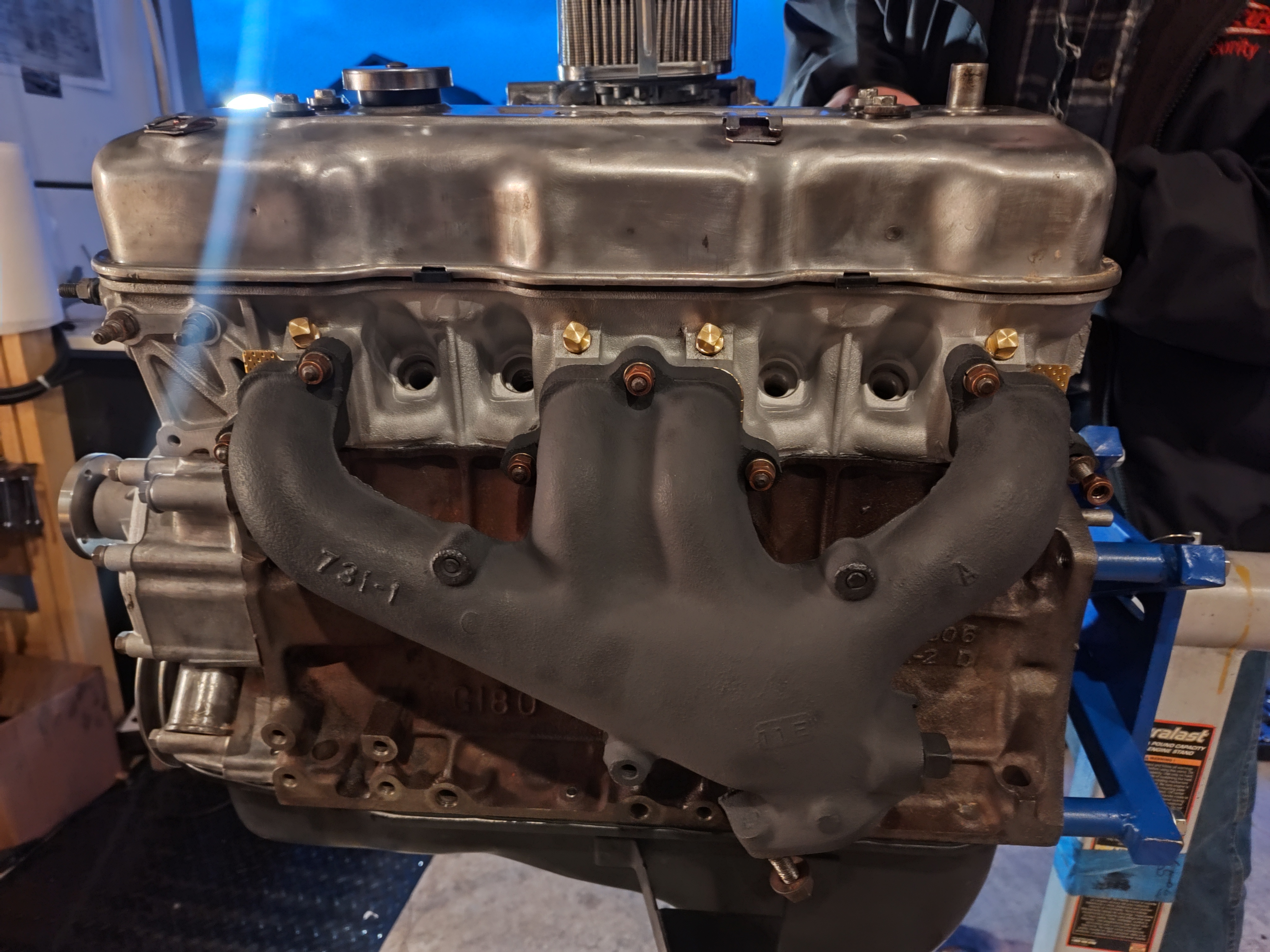

File comment: Exhaust manifold cleaned, painted with high temp ceramic coating. New brass plugs.

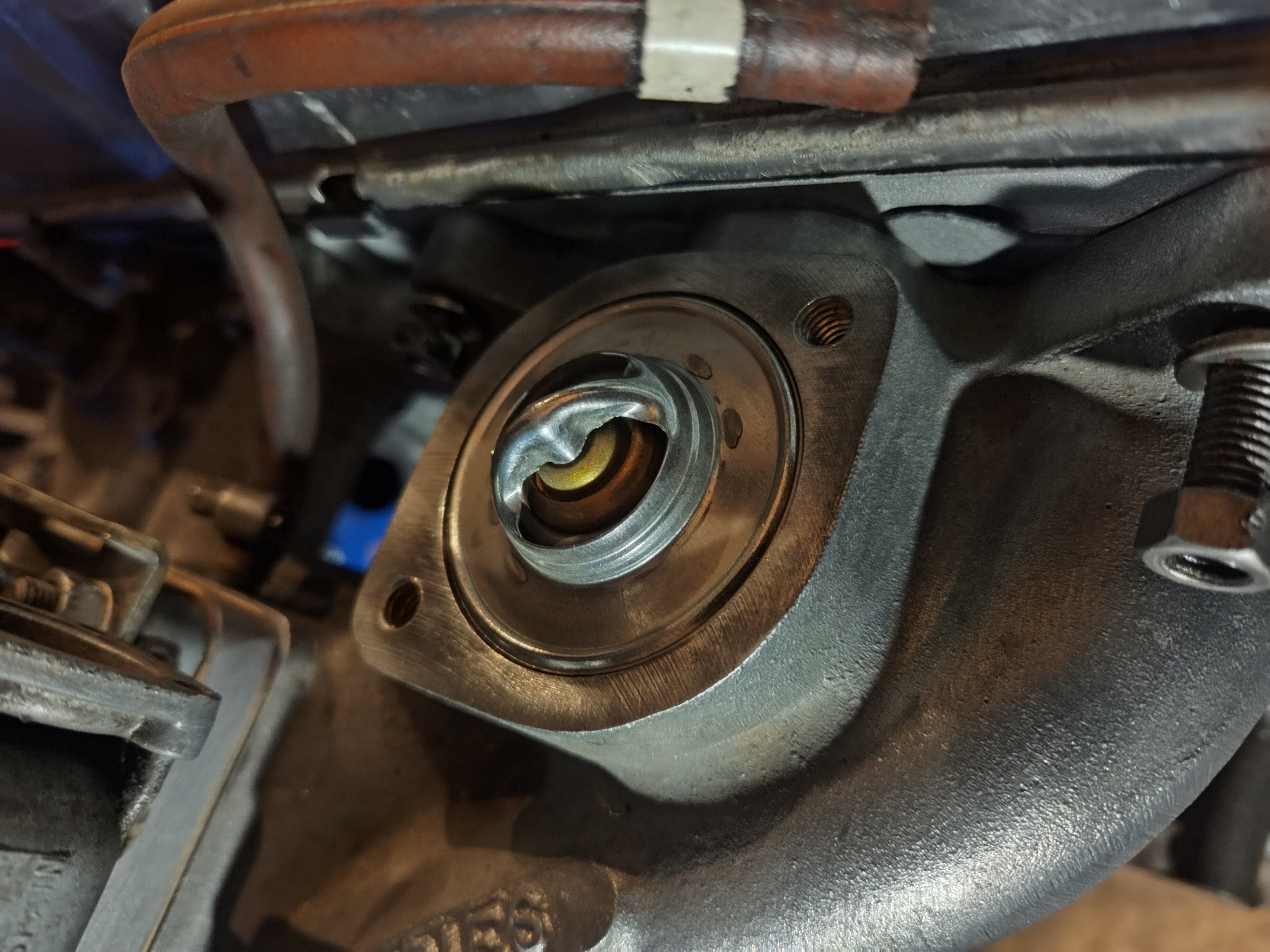

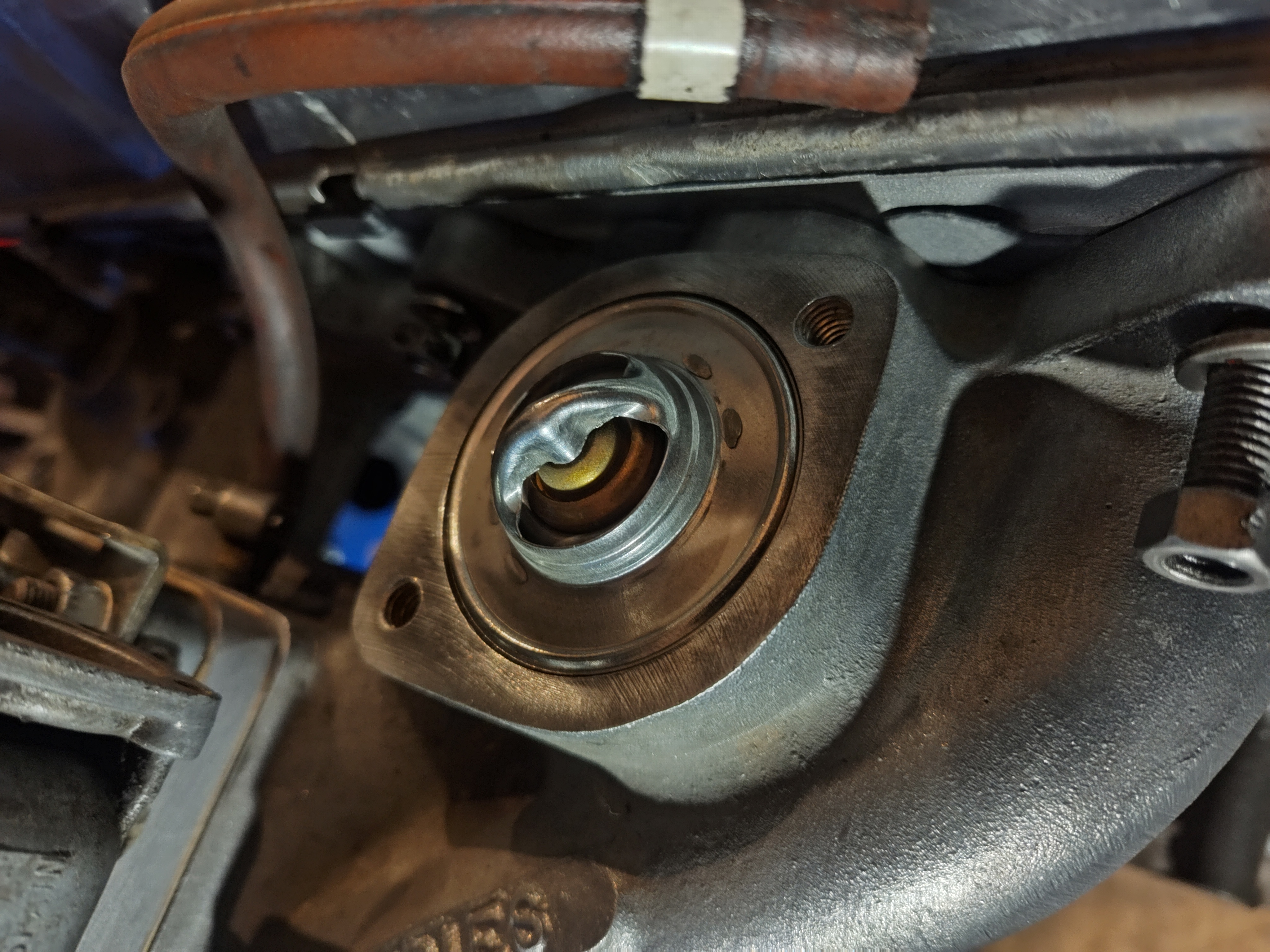

File comment: New thermostat

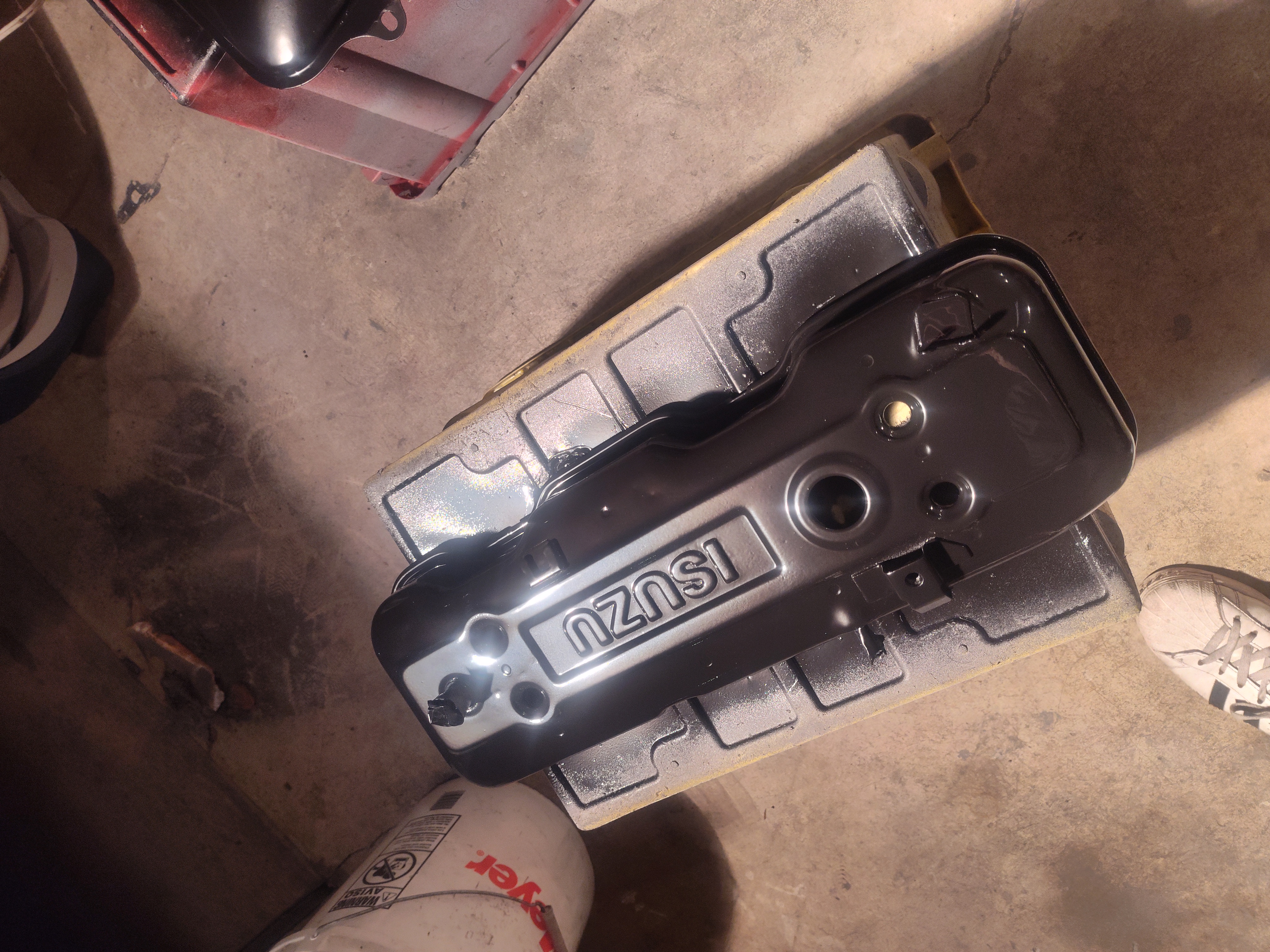

File comment: Block and valve cover clear coated

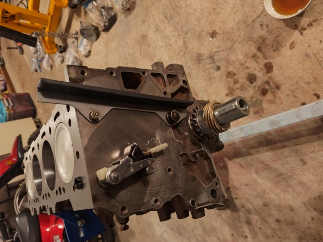

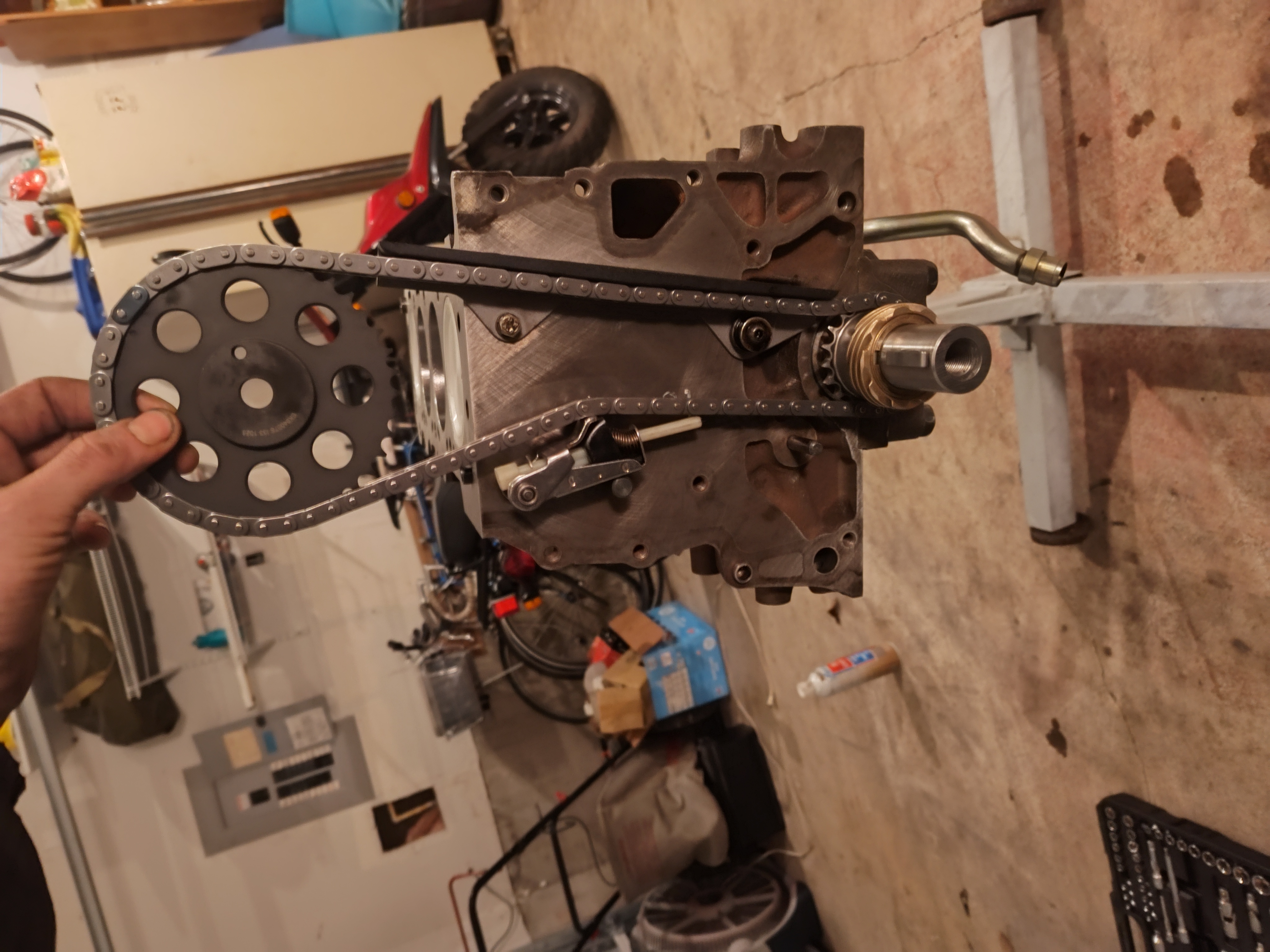

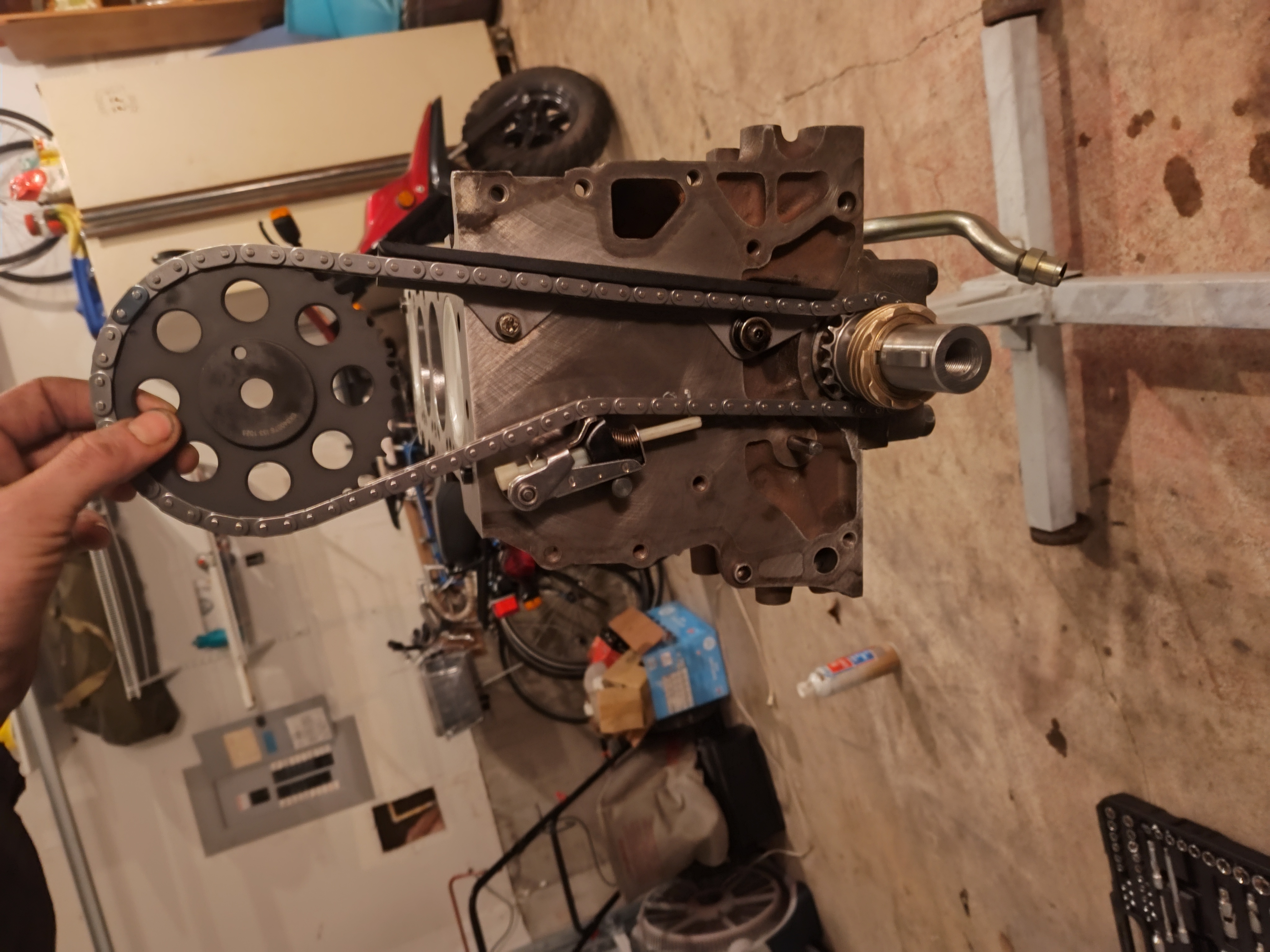

File comment: New timing component kit installed.

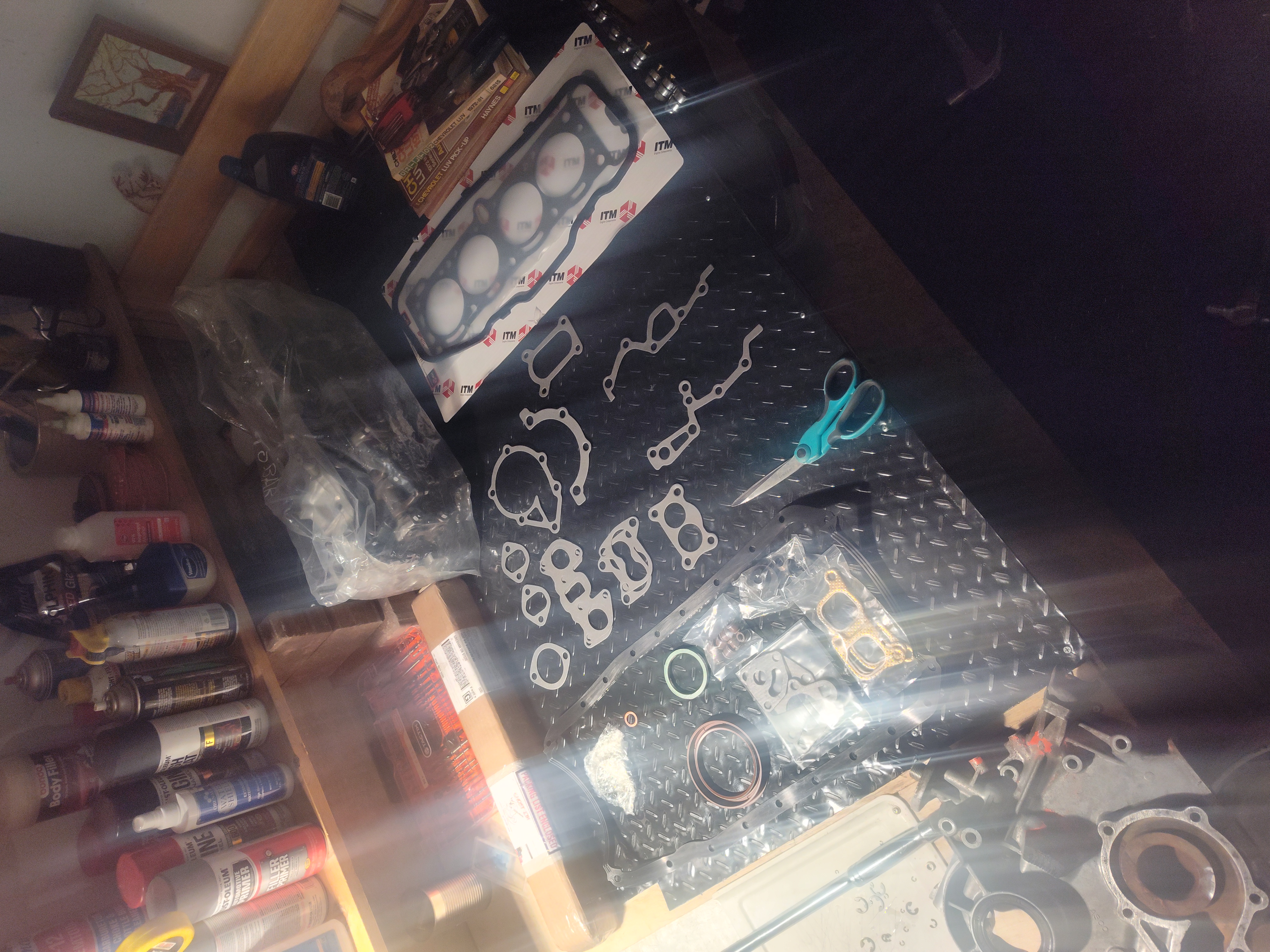

File comment: Gasket kit sourced from rockauto

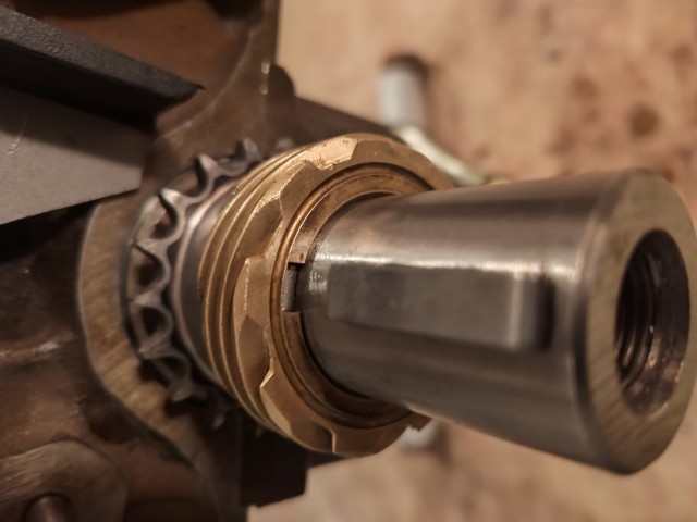

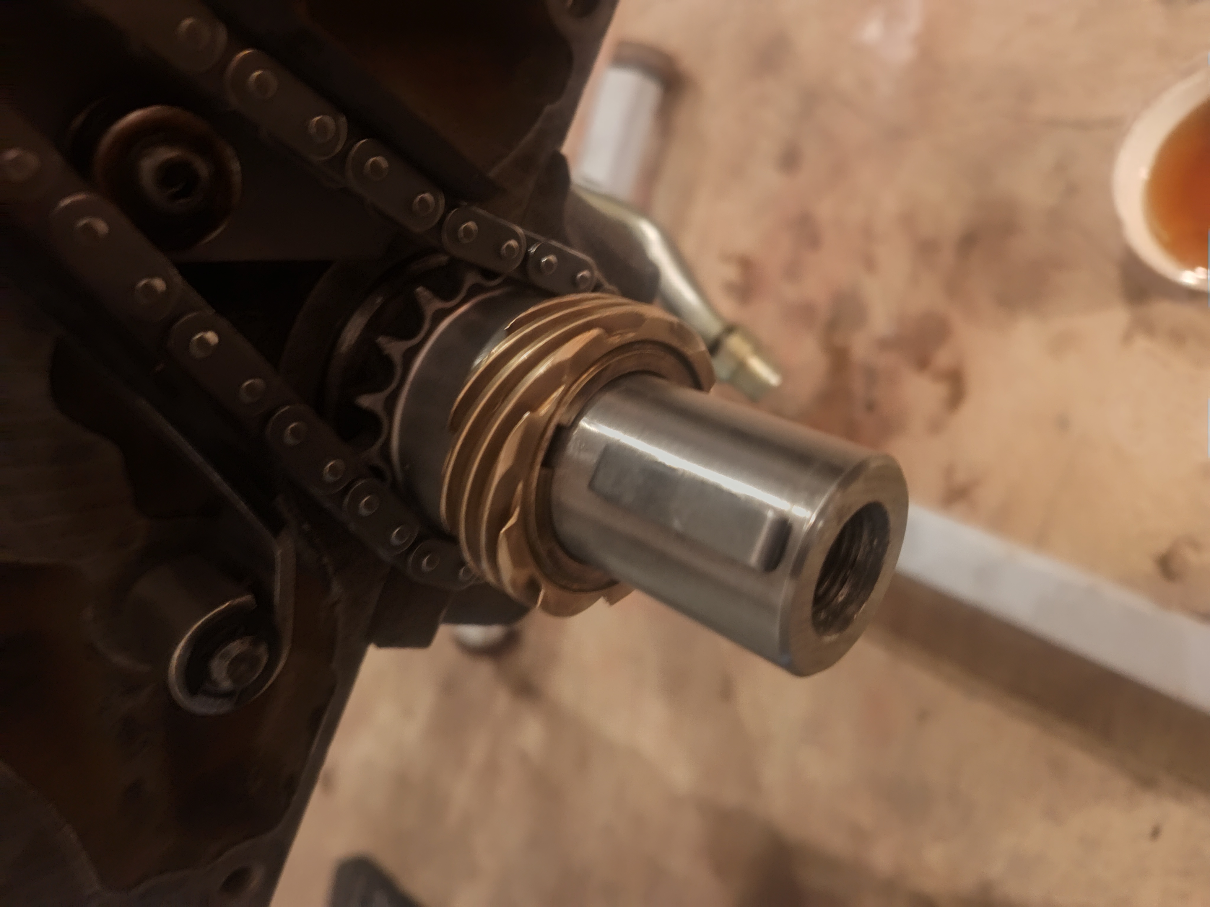

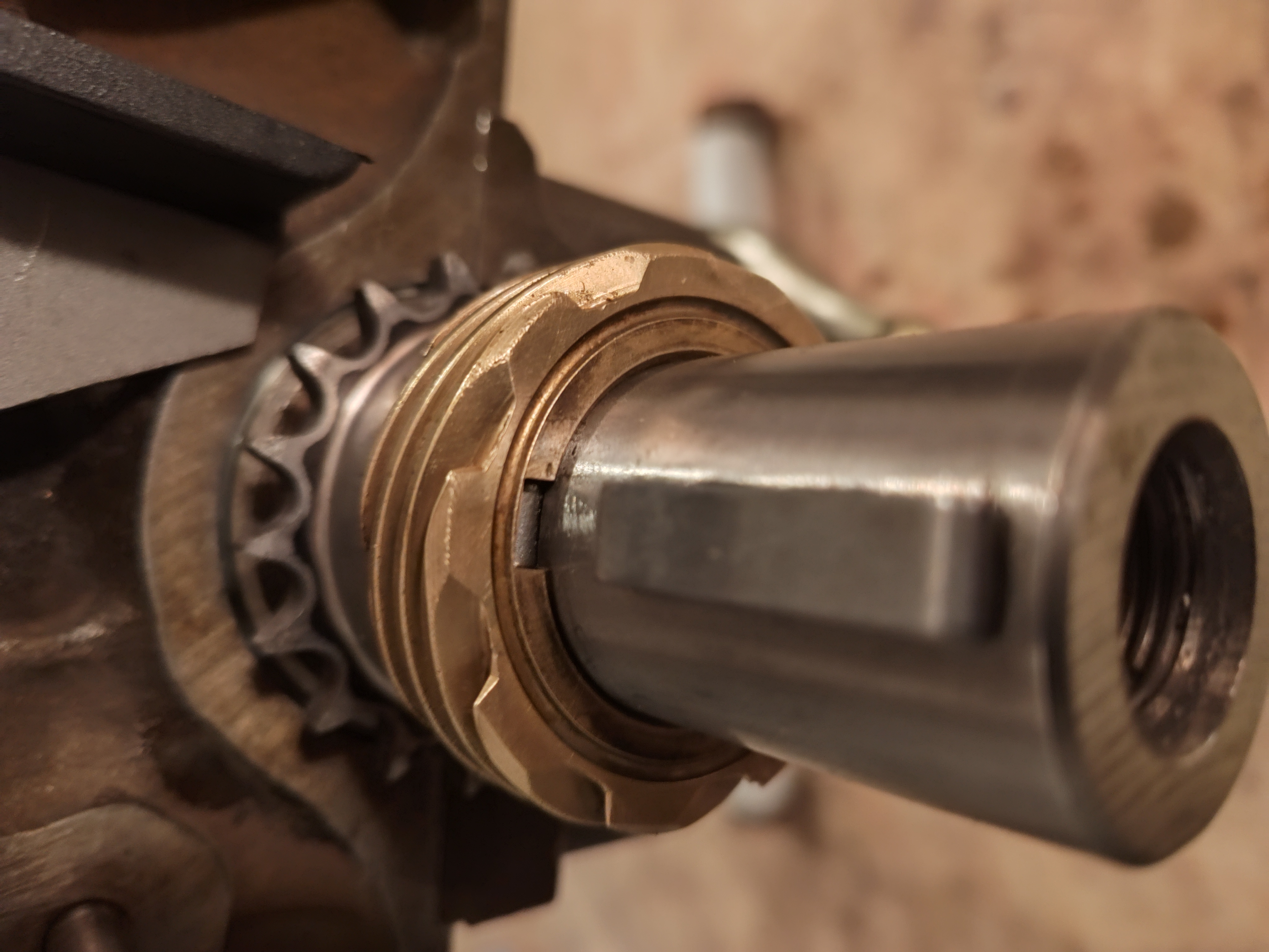

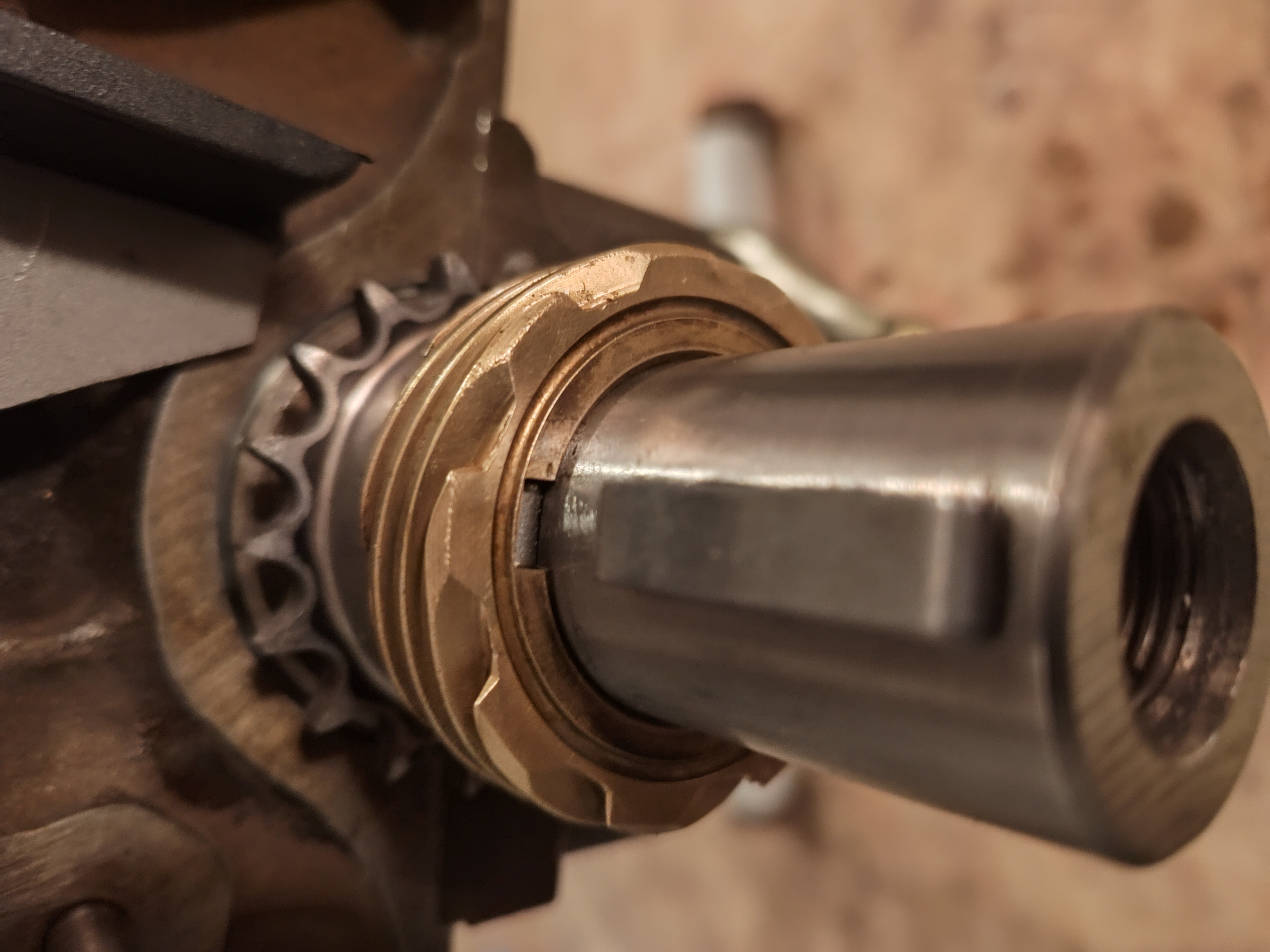

File comment: Crankshaft timing gear sprocket installed, oil pump gear drive installed

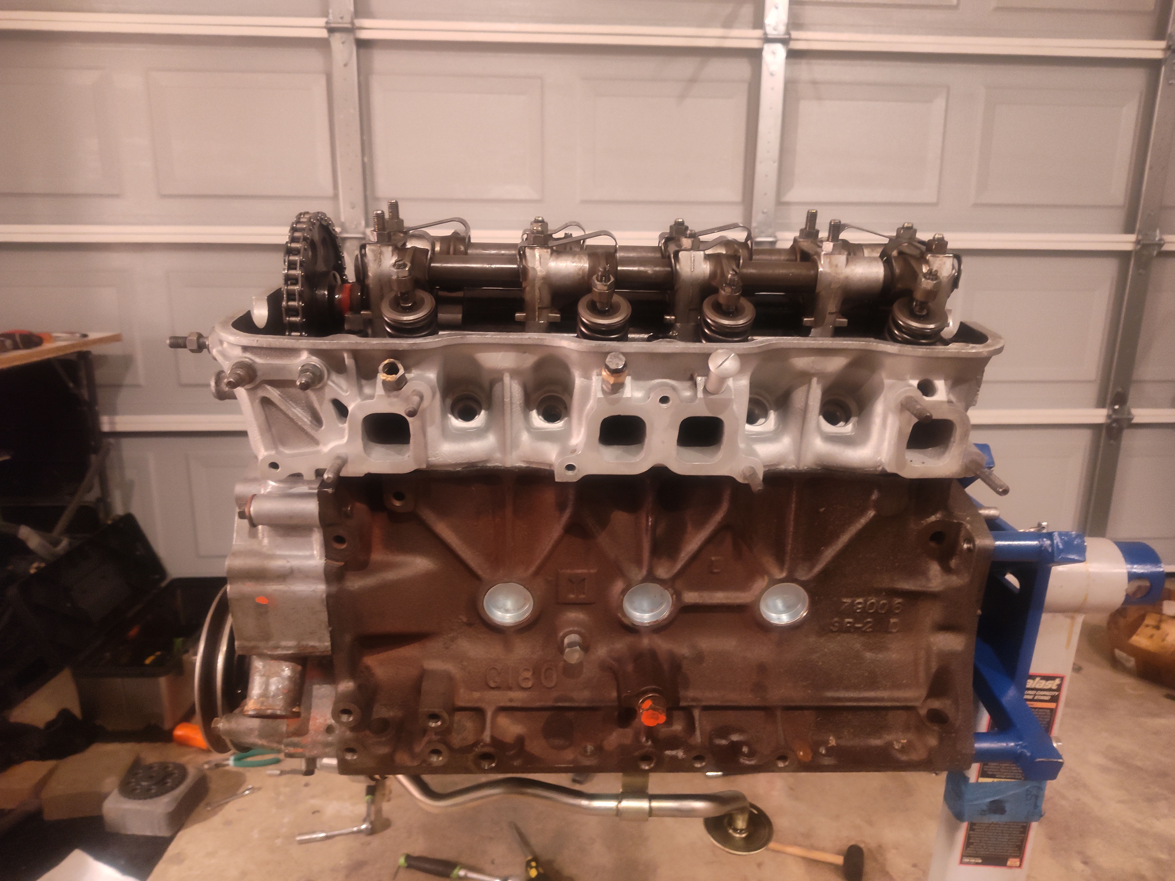

Continuation of rebuild.

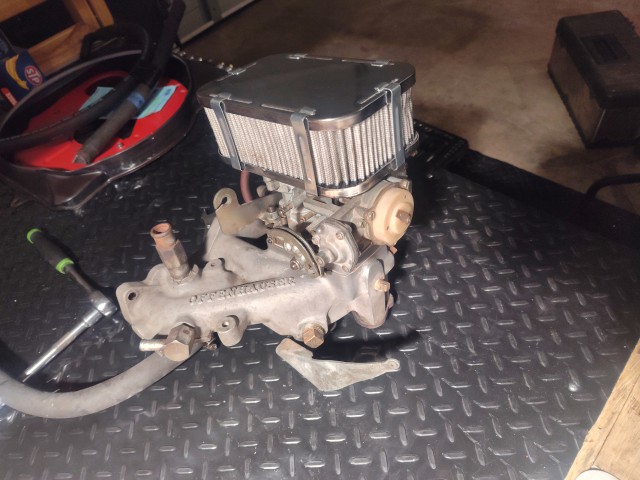

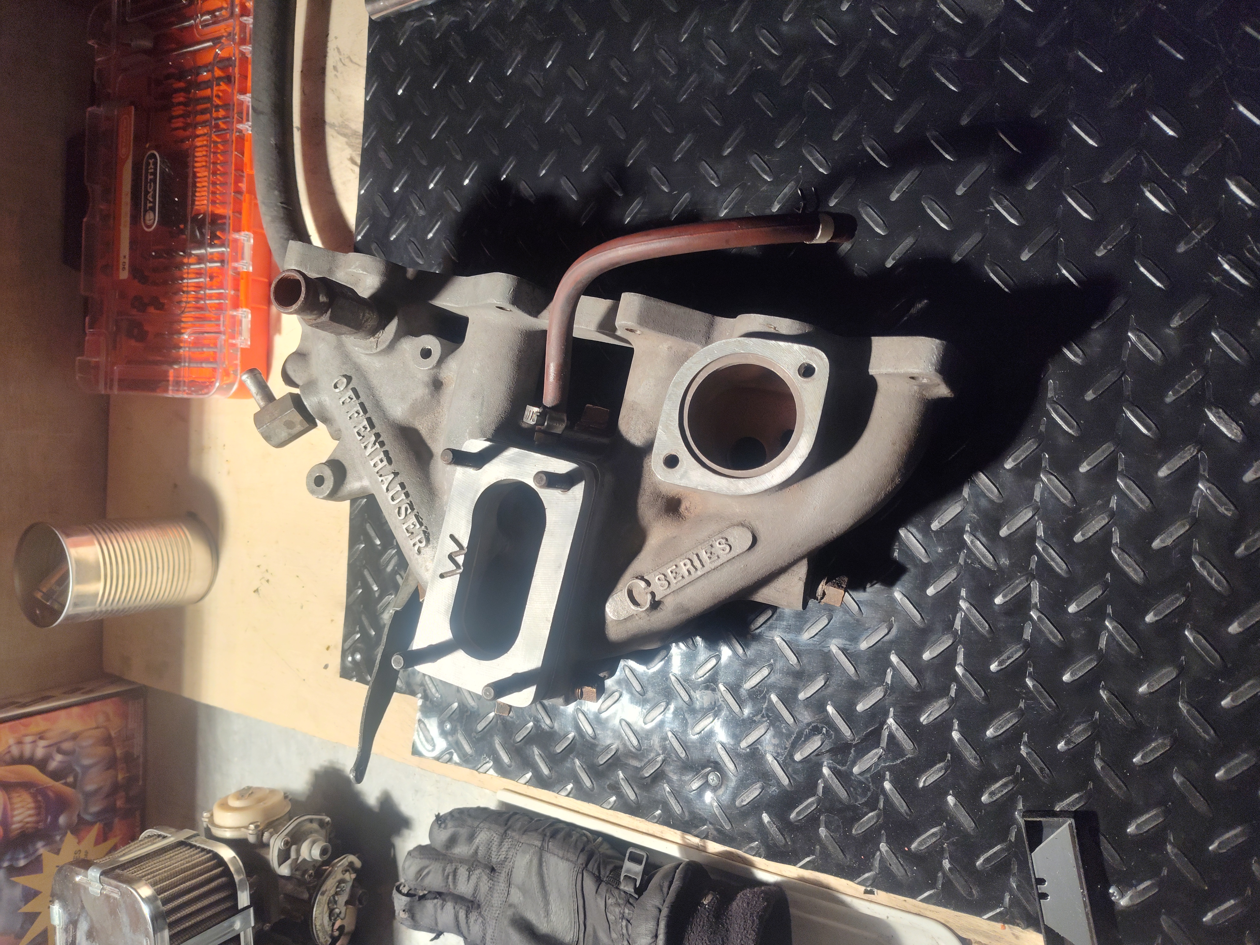

File comment: Offenhauser intake cleaned up inside and out.
File comment: Meticulously cleaned Weber 32/36 and put on new gaskets.

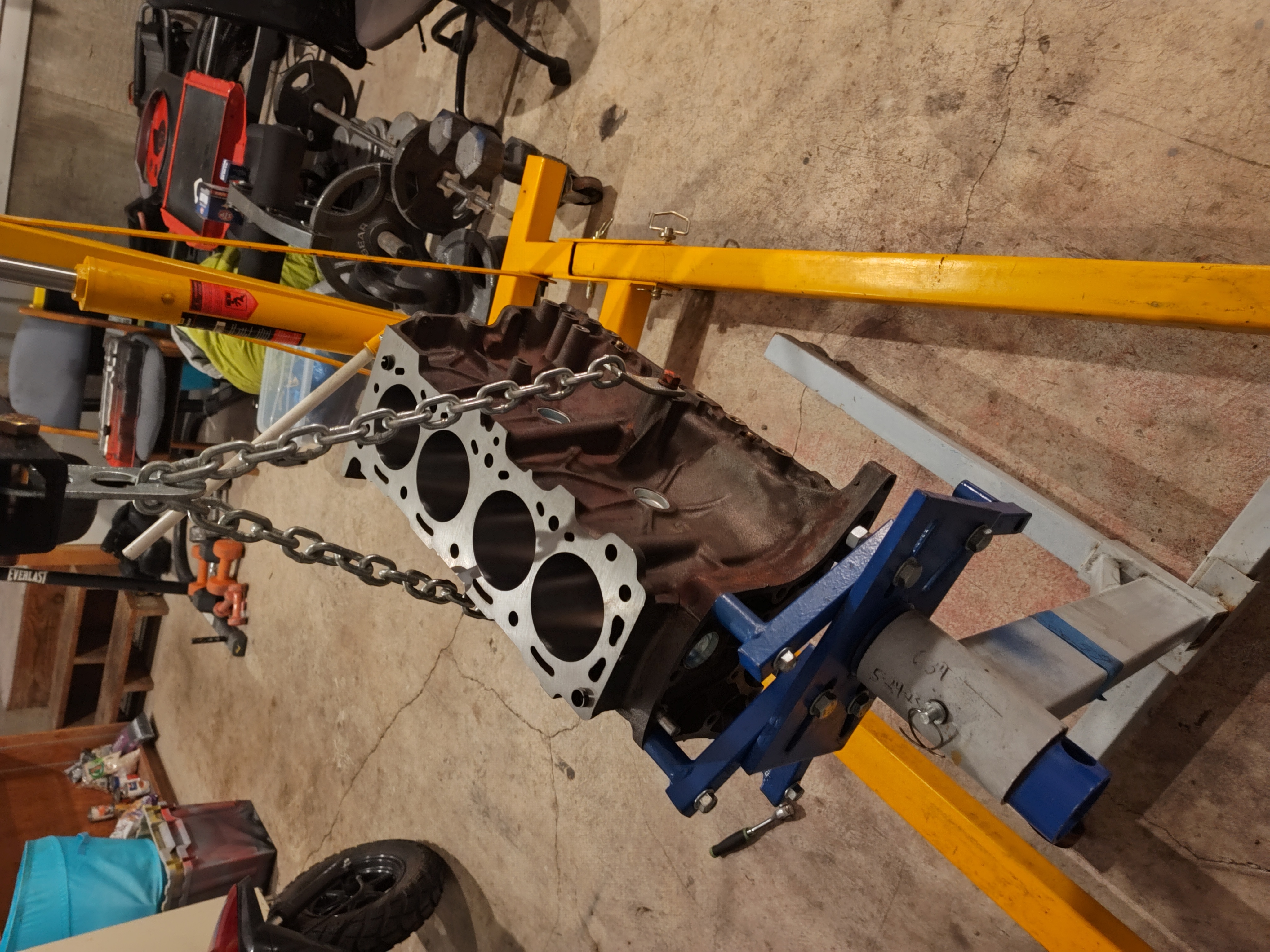

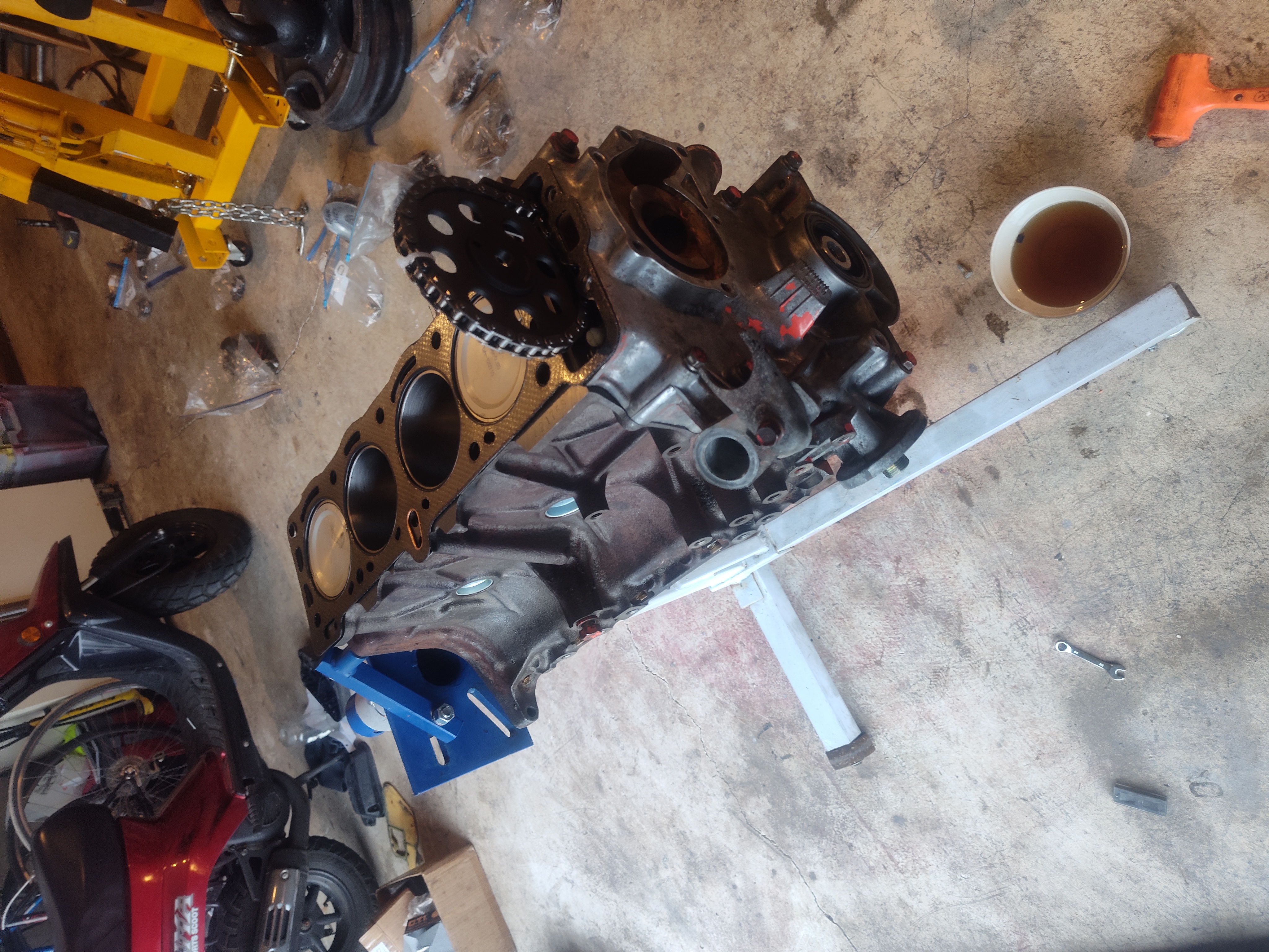

File comment: Resurfaced Block on stand.

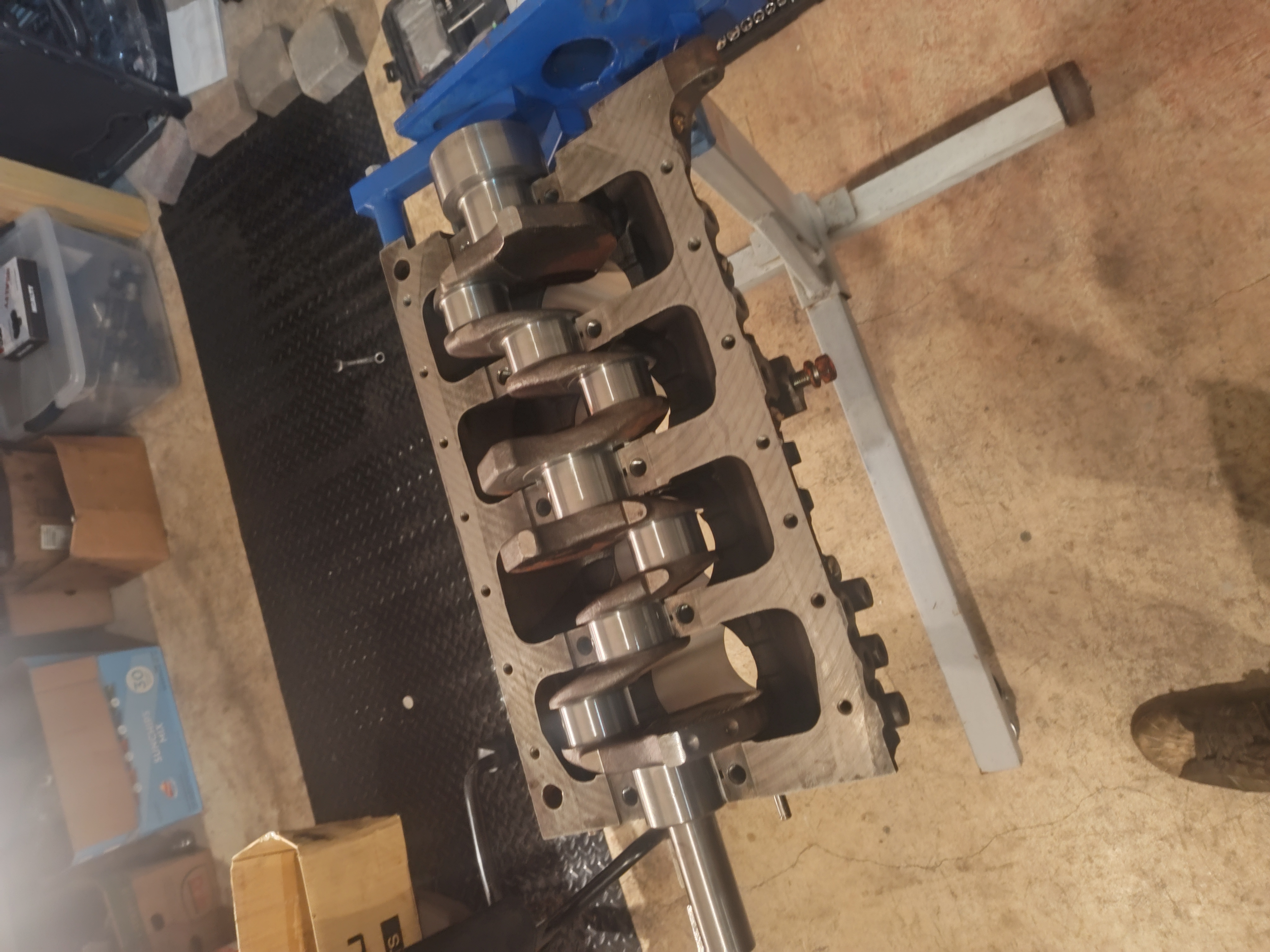

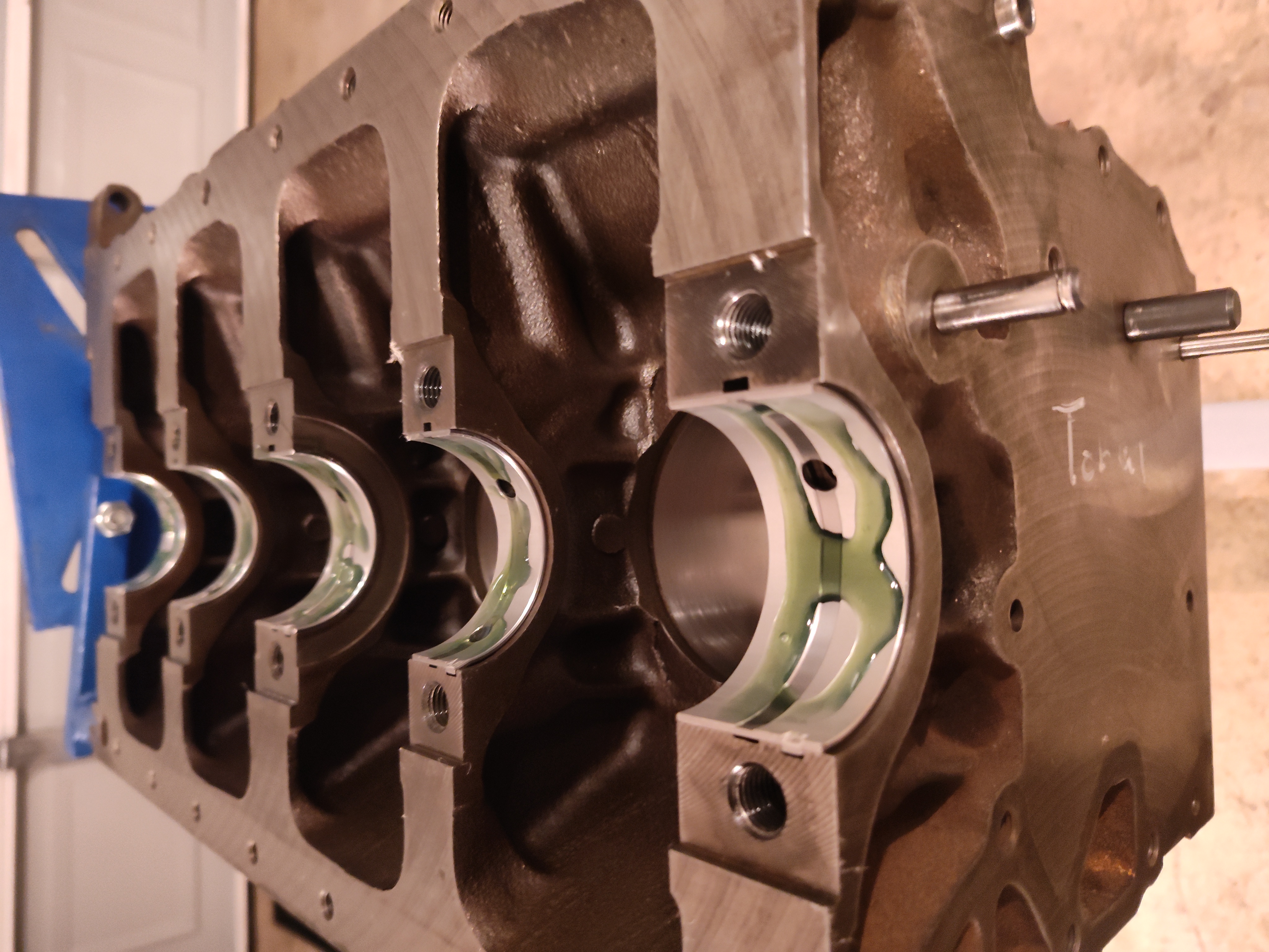

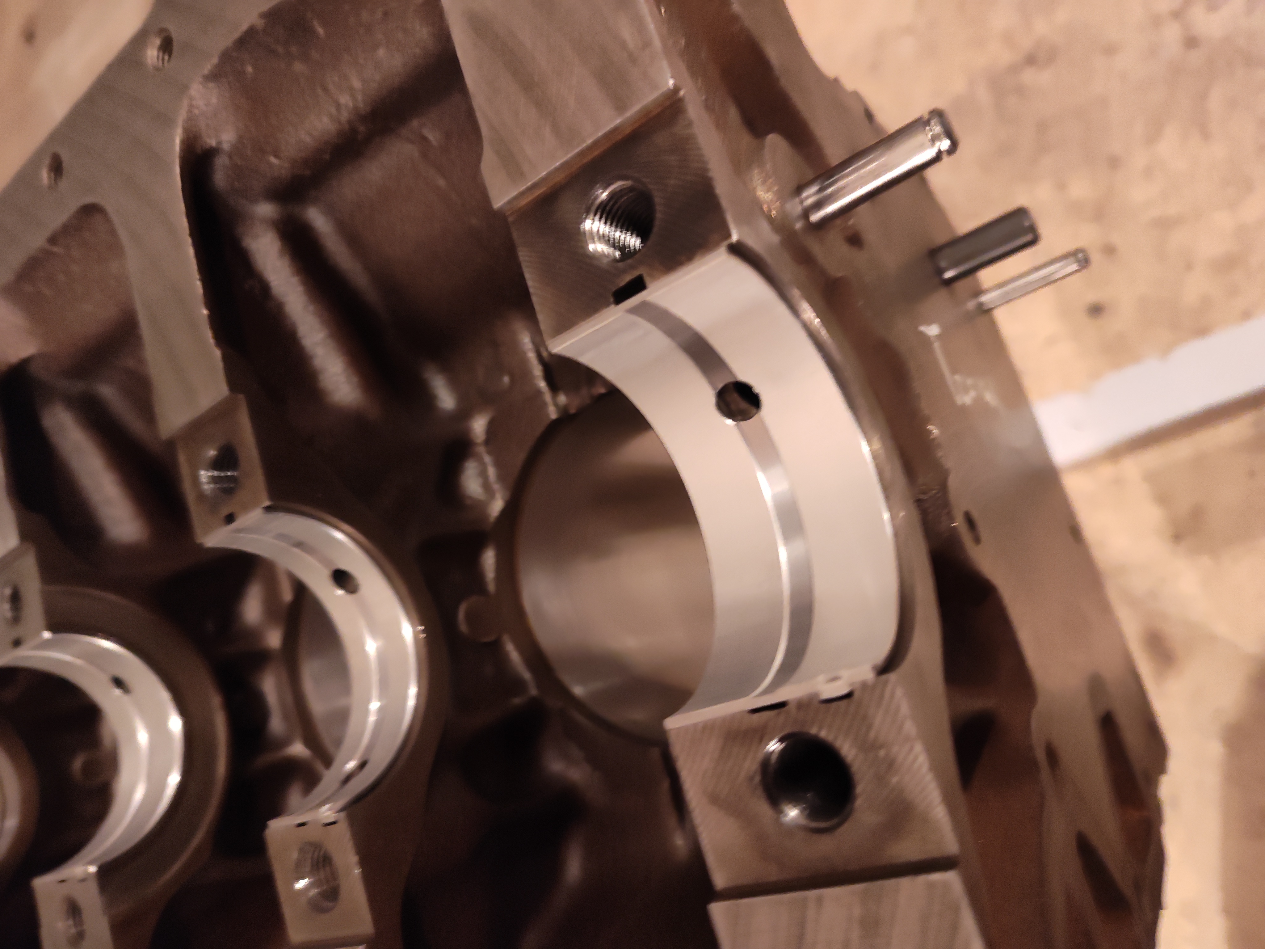

File comment: These are 25 under main bearings lubed up with Lucas brand assembly lube.
File comment: Crankshaft that I had ground at eastco resting in place.

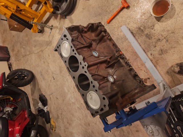

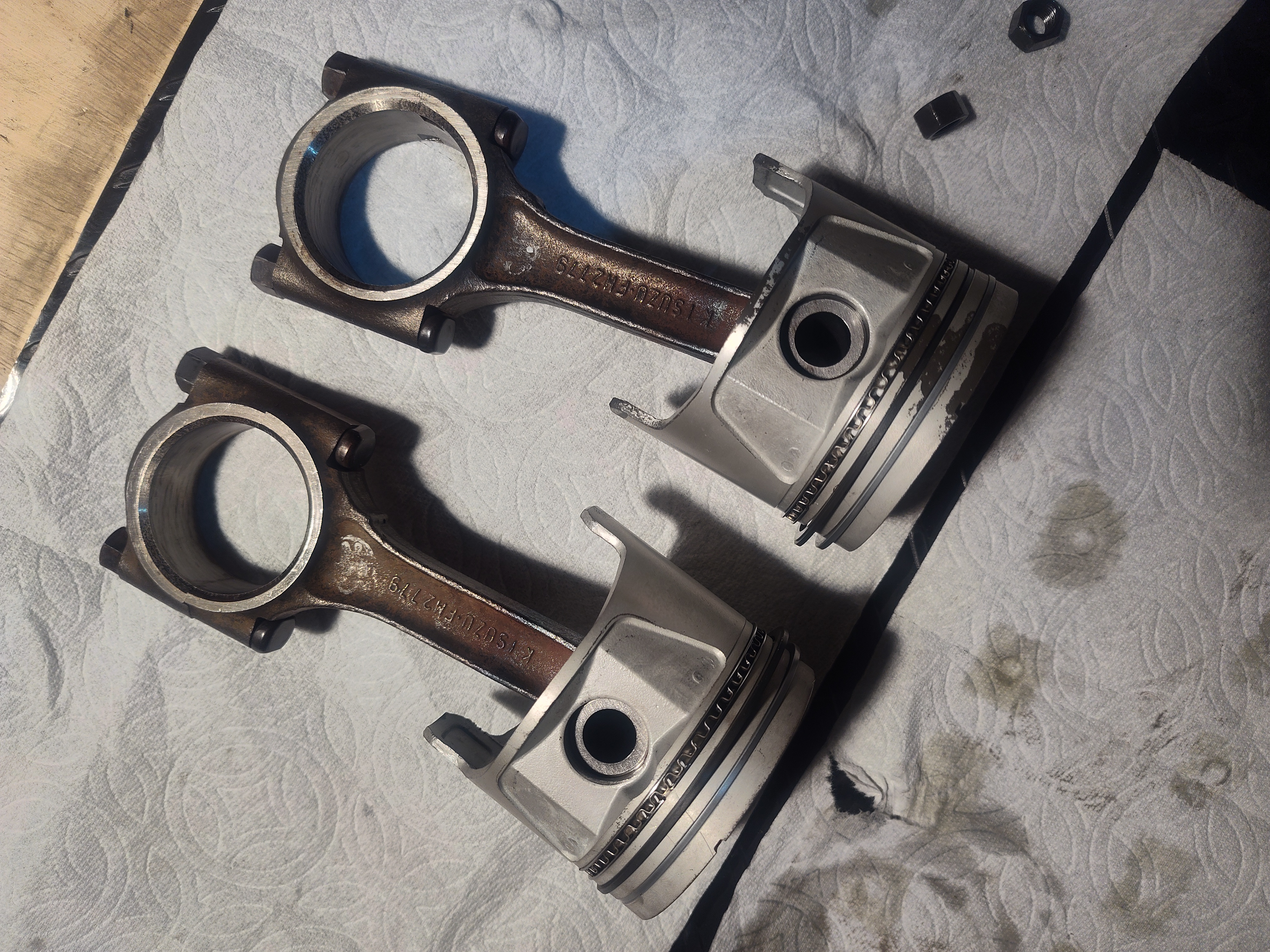

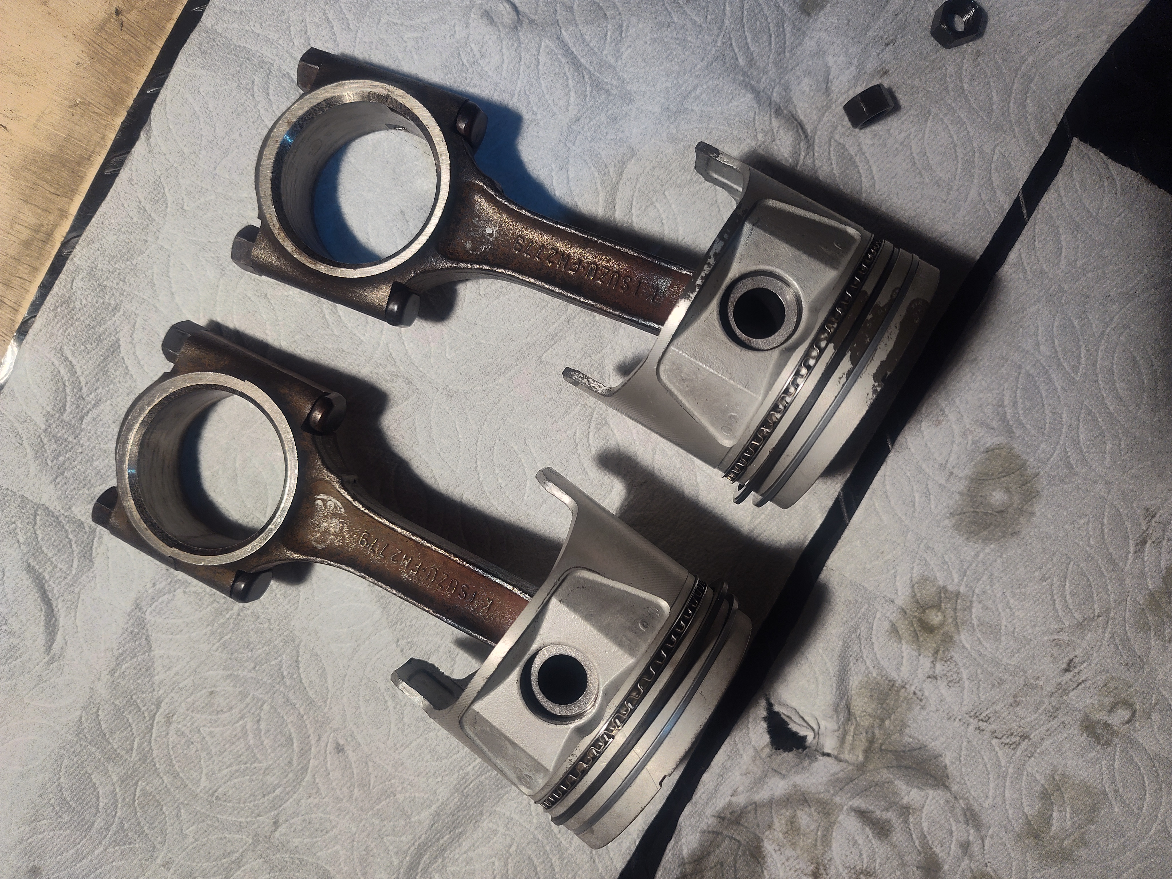

File comment: Piston rings installed 1st, 2nd and oil groves. One of my 4 manuals describes and instructs you to position the gaps in the rings at staggered positions so as to not have a straight gap going from top to bottom between your rings. I did that. I also dipped the tops of the pistons with rings I stalled I to motor oil to aid in the fitting of them into the cylinders.
File comment: 20 over pistons at TDC

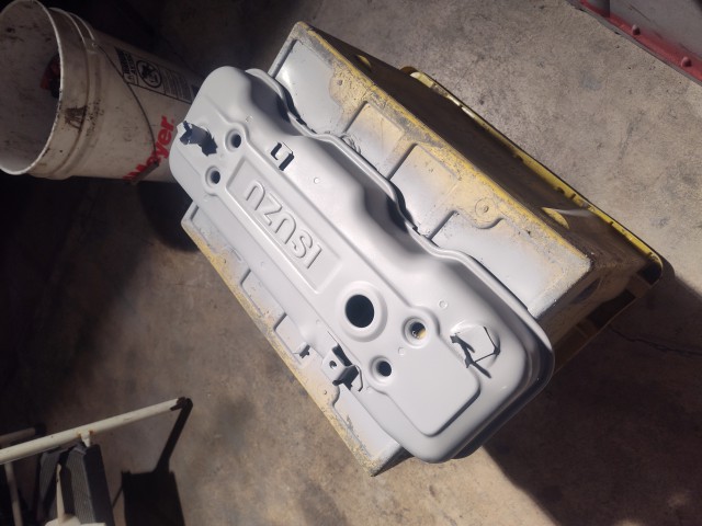

File comment: Valve cover prepped/primed

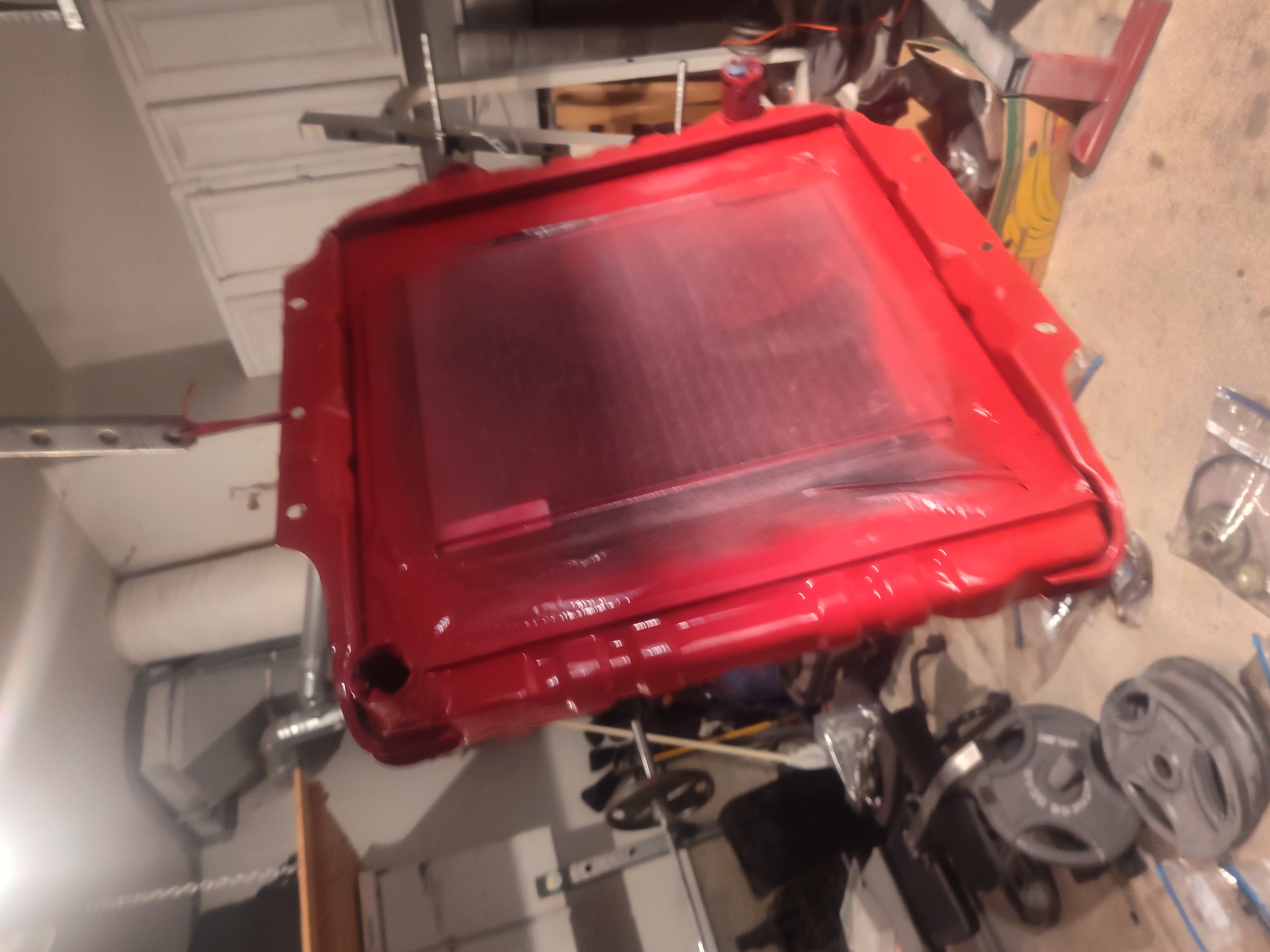

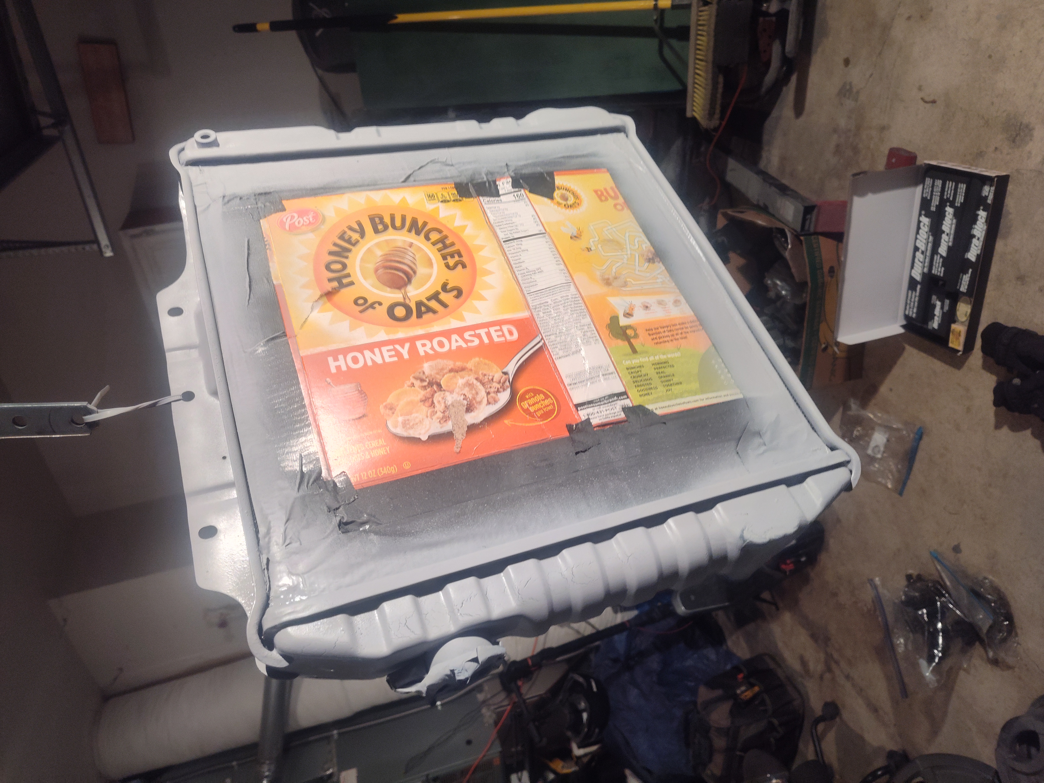

File comment: Radiator prepped, primed.

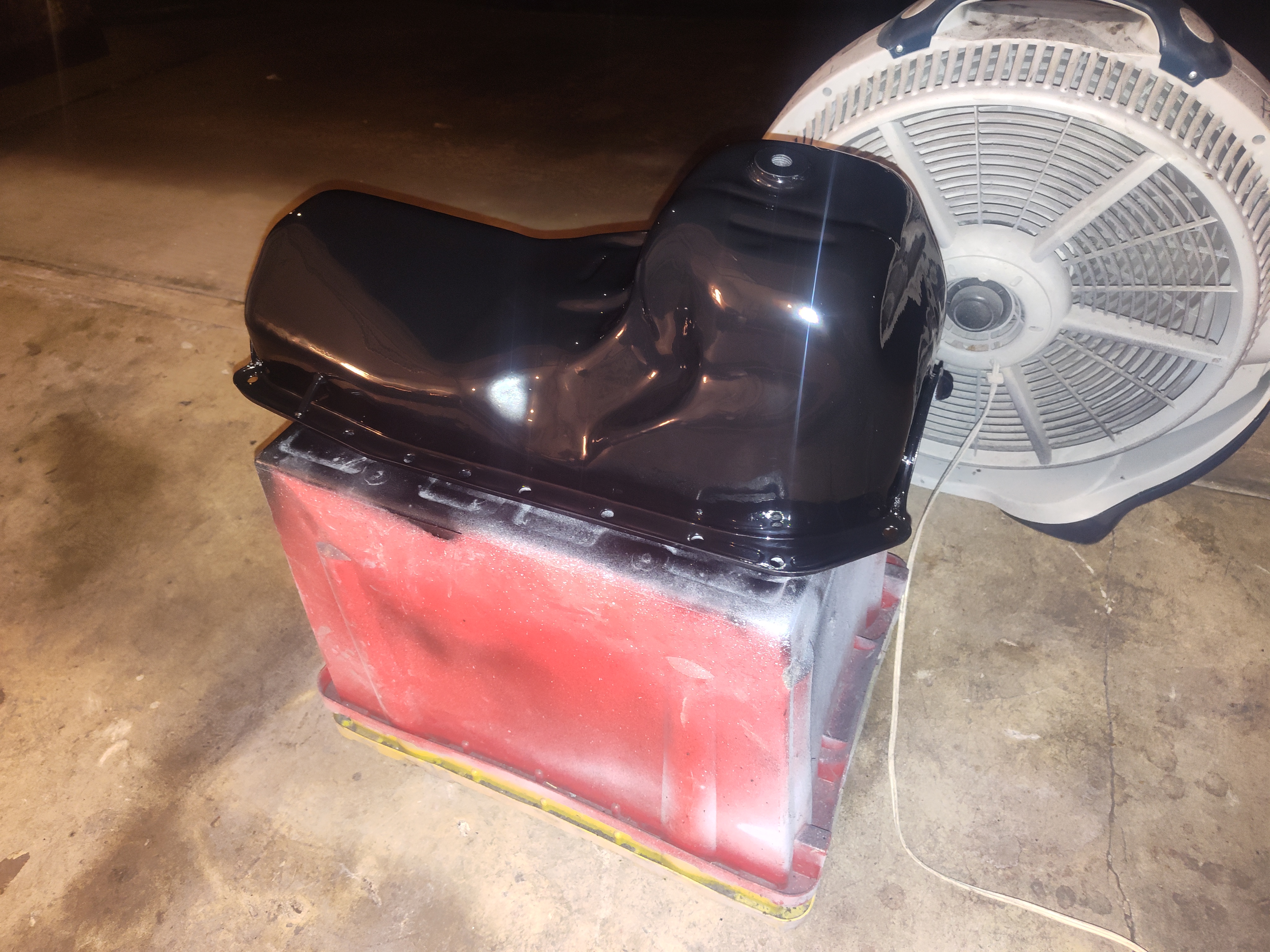

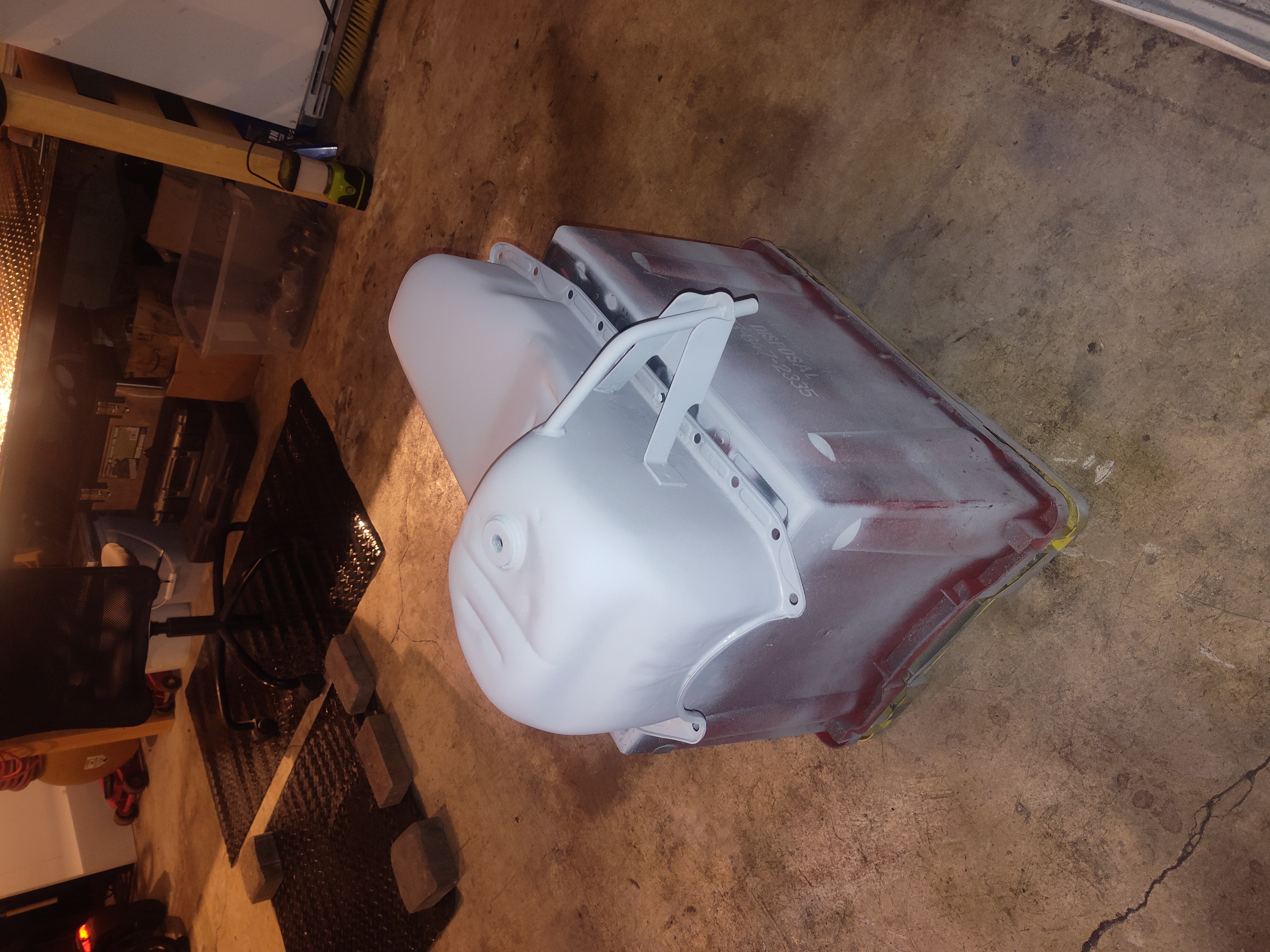

File comment: Oil pan sanded/wire brushed to bare metal. Primed and painted.

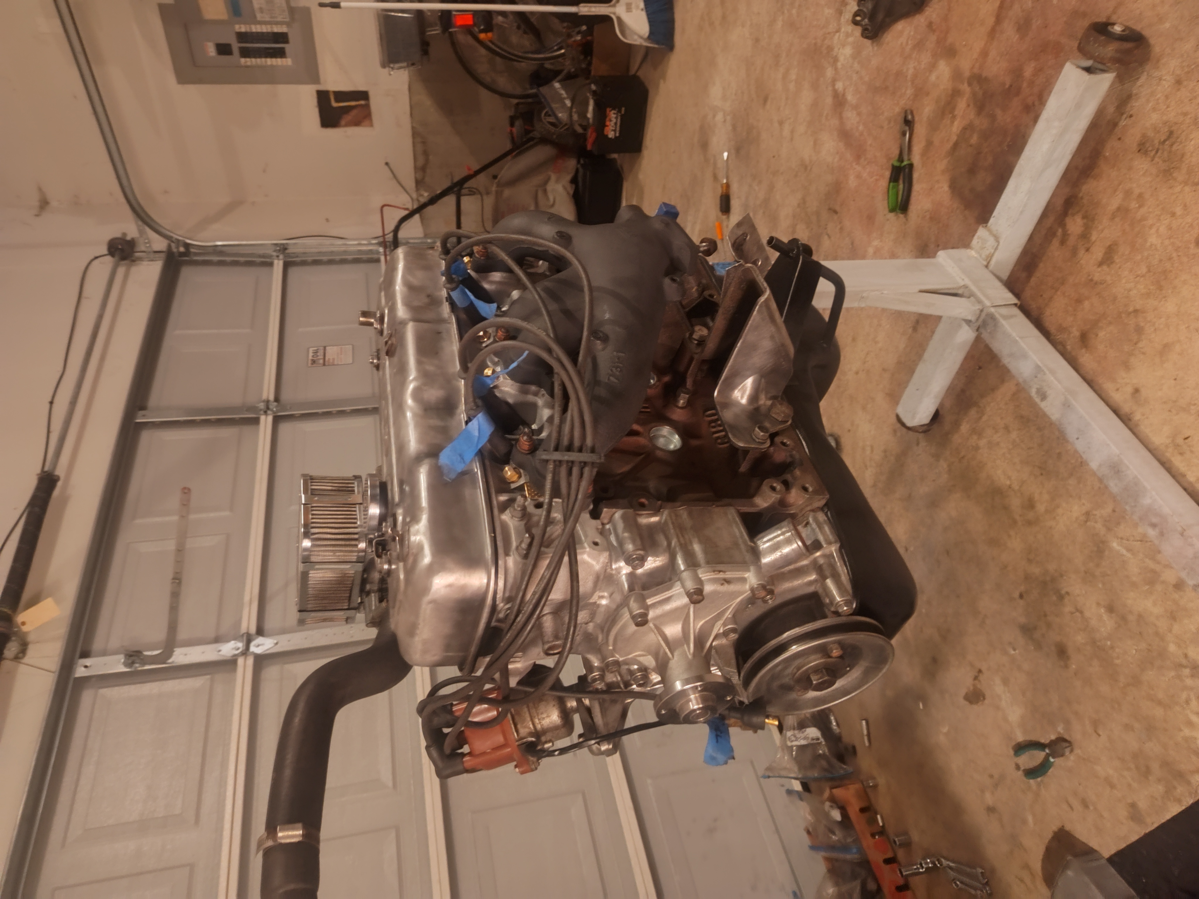

Nice work. Is it up and running yet?
PostPosted: Tue Jan 30, 2024 2:48 pm
Posts: 114
Location: Portland, OR

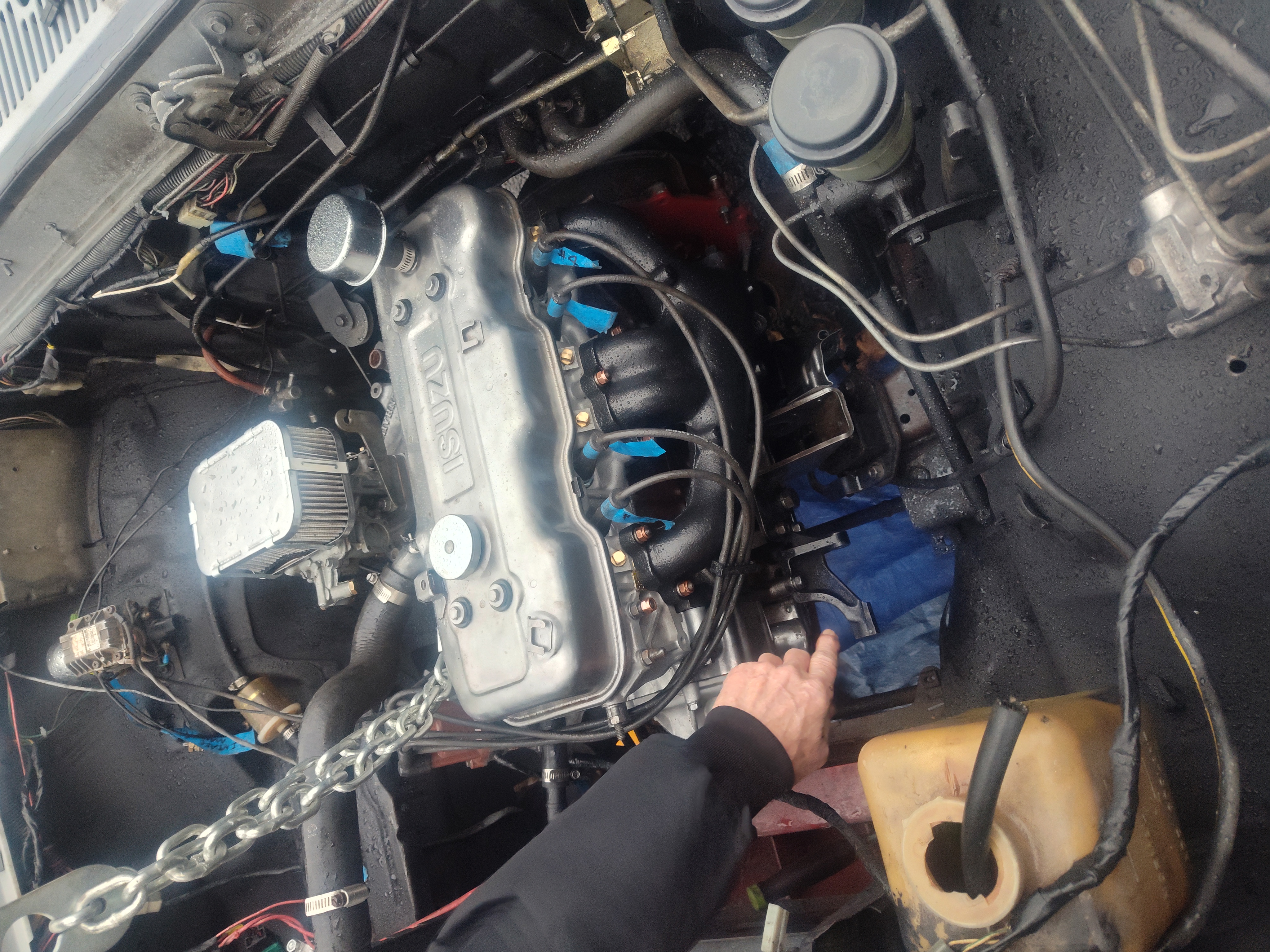

Yep, it's been up and running for about a month now. runs strong and smooth. I got a new Weber on its way cause the one I have on it has worn out components and the throttle plate gets stuck when returning to idle, I have tovfeatger and blip the gas pedal to get it back to idle. Also the idle mixture screw does absolutely nothing so I'm opting for a new carb rather than a rebuild. Im now working on a front end rebuild. Installed an idler arm assembly out of an 85' trooper, new upper/lower ball joints, new inner/putter tie-rods, new center-link and boots for my cv axles.
