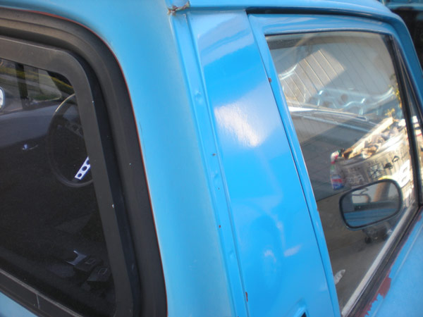

I did a test patch on the cab b-pillar and you have to love single stage paint. You can abuse the hell out of it and with some elbow grease and the right polish it comes back pretty good. I also did the top half of the right front fender with really good results.
