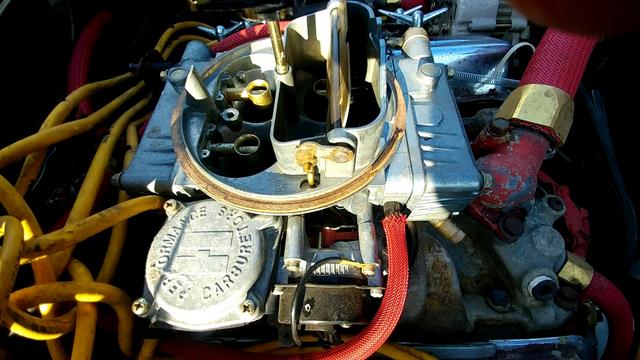

carburetor on the motor
File comment: carb on top

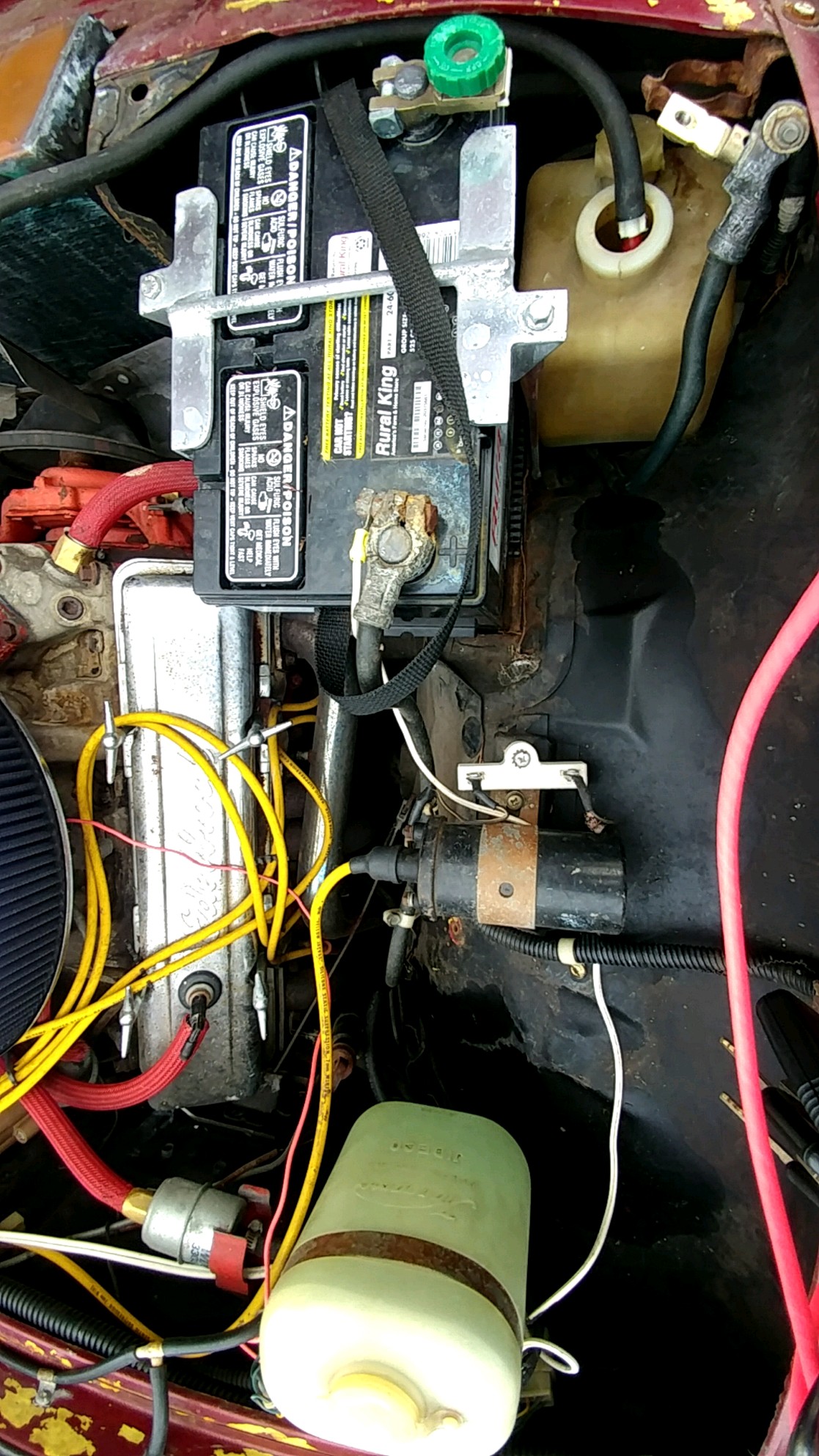

The passenger side of the engine compartment

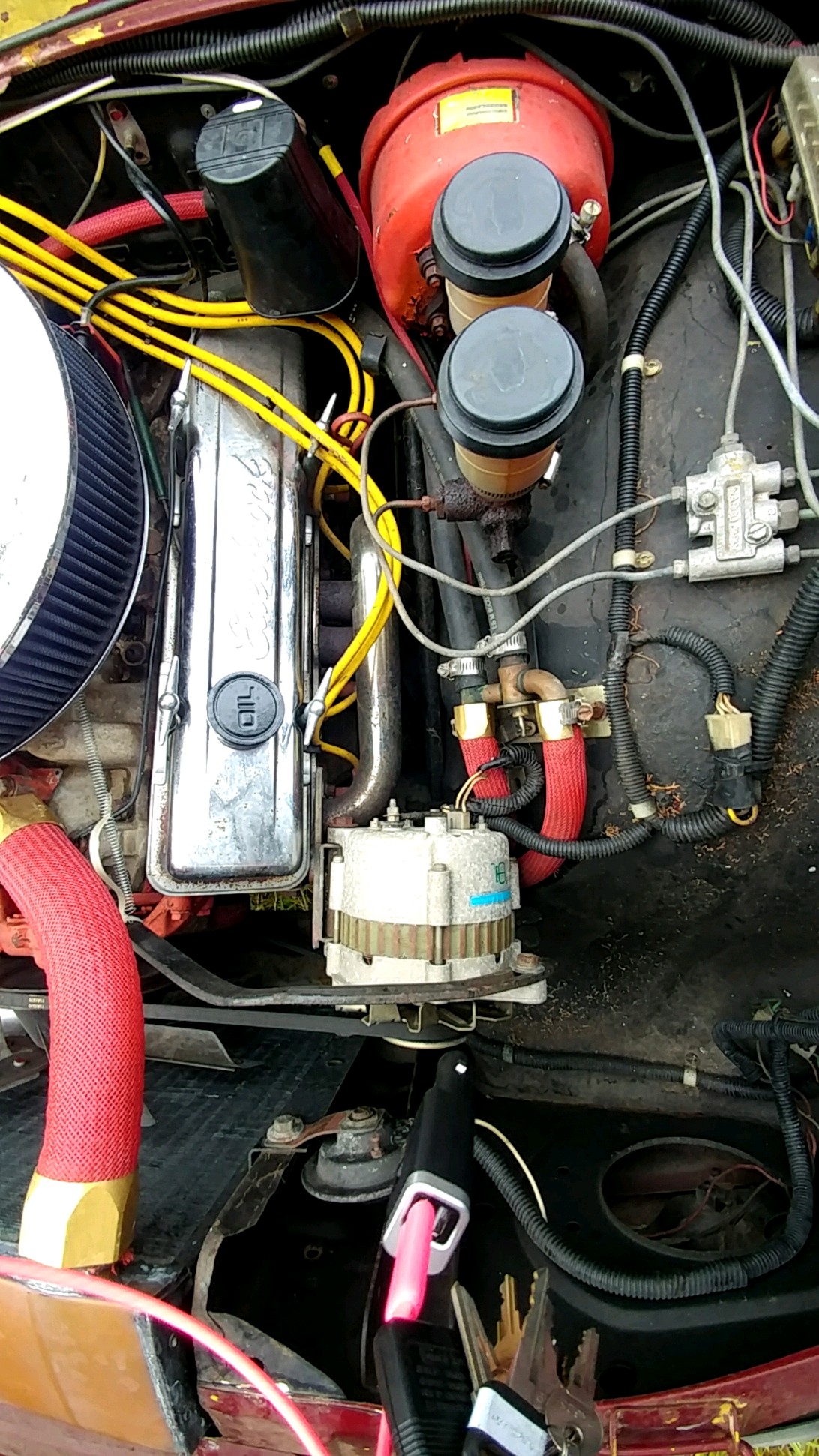

Drivers side of the engine compartment

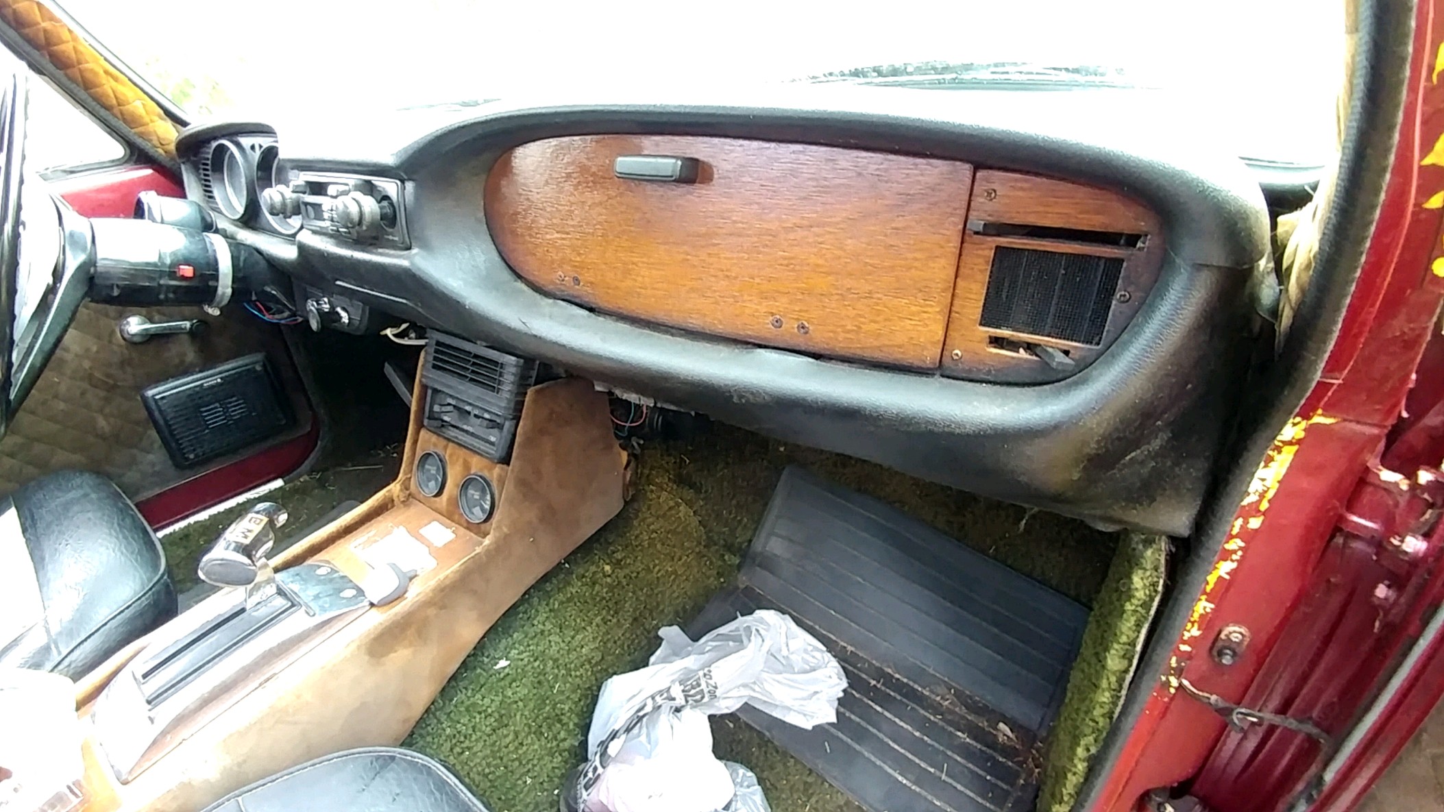

Somebody has made some of the dash parts in wood. this is a shot of the clove box and center councel they made.
File comment: Glove box

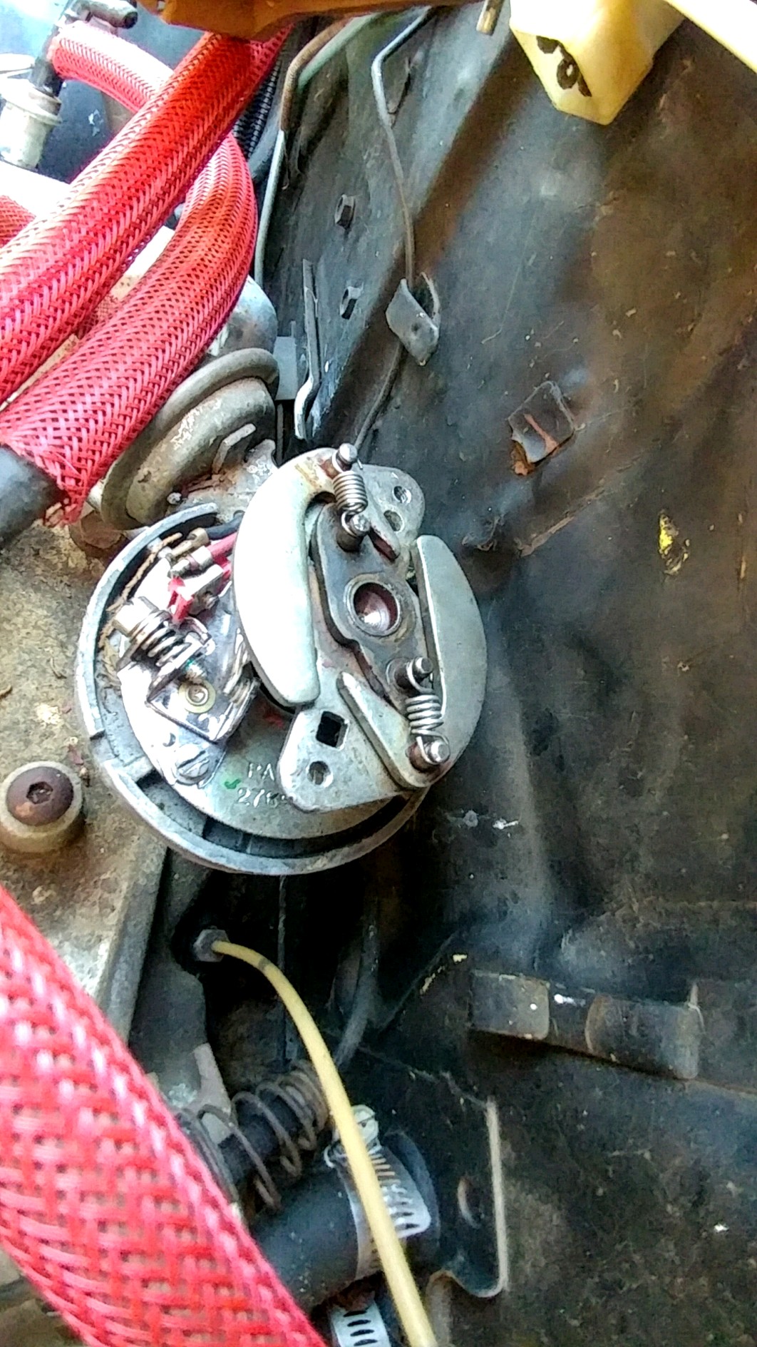

For now it has the old points distributor, I have replace the points with a new set of accel points. this is a shot before replacing the distributor.
File comment: distributor

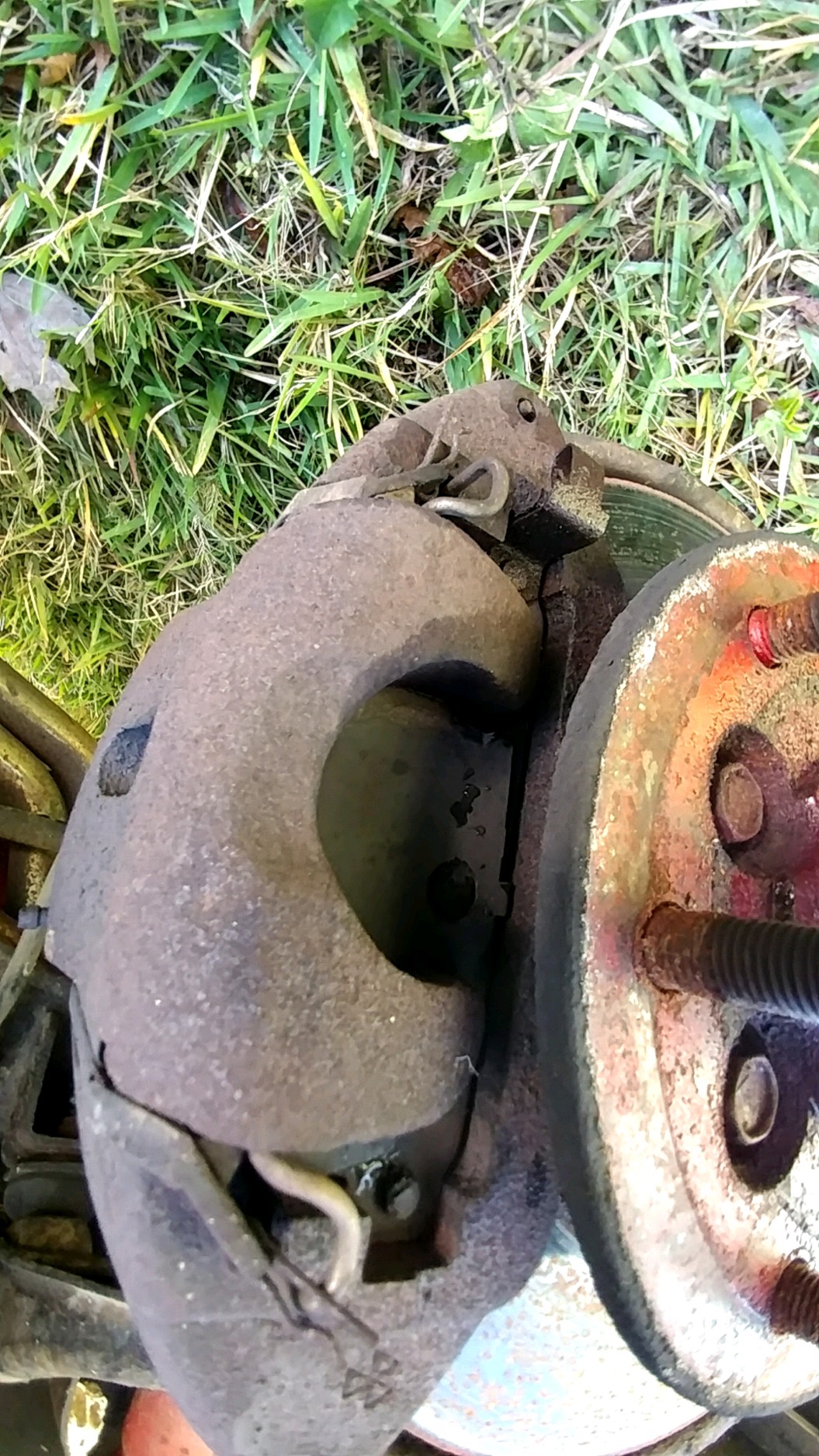

The breaks that are on it, at this time, are from a 1976 Luv according to the numbers on the parts.

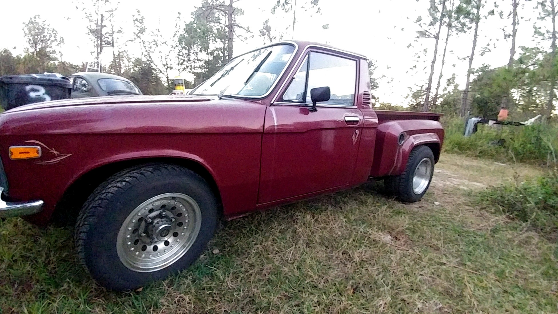

Right now its a twenty footer. It looks great from twenty feet away lol
File comment: passengers side

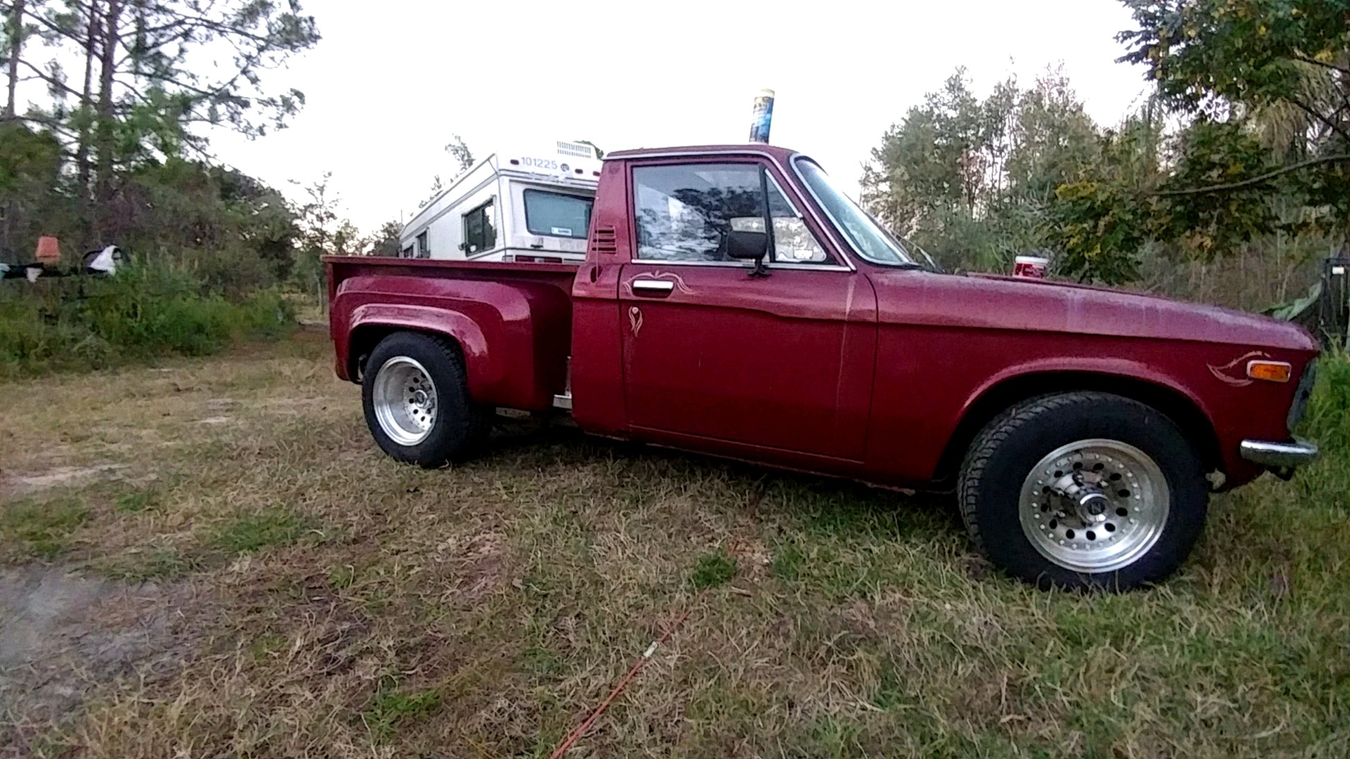

the drivers side..
File comment: drivers side

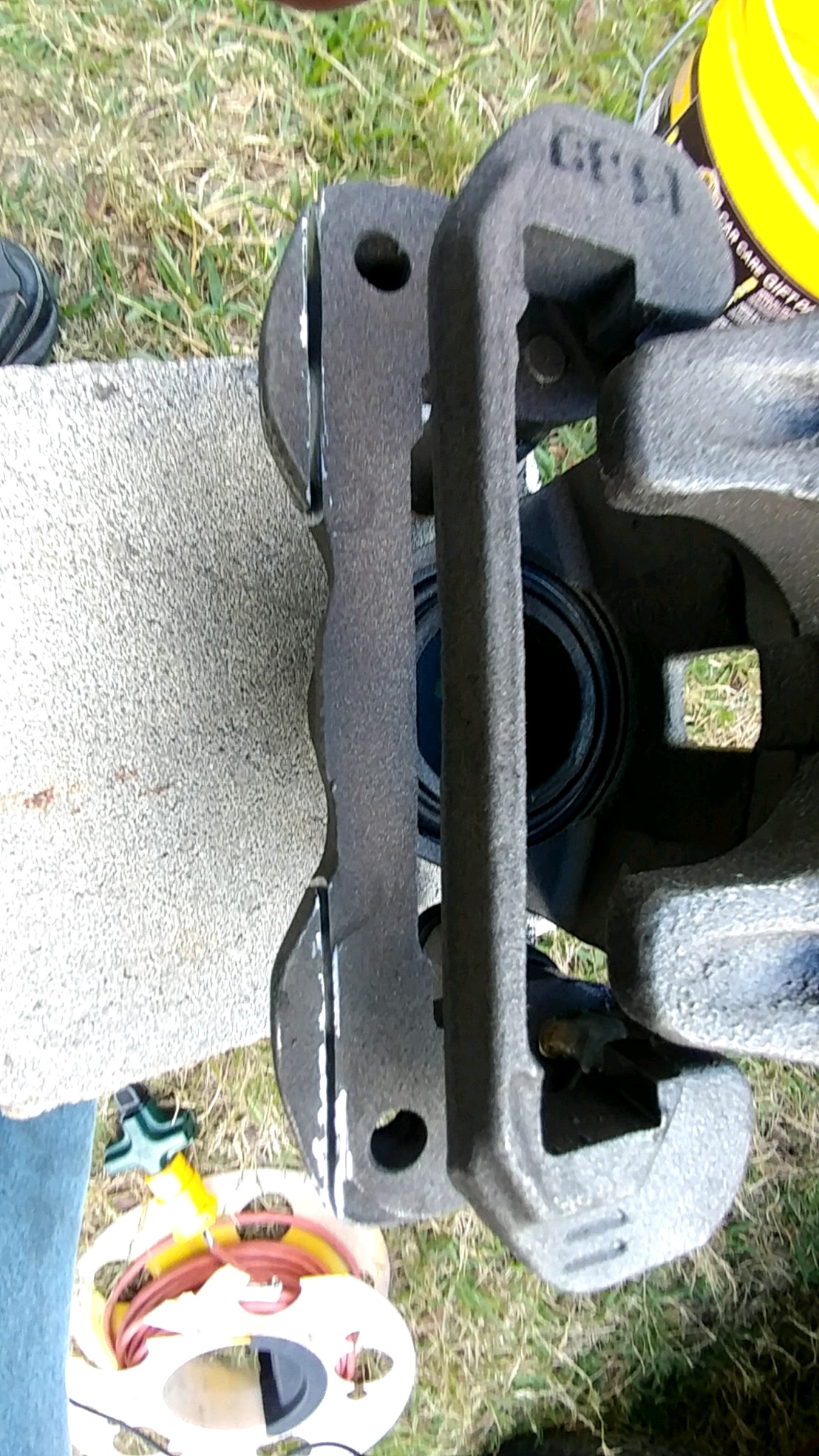

The caliper started like this.

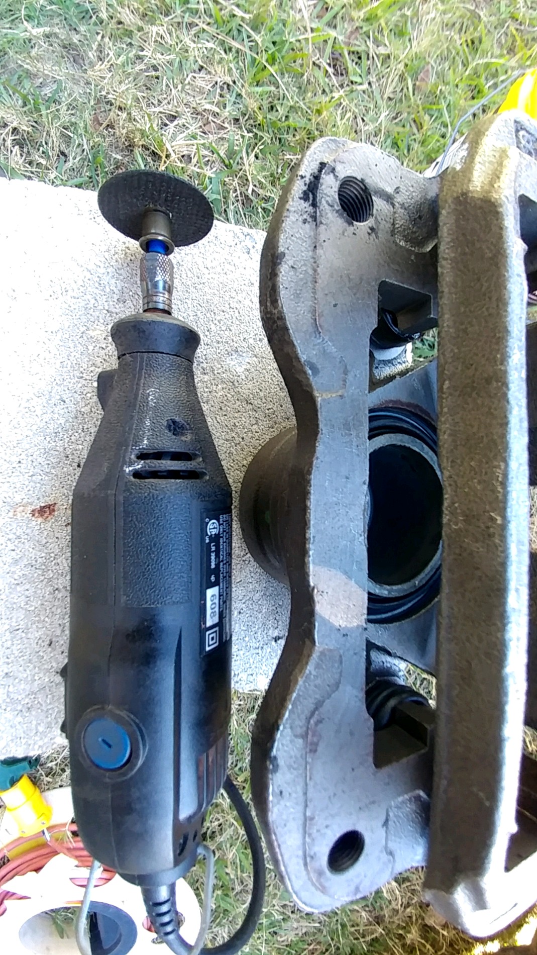

I cut this part off..

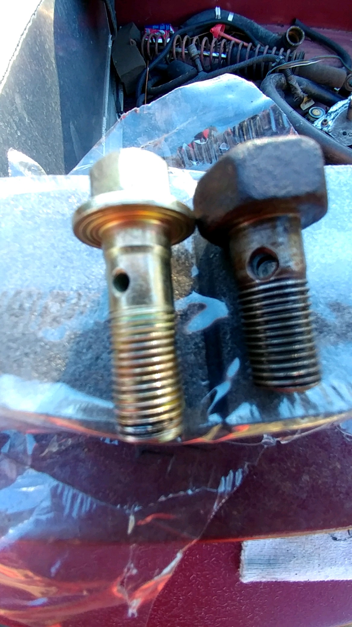

You need to use the bolt from the old caliper, as the one that comes with the 1982 Isuzu one is longer, and has a smaller hole then the one for the Chevy luv.
File comment: banjo bolt

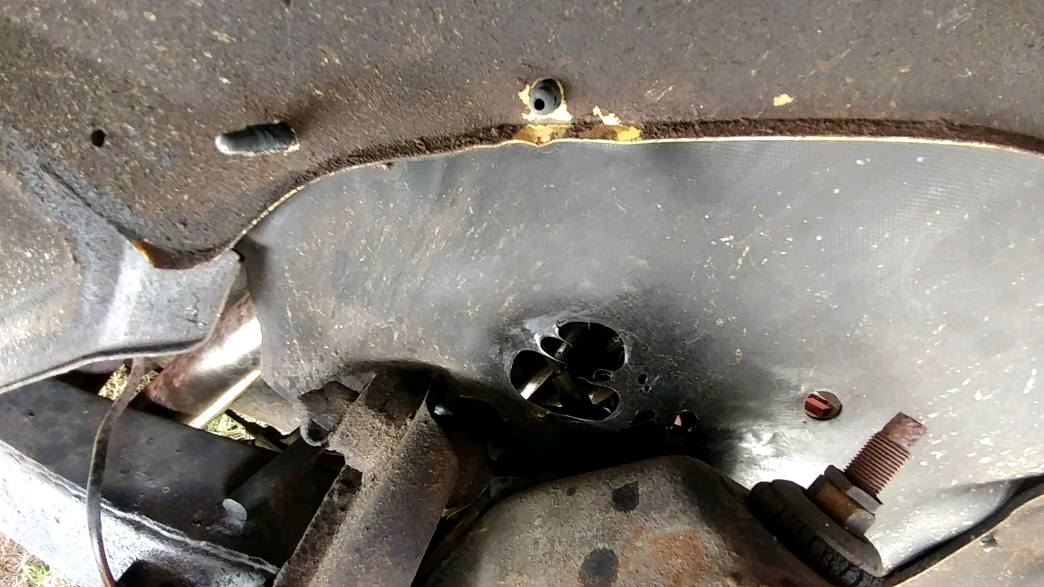

I went to work on the passenger side breaks, and noticed the mud control flap on the inner fender was melted. I am guessing it gets a little hot down there.
