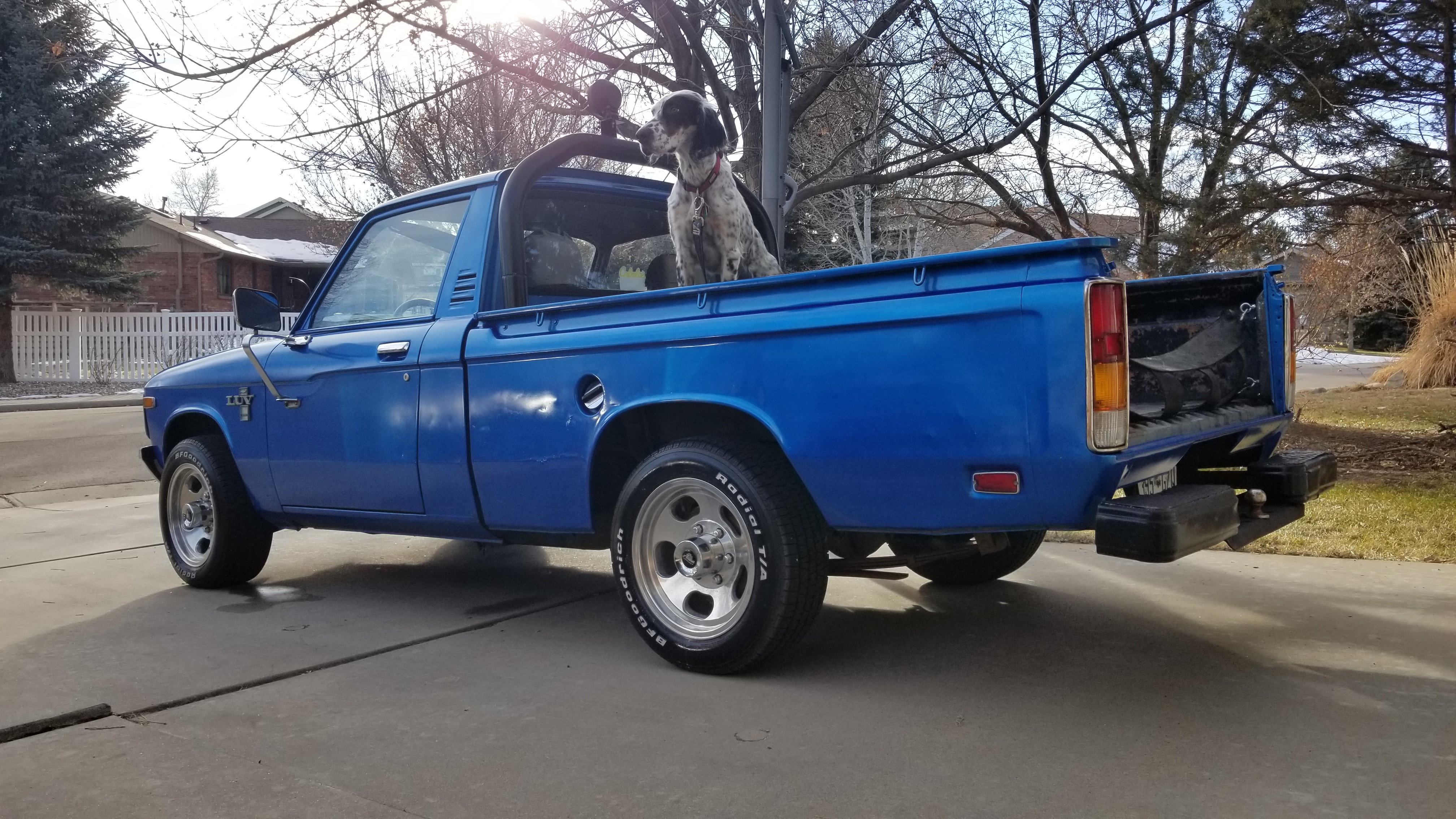

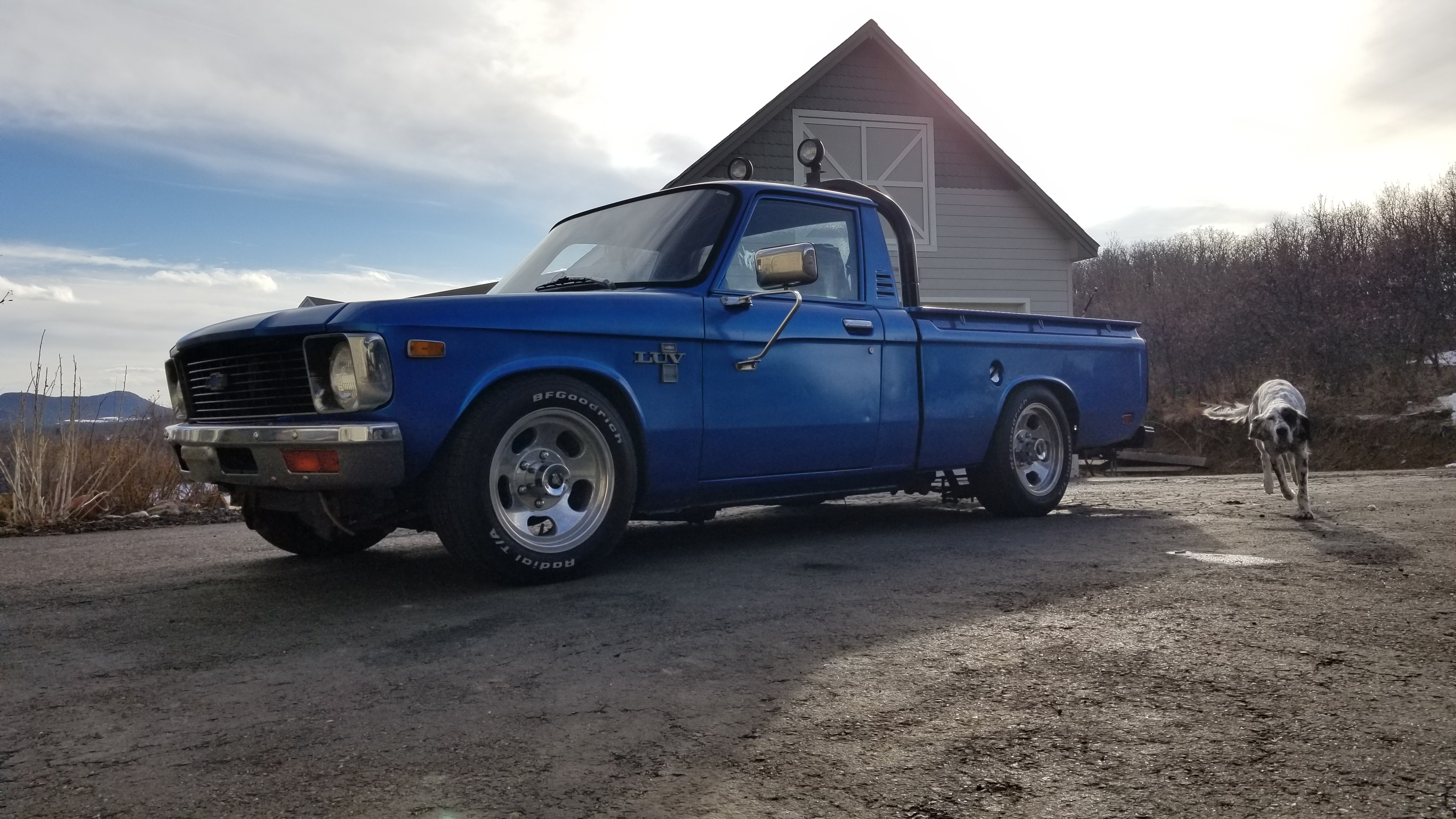

Slowly settling in on a theme for my LUV and it's looking to be a bit of a retro-pop modern style build. Touchscreen and all.
Gonna reserve a few posts below for major progress updates and the like, until then here are your before pictures... (Interior to be added)

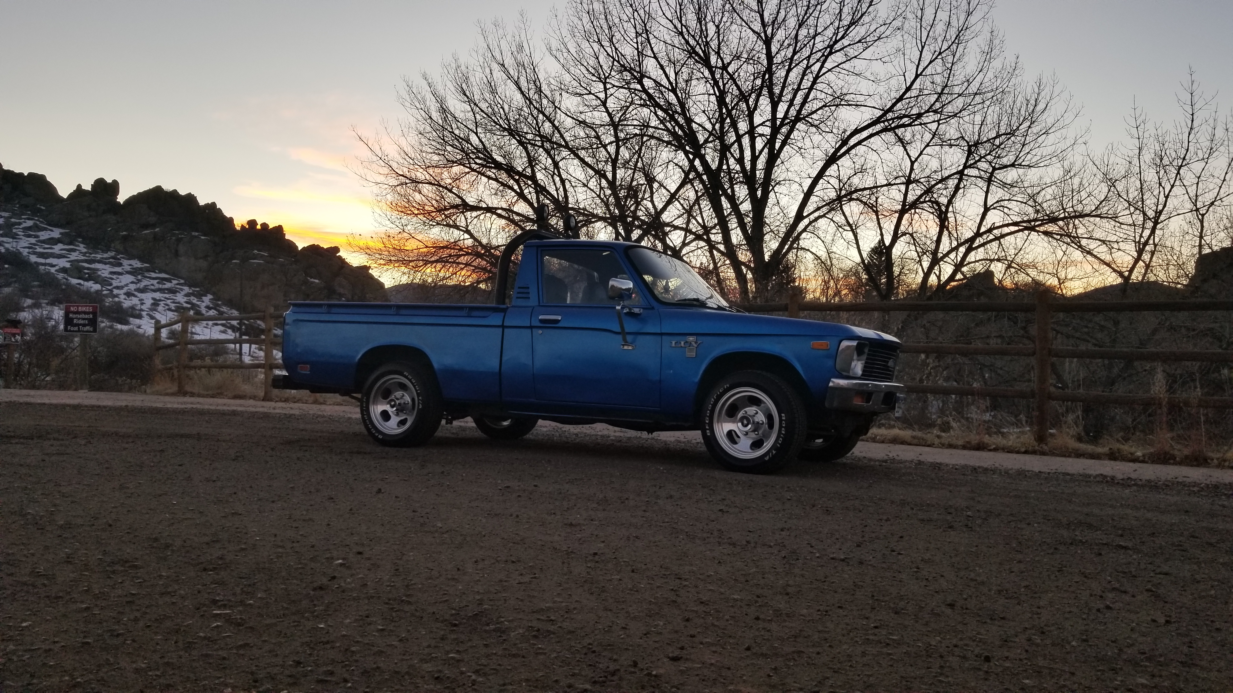

Anyways, adding some interior "before" shots. Main notes in here; 1) Seats are worn to the bone, going to look at replacing them with thin 1 piece buckets (hoping to gain that extra 1" of leg room). 2) current gauge setup is super clunky, plus of the stock gauges the speedo is way high, fuel gauge is pretty much useless (might be the level sensor here? Shows full until you burn about 3-4 gallons then swings wildly about for about a gallon before resting on empty. Oh and stock temp gauge doesn't work but aftermarket one does; I'm guessing the prev owner swapped the wiring). 3) Stock shifter leaves a lot to be desired in both style and feel (actual trans engagement feels nice and notchy but the neutral engagement & precision is just off. Might just need bushings somewhere?). Would like to go lightly weighted here in the future (I'm guessing the shift lever is fairly standard?)
Also a couple challenge goals I want to try and work out while going through the build + minor updates
- Goal 1: (Post EFI) Get cruise control working (either custom dev. or included functionality in the EFI ECU)
- Goal 2a: Install an integrated dash & backup camera. Integrate video feedback into PI dash
- Goal 2b: Develop a basic forward collision/lane departure logic into the PI dash (lot of open source SW to start with, final integration is gonna be tough)
Some progress;
- Lowering blocks have been ordered; went with 4" blocks w/ a 3° pitch correction. Hopefully those work nicely, should be coming in this week or next
- Found a nice source of info for getting a PI dash put together. Basically a some assembly required "turn key" type setup to run it off Android Auto though in theory. (Note, the main reason I'm looking to not use a normal head unit is the desire to build in custom functionality; it won't be cheaper or faster, but it'll be way more fun)
- For seats I'm currently looking at a set of NRGs + low profile generic mounts. If there's an available dedicated seat bracket that's available though that would be amazing. Will look a bit more here, advise is happily welcomed!
- For EFI, I'm currently eyeing the single DCOE kit from turbogemeni (I'll toss the link below). It looks to be too notch, anyone have experience with them?
Turbo gemini EFI kit: http://www.turbogemini.com/Single%20DCOE%20kit.htm
Probable NRG seat: http://www.getnrg.com/index.php?route=p ... &order=ASC
Raspberry PI Android Auto (OpenAuto): https://youtu.be/Q9gHsR4foLM
Edit: Short note on the lowering kit, one thing I didn't think about was front tire clearance. Going down 3" in the front will certainly cause some clashing on my existing wheels so I may look to swap these out/have the fronts machined down (or do it myself) about 5mm or so. Anyone have info on ideal/known good wheel offsets at all?

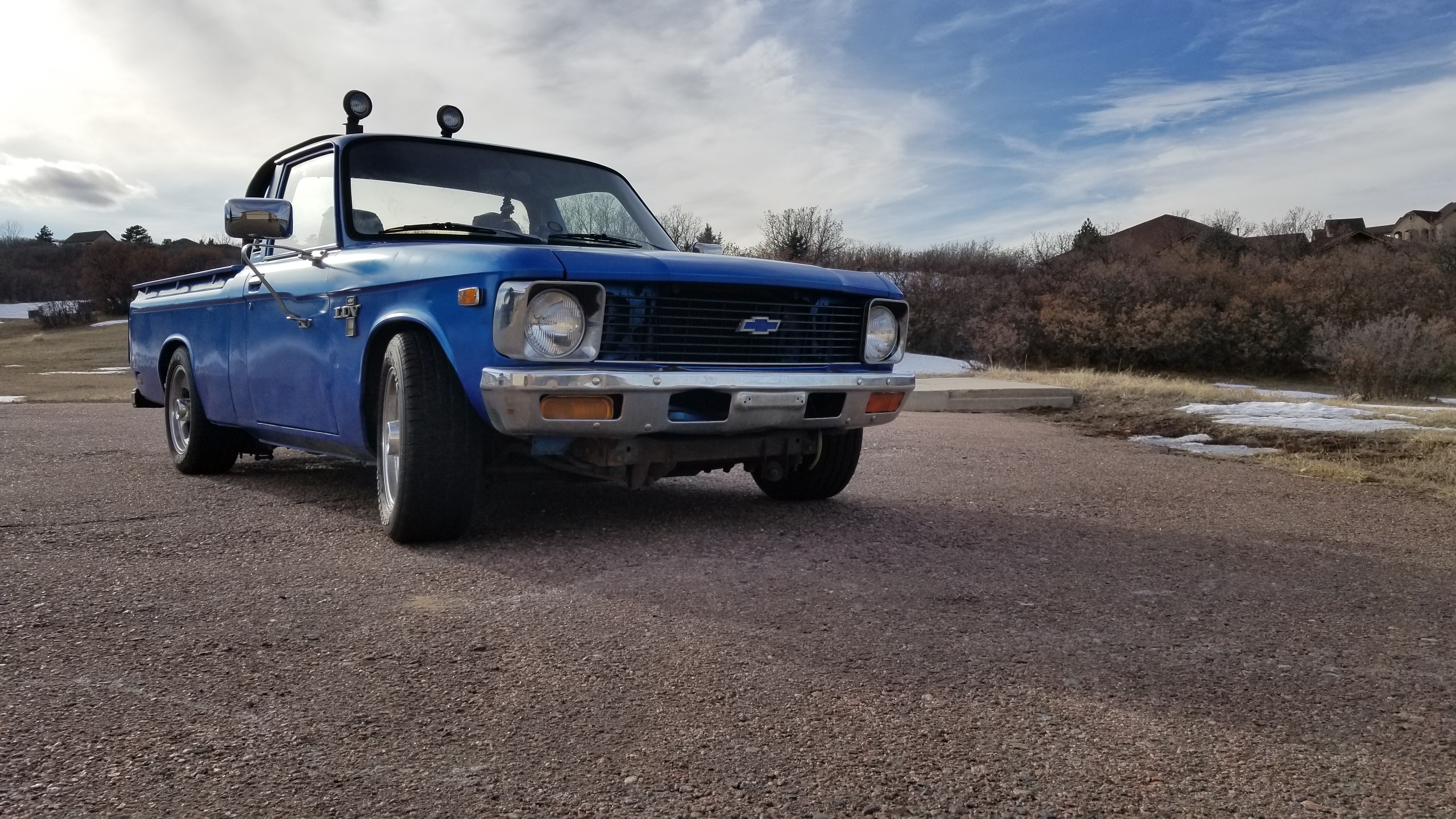

Lowering blocks have been installed! To recap, went down 4" in the rear with a 3° pinion angle correction. Currently up front an on about a 3" drop, want to come down another 0.5" but need to change up the wheels and tires a but if I'm gonna make that clear (first picture is desired front height, rest are post adjustment, will add a couple more later showing lowpoints).
Few things that jumped out while working on it...
1) All the soft bushings are trashed (not surprising at all) so time to look into replacing them.
2) Shocks are pretty old as well, going to look for some replacements (any recommendations?)
3) My exhaust hangs very low (and is a bit sketchy overall). Going to look into those Pacesetter headers and run a high flow cat + resonator setup while tucking it up a bit higher.
Also got in the first decent road trip in her (about 160 mi round trip) and it's 110% time for new seats. Anyone know off-hand what brand/model seat bracket fits closest?
Edit: Bottom picture is before increasing height by ~0.5", it flipped the picture order on me
