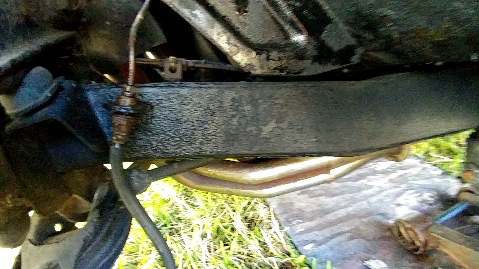

PostPosted: Mon Jan 28, 2019 9:05 pm
Posts: 103
if you take this clip of the brake line and loosen up the nut, you can then twixt the break line where it needs to be to mount the 1982 Iuzu caliper.
File comment: clip for breaks

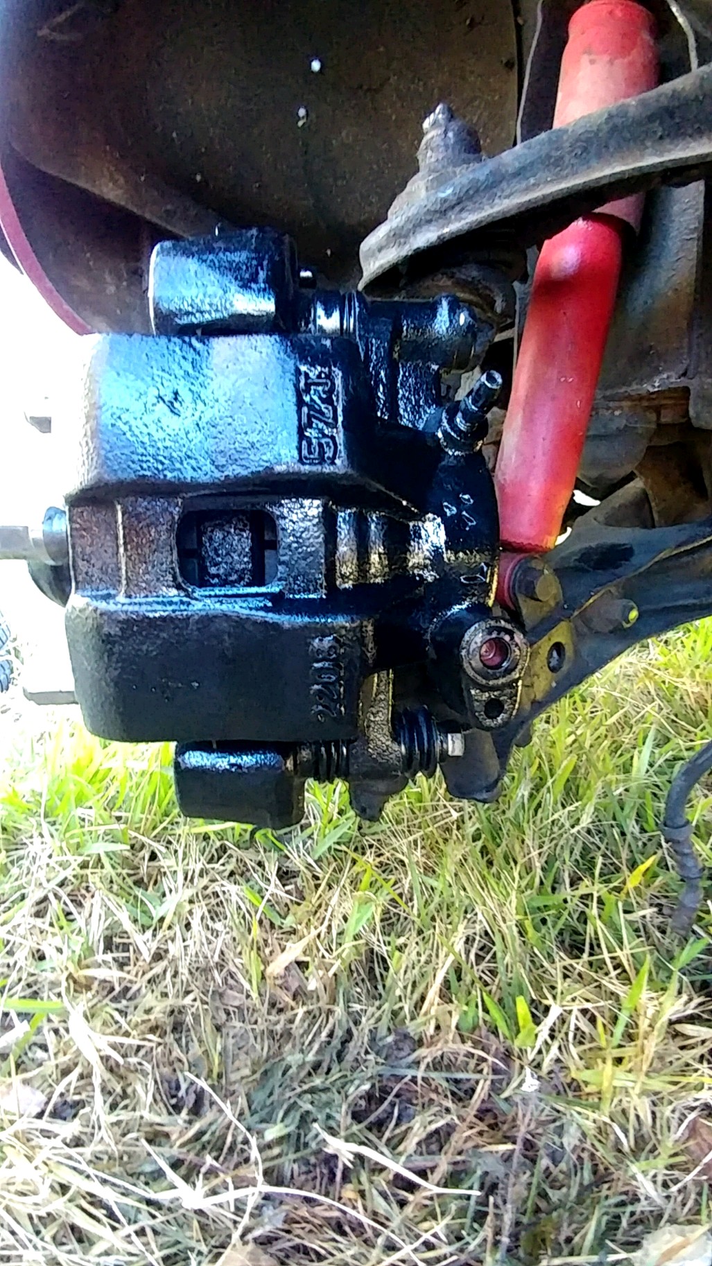

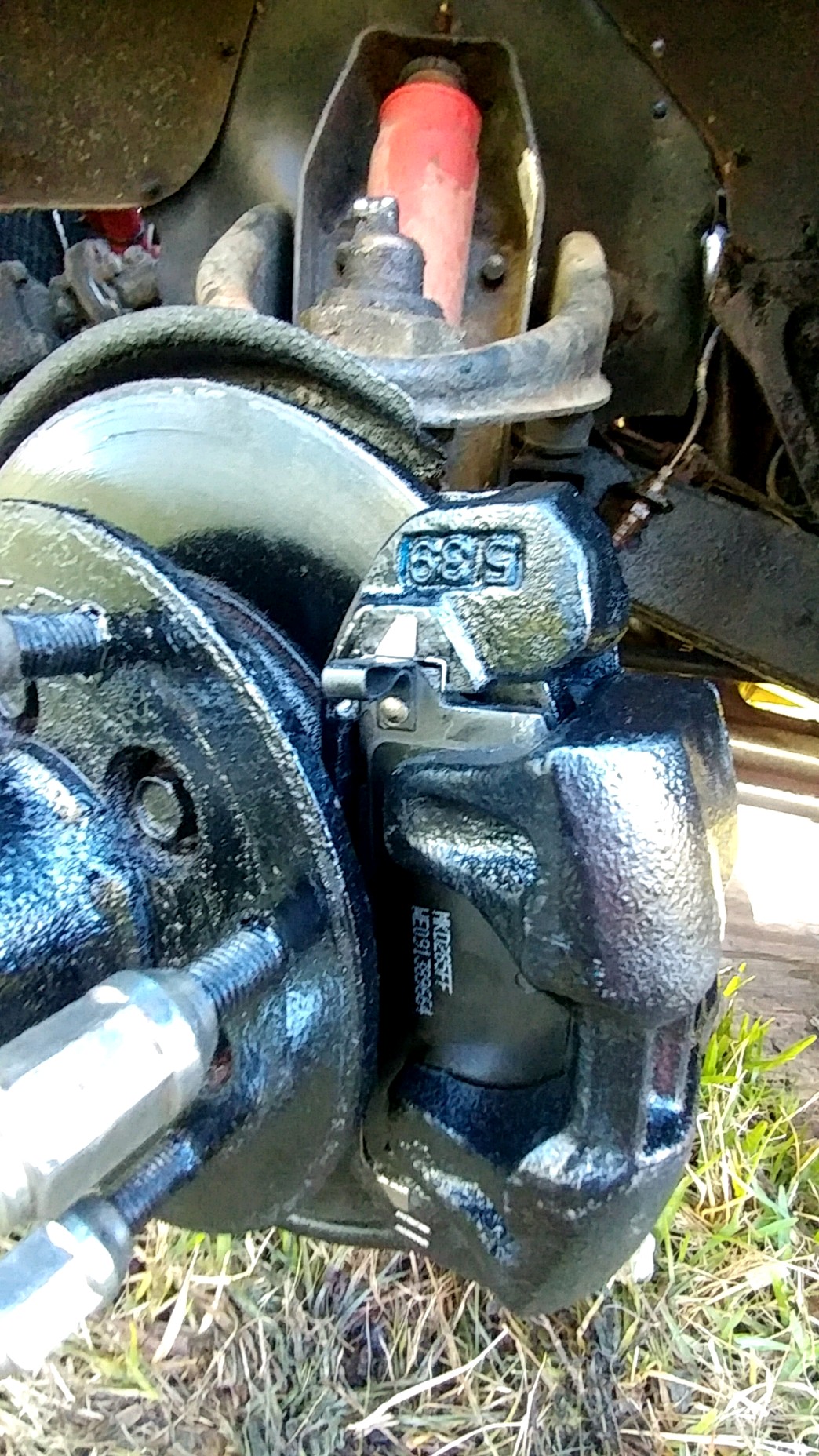

PostPosted: Mon Jan 28, 2019 9:10 pm
Posts: 103
After some paint and loading the caliper with the pads, it will fit on the front of you Chevy Luv truck.
File comment: fitts
PostPosted: Mon Jan 28, 2019 9:13 pm
Posts: 103
It centers well on the rotor. The brake fitting is however in a different location then the old one.
File comment: fitting shot

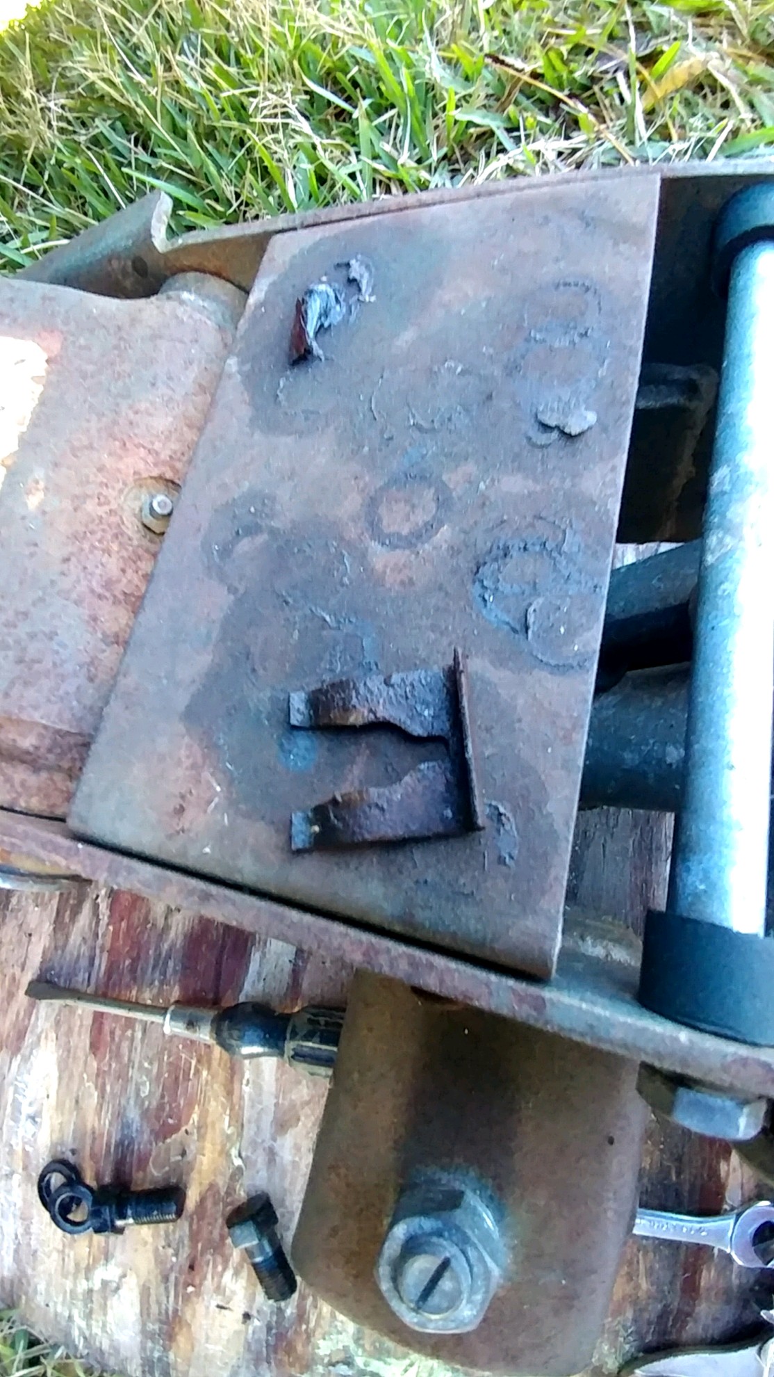

PostPosted: Tue Feb 12, 2019 9:37 pm
Posts: 103
I went to work on the passenger side breaks, and noticed the mud control flap on the inner fender was melted. I am guessing it gets a little hot down there.
