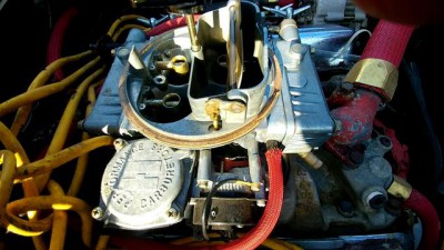

carburetor on the motor
File comment: carb on top

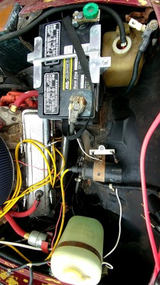

The passenger side of the engine compartment
File comment: drivers side engine compartment

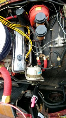

PostPosted: Wed Jan 16, 2019 9:06 pm
Posts: 103
Drivers side of the engine compartment

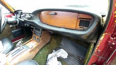

Somebody has made some of the dash parts in wood. this is a shot of the clove box and center councel they made.

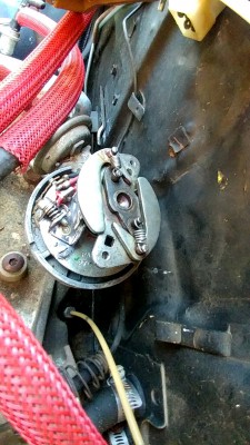

PostPosted: Wed Jan 16, 2019 9:14 pm
Posts: 103
For now it has the old points distributor, I have replace the points with a new set of accel points. this is a shot before replacing the distributor.

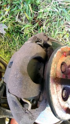

PostPosted: Wed Jan 16, 2019 9:18 pm
Posts: 103
The breaks that are on it, at this time, are from a 1976 Luv according to the numbers on the parts.

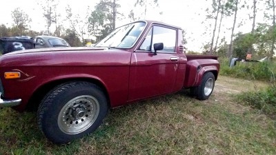

PostPosted: Thu Jan 17, 2019 10:15 pm
Posts: 103
Right now its a twenty footer. It looks great from twenty feet away lol

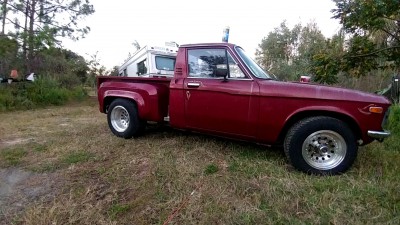

PostPosted: Thu Jan 17, 2019 10:16 pm
Posts: 103
the drivers side..

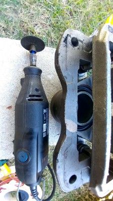

Fabbing a caliper and mount from a 1982 Trooper to fit on the drivers side. I just noticed I posted my pictures on the classified page. lol

I cut this part off..

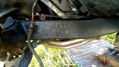

if you take this clip of the brake line and loosen up the nut, you can then twixt the break line where it needs to be to mount the 1982 Iuzu caliper.

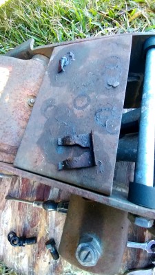

The clip hold this down so it won't move.

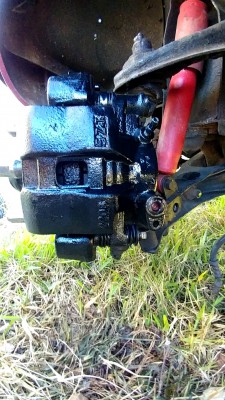

PostPosted: Mon Jan 28, 2019 9:10 pm
Posts: 103

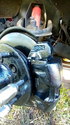

After some paint and loading the caliper with the pads, it will fit on the front of you Chevy Luv truck.

It centers well on the rotor. The brake fitting is however in a different location then the old one.

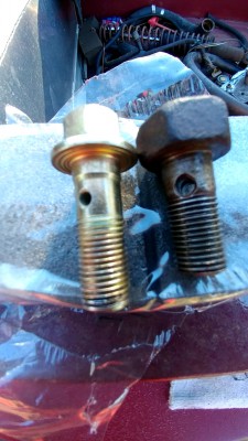

You need to use the bolt from the old caliper, as the one that comes with the 1982 Isuzu one is longer, and has a smaller hole then the one for the Chevy luv.

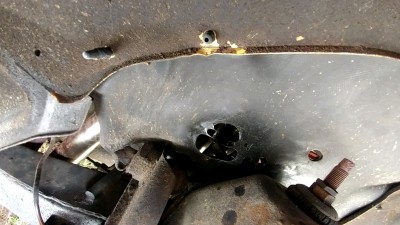

I went to work on the passenger side breaks, and noticed the mud control flap on the inner fender was melted. I am guessing it gets a little hot down there.
