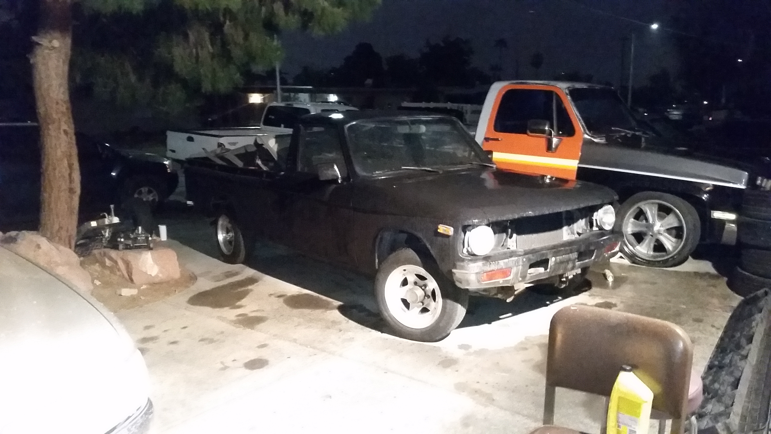

I need a lot of help on my 1980 chevy luv , I got this luv truck as a gift from my dad a few days ago and I want to do so much to it but not sure we're to start or were to get part for this as he told me it would be hard to find. I want to start off by dropping it down a few inches from the back and front.
