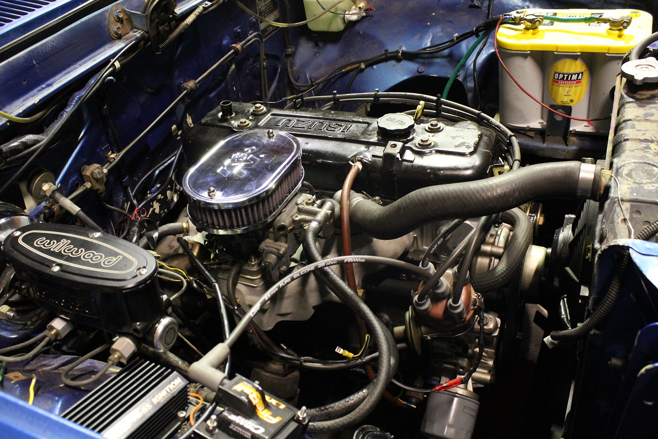

I've had this thing for nearly 4 years and had little to no time to work on it. recently i've been trying to get it ready to pass an inspection so i can get it registered. i've recently put an 8" booster and a 7/8 wilwood master in to get the brakes working.
donor for tub and other random odds and ends
quick rust repair using a section cut off a door
bleeding up new m/c
new brake lines throughout - tandem circuit now
new booster and m/c all fitted and bled. brakes are 1000% better, still drums though... note this is a temporary fix to get this thing registered. more to come once it has passed roadworthy...
btw thanks heaps to mokadeth for my new manifold!

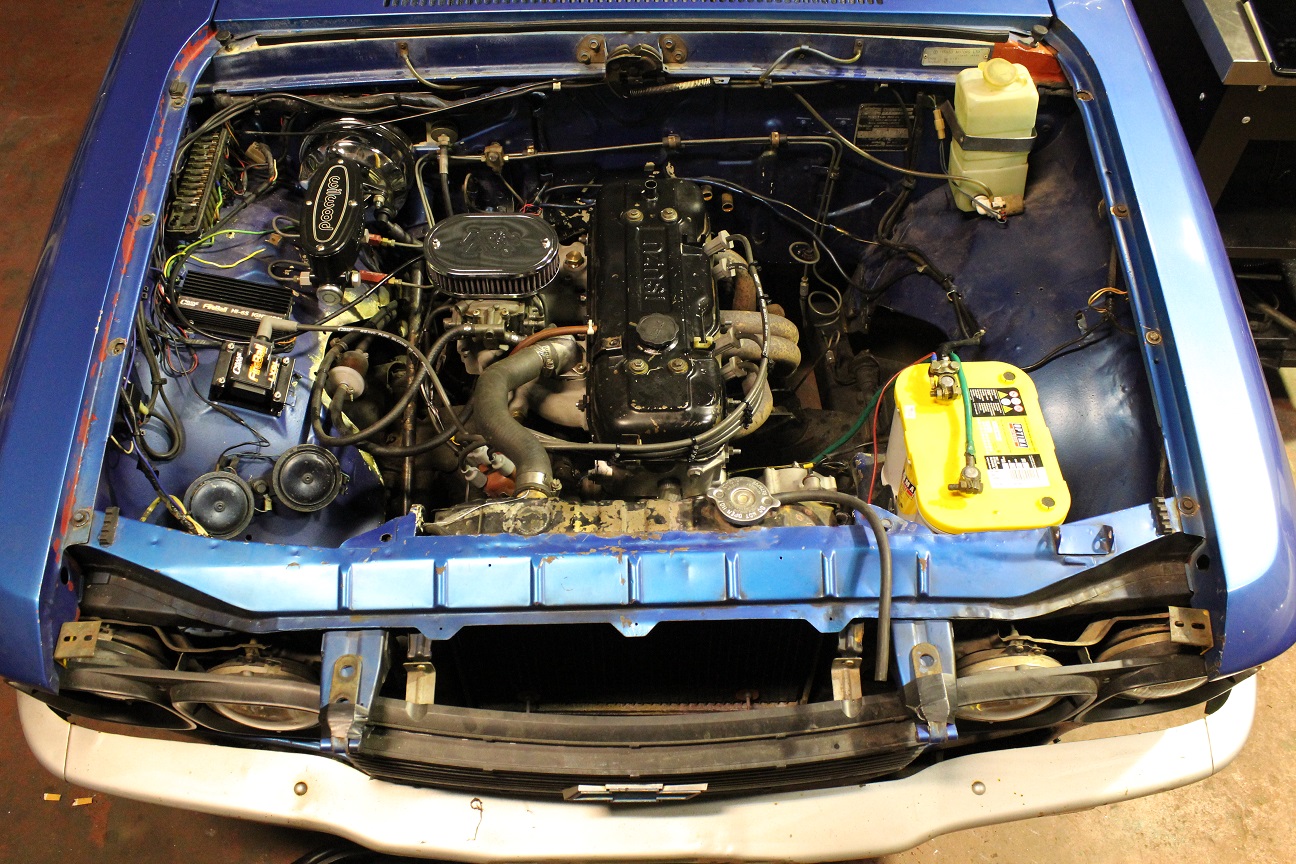

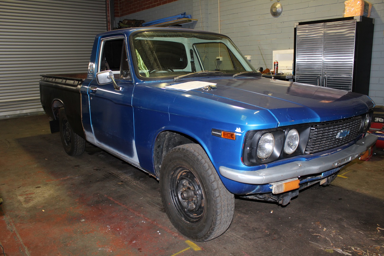

Okay so I have finally found time between other projects to spend some time on my little chevy luv.
I fitted new brake shoes and drums to try to even out a braking issue I had previously and with a little help from my good friend mr jack daniels got it to brake in a straight line again instead of pulling off the road.
I passed the mechanical inspection for registration renewal and now all I need is my registration papers to come through (its christmas time, might have a little wait on my hands) and it is back on the road.
I also fitted the new offenhauser intake manifold as supplied by mr Mokadeth and now my little chevy runs like a dream!
File comment: Looking a little old and tired

Apologies for the slight delay, I took some time out to work on other projects...
Its not a wilwood booster, i cant remember exactly what it is i just found something that might fit and modified the linkages to suit.
It turns out the master cylinder (260-9439-BK) and 8" booster combo was a little too violent with front and rear drums so i removed the booster and it feels great now.
