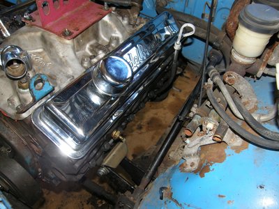

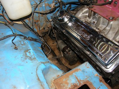

Exhaust manifolds came with 350 that was taken out of '79 GMC PU.
Re-ringed with new bearings. Want to keep costs at minimum.
Problem on right side is ebrake mechanism. Might relocate...
Or do away with it... Not sure yet

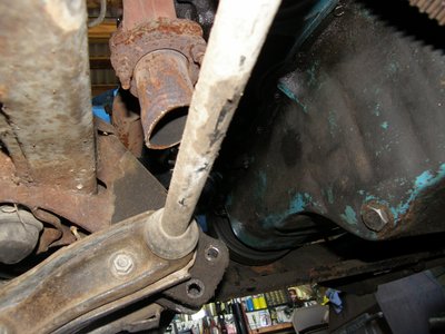

Seems to have room for exhaust pipe

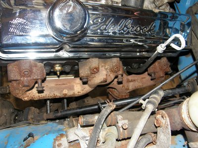

On the left side no problems with exhaust manifold
Should be able to get exhaust pipe on it
Other option would be headers, but cost is high

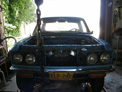

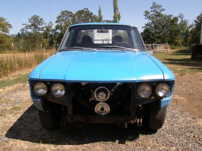

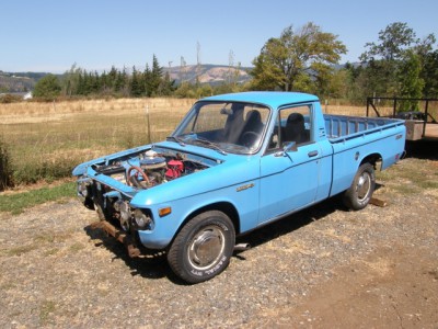

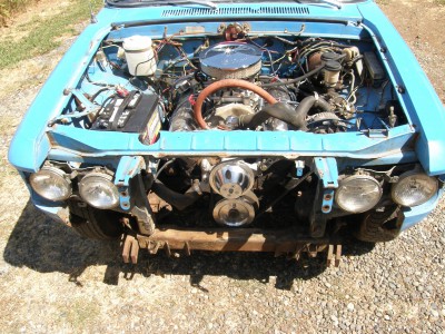

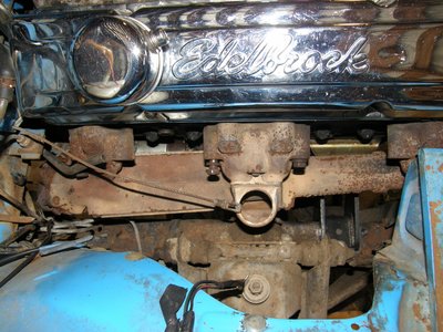

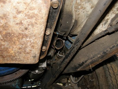

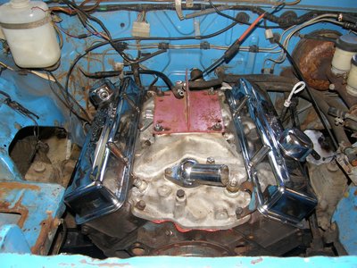

Removed core support
