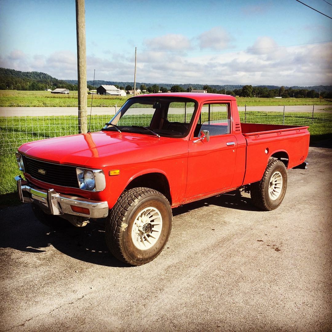

I'm swapping an Isuzu 4ZC1-T engine into my 1980 Luv 4x4.
I picked up the motor from a guy that beat me to the punch on buying a 1989 Isuzu Impulse from a junkyard. He bought the car for the same reason I did, the Isuzu motor he planed to swap into his Chevette.
At first I talked him into selling me just the exhaust manifold and I was going to turbo the original G180 that was in the Luv, but then I asked him if he'd sell the turbo, then the head, then the engine, and eventually he agreed to sell everything with wiring harness. I made out like a bandit.

In the mean time, here are a few pictures. Could use any and all suggestions. Especially with the motor swap. Also what else I can pull from the Trooper.
Thanks in advance!

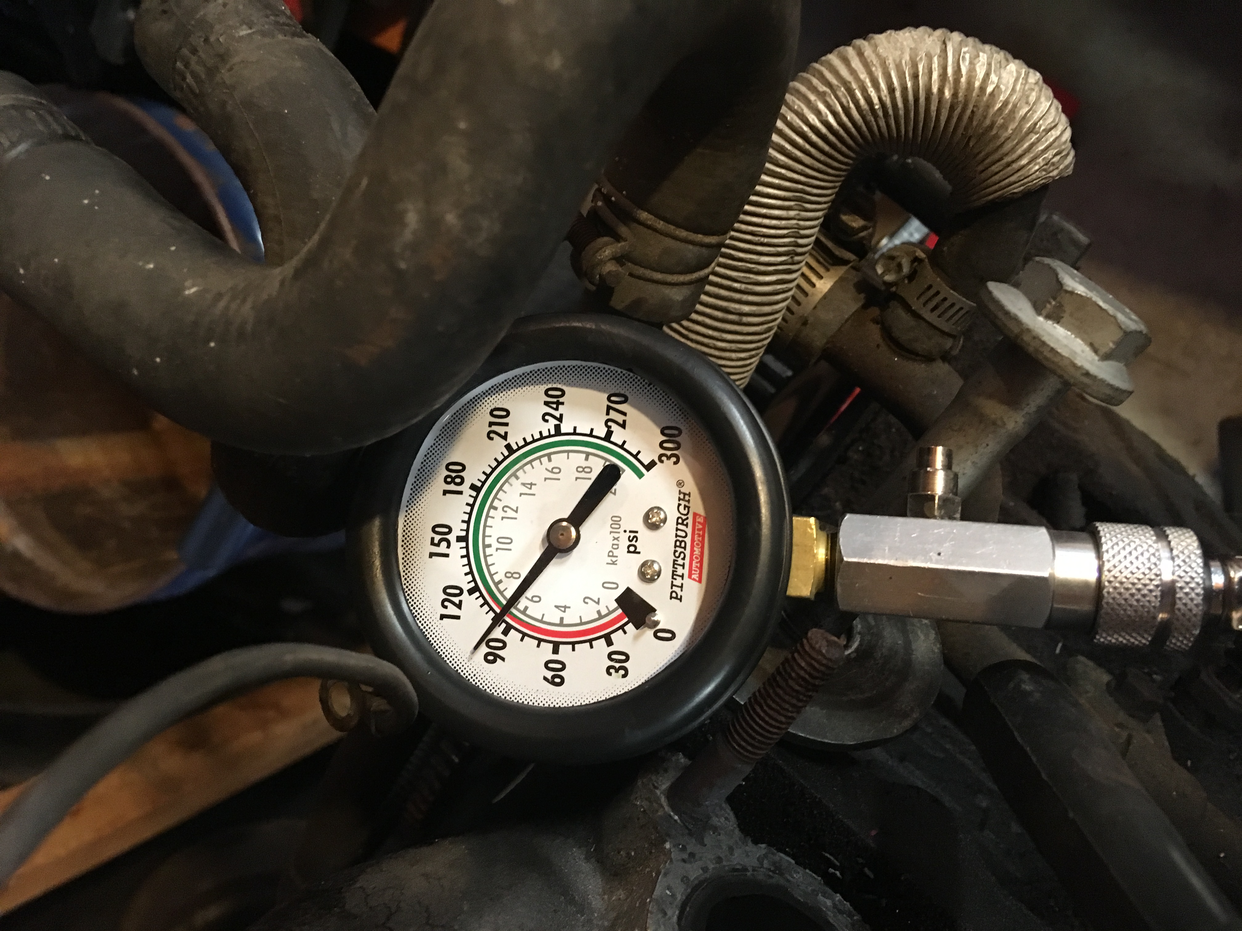

Also completed a compression test on the 4ZC1-T and I'm confident I don't need to rebuild it for a while (budget build). I'll have to hold off until I can afford it, plus I still have A BUNCH of wiring to do before she will ever drop in... Let's just focus on getting her running first before I invest moo-lah... (Pic Below)

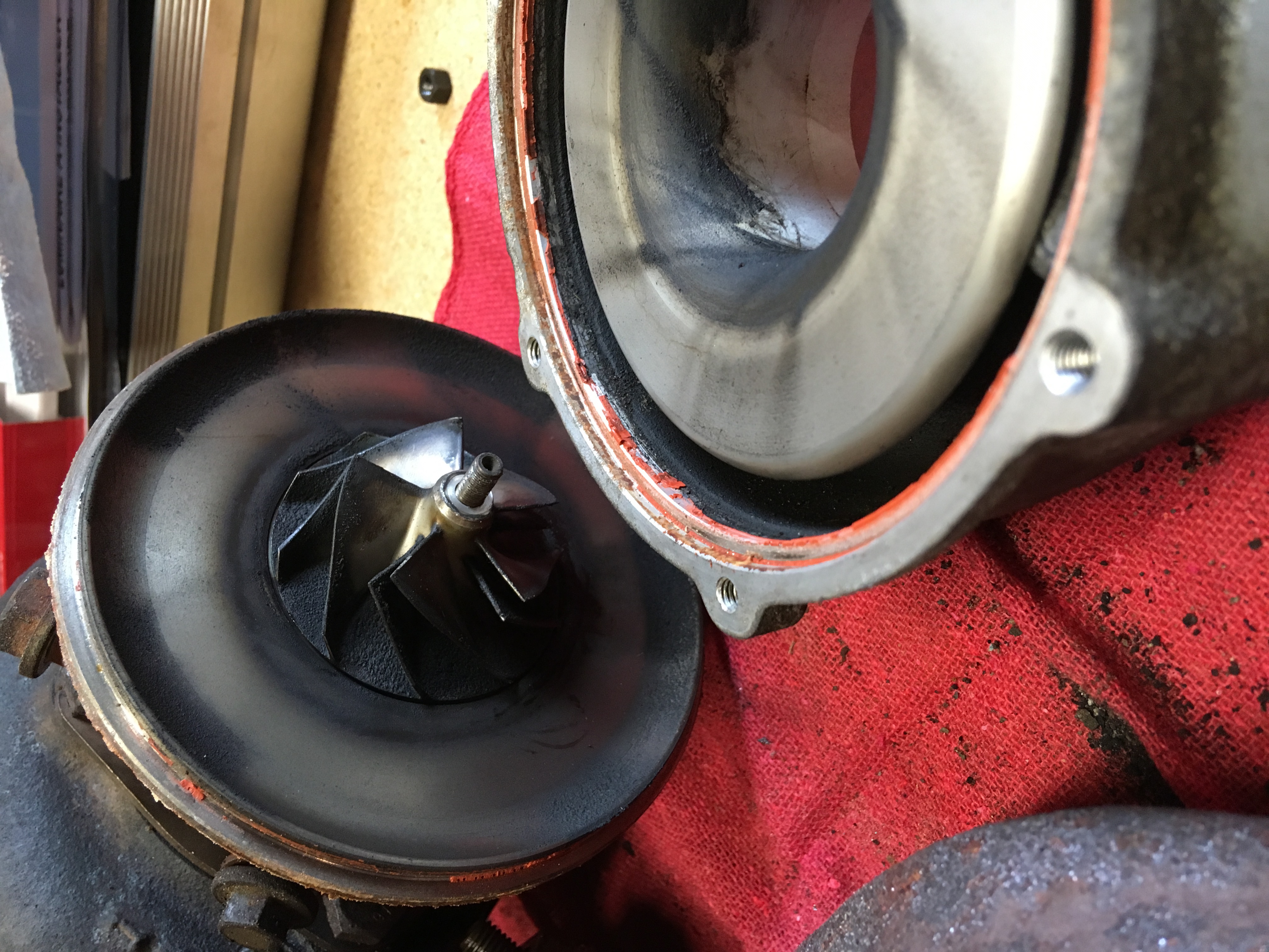

My turbo was sent back to me with a note saying, "Cannot find replacement parts"...
If you need work done to any turbo OTHER... than an IHI RHB5, I'd suggest "Tim's Turbos"!! He was very knowledgeable but couldn't help.
So the search begins for a turbo. Considering a T25 with the correct flange to mount to the exhaust manifold and run custom coolant and oil lines.
An aftermarket would help anyways, then I could upgrade from journal bearings!
But then again, I found a direct cheapo replacement on Ebay.... So.....?

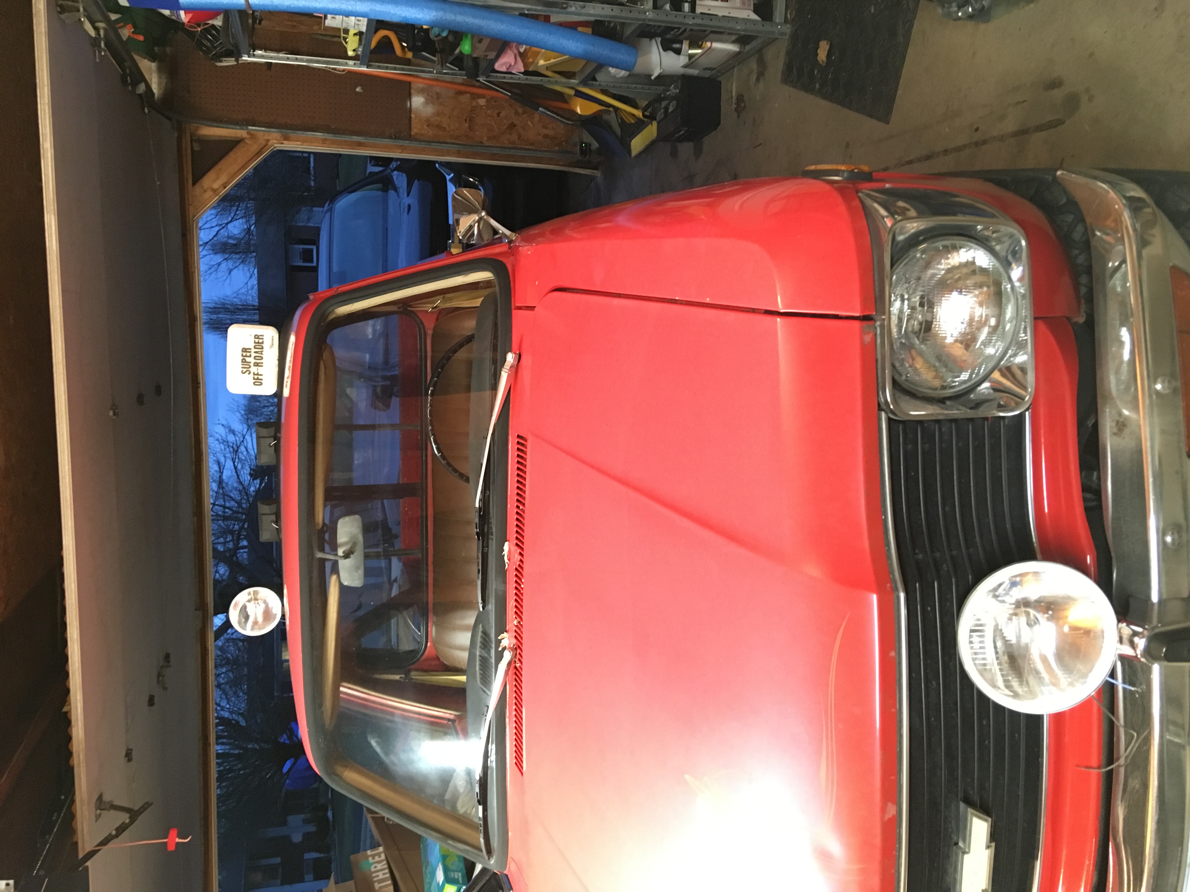

But I think I have a good idea once it's complete. I want to go with an "early 80's Baja" look. Below is a pic of how I plant to mount the light bar, and spare tire.
I also acquired some Dick Cepek Super Off-Roader lights that will mount to the bumper between the push bars, and some Hella lights for the light bar.
