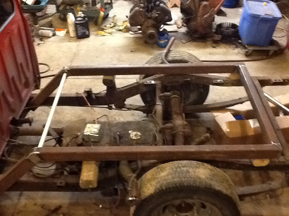

After ripping my bed off to get some measurements

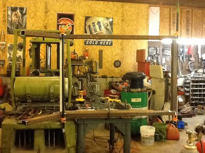

Mocking frame rails

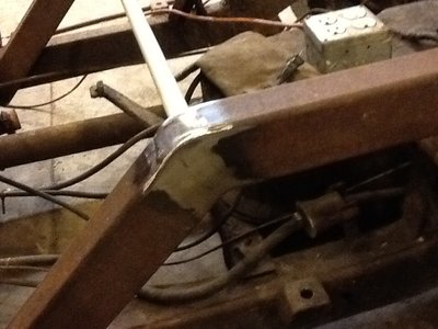

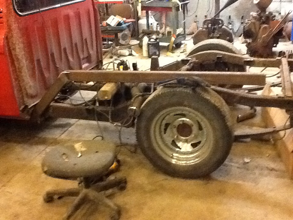

Cut the rails at a 45 so I didn't have a point therefore I radius the one cut and then folded the top piece down because I don't have a bender for 2x3 lol

Back half welded together

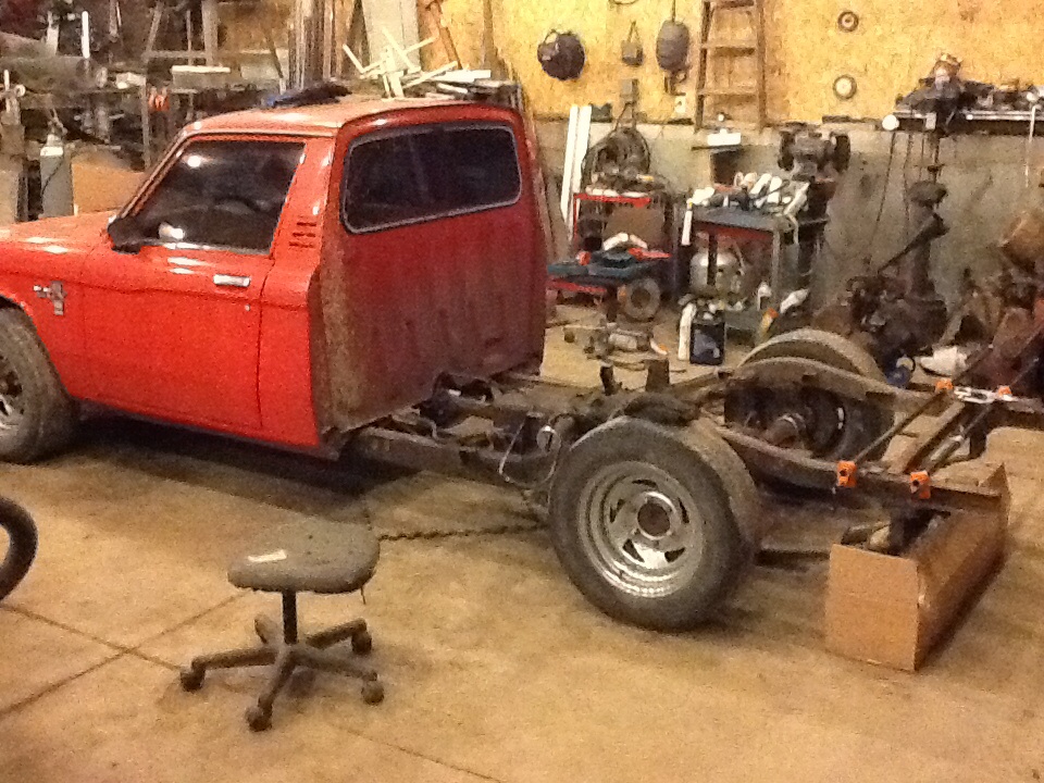

Set on the truck to get an idea of what she'll look like

The back half looks short because I forgot to say its along bed truck I'm shortening to a swb truck

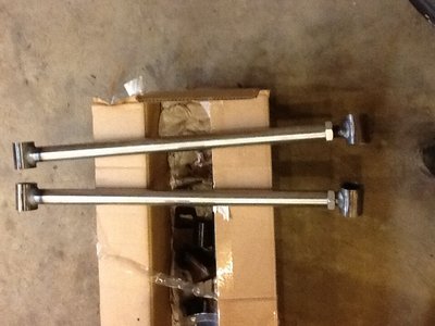

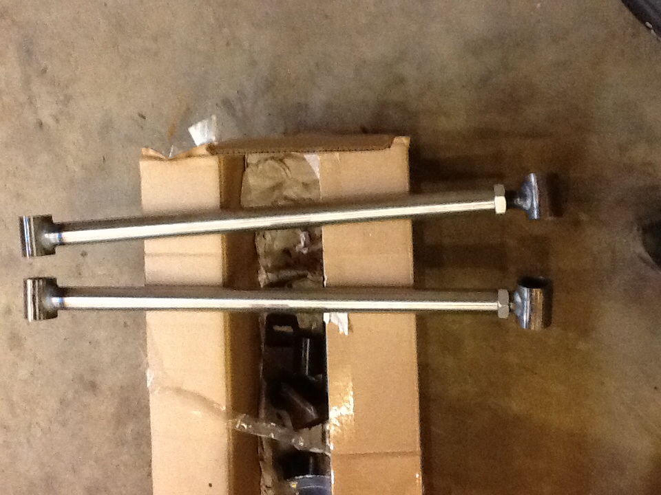

Bottom 4 link bars I made from some 1 5/8 dom tubing I had laying around

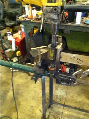

Notching my bottom bars

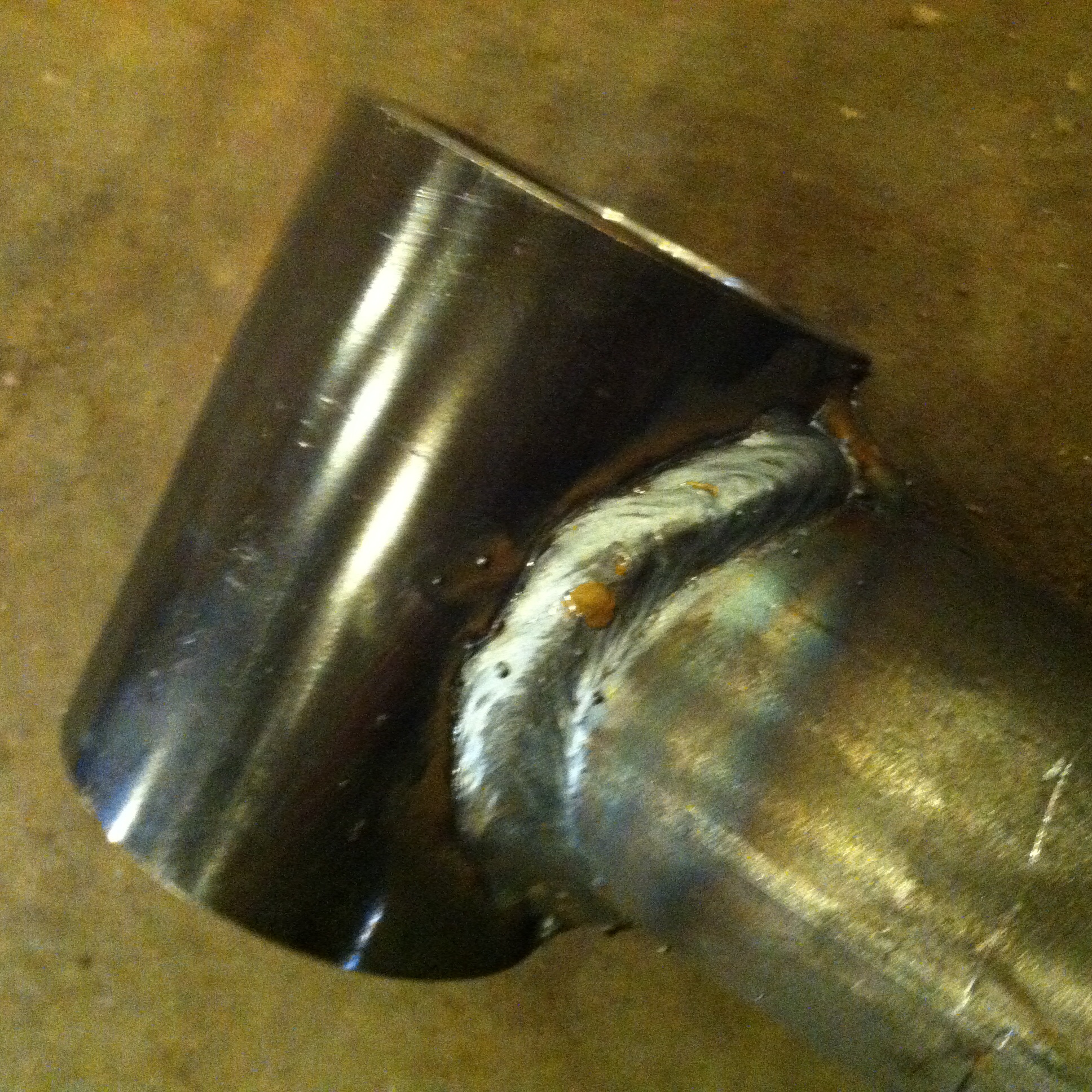

Welding on ends

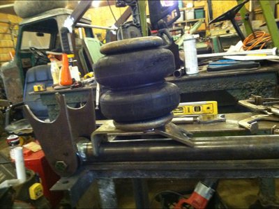

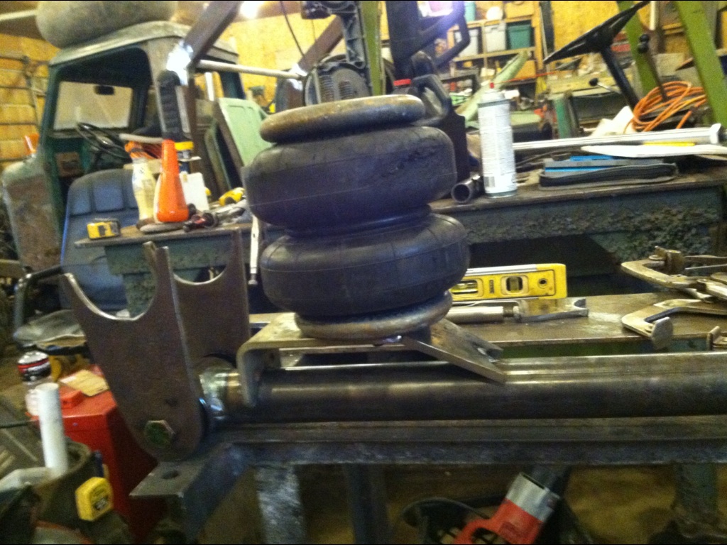

Axle tabs and bars and bag mounts .....all made from scratch tabs bag mounts and bars

Having been able to work on it much the past couple weeks got too a little bit Saturday started bag mounts ....building a set of custom bag cups to be welded on frame rails with. 1.5 dom tube instead of plates and doing a 1.5 in tube cross member and drive shalf loop laid back at a. 45 degree angle
