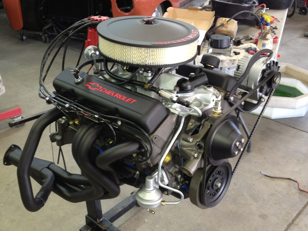

Well, the issues with the wiring, leaks, and sticking valves lead to more and more problems. The cam was flat in places, a head was cracked, bearings were worn all to hell, serious gaps around all the pistons... If someone tells you that an engine is "rebuilt", it's bull unless they have reciepts and pictures.
Anyway, the motor has been out the past month. The engine bay has been immaculat-ized and the wiring all rerun. Motor is at the machine shop and heads are being ported, polished and flow tested. Alum radiator, electric fans, new hei and coil, pistons, etc. are all on order and should be here in a couple days. All should be installed in the next week or two.
I'll create an album on photobucket with a hundred or so pics of the old and new, and post when its done and running. It should be a pretty fast one wheel drive truck when its done.
PostPosted: Fri Aug 24, 2012 8:57 pm
Joined: Sat Jun 23, 2012 11:17 am
Posts: 54
The motor rebuild is done. Should be in the truck in a week or so. More pics to come when it's complete.

PostPosted: Fri Aug 24, 2012 10:23 pm
Nice work, what alternator bracket are you using?
PostPosted: Sat Aug 25, 2012 8:33 am
I didn't read through this whole thread, so it might be, but that thing looks like a brand new crate motor. Beautiful!
Posts: 54
Thanks. The alternator and bracket are pretty much the only salvageable accessories on the motor. The bracket just got shot with paint to make it match the other stuff. Not absolutely sure what brand/model it is, but the top arm looks a lot like the Spectre, Mr. Gasket, or Proform parts on Jegs/Summit, not sure on the lower bracket. I'll ask the guy who assembled the motor if he knows and get back to you.
Posts: 54
Thanks, but no, it's the original motor, just rebuilt - 1971 casting, 4 bolt main. The block was stripped, decked, bored, and got shot with an iron/dark grey color. The crank was reground and polished. Fresh pistons, cam, 670 carb, ignition. Heads also were machined- ported and polished, new valves, lifters, springs and rockers (same grey paint on outside as block). Valve covers and breather, air cleaner, headers, water pump, and harmonic balancer are new. The intake and other accessories, pullies and brackets, fuel pump, were stripped and got a fresh coat of paint.
The radiator gets mocked up next. The trans cooler is built in, so the lines need to be refitted. Wiring is mostly done (redone) and is looking much cleaner. I might even have functioning windshield washers, oh my!

PostPosted: Sun Sep 16, 2012 9:30 pm
71 truck 350 would come with that lower bracket for a short water pump. Top one may be aftermarket, but the stock one for the 71 truck would look pretty much like that one. I find them from time to time on 67-72 farm trucks...

PostPosted: Mon Sep 17, 2012 12:18 pm
Posts: 54
I forgot to post a follow up on this. I asked the mechanic working on the motor rebuild. He said the same as mytmouz- the bottom mount is original to the 1971 motor and the top arm bracket is also likely stock or oem from a later motor. There are also similar top arm brackets for sale on Summit/Jegs for around $10.

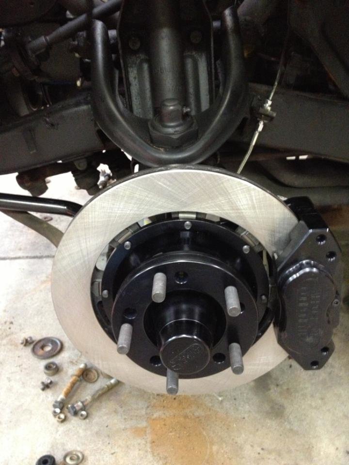

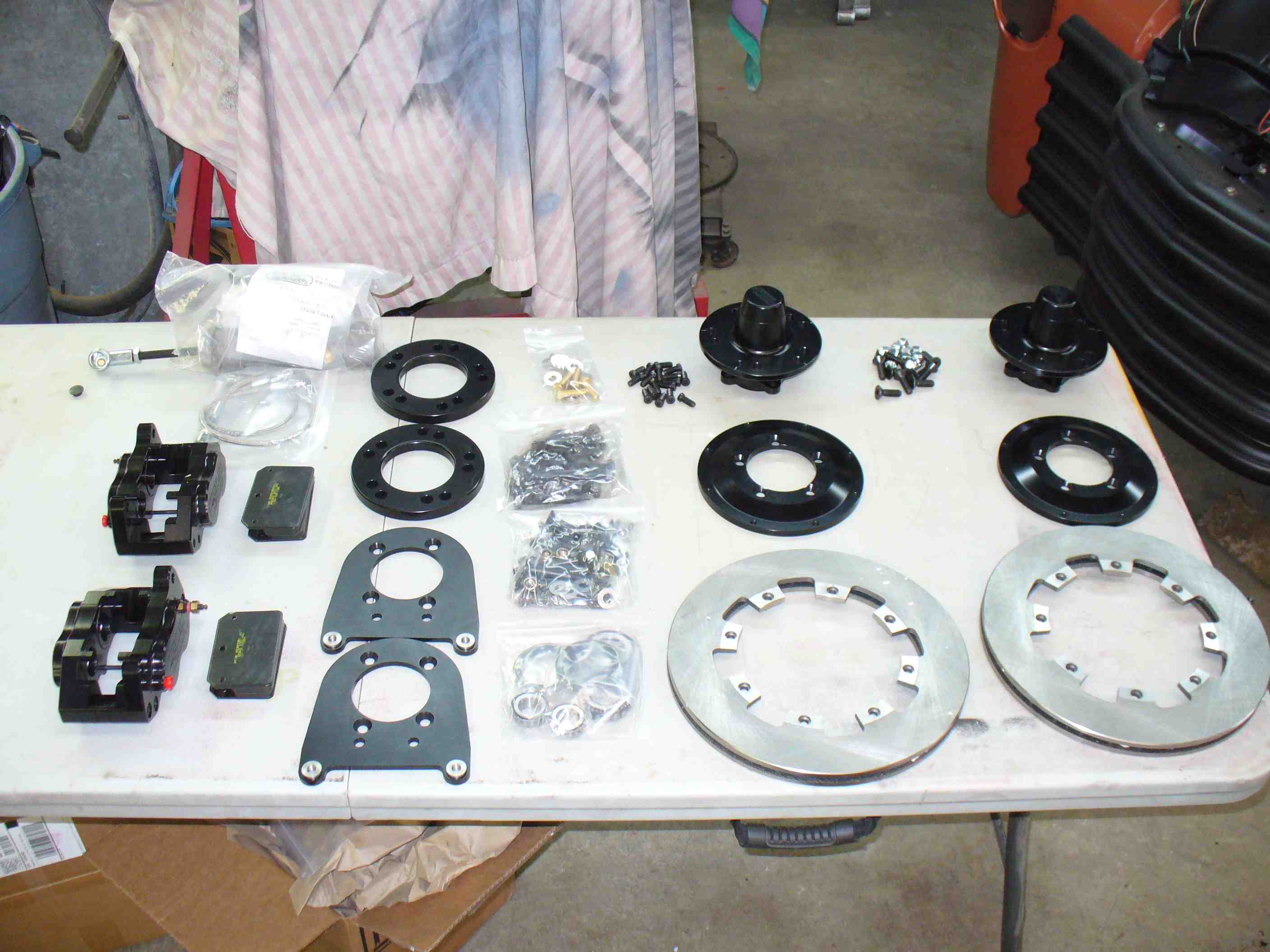

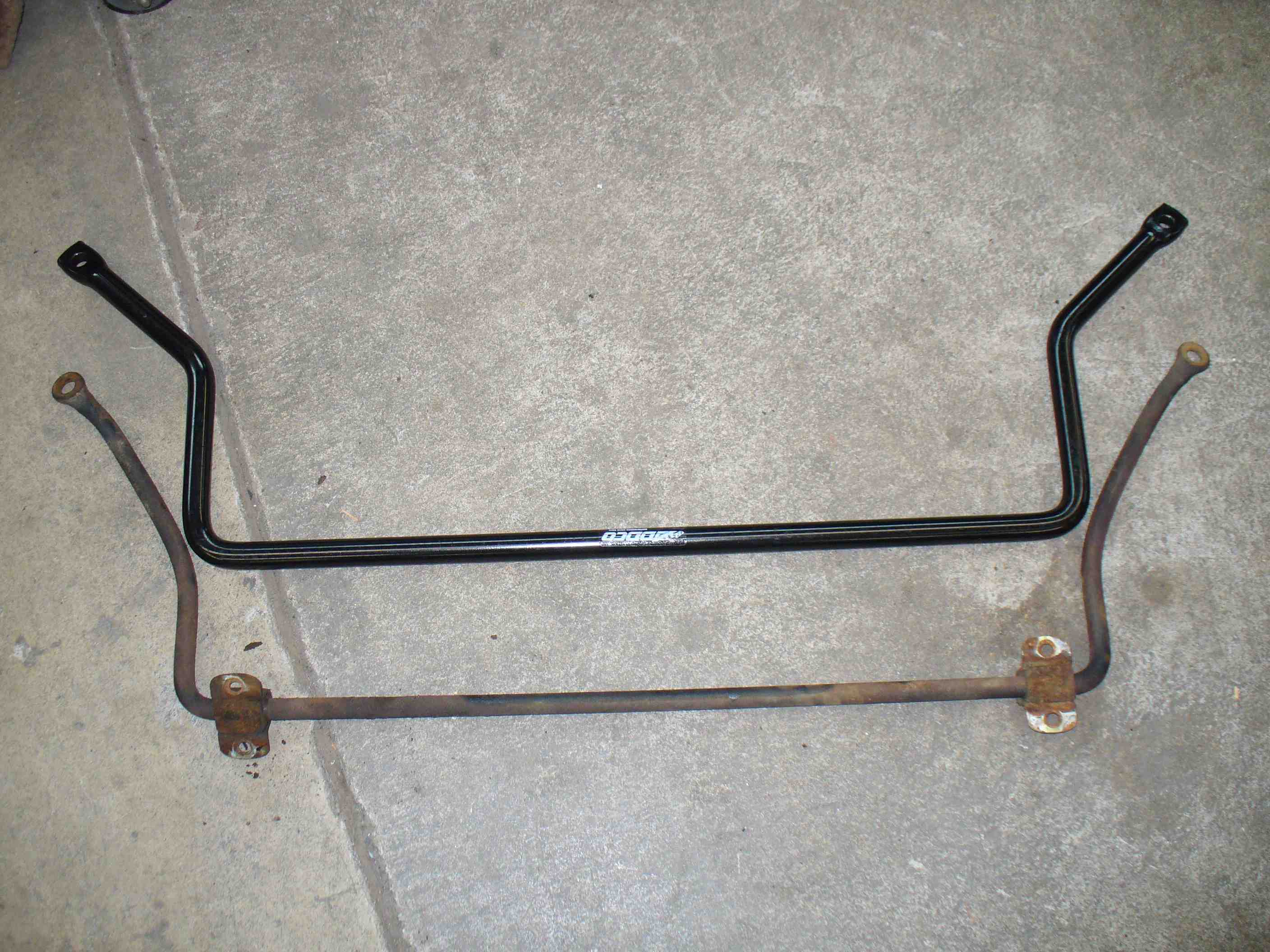

Did a bit more work on the truck in the past month. Here's some shots of the Aerospace brake conversion, the Addco front swaybar, and my crud filled gas tank that got cleaned and resealed.

Here's the Aerospace kit.

On the truck

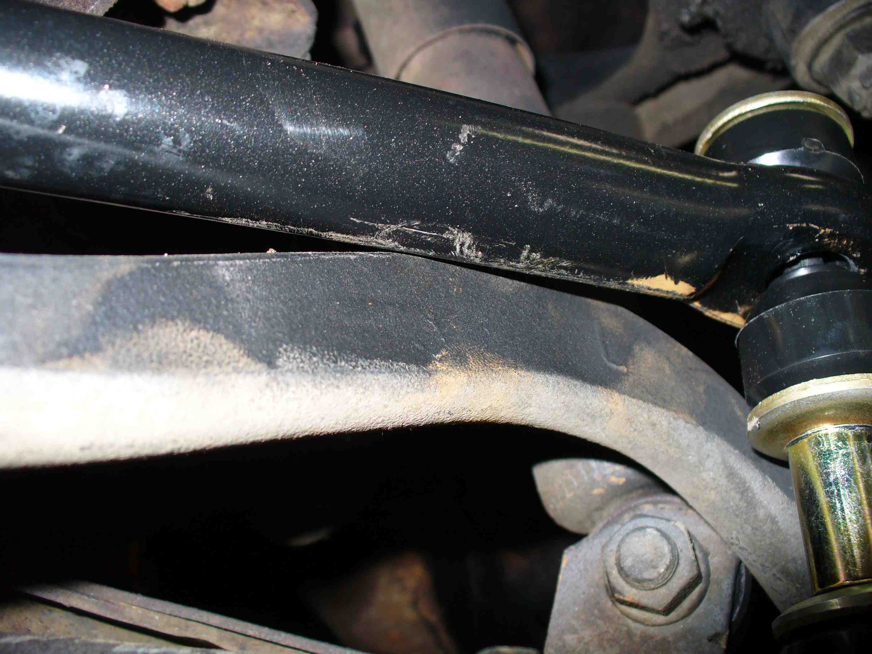

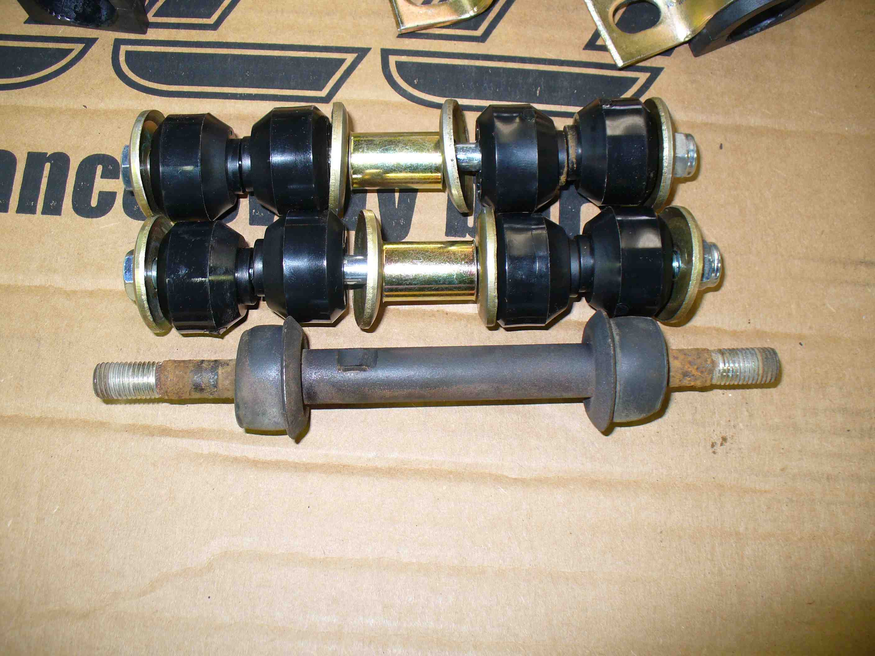

Here's the Addco front swaybar. You can see the difference in shape from stock, both in the bar and the ends. The ends that came with the kit hit on the lower control arm. We ended up using a new set of OE ends to get past this. The bar itself still hits on the outside of the frame rails. Not real happy with the kit, but it does keep the front end flatter in the corners.

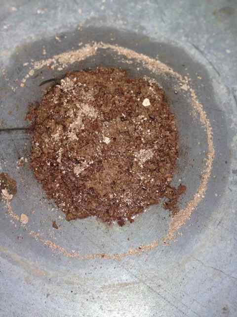

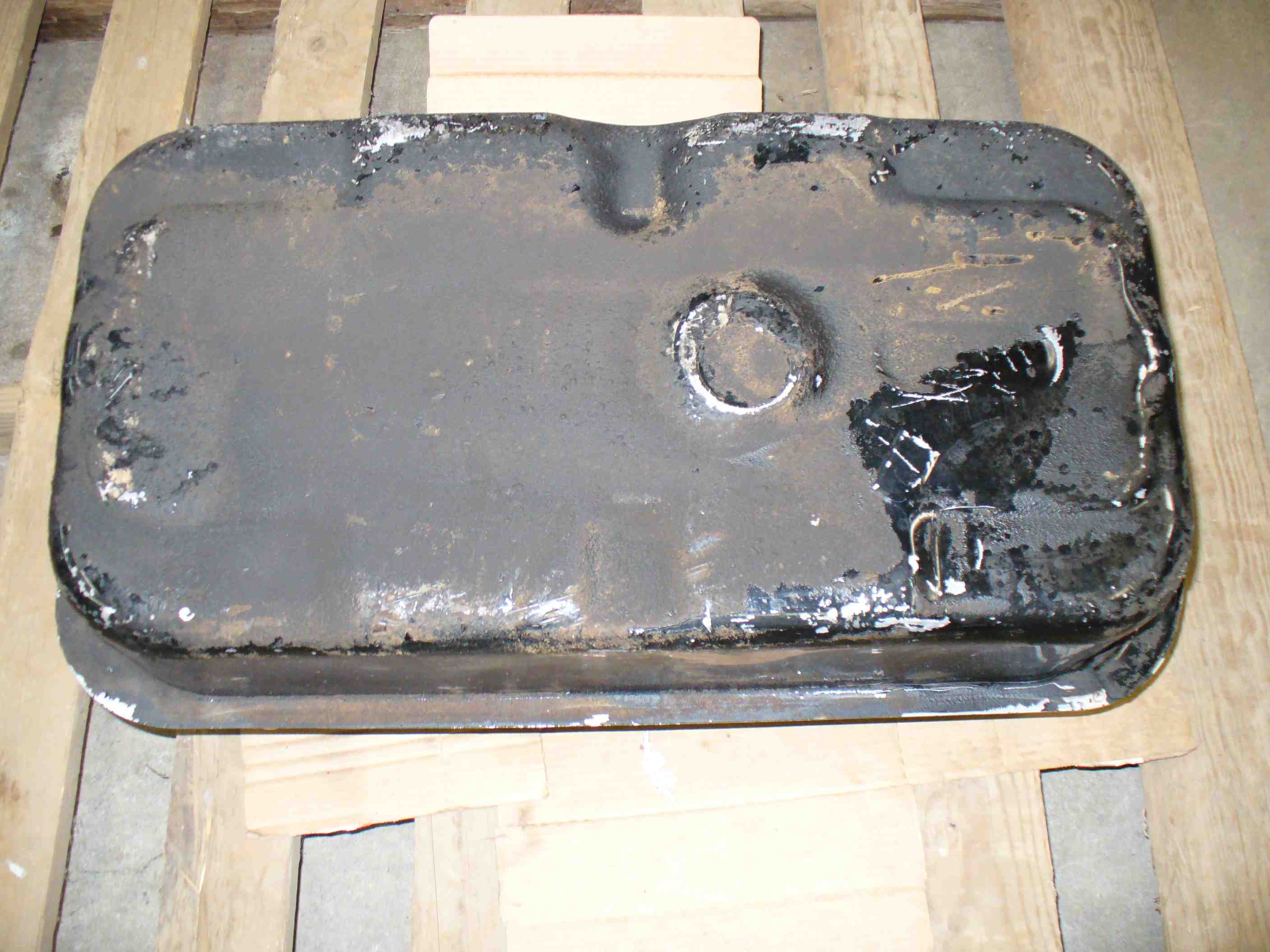

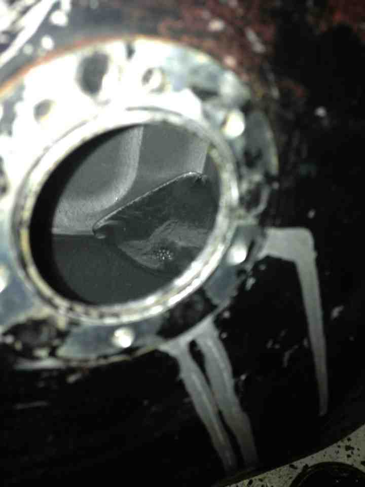

Here's the tank and the fun that was in it. After the motor rebuild, I was finding small particles in teh upper fuel filter after 200 miles. Cleaned out and resealed, good as new.
This is what came out of the tank
Nice and new inside
