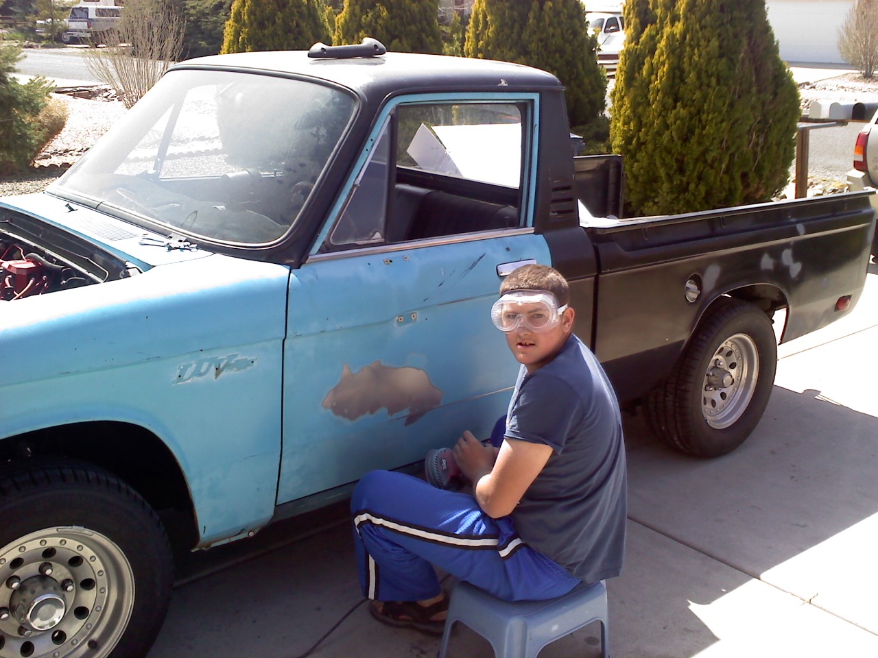

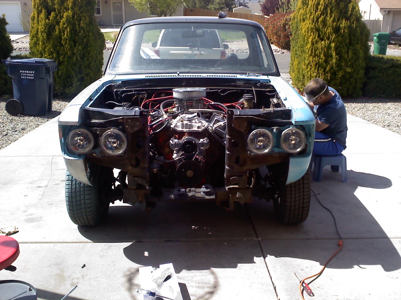

PostPosted: Sat Apr 16, 2011 7:31 pm
Posts: 190
Location: Prescott Valley Az
well got radiator and most of front end done
LIVE HARD PLAY HARDER
PostPosted: Sat Apr 16, 2011 11:35 pm
Posts: 190
anybody know what i can use for a front end the skins i had were in really bad shape rusted out so need input on lower skins and bumper. all i have for the front is what is in the pics. as
lso anybody need front drums got 2 new an also 2 new brake cylinders let me know they are free just pay for shipping. may take time we only have private mail system here about 2 weeks for shipping standard
