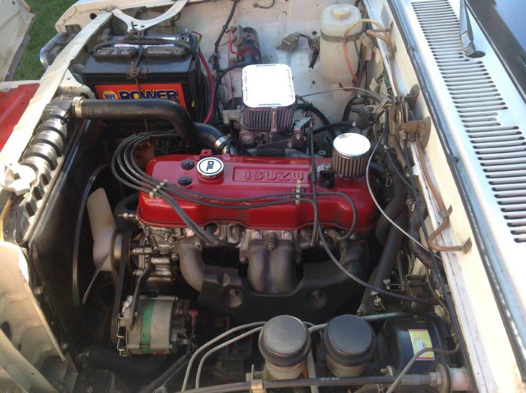

Rebuilt motor, smog delete, weber carb and pertronix ignition.

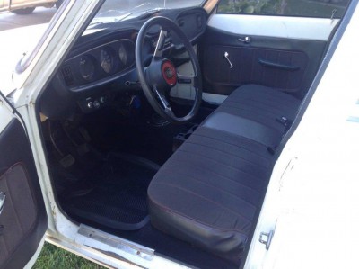

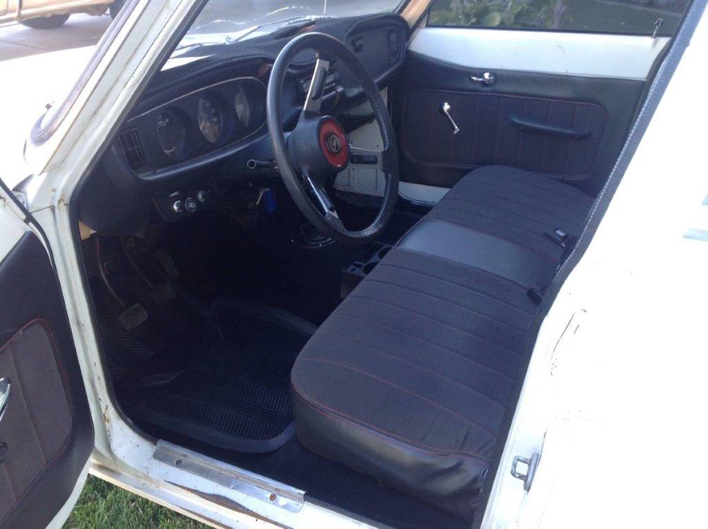

had the seat recovered and new door panels made. Welded small pinholes in the floor and layed down sound deadner. Some cheap carpet from the auto parts store. A Mikado steering wheel i found on this site.

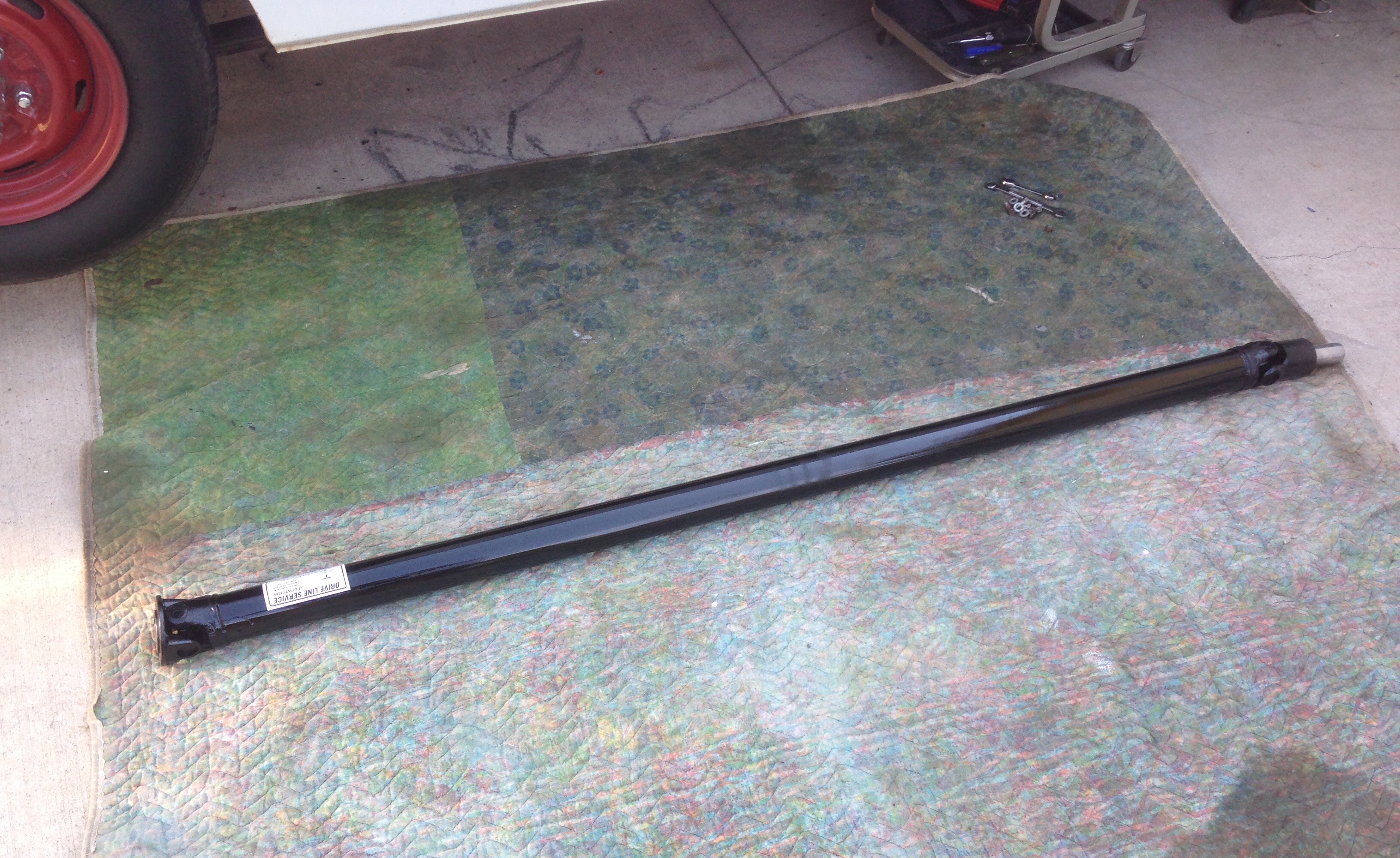

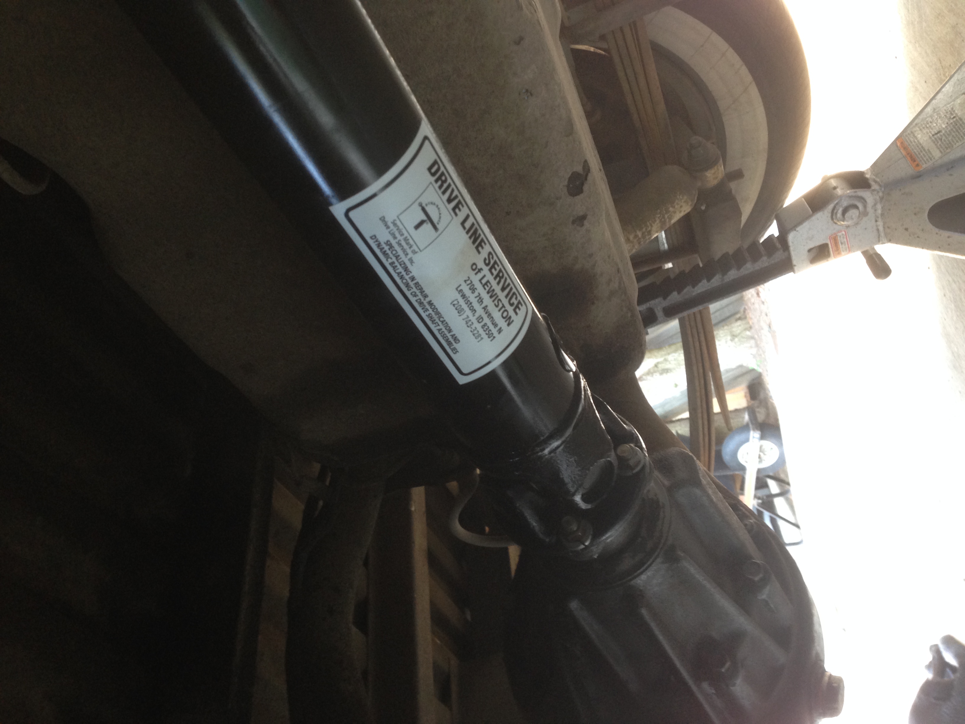

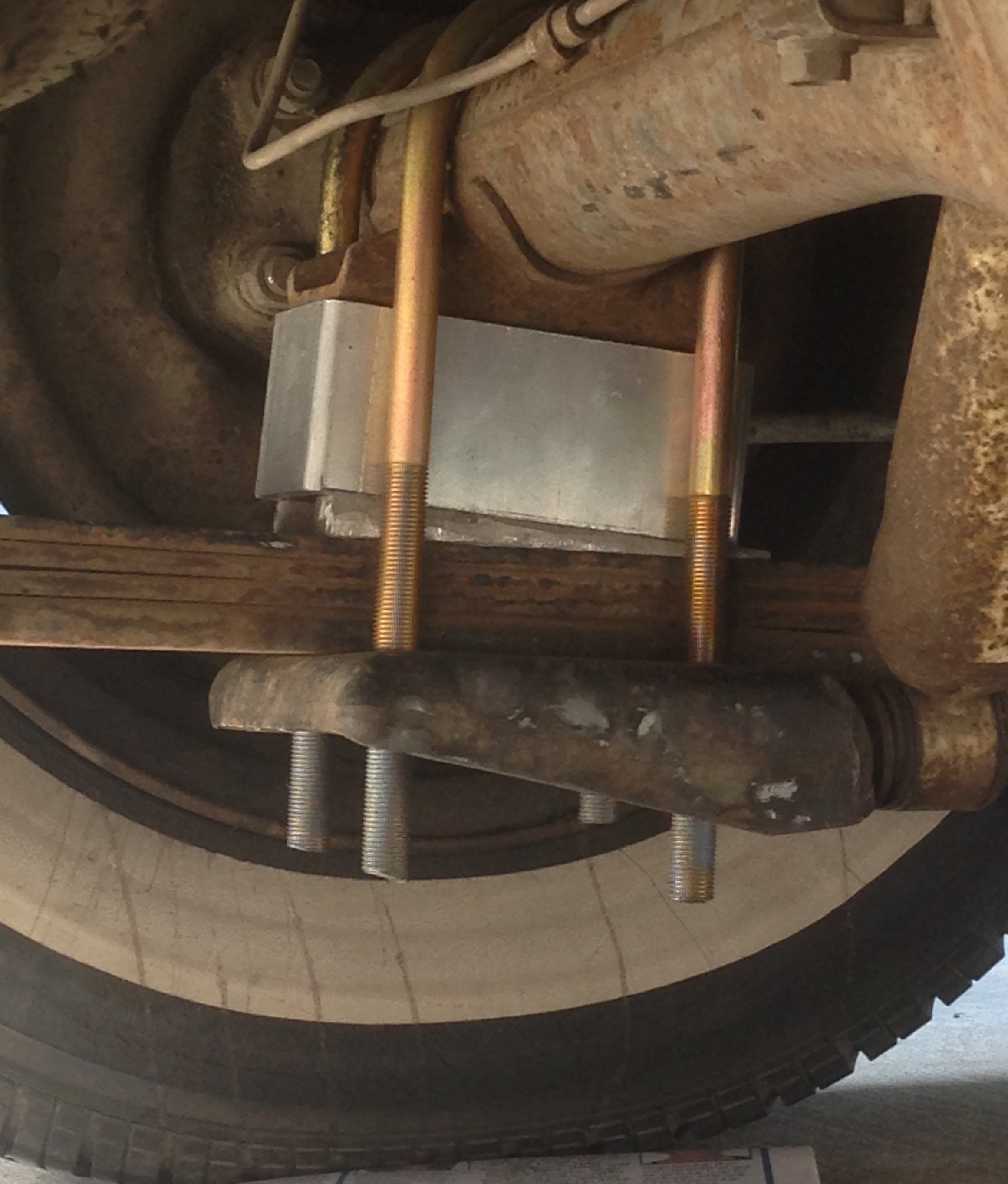

Lowered the rear 3 inches with blocks and removing a spring. Been fighting bad ujoints and a carrier bearing. Finally got my pinion angle right with 4 degree wedges. The. Had a drivline shop make me a custom 1 piece drivline to replace my 2 piece.

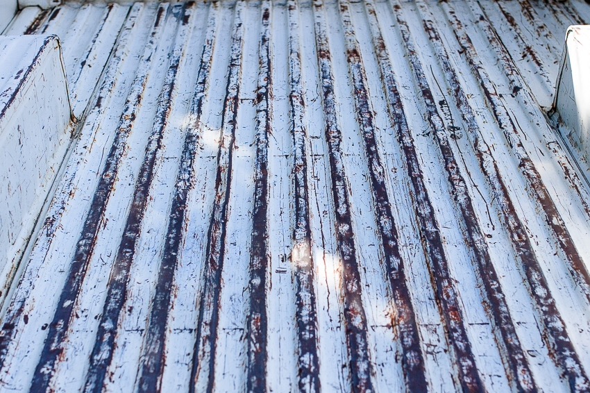

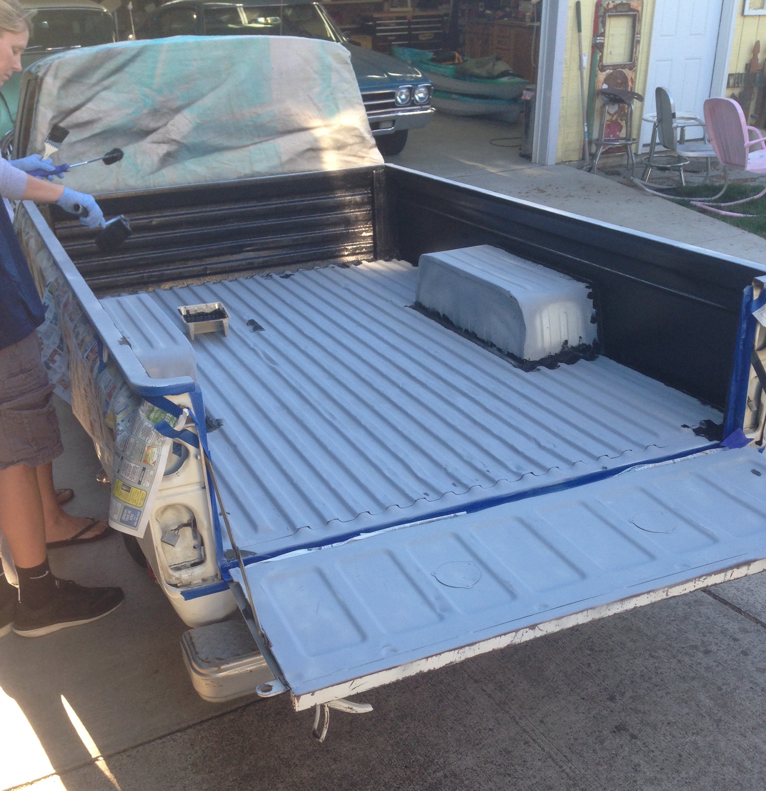

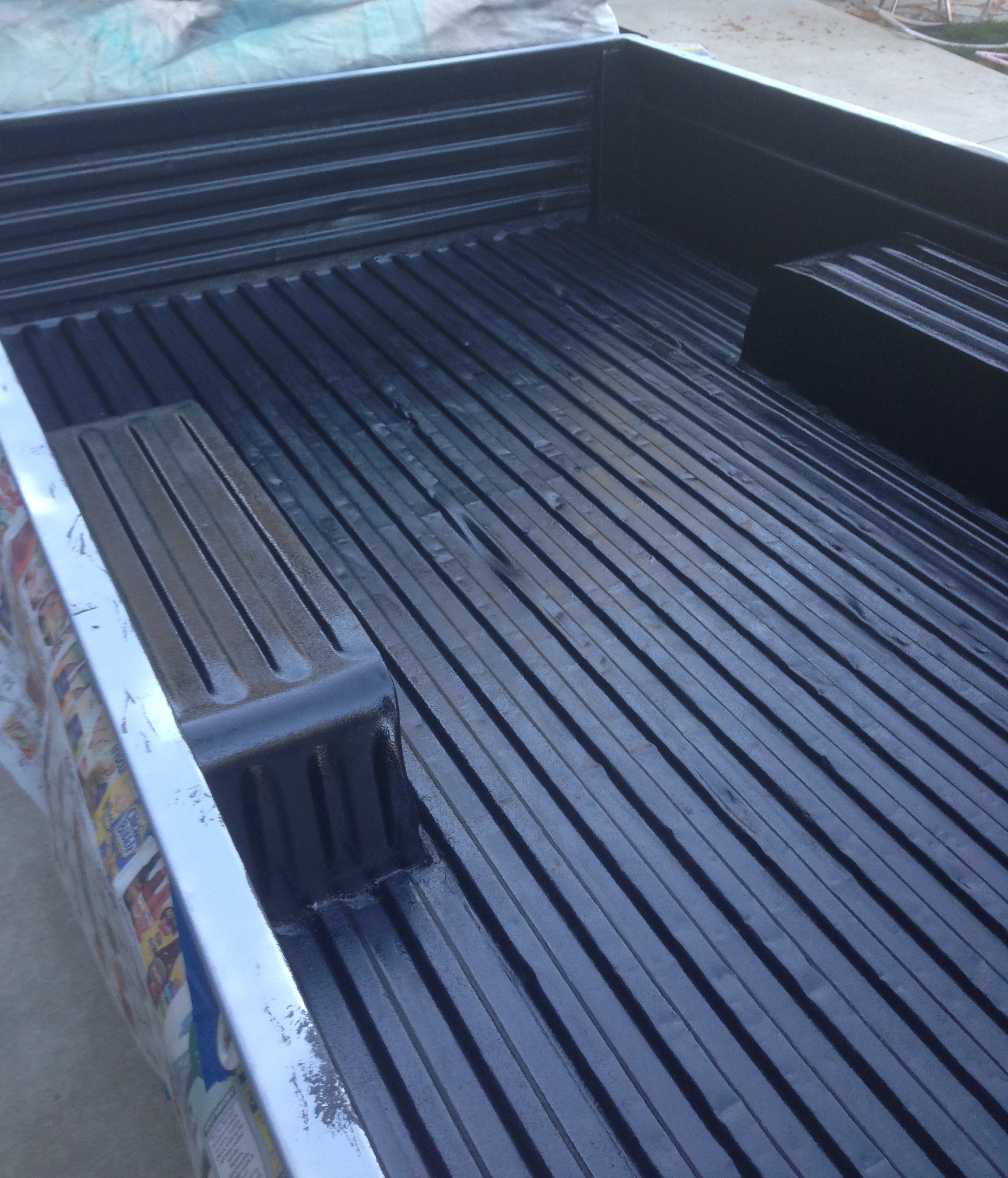

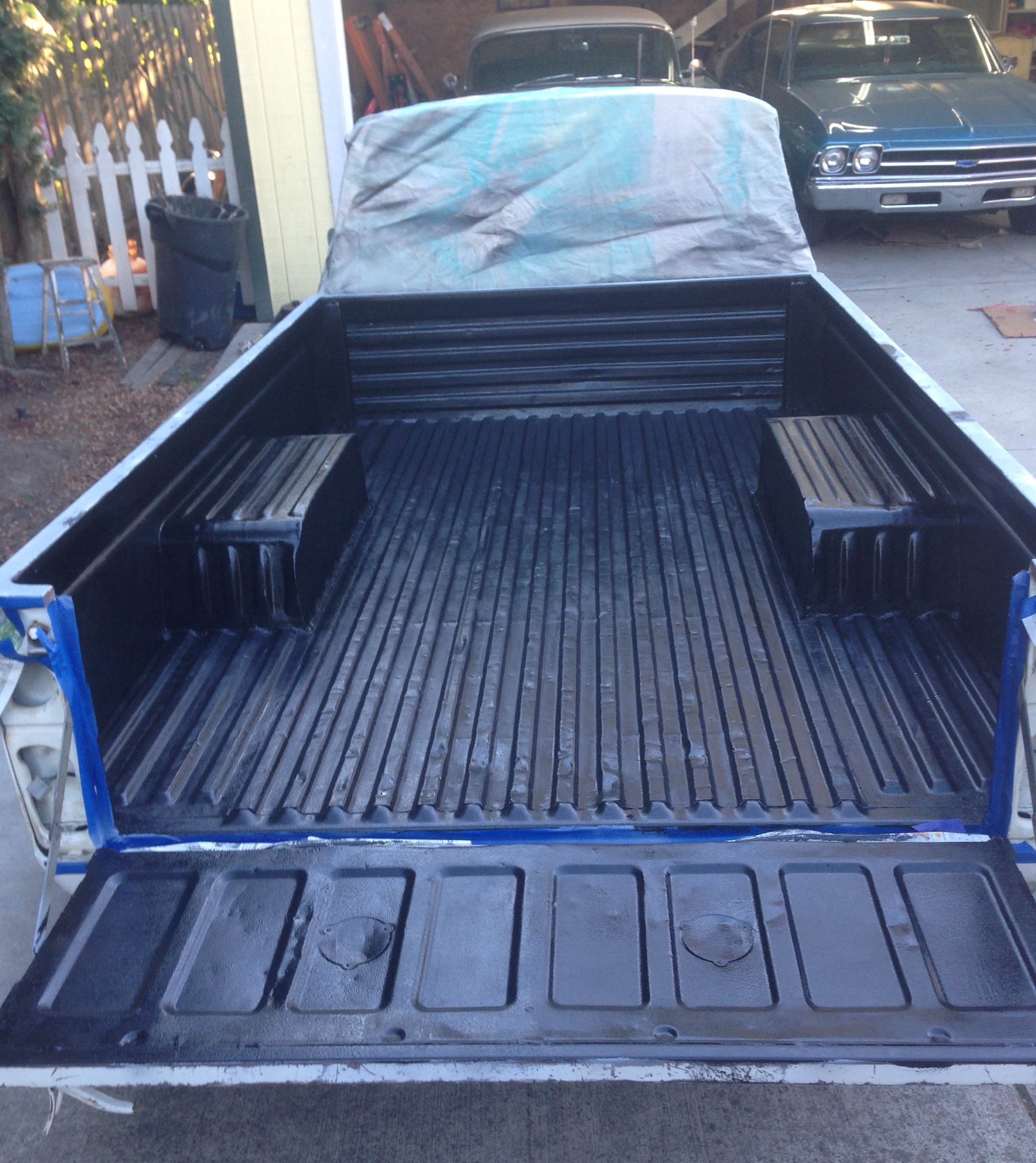

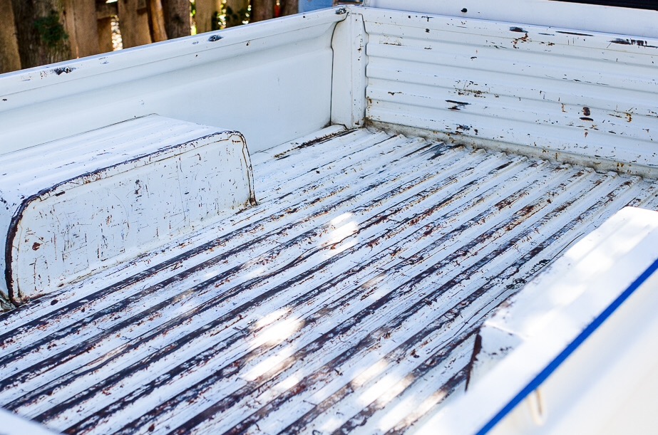

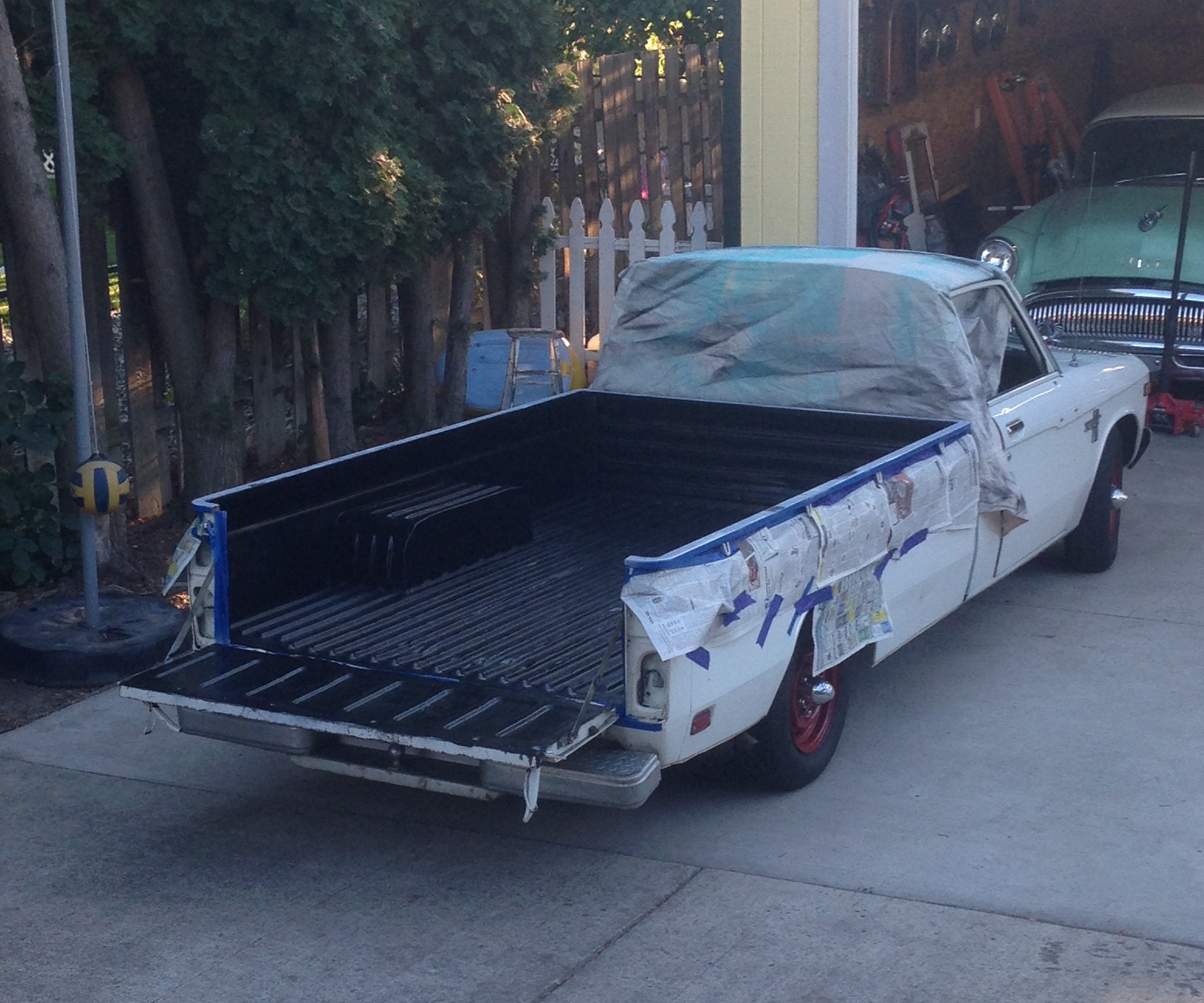

My wife, son and I cleaned, sanded, cleaned, primered, and cleaned again the bed for a roll on bedliner.
We used the rustolem kit. Time will tell how it holds up but so far looks alot better than before.

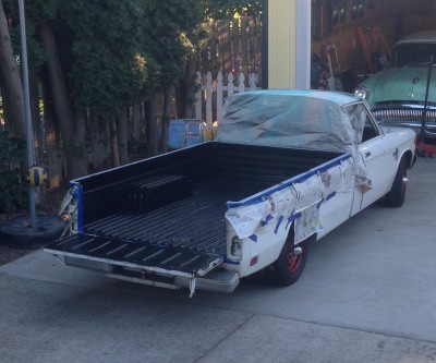

More pics of bed

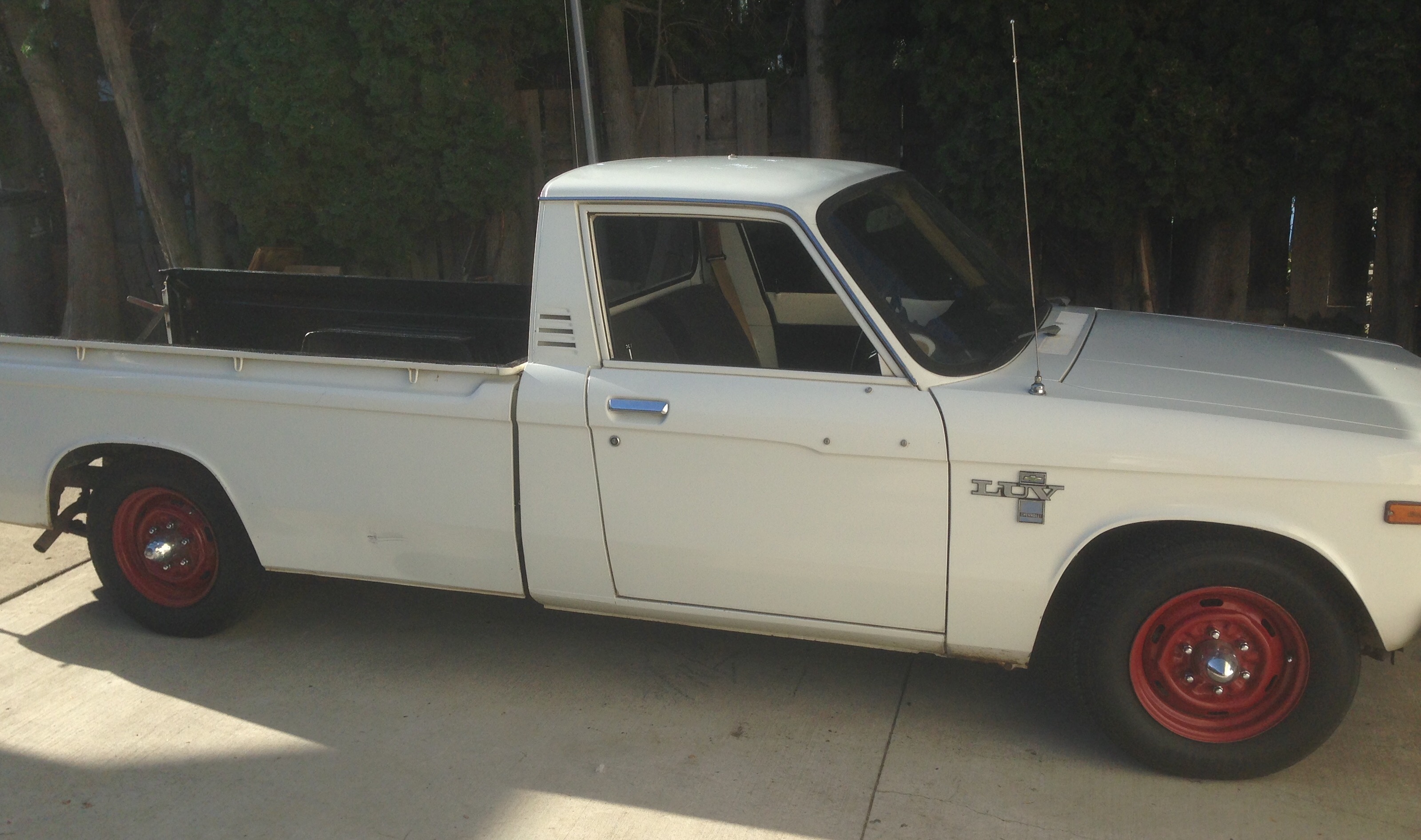

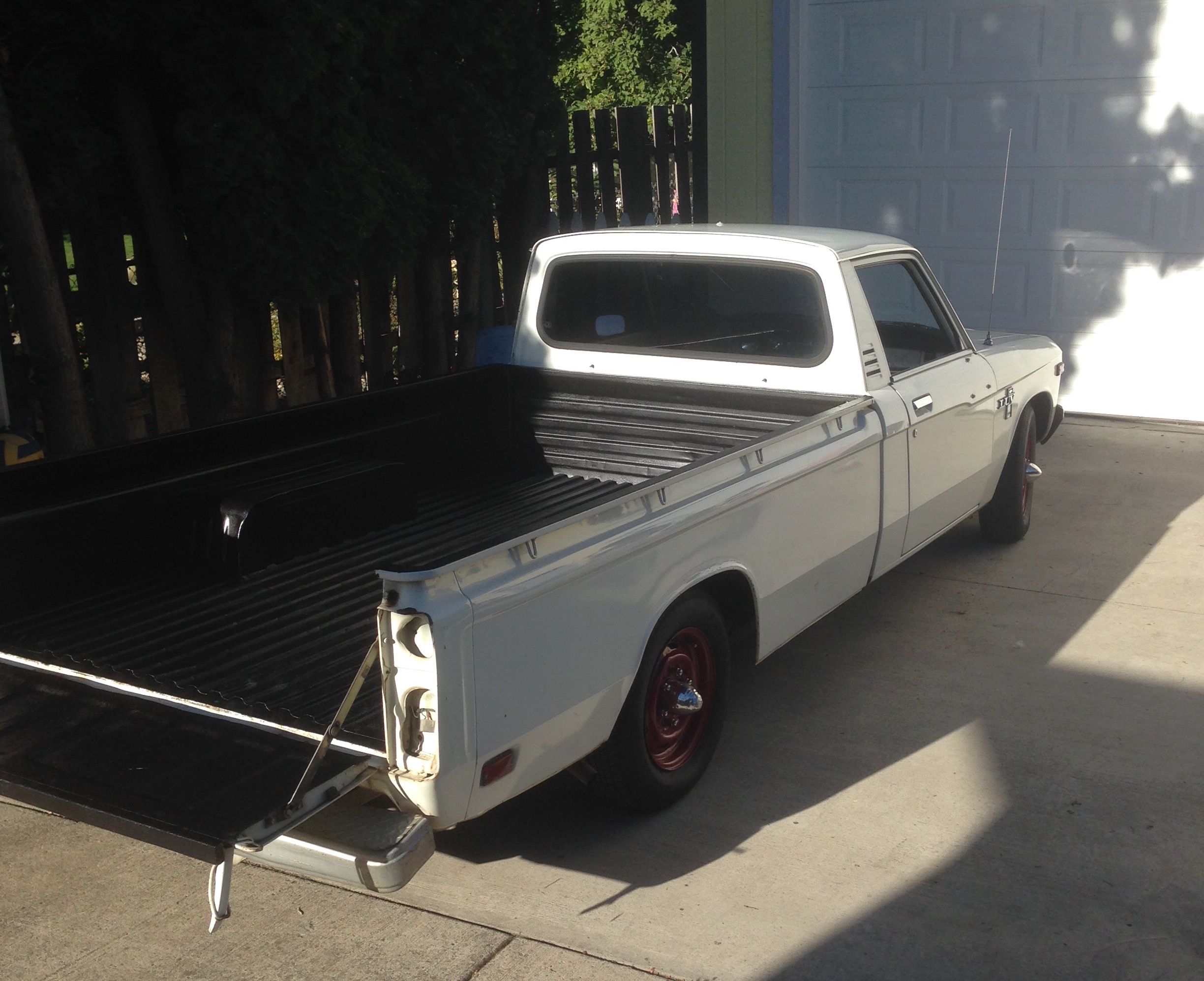

As she sits now. Next up is exhaust, and replace the cracked windsheild.
