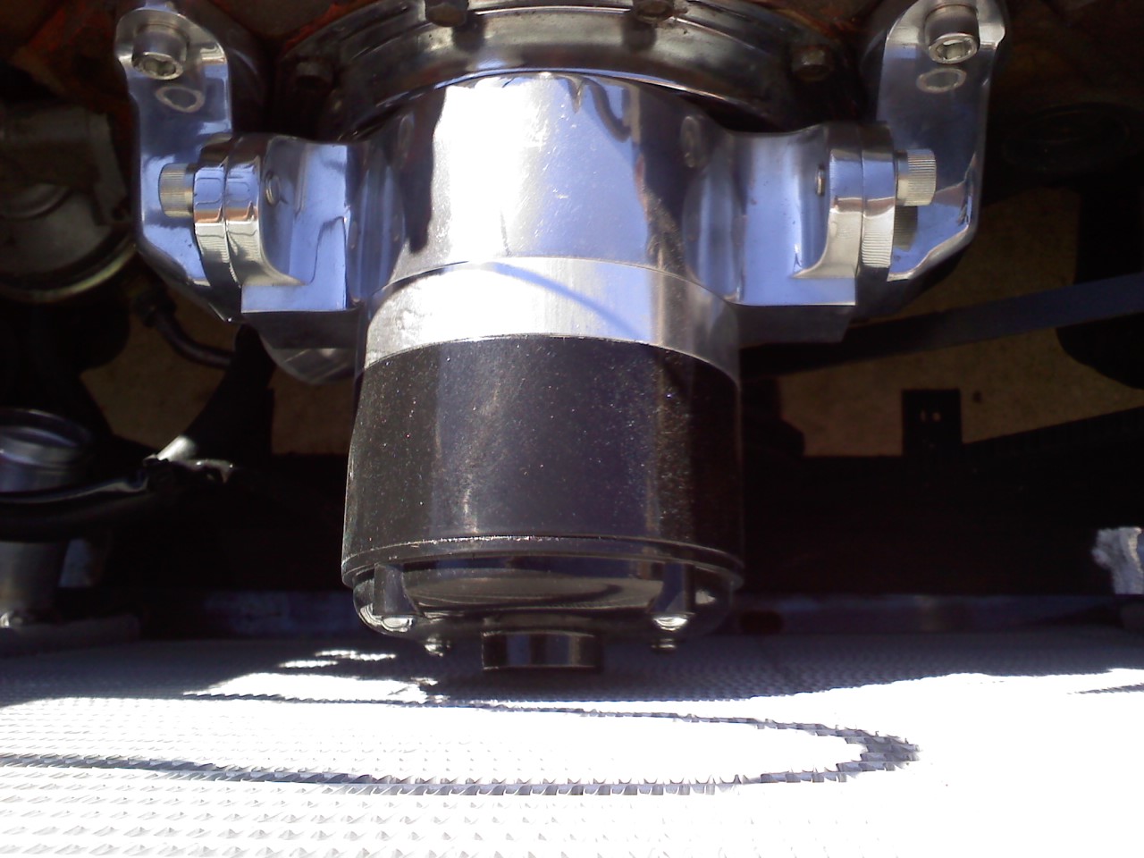

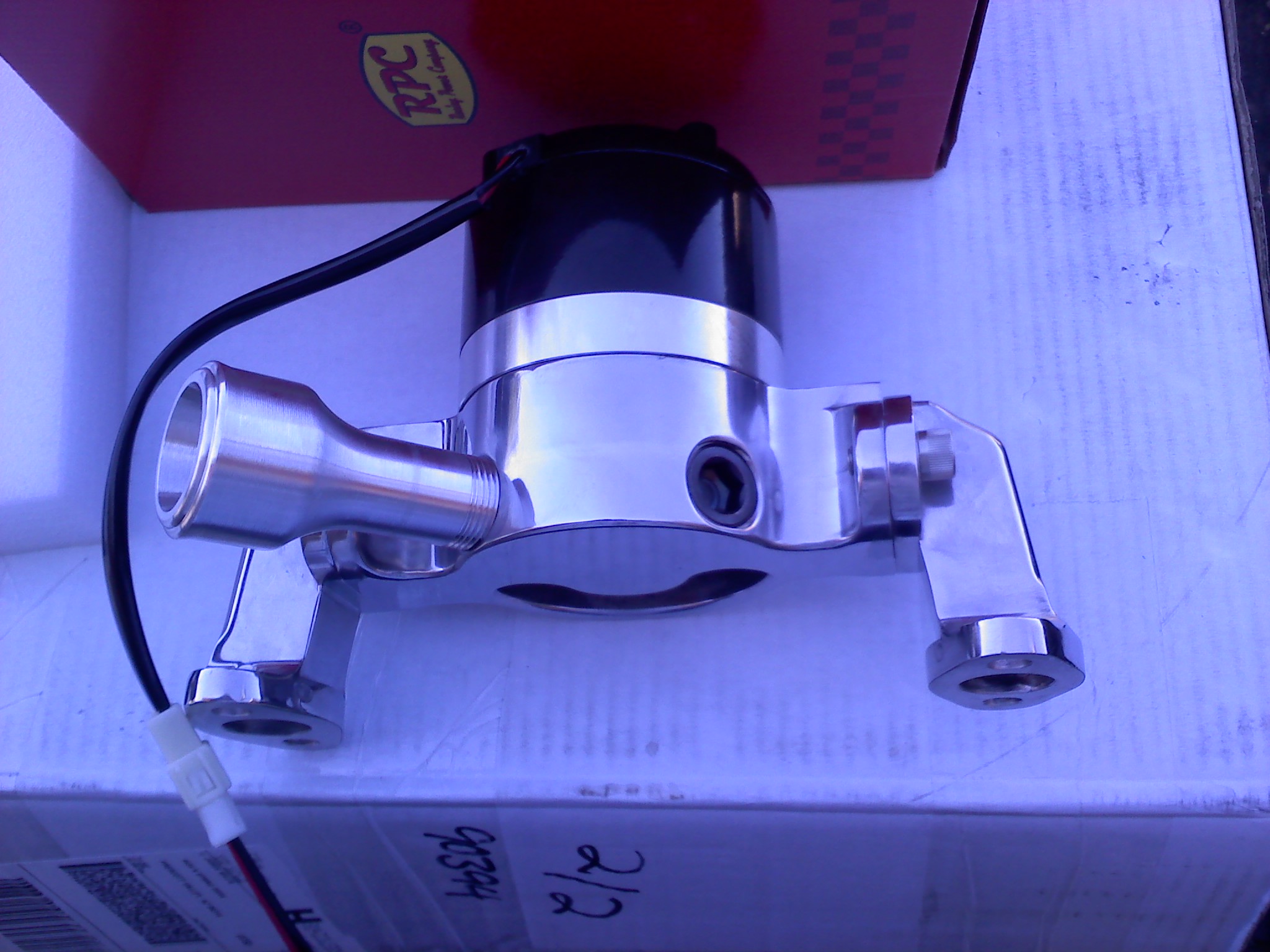

Well found a set of 5lug 5.5 pattern front disc setup for 50 bucks that included the calipers. Will be getting those done either today or tomorrow. Going to put in a 8in dual bladder power booster from a 1980 chevy truck going to take both the booster and master from it and fab up everything should allow it to stop on a dime. I will make sure to let everyone know how it does plus put the plans up on how to do it to your luv. Picked up a electirc water pump so that will allow me to run only the alternator off the crank. I put a 16 inch electric fan with a temp sensor set at 180 degree. it is real tight fitting but covers the whole radiator. running in front of the radiator. next week will start the fab up of the bed going to tub it so I can run the slicks I am going to need. and at the same time going to put a 6 LINK in it. and yes I said 6 link not a 4 link. I will have some parts to be placed on her when I get that done. will have 2 factory gas tanks and filler necks for sale. Going to run a 16 gal fuel cell. it will be sitting in the rear part of the bed recessed in. than I should be at the point to start the body work. Looking for some kind of front spoiler, but no the big square looking ones I am going to see if I can take a early modle s-10 spoiler and modify it to fit. Pics will be comming. Any suggetions welcomed.

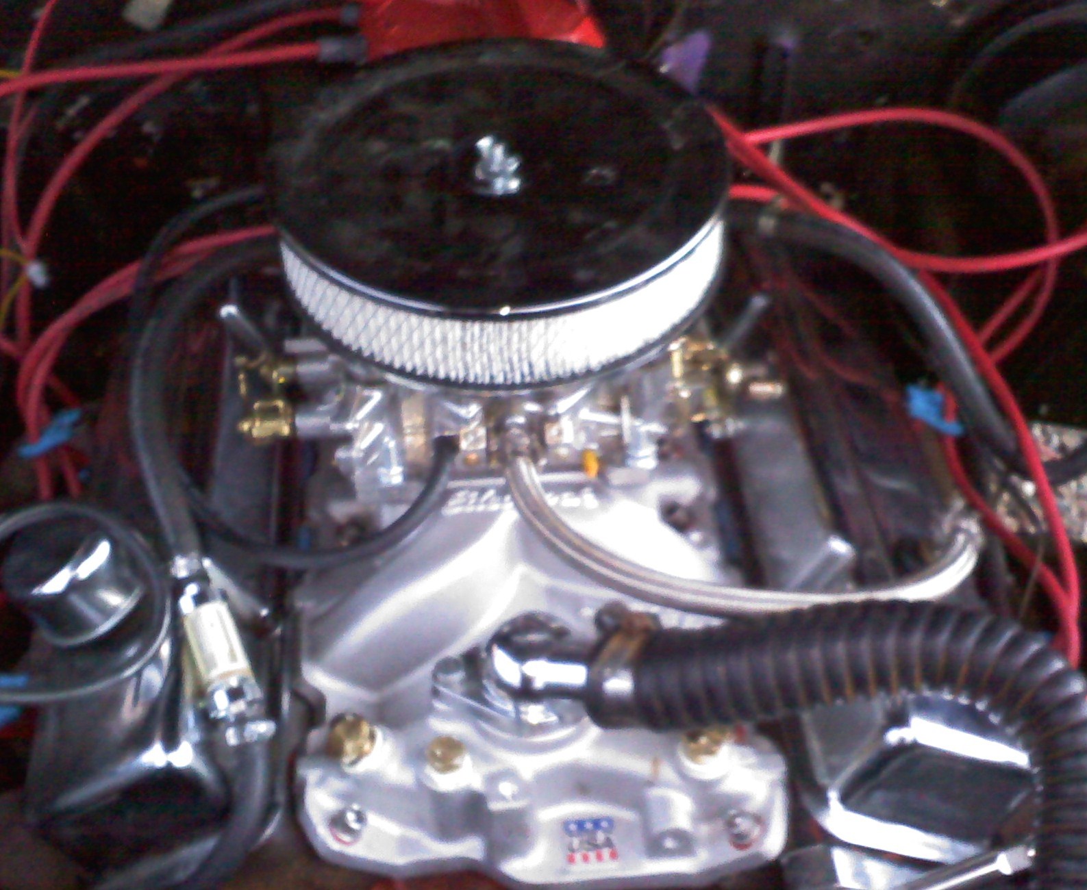

here is a new pic of motor

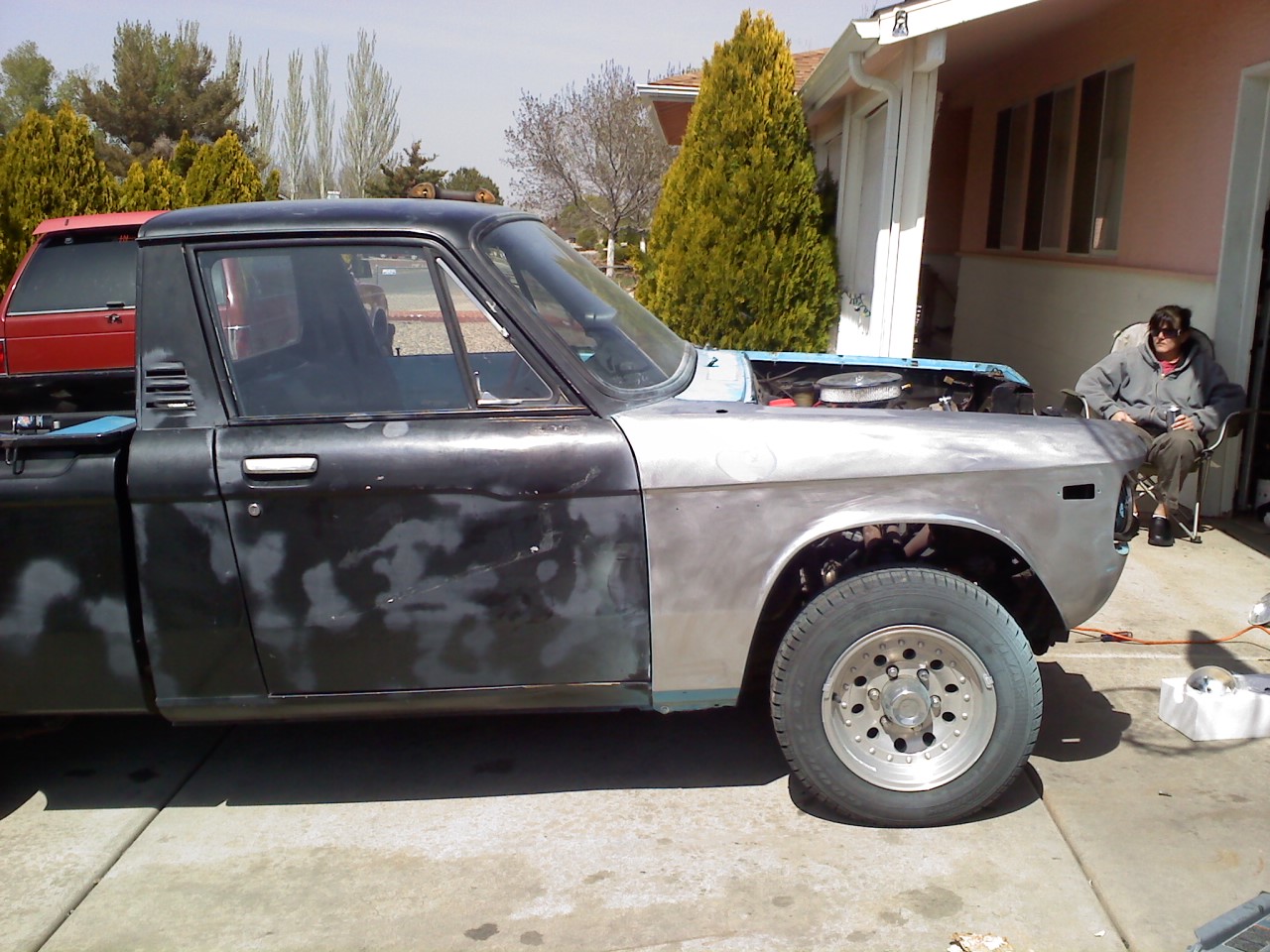

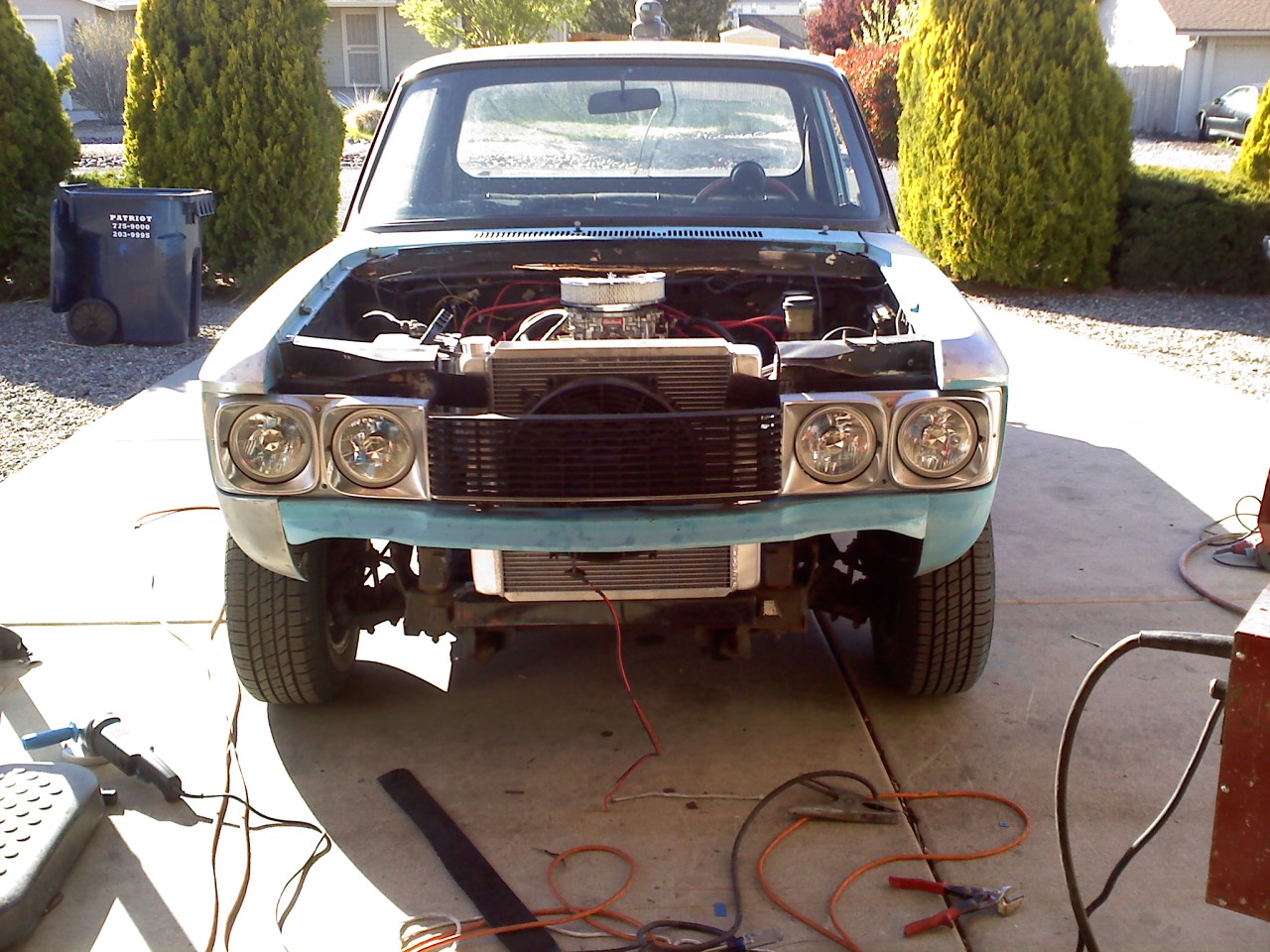

update :
Well got new door on both new fenders new grill with hid lights electric water pump( that was fun space wise ) new radiator. started sanding now pics comming tomorrow folks. thanks for all the support.

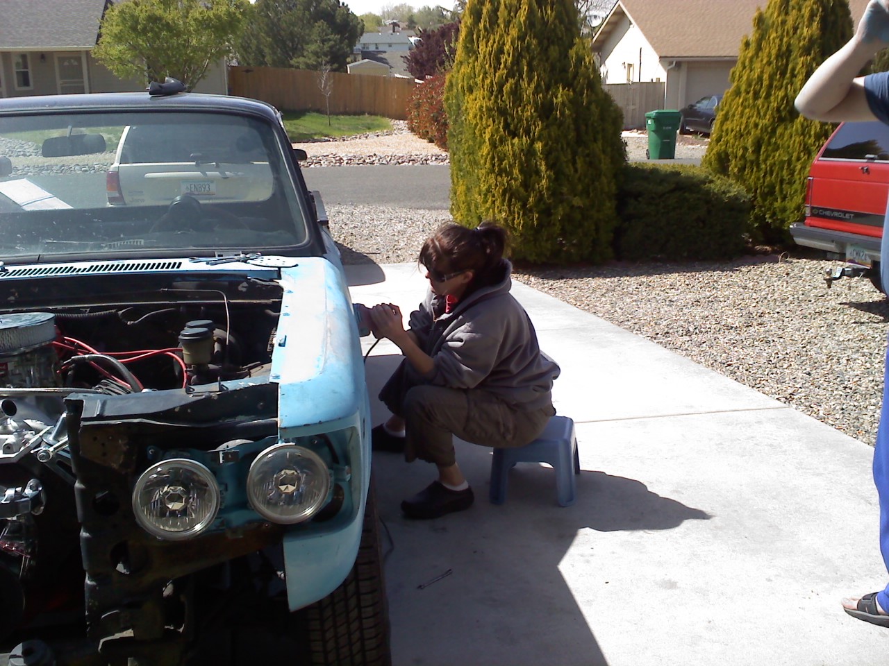

here are pics of the updates
LIVE HARD PLAY HARDER
PostPosted: Fri Apr 15, 2011 9:55 pm
Posts: 190
Location: Prescott Valley Az
more pic

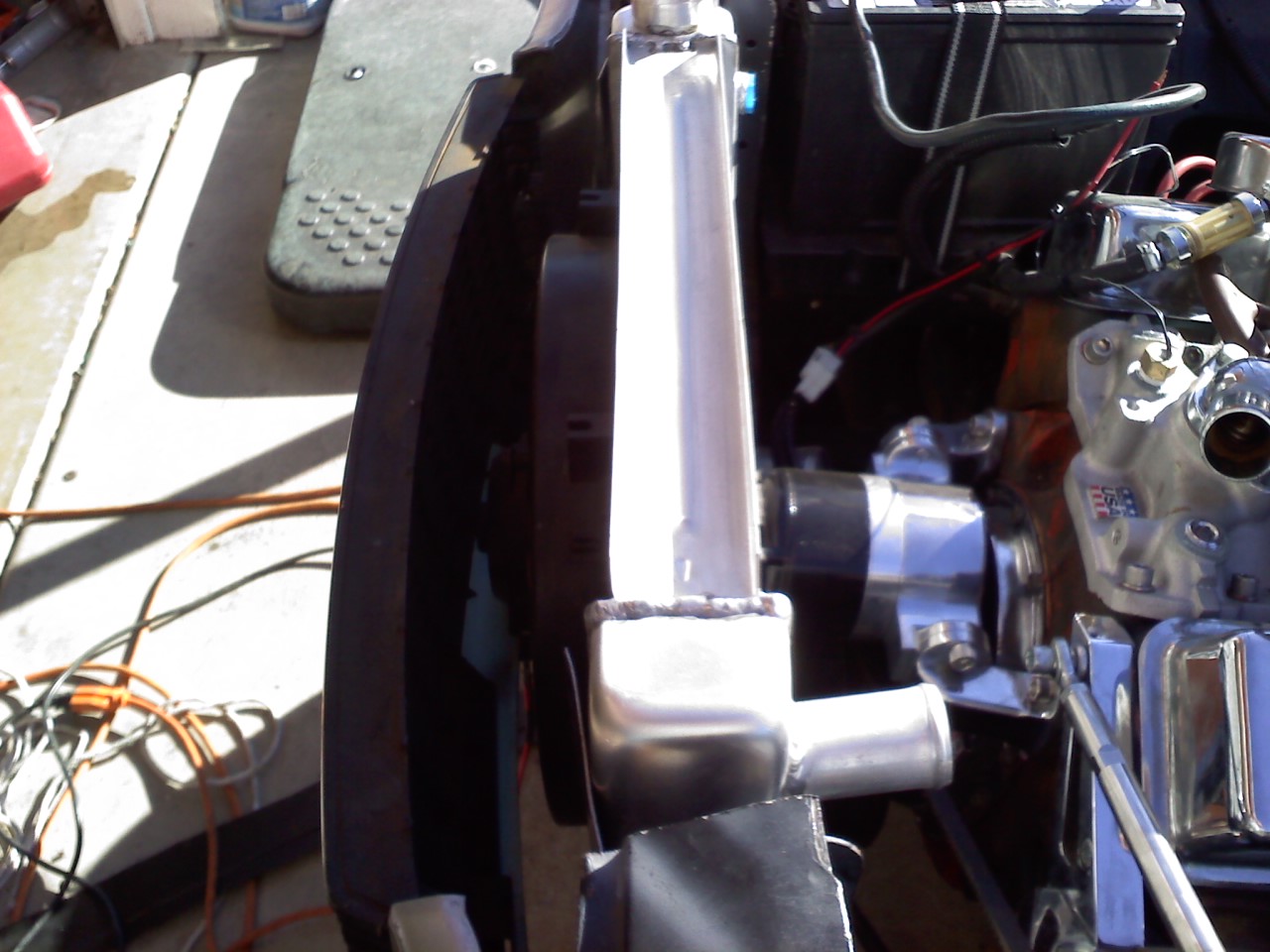

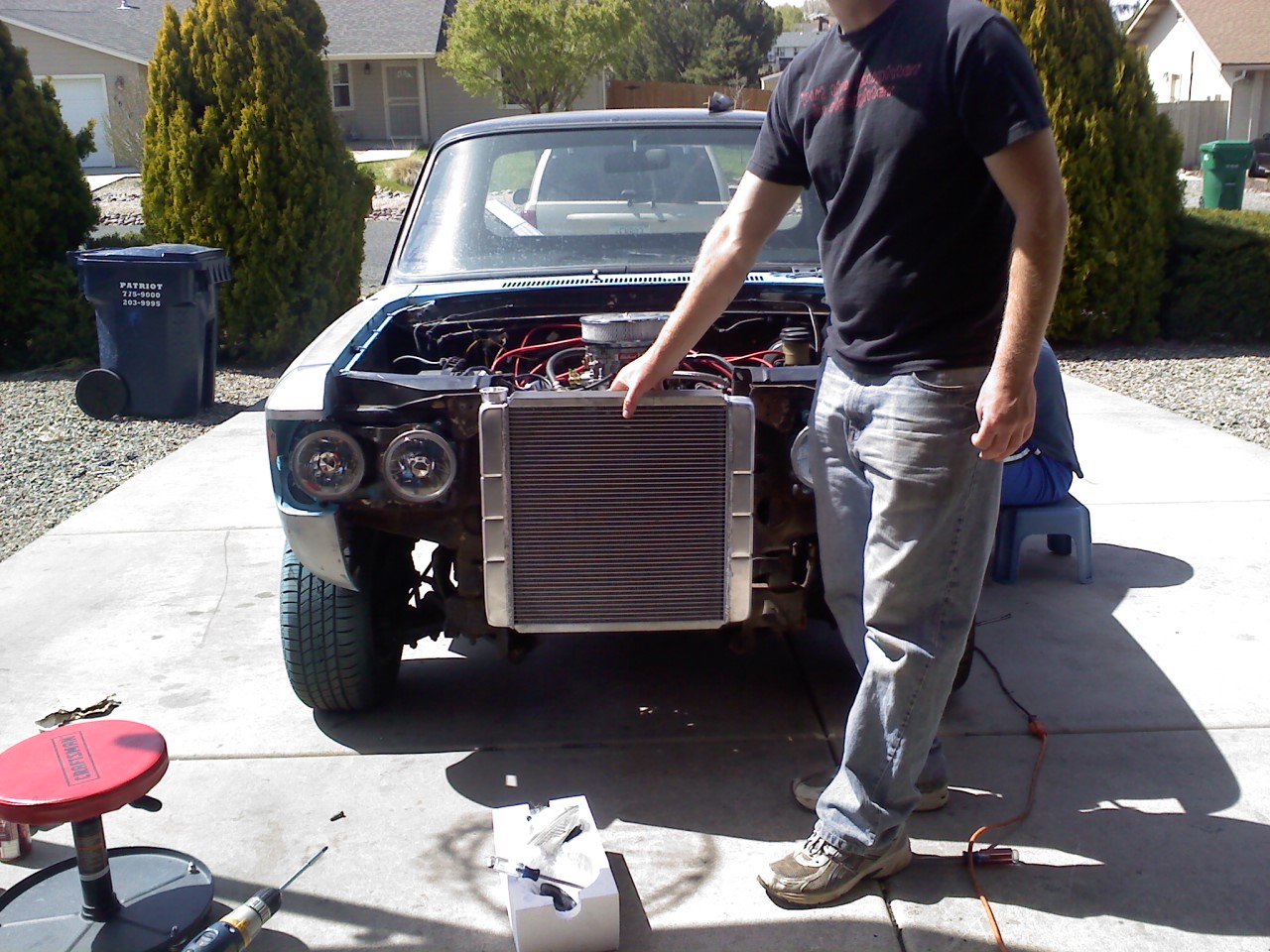

well got radiator and most of front end done
