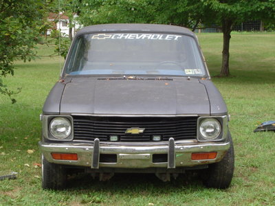

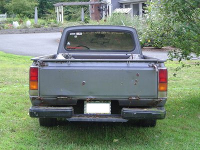

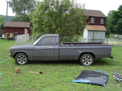

Hey Guys,
I am starting to do some research on restoring my first vehicle, a 79 Luv long bed. I have owned the truck since 1998.
My plans for the truck are to do a frame up restoration. I want to do a V8 Swap and also make it a short bed. i guess my first question is what frame/suspension modifications will i need to do to achieve this and where can I find a short bed in good shape? I live 45 minutes north of Philadelphia, PA.
I already have a rebuilt 350 ready to go for this build. What drive line components are necessary? i.e. transmission, rear...

the frame itself can handle a standard 350 all day long without any kind of problems, very strong, full boxed
hit the ol "search" button and look around the site dozens of people have done the swap recently and can help you with specific info you may need.
i have not done it personally but as far as i understand a 350, with Th350 auto trans, and which ever rear end does pretty good.
stock rear end is able to hold up to a 350 just fine (unless your running race slicks are a heavily modded engine) a lot of people have swapped out the rear end for a camaro or S10 rear, ford 9", DANA whichever to go with their sbc, pretty good list of options since the luv frame is so strong,
as for suspension you could crank the torsion bars in the front end to handle the weight of he engine better, or you could swap in some coilover springs to the front end for a better ride.

I am pretty sure that a longbed frame is specific for a longbed box. A shortbed will not line up at all on a longbed frame. You would have to use a shortbed frame.

i was thinking that but wasnt sure,, pretty sure the wheel base was extended for the longbed a short bed wouldnt fit properly, maybe shorten your bed a bit?

the shortbed luv wheelbase is 102.4" the long bed is 117.9" (says wikipedia usually right)

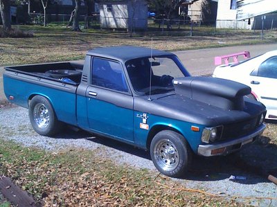

i have the v8 swap done in my 79 luv. its a 383 stroker with a turbo 400 tranny. i used a 12 bolt chevy rear end so i didnt have to worry about two diffrent rims bolt patterns. i can answer most of your questions but ya got to be more specific on what ya needin help with.
 Post subject: Re: HOTROD LUV
PostPosted: Mon Mar 21, 2011 7:24 pm
Joined: Fri Feb 11, 2011 10:30 am
Posts: 17
Location: Louisiana
this is my toy
