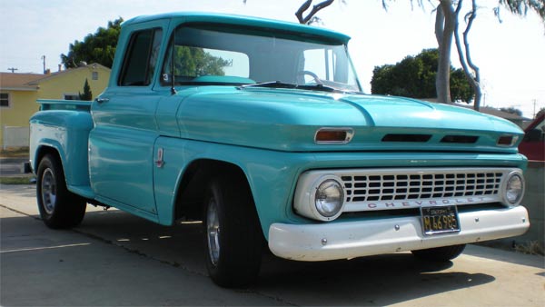

with LUV we make a serious training there because of our love to classic cars -> for example four our friends we search constantly for another Chevy Pickup - first generation C10 stepside like this
my friend wife like the Twilight saga and with Chevy like this rides the Bella from Twilight exactly and she want to have same pickup like the Bella from this movie :)

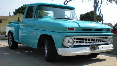

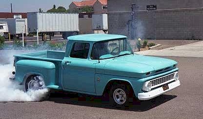

PostPosted: Fri Jun 03, 2011 6:55 am
You are making great progress on your truck.
What a small world. I sold my 63 C10 last January to a car collector from Sweden. Now my truck is over there. This is when i decided to get back into Chevy Luvs again.
