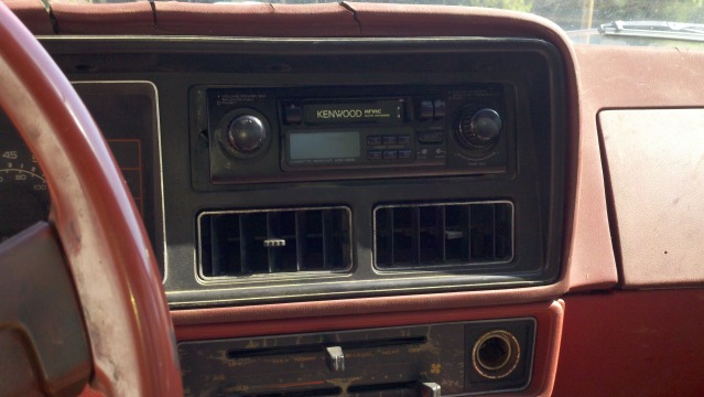

Tripled the value of the LUV this afternoon. Put the stereo in. Sounds great.
