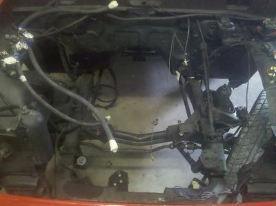

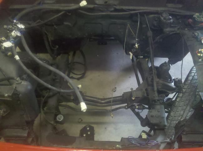

Here, hope this works!

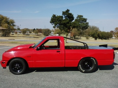

1981 Luv!
http://i1029.photobucket.com/albums/y35 ... 1295547781
