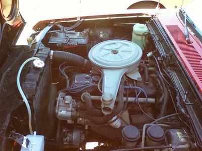

Hey guys,
I've decided that I'm gonna tackle the head gasket job. I'm going to post all of the pictures I take here so you guys can guide me through the process and let me know if I'm making any mistakes. This could take several weeks (I really hope not, but its possible) so please bare with me, lol. :P
These are pictures of a few of the symptoms I've been experiencing.
Blowing smoke out of the tailpipe.
Overheating even after replacing radiator, hoses, flushing twice, adding overflow tank, and radiator cap (Will replace thermostat soon). Sorry, no pics of it spewing steam. :lol:
Erratic vacuum readings at idle. (Just a pic of the gauge, the one on the right side of steering column.)
Dripping coolant down the block (This just started yesterday).
Low Compression in all four cylinders.
The compression readings were:
Cylinder 1 (front, closest to radiator):
95+100+105+105+102=101.4
-plug was wet - yellow & green color
Cylinder 2:
90+90+90+87+87=88.8
-plug was damp - brownish color
Cylinder 3:
89+85+84+85+84=85.4
-plug was wet - reddish color
Cylinder 4:
100+97+97+98+99=98.2
-plug was dry - brownish/blackish color
These numbers are low right? I think its supposed to in the 130's about.
I overheated the engine real bad once also, so I suspect I might have a warped head contributing to the low compression. Let me know if you think that something other than the cylinder head or the head gasket could be causing any of these problems.
I bought a completely rebuilt head for $175 here in the classifieds and a Head Gasket Kit for $65 at Advance Auto Parts. I also bought a torque wrench at Sears for $25.99 (old school beam type), and the compression tester in the pictures for $22.00 at AAP. (This is more for my purposes, trying to keep track of total cost, lol :lol: ) The last of the parts will get here Friday, so hopefully I'll be able to start tearing it down Saturday.
I'm going to try to do the entire job with the engine in the truck. I've got a buddy to help me who'll let me borrow tools and his garage, which is a HUGE help. I've also got an old Chilton service manual and Figuarus's head rebuild thread to guide me (viewtopic.php?f=5&t=20873). I'm always open to any suggestions or tips you guys have, so please don't hold back, lol. This is my first major automotive repair, so bear with me. :D

If the tailpipe smoke has the sweetish antifreeze smell, it is almost certain the gasket is blown.

Pic#4 is the clincher...

So i picked up the gasket set today, but I'm still waiting for the head to come in. I'll be driving it to my friends garage soon also. :) Hopefully I wont get pulled over for polluting the neighborhood. :lol:
Haha, ya, the gauge was there when I bought it. Its nice to see what ur engine is doing while u drive, lol. The needle bounces between economy and idle range (about 10 degrees) when idling, but stays constant in power or economy range when revved. Never had it in the supercharger range.... :o lol
And ya, now that u mention it, the smoke does smell kinda sweet. Maybe thats why I never knew it smoked until someone pointed it out, I was originally trying to smell burning oil, but it doesn't smell like that. lol It's got a greenish tint too, so its coolant no doubt.
Ya, it just started leaking like that. It's almost a constant *drip drip drip* from the bottom of the oil pan when I run it now, =(

be careful with what head gasket you get( felpro )is not for a 1.8, its for a 1.9, 2.0 (ect) i found that out with lots of looking up stuff you need to get head gasket victor renze 3553 better matching and more meat in between the cyl fire rigs are thicker also ill post pic of the gasket i bought and another thing call felpro complaing about there head gasket THEY WILL TELL YOU ITS FOR 1.9 haha they need 3 headgaskets for the engine not a universal 1

Ok, so I found out that I did the compression test wrong, I didn't have the throttle open all the way. :oops: So I'm going to retest it tomorrow. I'm also going to put about a teaspoon of oil in each cylinder on the second round to see if the numbers change (supposed to tell if the rings are bad.) Hopefully I'll do it right this time, :lol:
Um shoot, the gasket kit I got is a Felpro...... Should I take it back? It looks like it'll be alright, but if you've had trouble with 'em, I don't wanna mess with it.
Here is a pic of the gaskets. I don't even know where all of them are supposed to go, :lol:
This is the information on fitting etc. that was on the box
I did notice that the years they showed on the box were wrong, but the guy at Advanced Auto Parts said its supposed to fit. Do you think it'll be alright? I will have to apply sealant on the head gasket cuz its metal, but the guy at AAP said it was the best they had.... :(

Some of the stuff you will sort out as you take stuff apart. I think you have carb to manifold gaskets. If you don't take the carb off it, you don't need new gaskets. I think the O-rings go in the block around oil passages. The 8 things in the clear pack are the valve guide seals. If you were having your own head rebuilt, you would give them to the shop to install.
