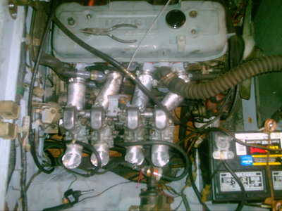

trying to figure out how to run my lines

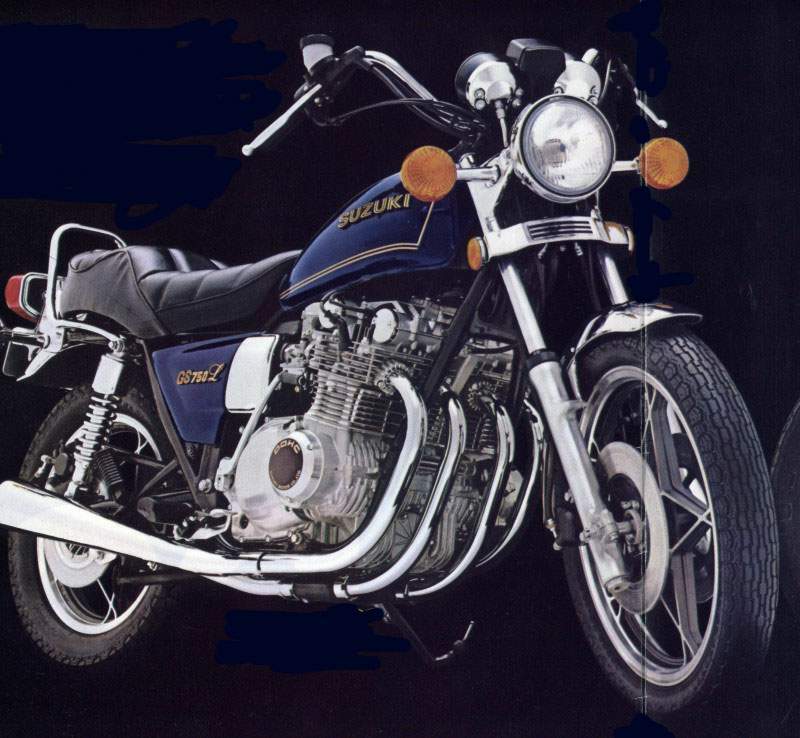

gs750 + 77 luv

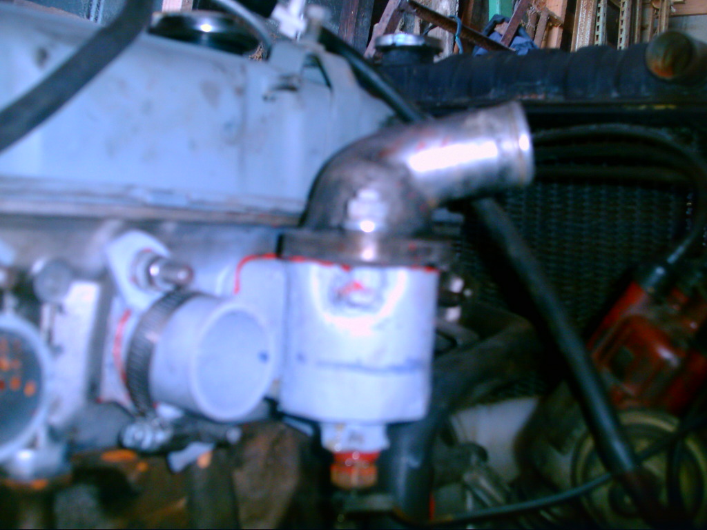

any pics of just intake and the thermostat area?

yeah ill get some up today its under my thermostat ..im having problems..my im not geting fuel the bowls fill up but nothing comes out..the guys at KZrider.com are helping me and i have a coolant leak around the bottom of my timming cover...my throtle cable is something else though i snached a bike break cable and ran it through a choke cable housing i got for six bucks and used the ends on my stock cable and it works pretty good a little stiff but it works

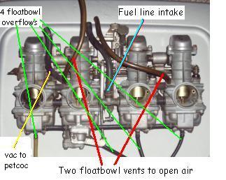

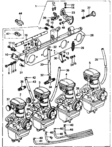

the guys at the kz forms are saying that there is no vaccume on the carbs and that because of the preasure in the bowls from the fuel pump it might not work so im going to try gravity fed and see if that works

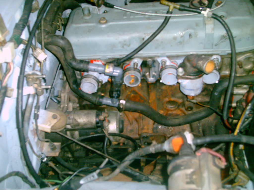

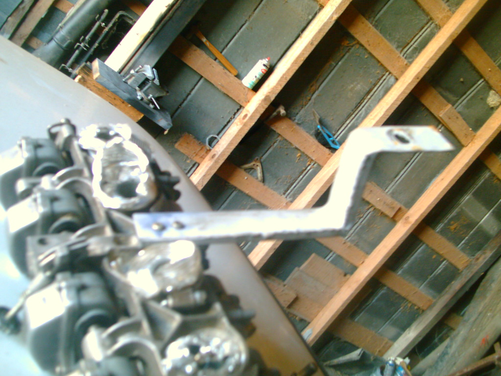

pics of my intake and bracket

yes no pump valve or power valve. it works off vacuum only. on mine i pull the choke just a bit turn it over a couple time then it fires right up.... if the motor is already warm it just takes one try... so when you go to start it dont need to push the throttle cable down as it will do noting but move the butterflys , it wont help to start it at all... have you tried running it yet?
oh and the pic of the carbs is he way the R1 are also with 2 vents and 4 drains with 1 fuel in ...

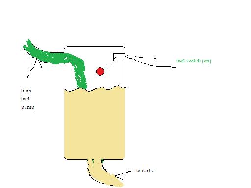

so you are saying that i will pull the fuel from the tank ......i was thinking of having to make a small tank that would feed the carbs like the motorcycle would do...... i have turned it over yes but i there is no fuel coming from the jets.... going to work on it today

here is what i was told.
Quote:
they have no pump jets so if your pumping the throttle all your doing is moving the butterflys.The choke is the sliding bar at the front of the carbs,its not a choke as such but when pulled open it to allow fuel to be sucked directly out of the float bowl through the little holes which are located in front of the butterflys.We usually set the idle mixture screws to 3 - 3.5 turns from fully in, any more than that and it starts to interfere with the cross over between idle circuit and the needle circuit
i am using the R1 fuel pump as it turns on and off automatically depending on fuel pressure and level needed. that way the fuel bowls are always at a constant pressure and level...i dont think there would be a need for a gravity feed but thats just my opinion ...
