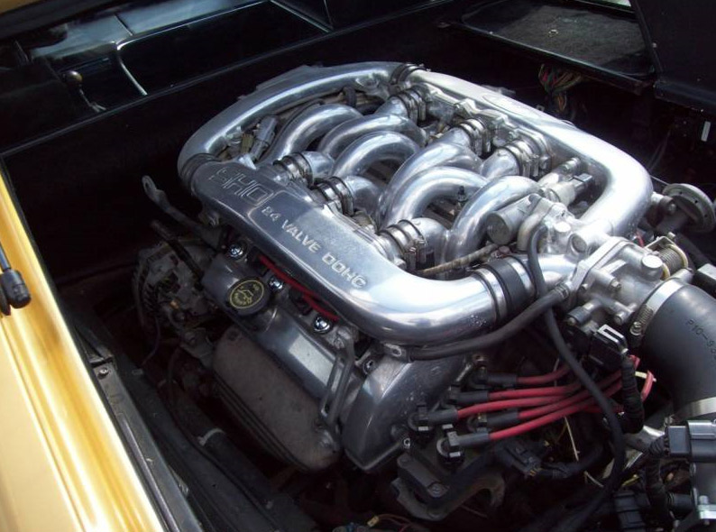

O and Hey Wouldnt a Yamaha Sho 3.0 or 3.2 in a luv look bad@$$! 8)

that would look epic in a luv 8) i dont think i have ever seen an intake like that before.. well except on a viper.
