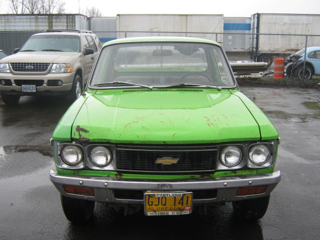

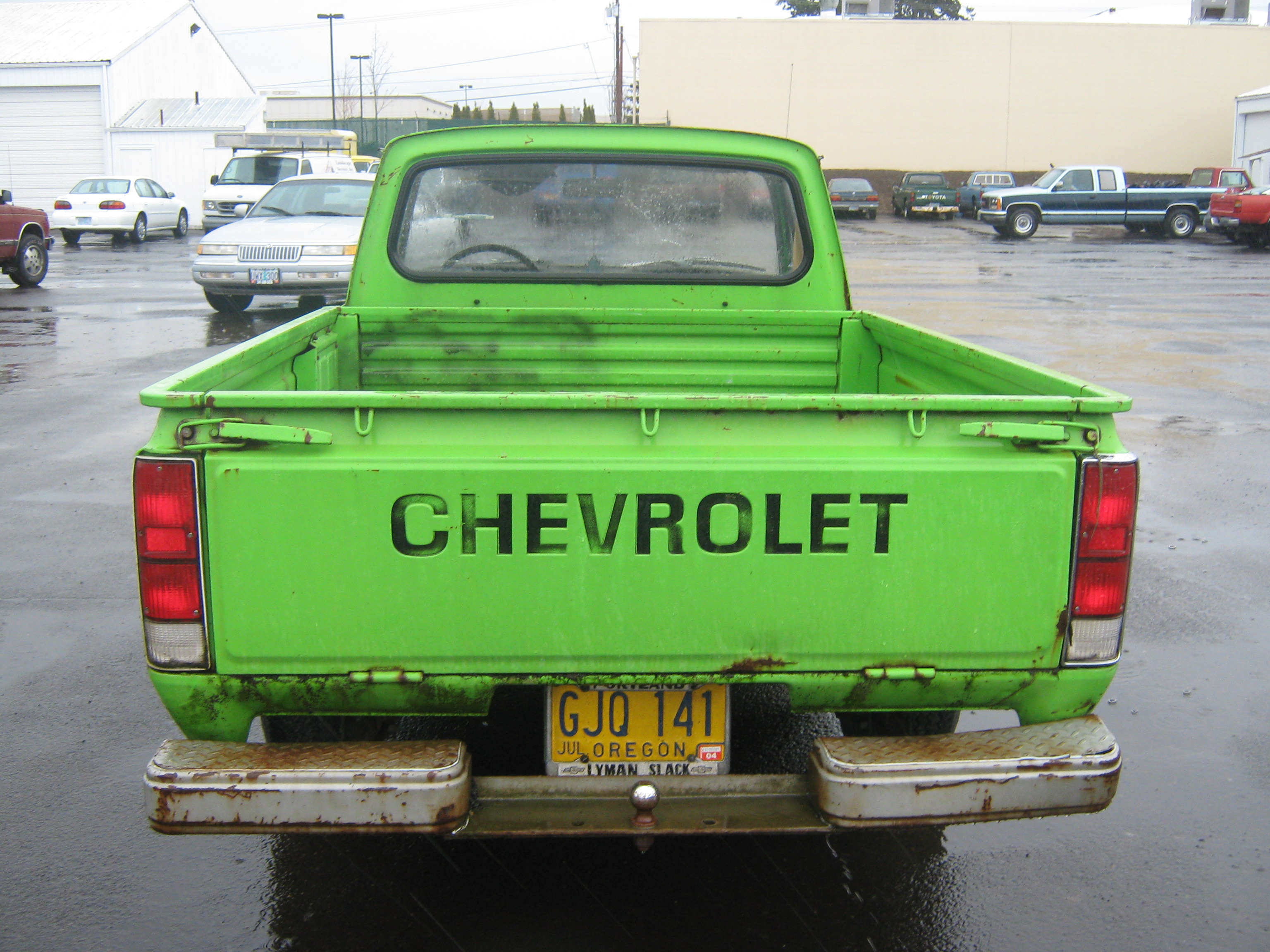

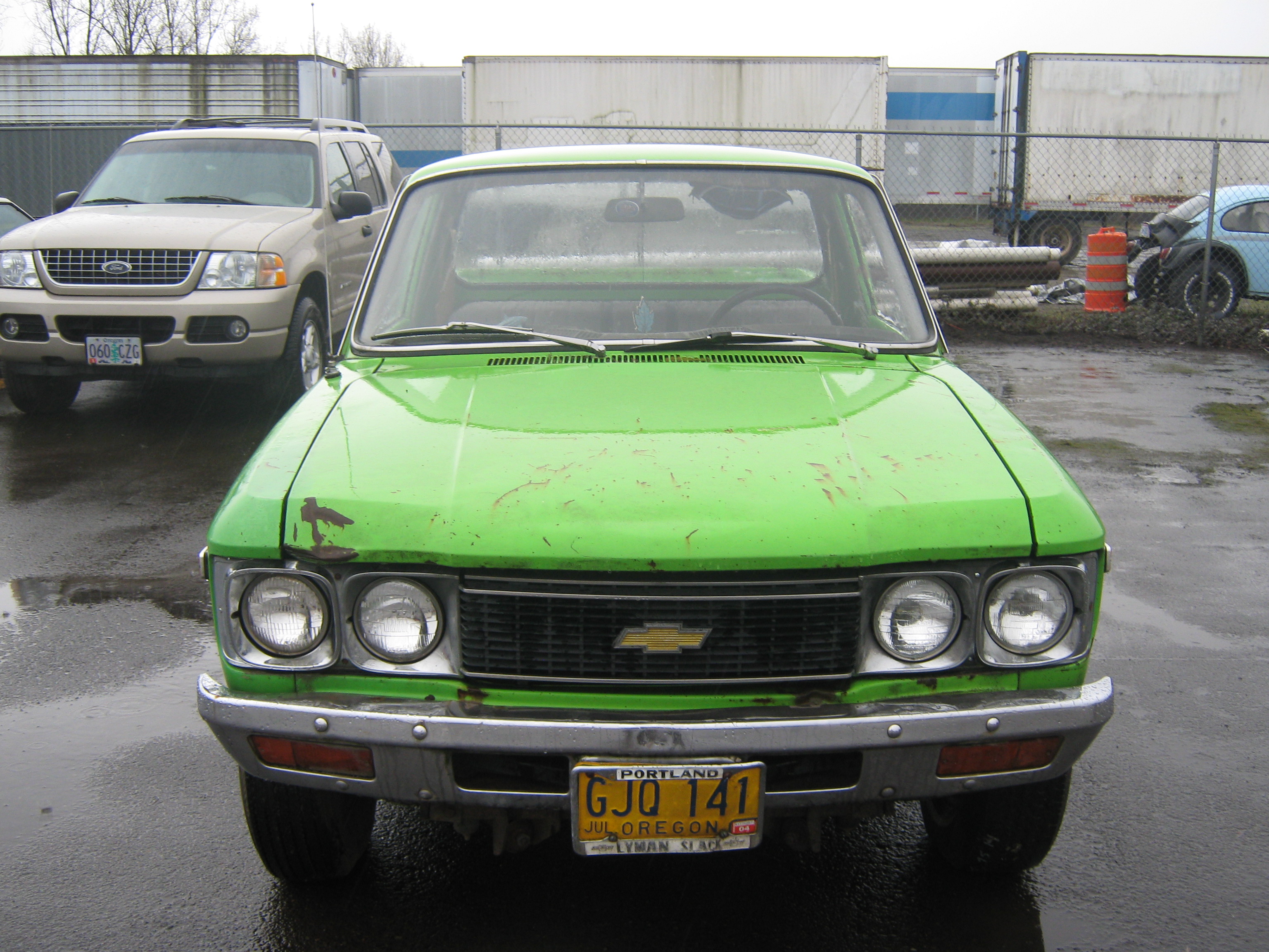

here it is,my 76 mikado,a little rough but workable!what do ya think,$200 +$200 to transport. I plan on dropping it a couple of inches,going with 15 in.ralleys w/beauty rings and caps.i have a weber on order, after that isuzu dist.,5 sp, pacesetter header,shave and port the head,etc.thanks to all who make this site so great! :ebiggrin

76 mikado project,mean green
 Post subject: Re: 76 mikado project
PostPosted: Mon Feb 23, 2009 9:36 pm
Looks like a deal to me...
I would say you got a good deal. I don't think it looks too bad.

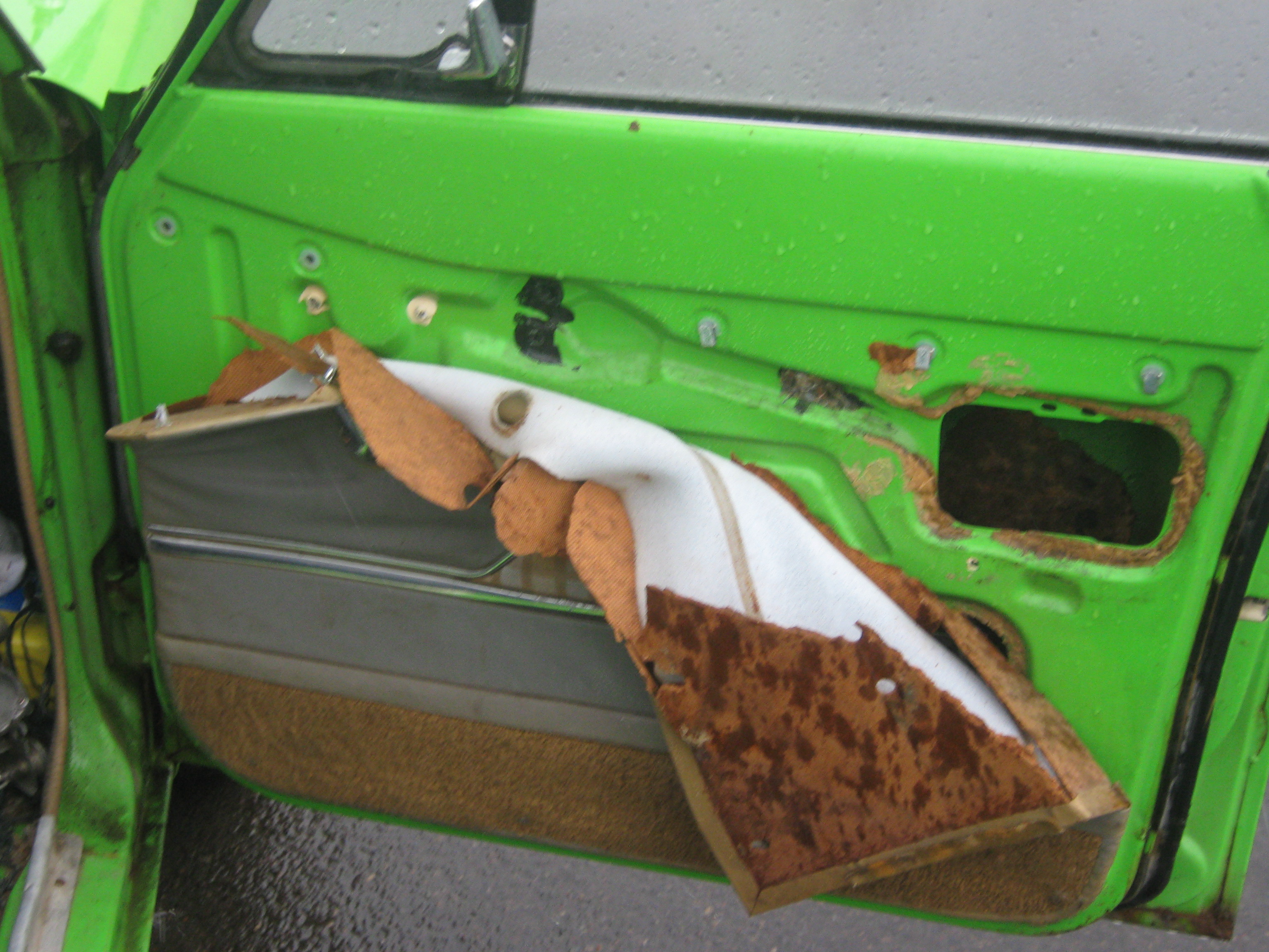

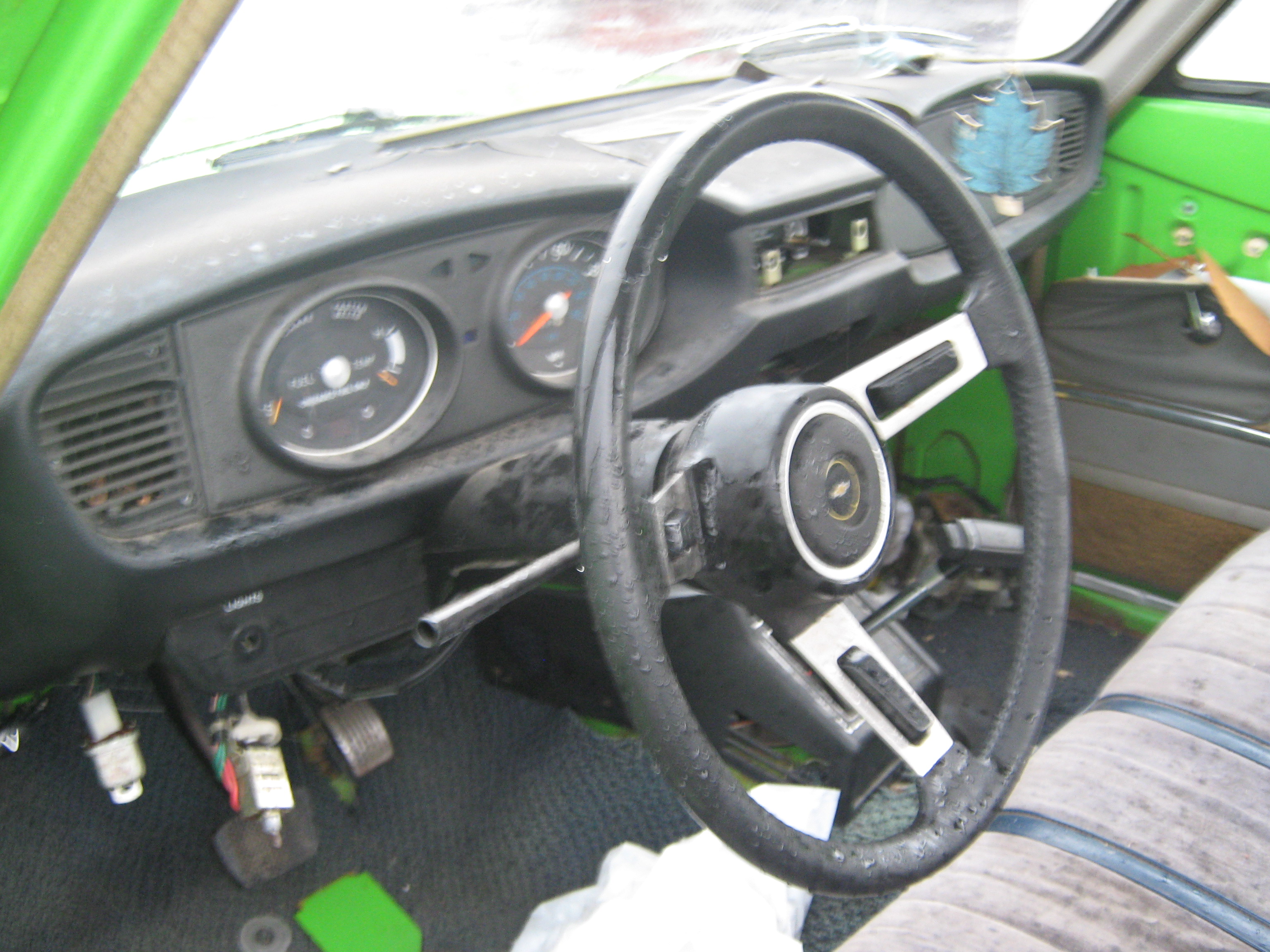

thanks! interior looks kinda like a racoon lived in it!
PostPosted: Mon Feb 23, 2009 10:40 pm
she is kinda tattered, isn't she!!
PostPosted: Mon Feb 23, 2009 10:41 pm
yes the hood can be fixed... i have the tools here to do it if you get bored one day during the week and if you don’t want to fix it i still have the other option for you

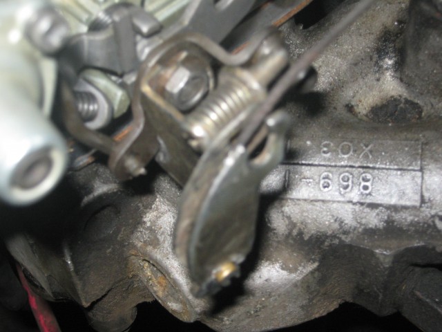

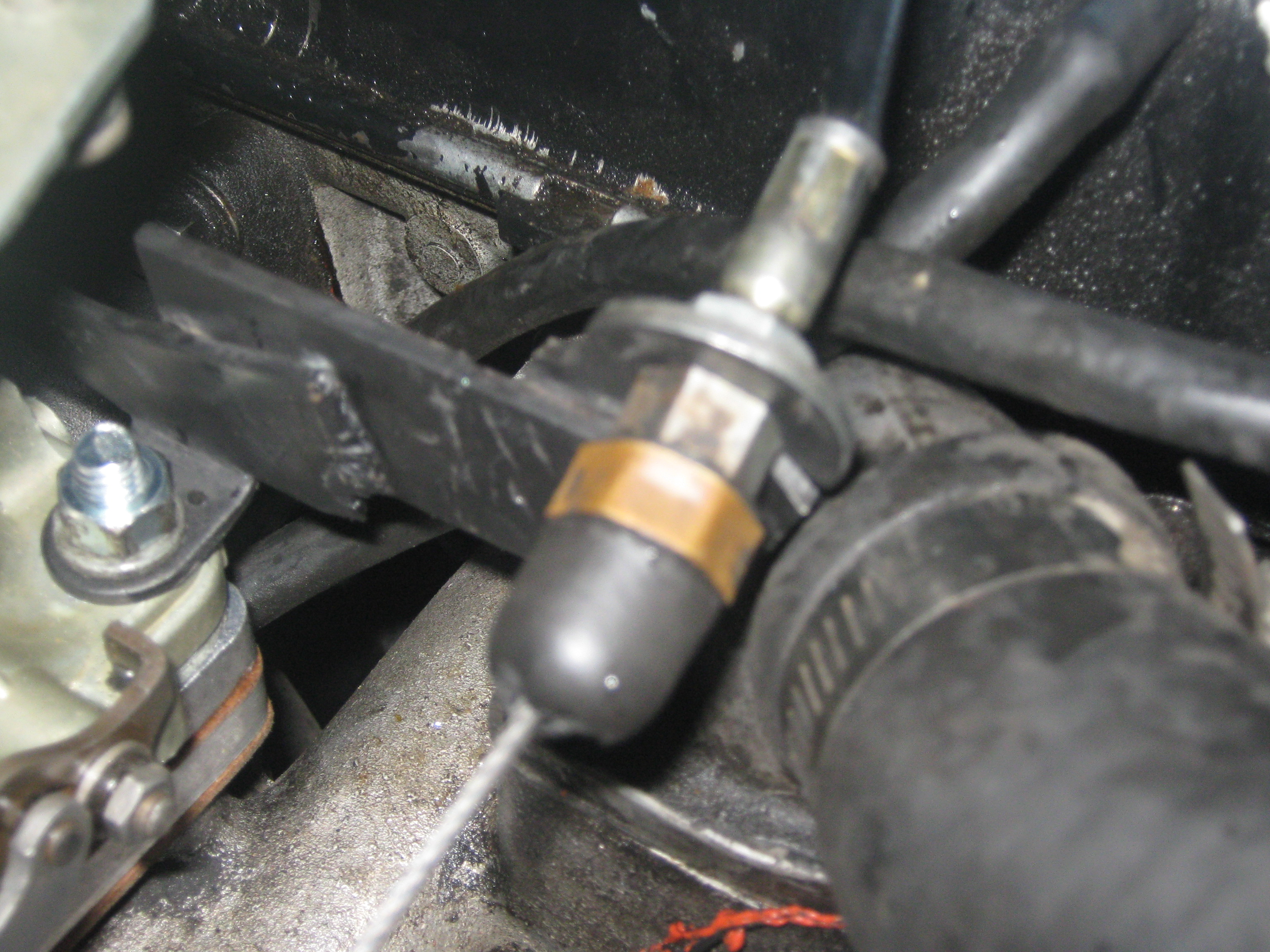

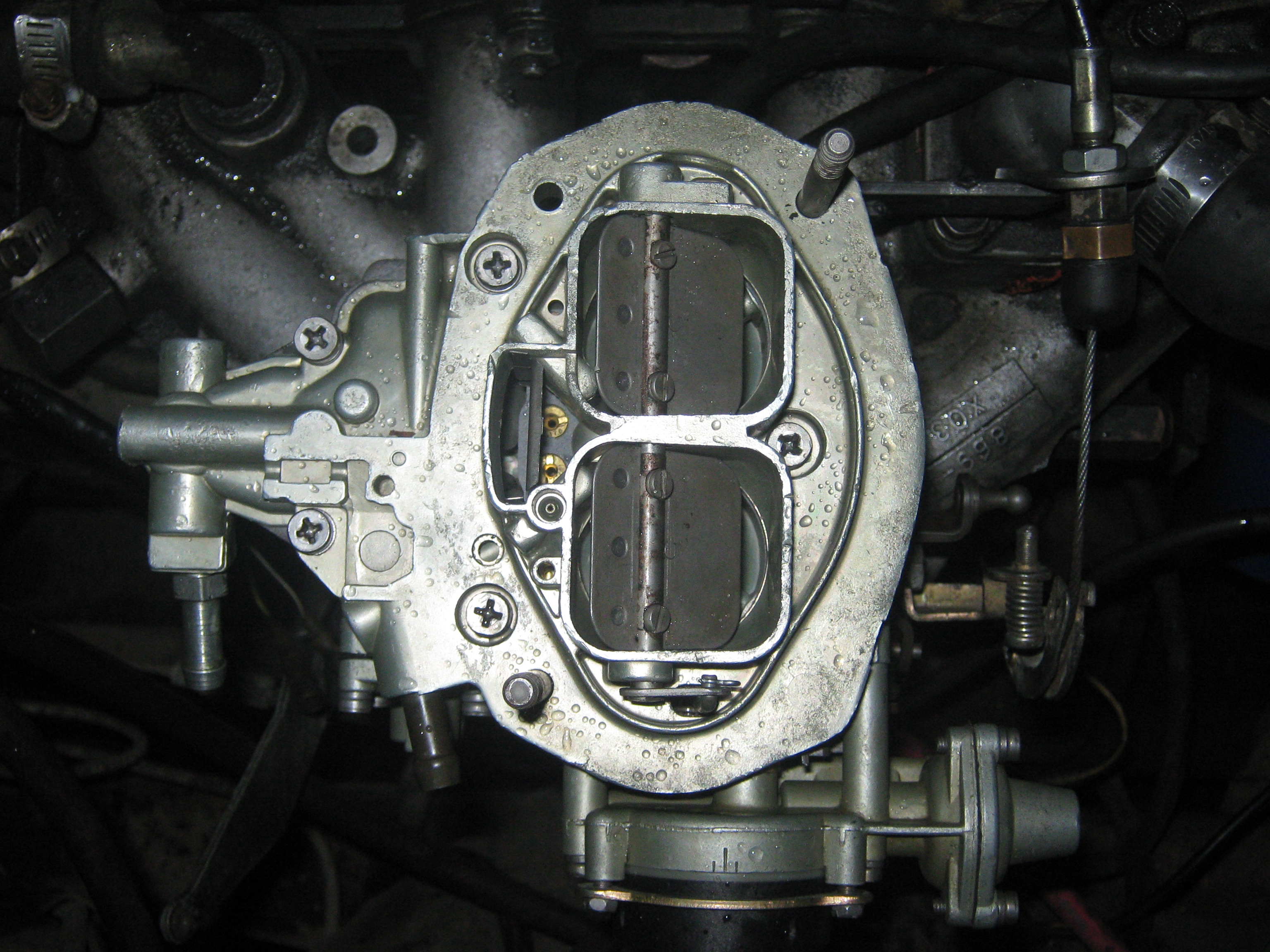

got a carb off ebay,it said it was a weber copy by holley,they failed to mention the linkage is the reverse of a normal weber!so I robbed some parts off an old hitachi ground on it and drilled it to accept the cable on the opposite end.bent the tabs on my redline adapter 180 cut it in half and made it longer.the cable is stretched pretty tight so I will have to find a longer one in the future.
File comment: backwards linkage carb
File comment: the part off old carb
File comment: needs to be cleaned up and painted, my first fab job!!!!!!!
