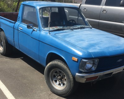

The truck its self, didnt run for a year so I replaced the battery and it fired right up.

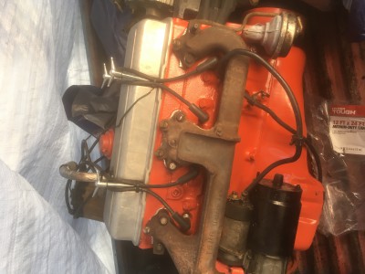

The chevy 350, runs just fine thought for $500 was just to good to pass up!

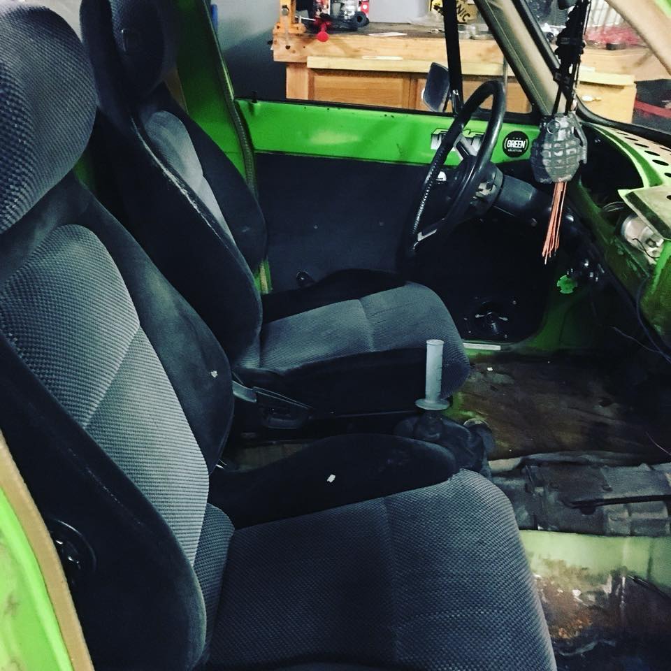

Good lookin truck.
You may have an issue with that transmission. The shifter on the t56 is pretty far back and may put the shifter close to the back wall. Might want to do some measuring before you commit to that setup.

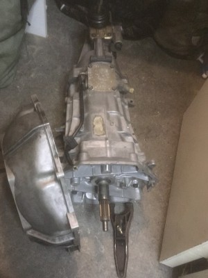

The thing that made me the most excited about this truck, the t56 itself. The guy I got it from snapped two spark plugs off in the block so he did an entire engine/tranny swap. Worked out just good for me at $700 only had 65k miles.

I have a buddy who is did this setup, the shifter will be between the two seat I got as of now and it isn't to bad looking ill post a picture for everyone to see how it sits.

I will have a different shift it inst as bad as you would think.

Ah ok. Cool. Should be a fun setup.
