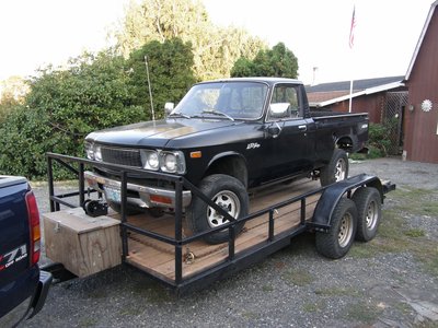

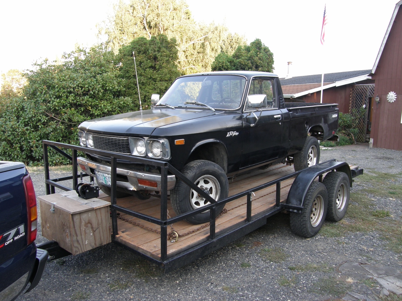

Found this Luv on CL and just had to have it for $550.

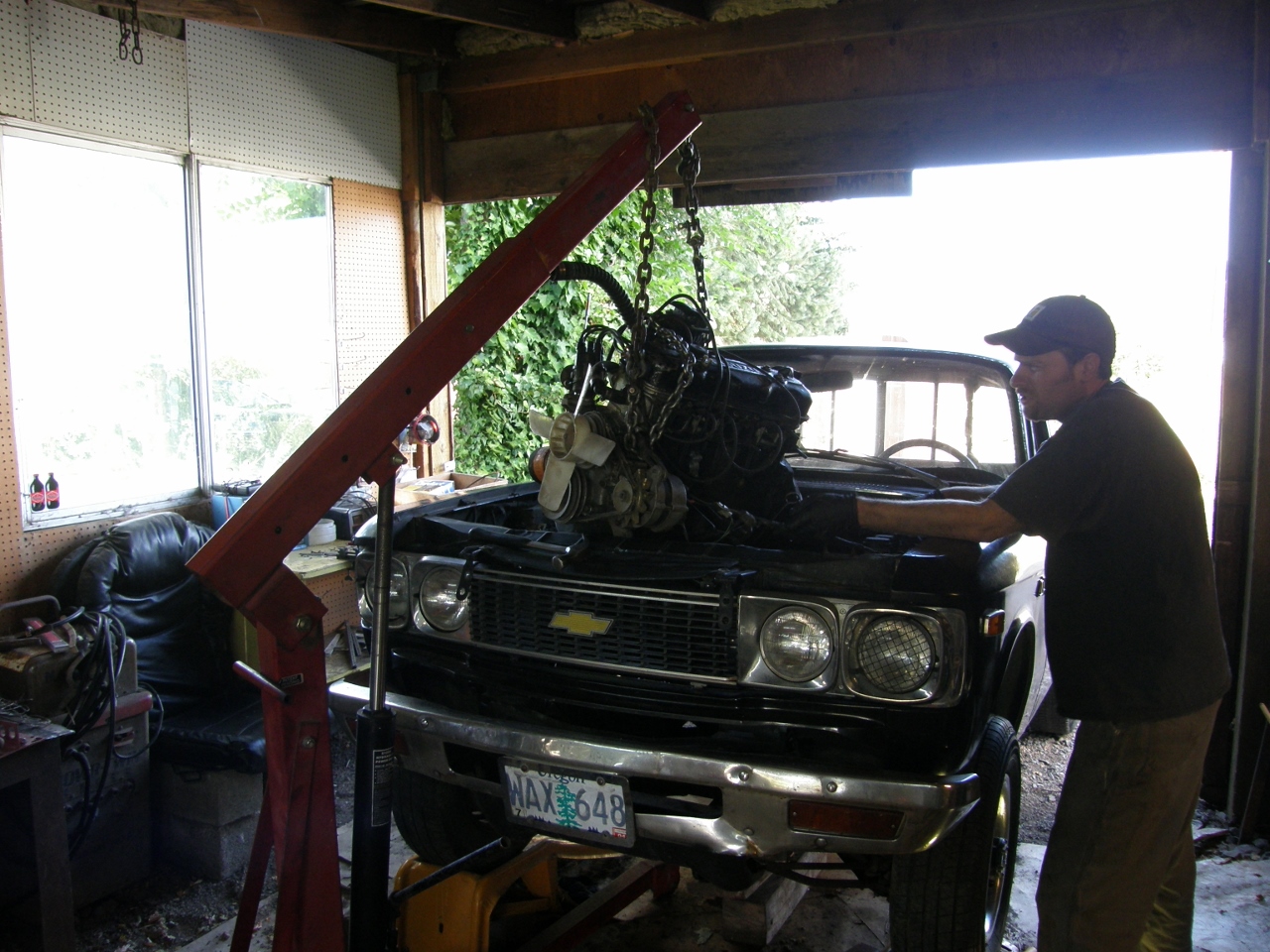

Thanks for info... We did pull the engine today and looked at the caps. Looked fine to us.
The cylinder numbers on the cap and rod were aligned. I suppose the pistons were installed the right way.
Will pull the head and pistons next time and see what's going on. Cannot turn crank.

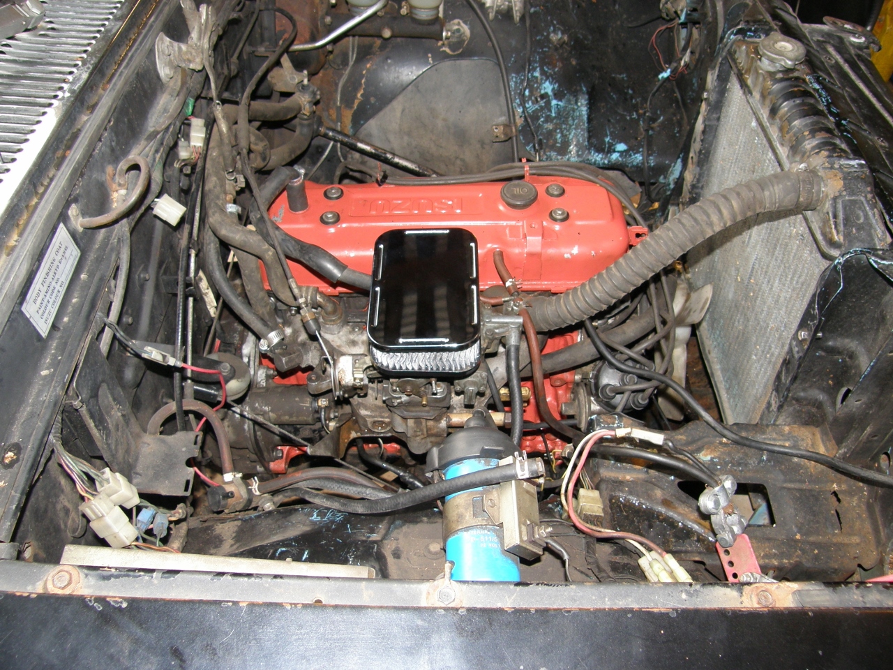

Motor is back together and in the truck. Did get it to run after some work.
No fuel would pump from the fuel tank so we pumped from a gas can.
While at idle checked timing and it was at 6 degrees. Got it to run fair at higher RPM. But dies out a lot.
Does carb need rebuilt or cleaned up?
Coolant leaking out of intake under carb. Is there small freeze plugs in the intake that can be replaced?
Need to remove fuel tank and see about the problem. Must be plugged.

The OEM filter is mounted up on the side of the tank next to the frame, I would check that before dropping the tank. You can see the filter by looking above the frame. At least on the 2wd. My 4x4 is long gone.

We pumped fuel from the gas can thru the filter so it's not the problem.

My son and I removed the fuel tank today. Lots of crud removed from inside tank. The bottom 2" of the supply tube in tank was plugged. Opened up supply tube & freed up the fuel level mechanism and rinsed tank out. Reinstalled tank and now it pumps gas to carb.
Runs rough & backfires when starting, must need to adjust valves?
Does anyone know where I can order freeze plugs for the intake manifold?
