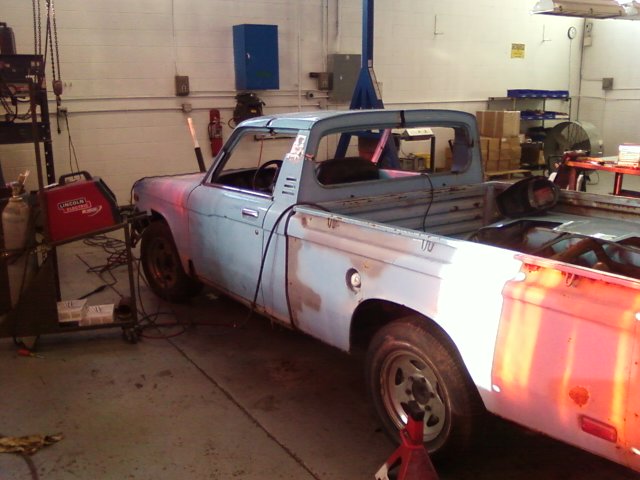

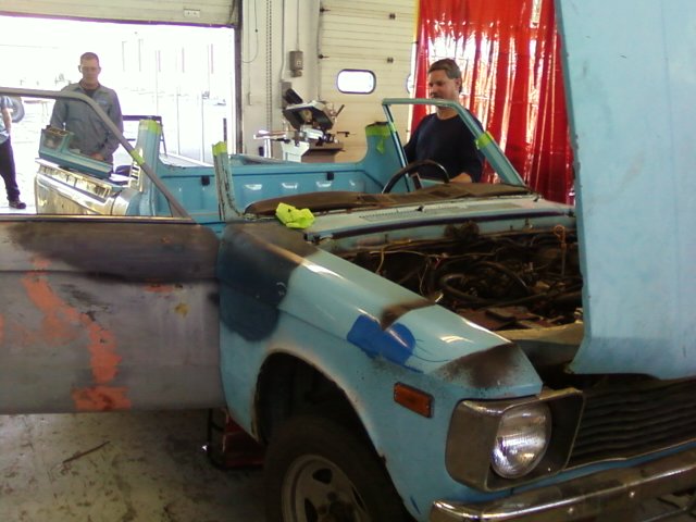

shes a bit shorter captian :twisted:
PostPosted: Wed Nov 25, 2009 8:41 pm
Posts: 2030
Location: s/e ohio

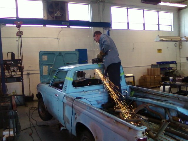

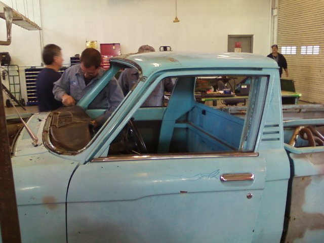

also if you ARE dumb enough to try and cut the rear glass with a "death wheel" (cut off wheel) ...it WILL explode 8O
however...it may take a minute after you make a test cut. while you are standing back smoking a cig. scaring the living shit out of you 8O
needlees to say i am going to HOPEFULLY!!!!! find someone to properly cut my one and only windshield.

8O That takes some big balls right there!!! Good luck on the chop!
PostPosted: Wed Nov 25, 2009 9:32 pm
LOL!
Mental note taken.

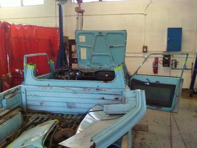

It seems like you could save some time and fabrication by getting a second top from a doner truck and combining the two instead of having to add in strips of metal.

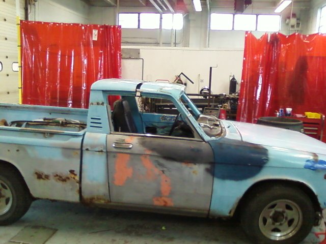

how much are you removing?
2" all around
now that wouldnt be nearly as fun would it? :wink:
