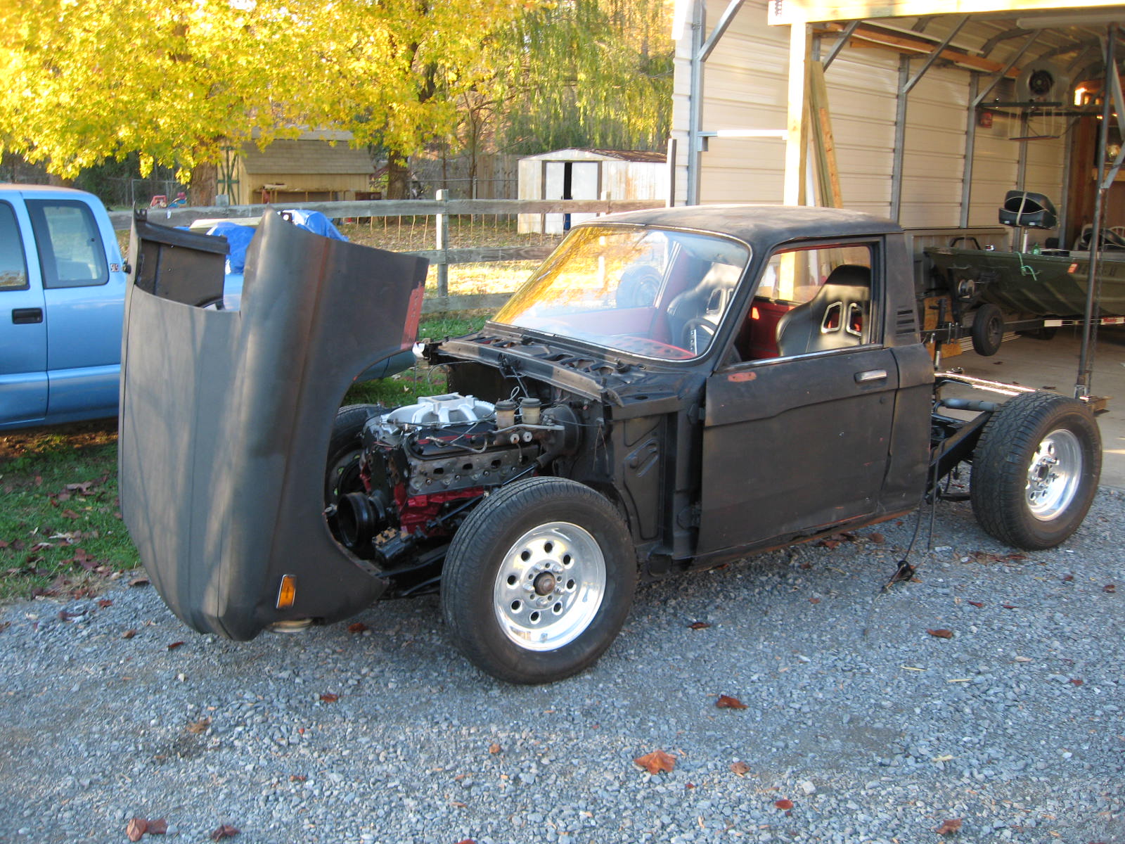

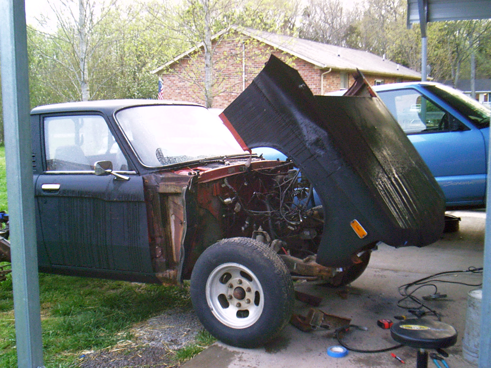

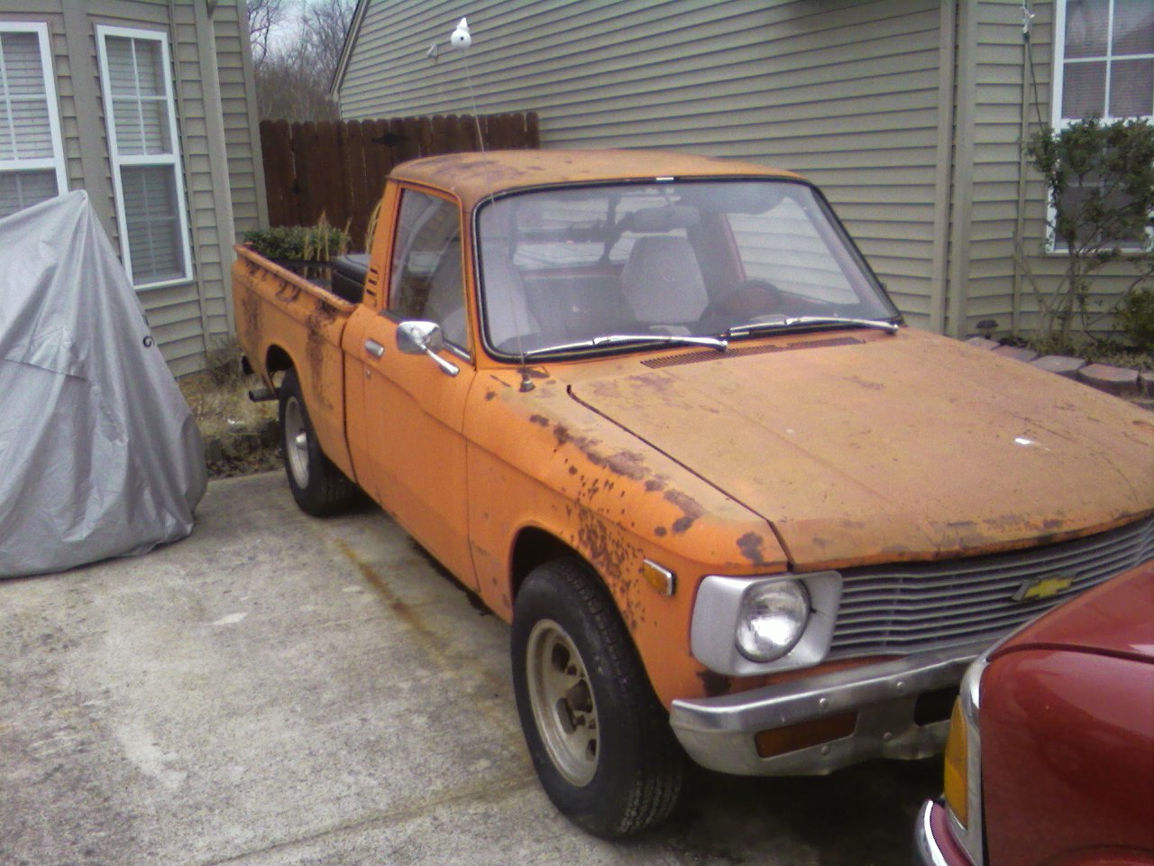

here is the post i started its a lq4 not a lq9 factory hp 325.
I have added comp cam lifters, and cam. gmpp racing lifters, patriot dual gold springs, ls2 timing chain, victor jr intake, modified holley 750. 150 shot nos. built th350 3500 stall mainly a play truck hopefully 400 hp n/a over 500 on nos
i have a tilt front end , coil over conversion, custom ball joint plates with s10 ball joints and spindles. firewall moved back and trans tunnel made bigger for easy acces. mainly a hobby on the weekends! here is a couple of pics
