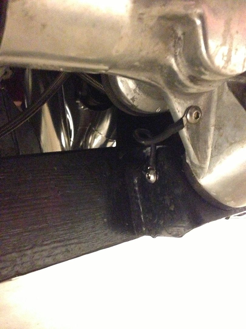

Started tracking down my horn issue a while back. Got fed up with it so i left it alone. Decided to get it fixed today since all my new horn parts for the column have been here. Replaced them all with no luck. Then i realized the steering shaft in the column wasn't grounding. It wasnt grounding because the rack and pinion wasnt making a ground. So I fixed it. IDK if there is a cleaner way to do this.. But my buddy suggested a ground strap.. works for me. Tapped the holes and soldered the ring terminals on.

Nope solder and heat shrink is the best way . Did it work ?

I was questioning the way I grounded the column. Wasn't sure if anyone else has had a problem like this. And yes it did work. I finally have horns.

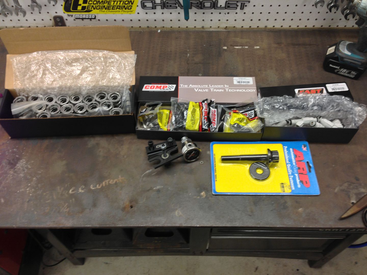

Pat G spec'd cam 226/230 .598"/.609" 112LSA +4advance
FAST 36LB injectors
Brian Tooley .660" dual spring kit
Comp Cams trunion upgrade
Cam was for Christmas from my parents. I just ordered everything else. Cant wait

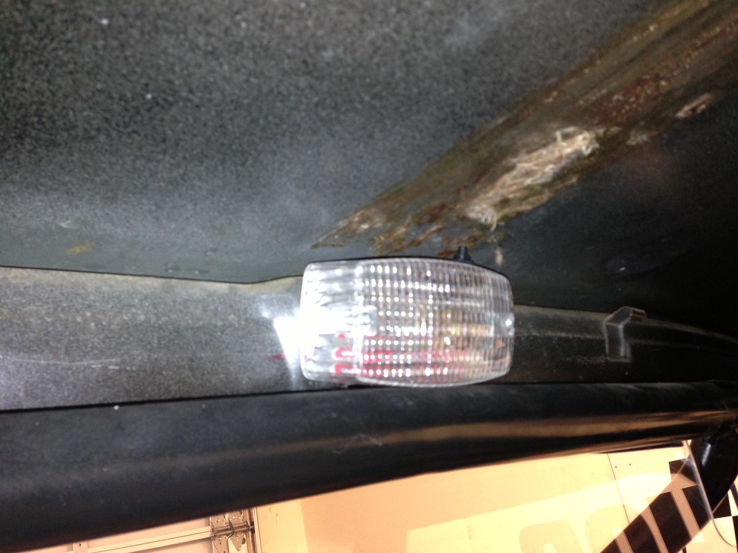

Been wanting a dome light. Picked this up from oreilly's since like 98% of LUV dome lights were falling apart or missing all together. Mine was falling apart and half missing. Plenty bright. Will be nice to be able to see around the truck at night when leaving somewhere :lol:
Has a little button on top to where you can override it and keep it off. Will be good for when i have the doors open working on it.

Not much of an update but everything besides the cam is here.

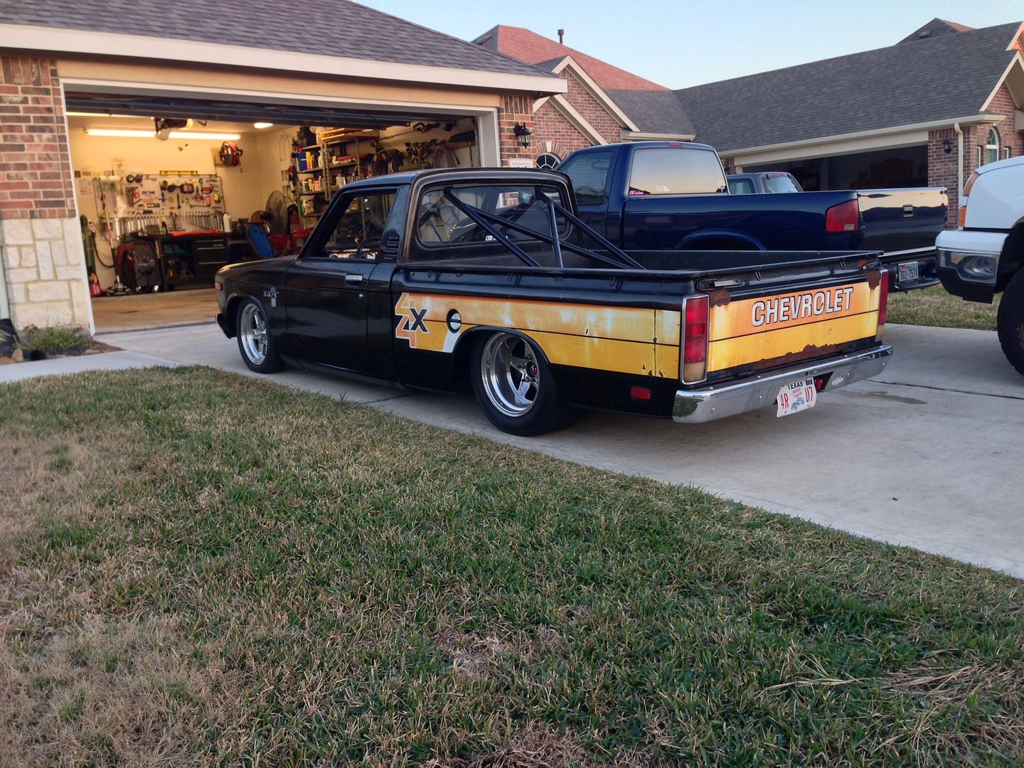

Took her for a quick cruise. We're supposed to have bad weather the next few days so I wanted to get a few miles on her.

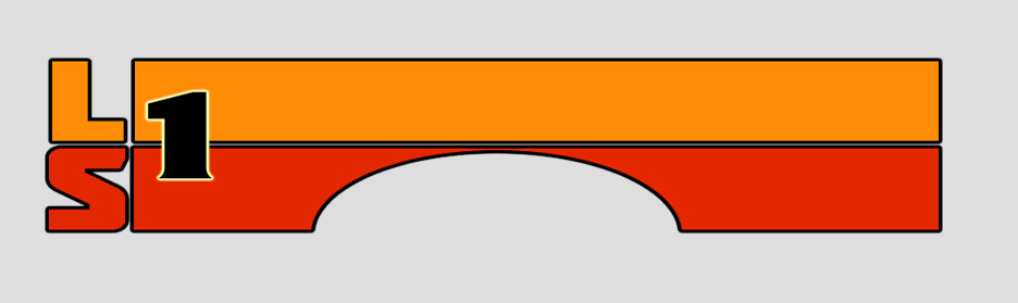

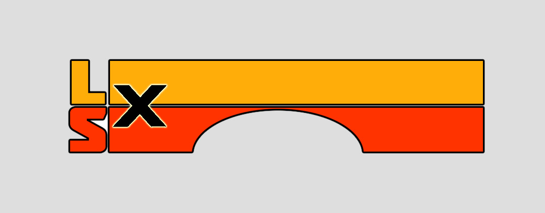

Hmmm
