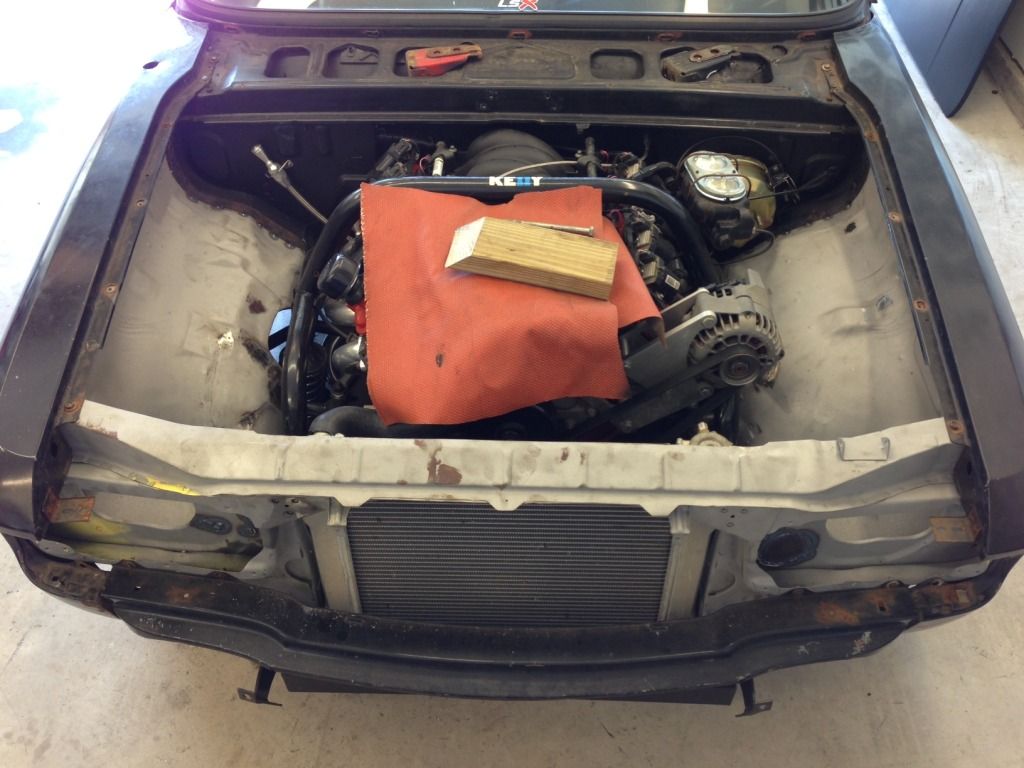

Beautiful! Any pics of how you put the front end on?

Put the inner fender/core support on. Bolt on fenders and everything else. I took it off in one piece once and it was a major hassle. I completely disassembled the front end in 30 minutes by myself.

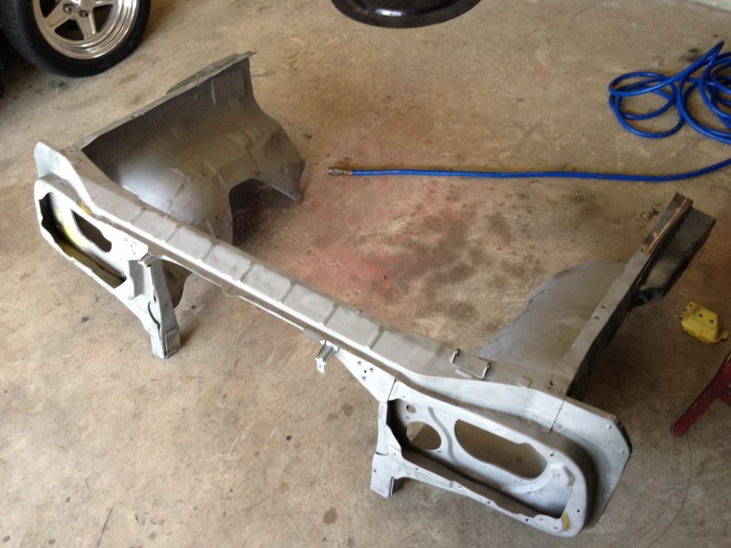

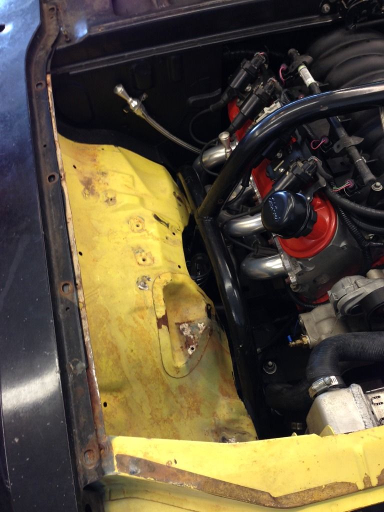

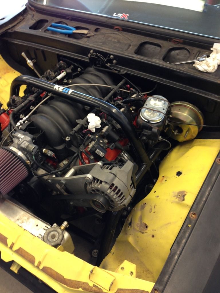

Got the new to me inner fender/core support. Need to do some tweaking to make it fit

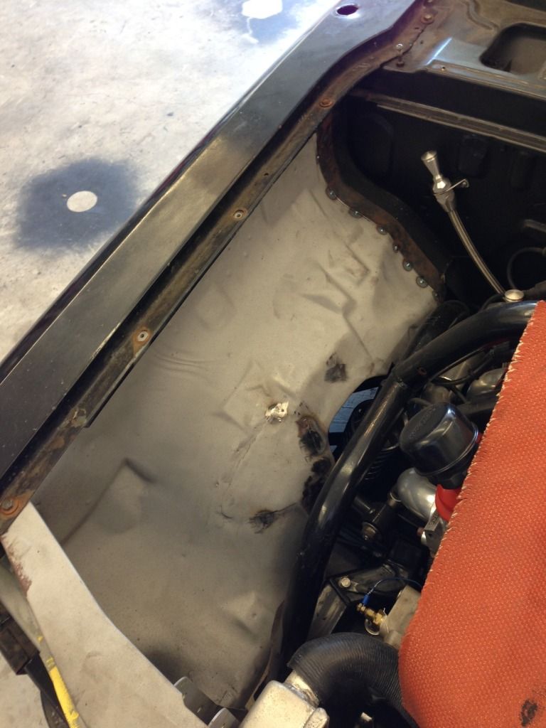

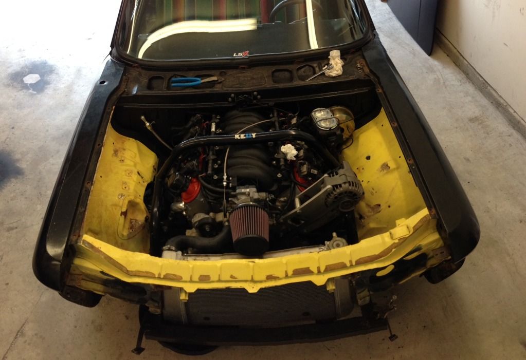

did a little trimming on the inner fenders to get it to fit.

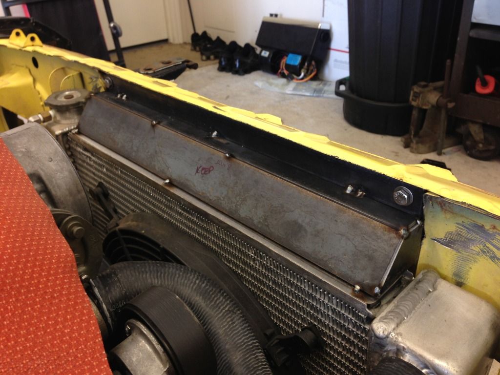

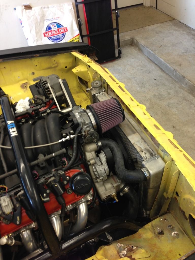

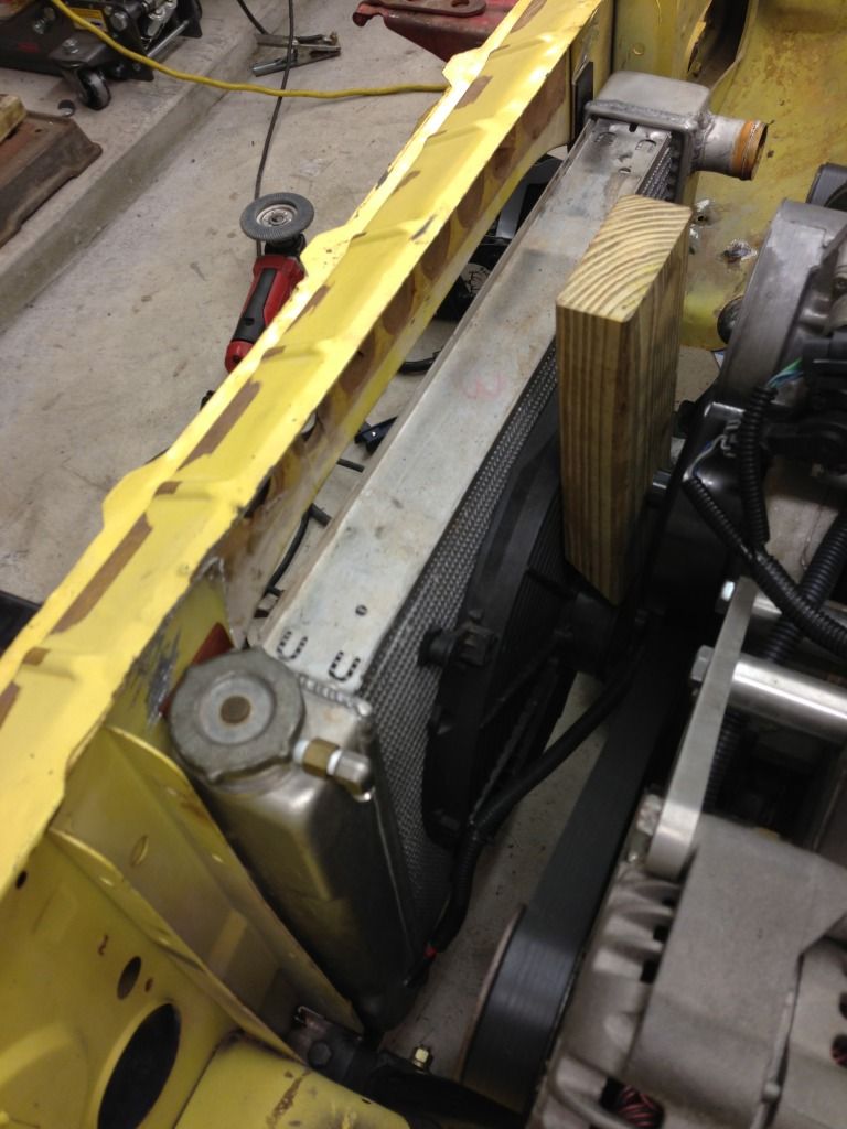

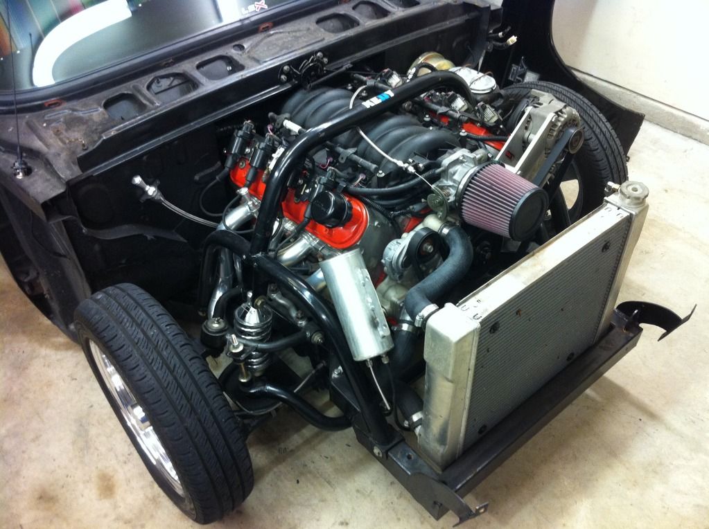

That is the perfect size radiator .
 Post subject: Re: LUV II
PostPosted: Thu Oct 11, 2012 7:17 pm
LSX LUV Owner
Posts: 1261
Location: Dickinson, Texas

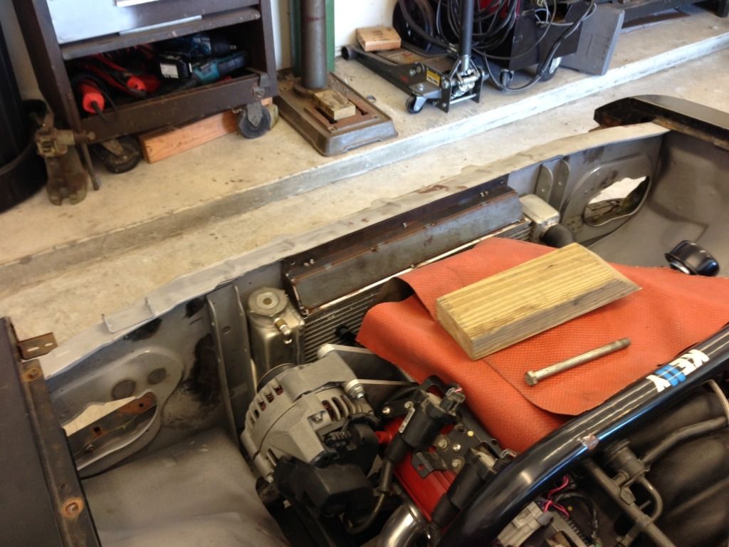

Yes it fits with 1/8" of clearance on each side

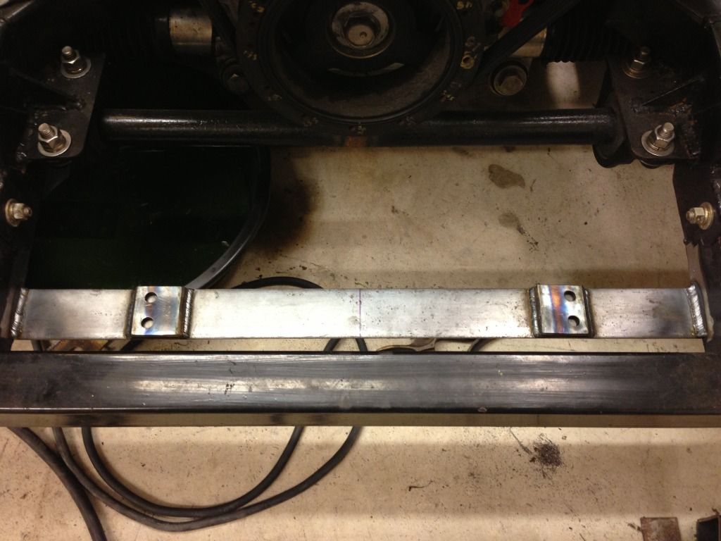

Lower radiator mount.

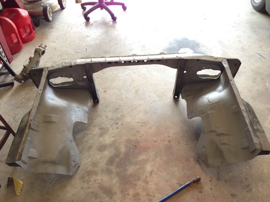

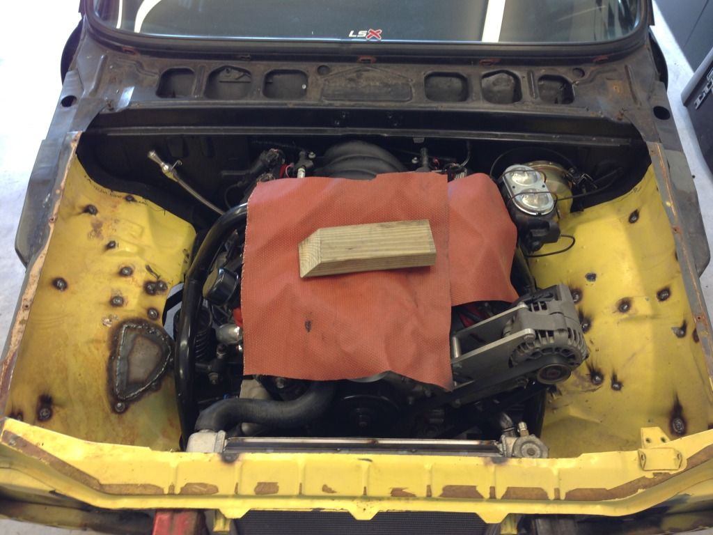

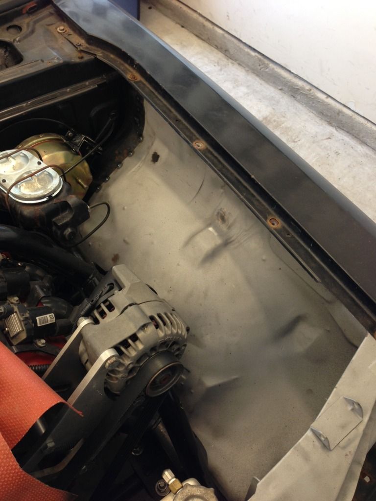

Got a little more done today. Need to fill some spots on the core support, then cut a few strips of sheetmetal to overlap the joint where the inners meet up by the firewall. The new clip's cuts were not straight like mine so i need something to hide that. Drilled out the spot welds for the battery indention and whipped up a filler piece for it.

Took the clip to my dads work earlier and got the majority of it sandblasted. The cabinet was only 2" wider then the clip so I had a hell of a time getting to some of the spots as is. SO after two hours of blasting I called it quits. A couple spots have some paint left, but it can be hit with a wire wheel.

Getting closer, I have everything welded up and ground down except the two strips by the firewall. Putting everything back together now to make sure everything is fitting like it should. Need to hole saw a couple holes for wiring, and make a bracket for horns to bolt to. After that gonna put a little filler on a few areas to smooth it out, and then bedline it.
