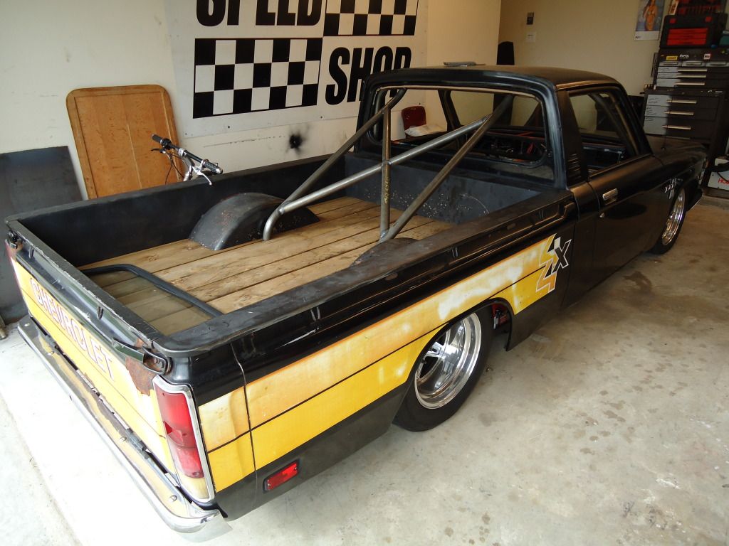

I'm not getting it cert'd. I'm using 1-5/8 DOM .120 wall. Mig welding pretty much all of it.

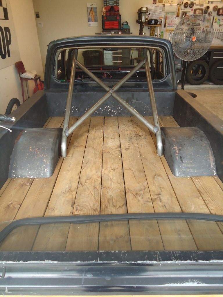

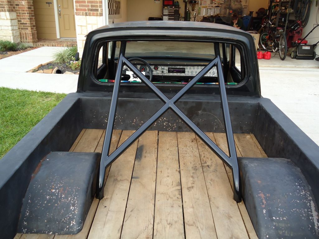

got the x brace in, need to weld bottom side still. and i had to cut about 4" total off the dash to get it to go back in so i have to rebuild the sides.
 Post subject: Re: LUV II
PostPosted: Sun Jul 01, 2012 6:00 pm
Posts: 509
Location: Tomball, Texas
Can the bed still be removed if needed?
PostPosted: Sun Jul 01, 2012 7:39 pm
LSX LUV Owner
Posts: 1261
Location: Dickinson, Texas
id have to cut the rear down bars to get the bed off. but i can take the wood floor out and access everything.

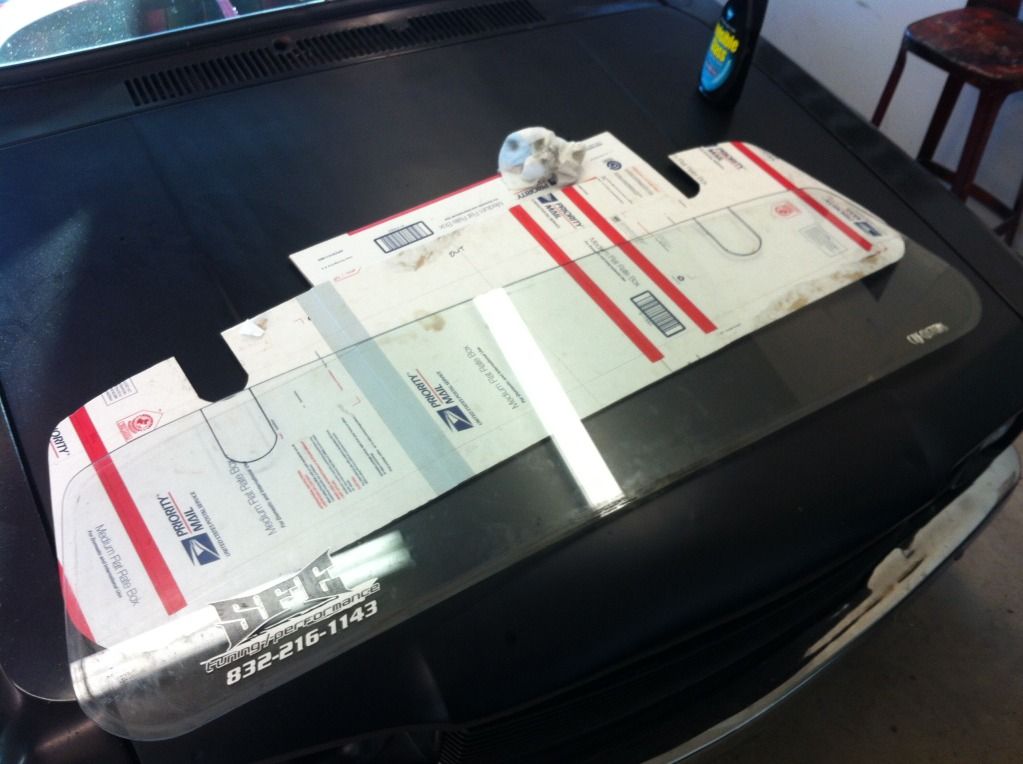

Got the glass marked. Gonna take it to the glass shop tomorrow to see about getting it done.

My glass couldn't be cut. But they can cut it on non tempered I guess? They didn't have any 3/16 in stock though.

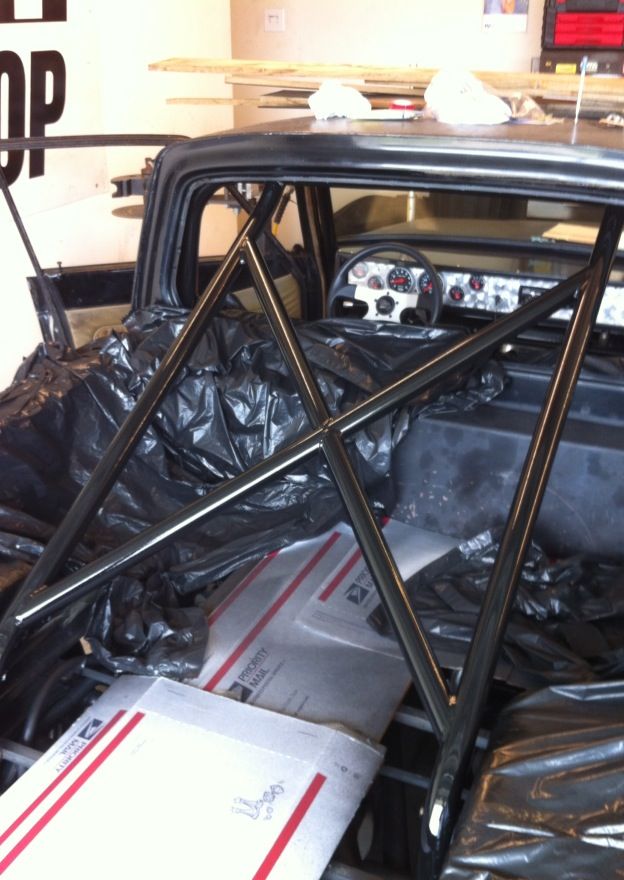

Got everything on the cage welded up and got it all tied into the frame. Gonna rebuild my dash tomorrow, and paint the cage and be done with it.
PostPosted: Thu Jul 05, 2012 8:43 pm
Posts: 582
Location: San Leon Tx.
Those welds are looking good.
Make a post for glassman chad on H-town . He says he can cut it non tempered and then have it tempered . Post up the picks he will be all over it . Been begging to do one for me .

He wants 50$ more then I can have it done for right down the road.

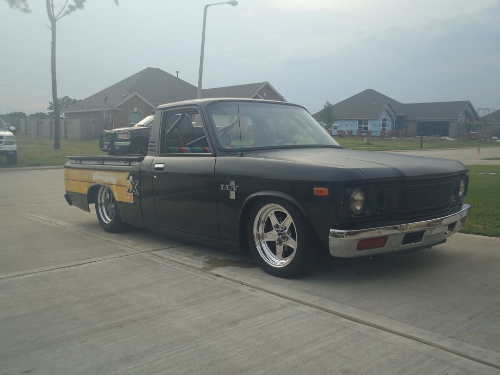

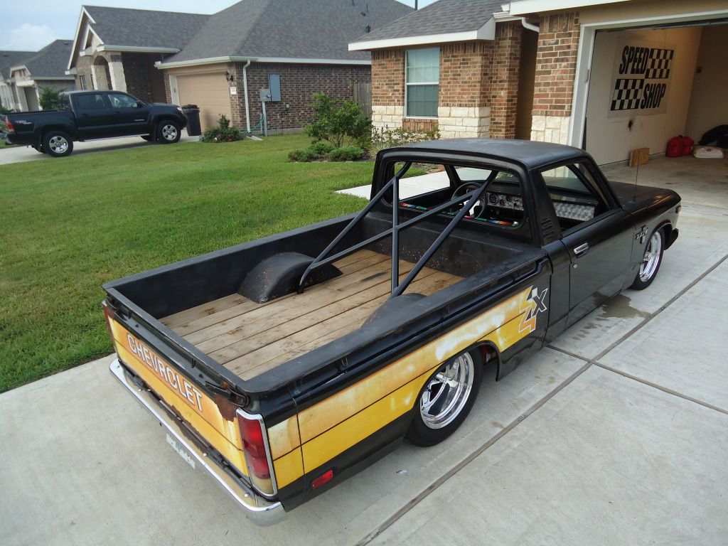

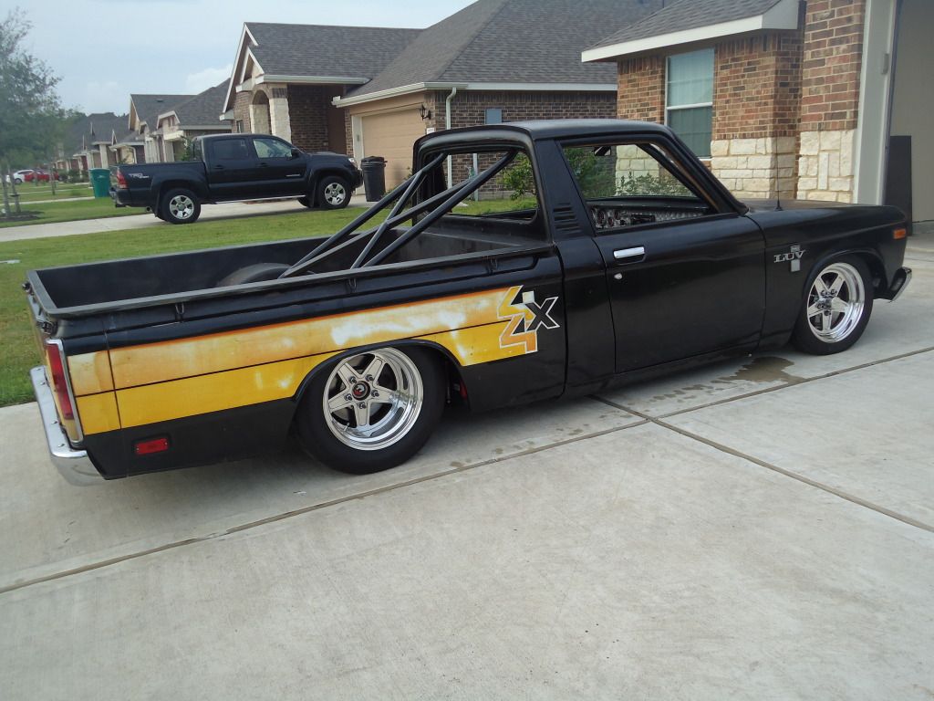

LSX LUV Owner
Posts: 1261
PostPosted: Sat Jul 07, 2012 8:34 pm
man that thing looks sweet... have you taken it out for a drive yet?
PostPosted: Sun Jul 08, 2012 12:20 am
Posts: 2030
Location: s/e ohio
So much for the sleeper look :P
J/K man, looks great :twisted:
no i havent. I was kinda busy most rest of the weekend and now its been raining.
haha thanks. i was really shooting for the sleeper look too :lol:

sleeper with an engine like that under the hood, how do you pull that off :lol:
how much power is that beast putting to the wheels?

Last it was dyno'd it put down 337, don't remember torque. Wasn't there when it was dyno'd and their comp system took a dump and lost my dyno results.

very nice 8O
wonder how much of a difference the cage will make for stiffness driving :eugeek
