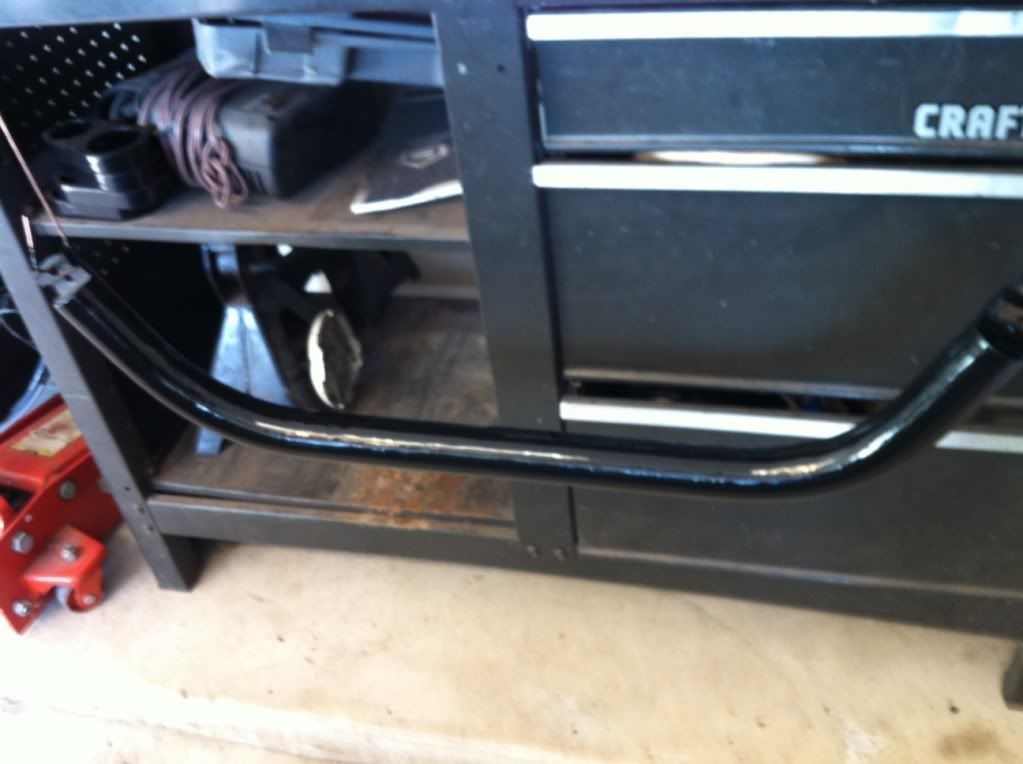

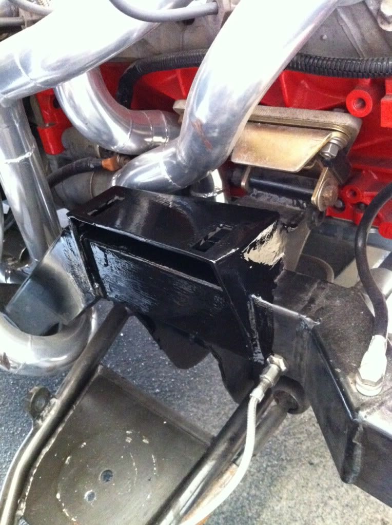

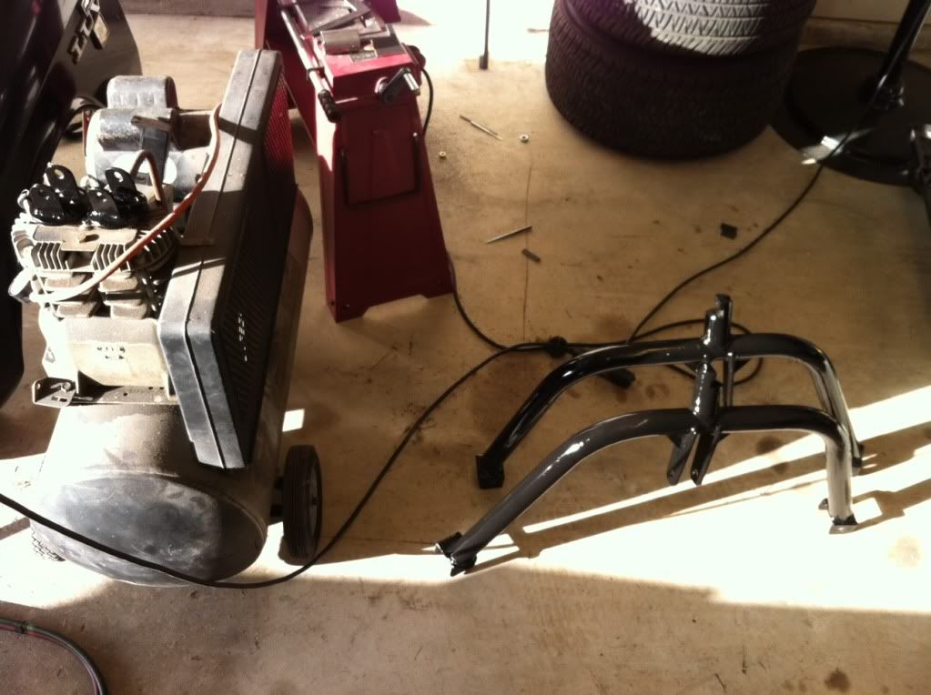

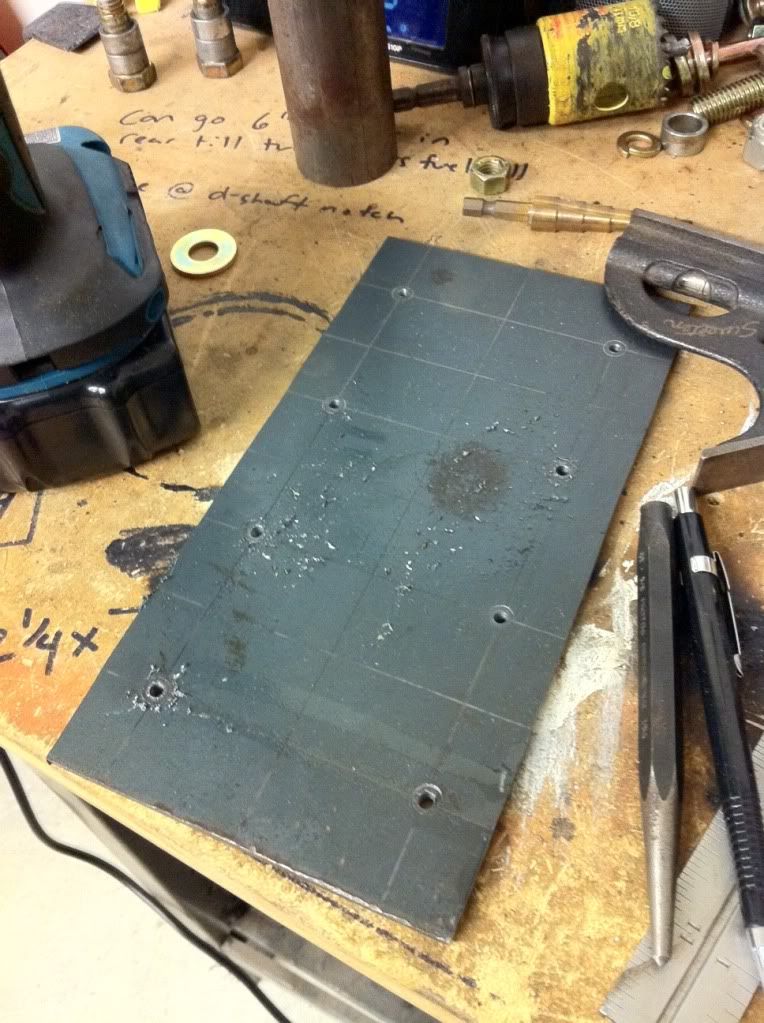

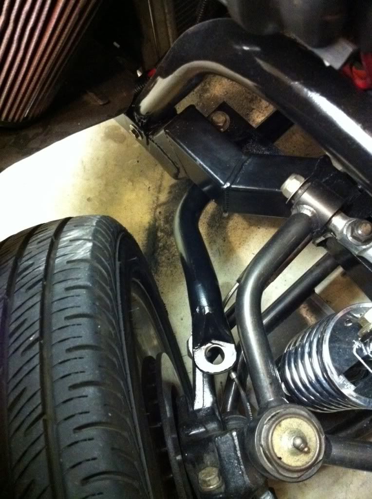

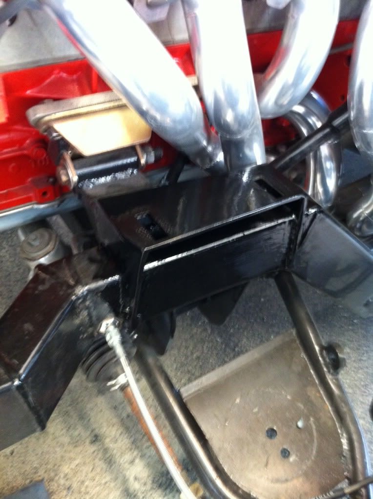

Got pass. Side tacked on
These will be the flange pieces to unbolt the crossover piece
Petey bein a good boy

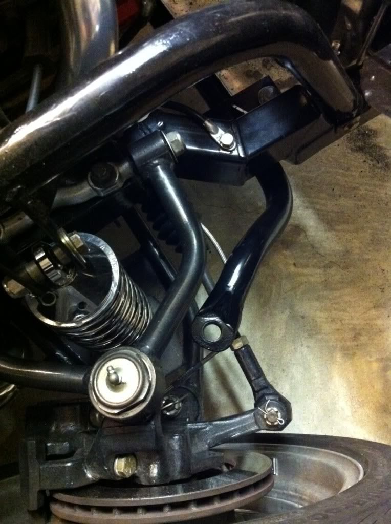

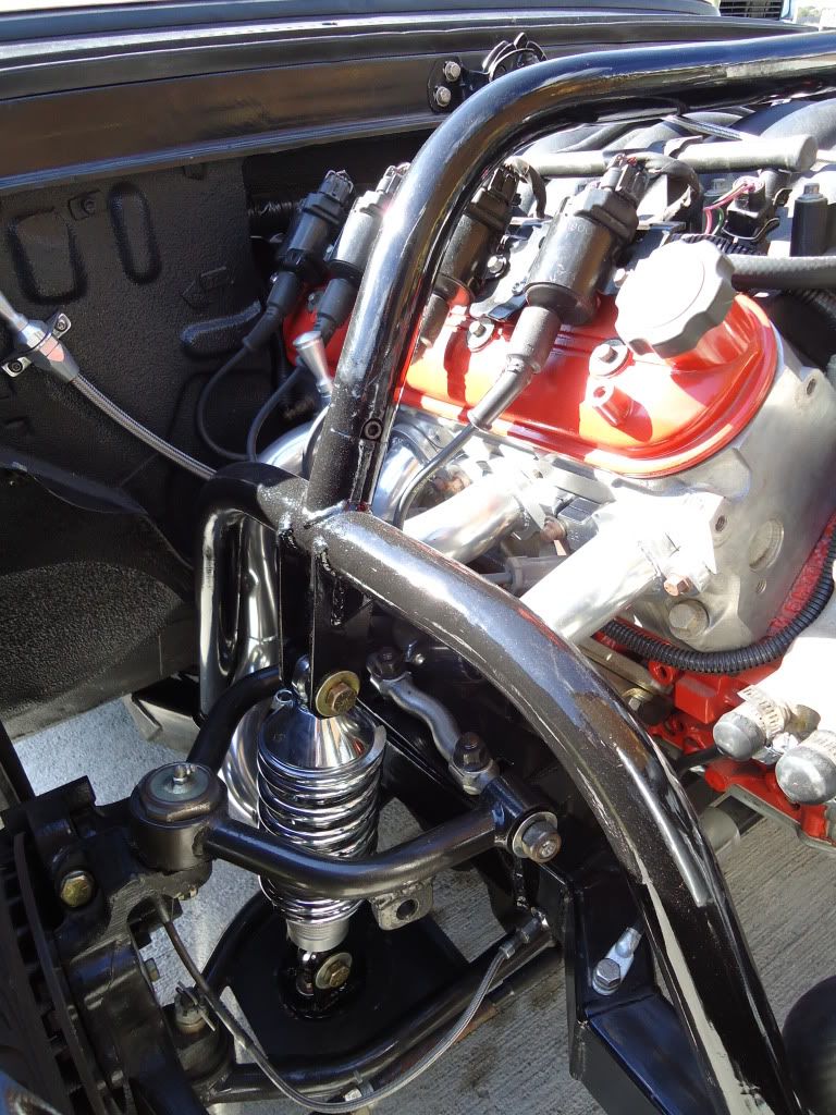

not sure how much these springs are supposed to compress.. but i had to adjust it all the way up to here to get it to sit like i want.. and its at 11" for mounting points and its supposed to be 10.25, but there was no weight on the tires.. sidewall flexed 1/2" with the weight... feels soft.. those are 325 pound springs..

speedway tech. reccomended 450 pound springs since theyre such a small stroke. So those will be here saturday. gonna try and have everything welded/cleaned up and painted by then so i can just swap out the coils and take her for a spin.

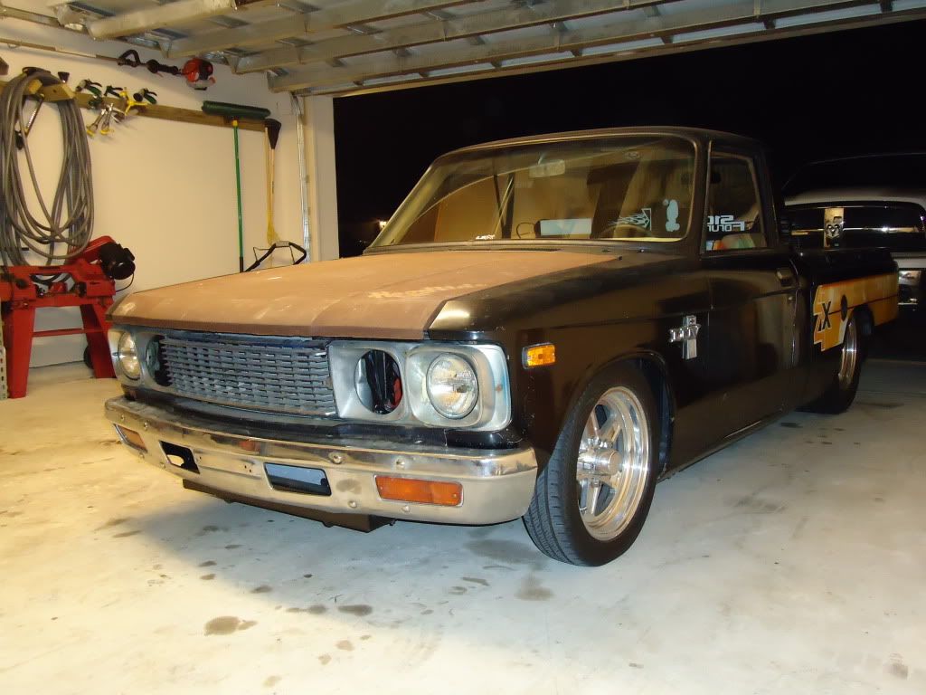

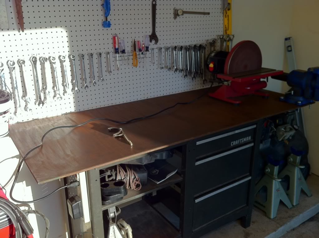

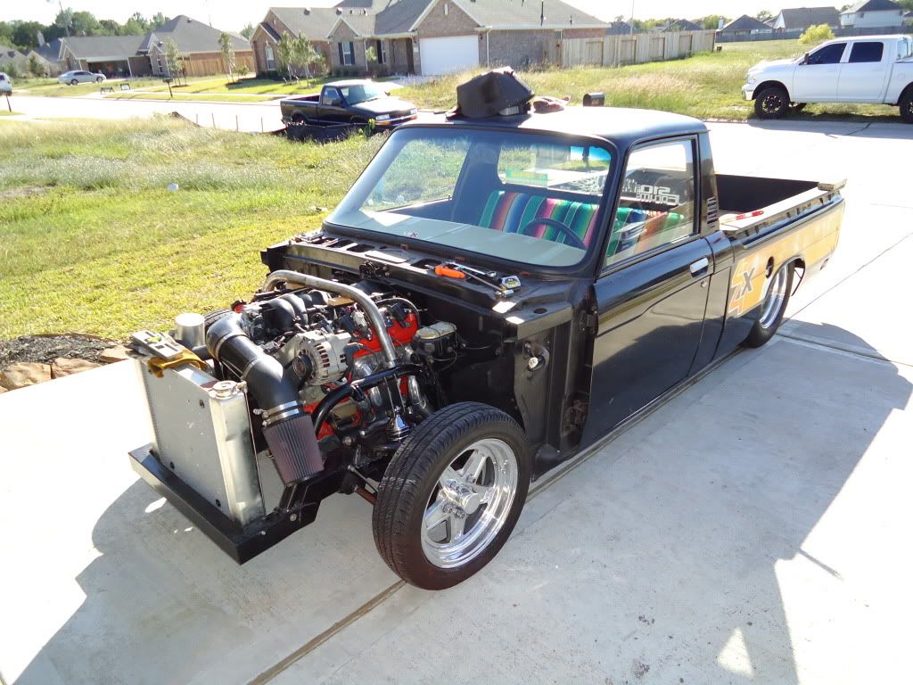

rolled truck out after i got back home yesterday to put on a metal top to my work bench.. snapped a few pic tars
today i got everything welded/cleaned/painted
450 pound springs will be here tomorrow.

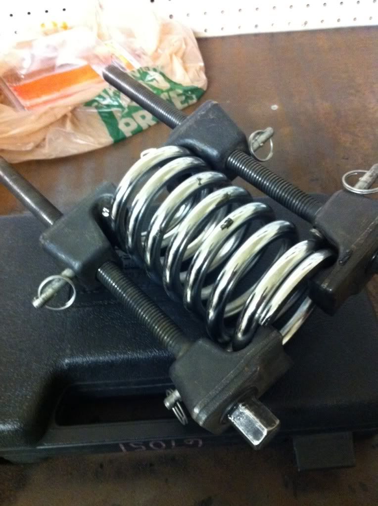

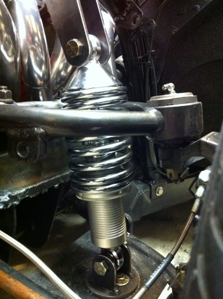

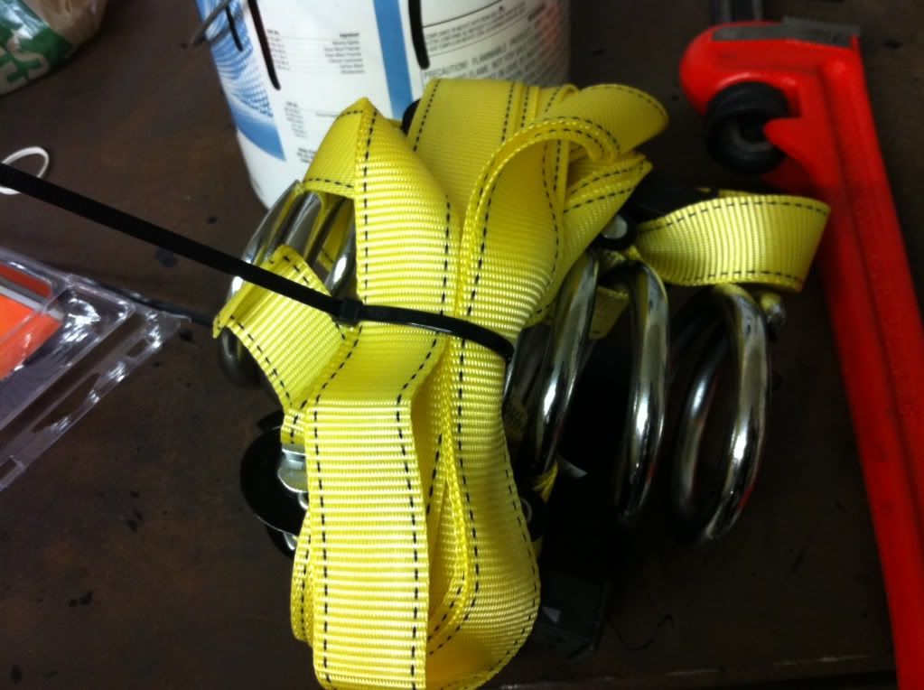

also, a spring compressor will not compress these springs to get them off. So my buddy told me about some ratchet straps that have a real long end on them that loop back into itself.. so i went to home depot..
"endless loop" ratchet straps. got the spring tightened up enough to where i could spin the adjuster nut all the way down, and got the spring right off..
then i didnt just want to undo the ratchet straps in fear of the spring ripping my face off. So i used a spring compressor, then popped the ratchet straps off.
then loosened up the compressor, and wala.. only took about 5 minutes

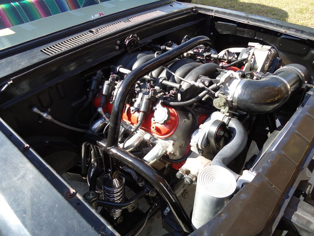

I think im going to flush the cooling system before putting front end back together. I forgot i never flushed the motor, and i put regular coolant in the truck, now the radiator cap has mud all over it from mixing dexcool..

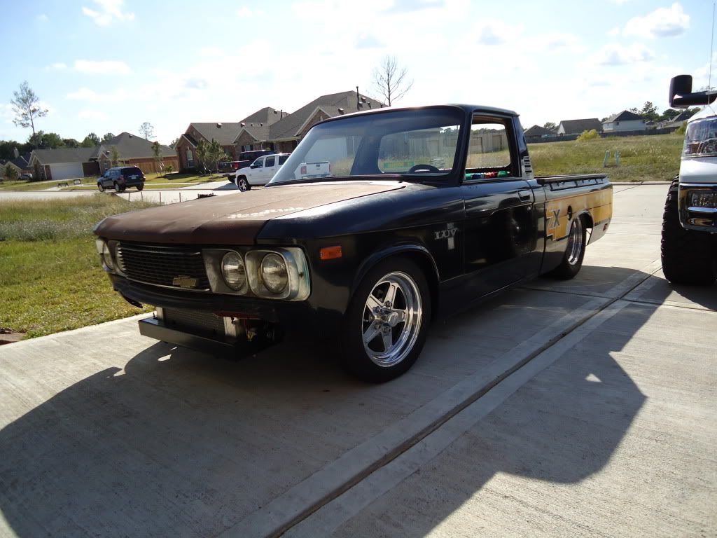

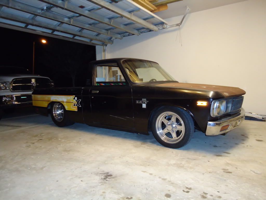

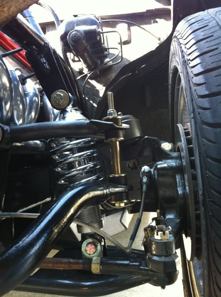

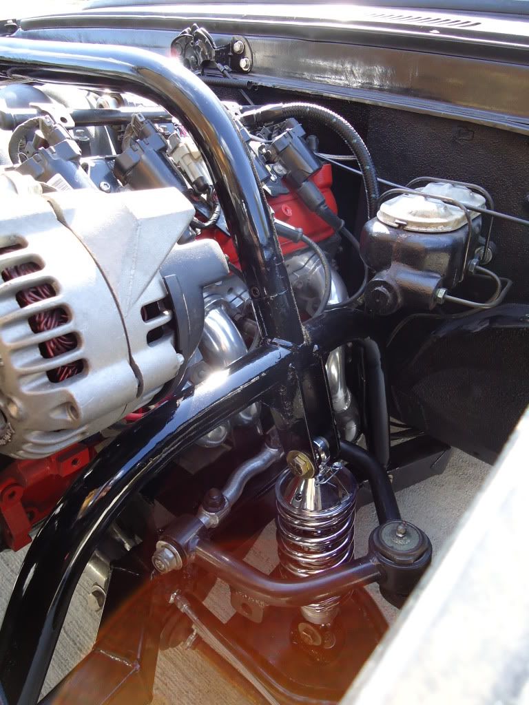

got it all back together.. 450 pound feels just about perfect.
got a new sticker.. guess it clothing or something(girlfriend gave it to me), but i like it cause it has a Popsicle on it. LOL

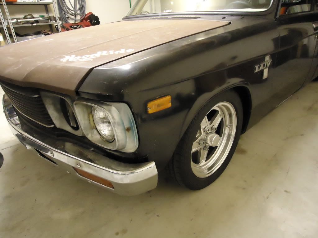

I know it's just personal preference, but I like the new wheels about 100 times better than the black ones.
The work that you've put into your truck is just amazing!

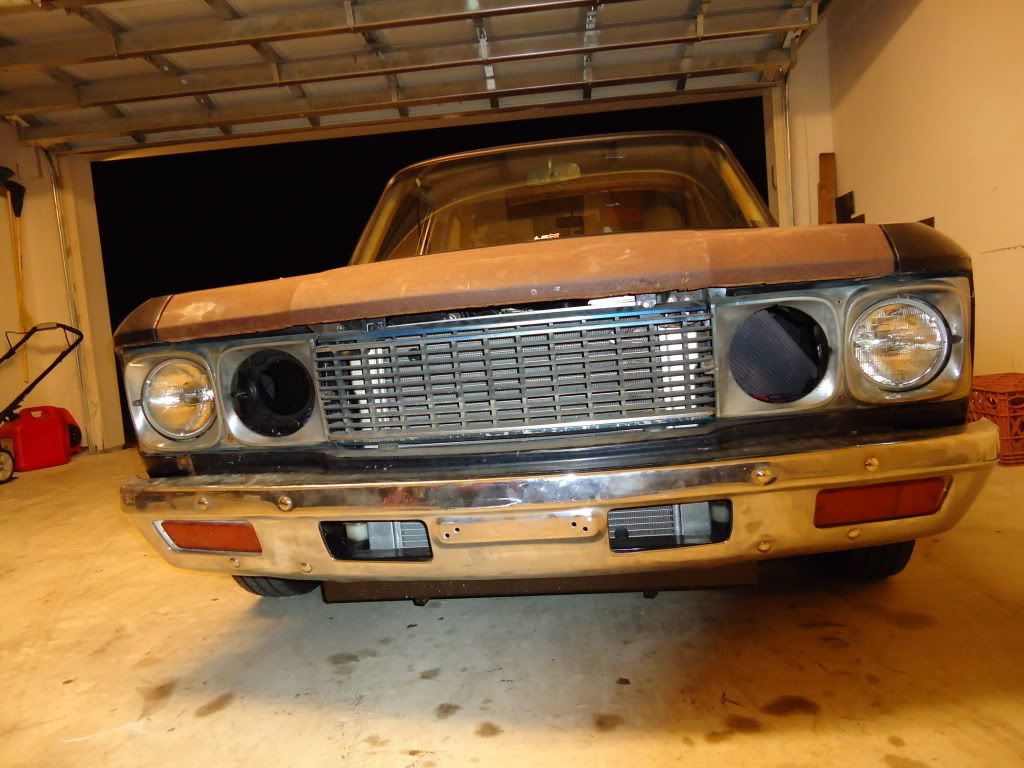

found a bumper at a swap meet today... finally
 Post subject: Re: LUV II
PostPosted: Sat Nov 05, 2011 8:59 pm
Posts: 363
Location: macon,ga
damn thats was a nice one to find..
