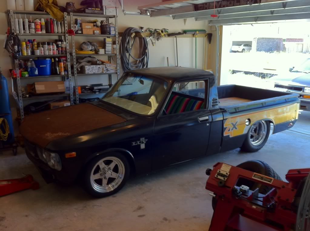

im in love!
 Post subject: Re: LUV II
PostPosted: Thu Oct 13, 2011 8:10 pm
Did I mention that I covet thy Bogart's
PostPosted: Thu Oct 13, 2011 10:28 pm
Those wheels make it pop, very nice.

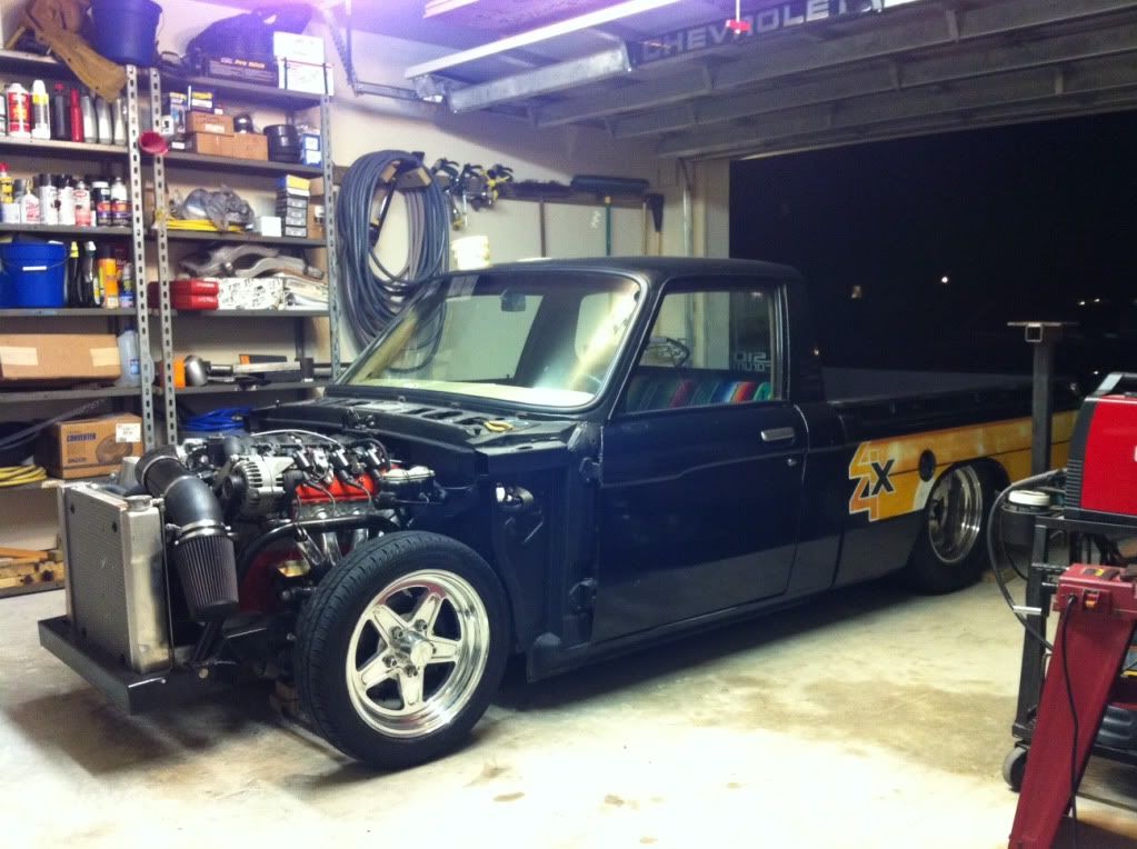

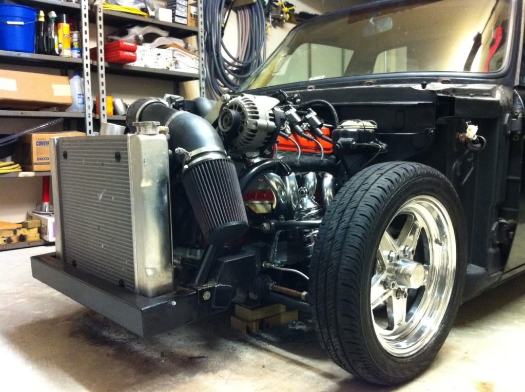

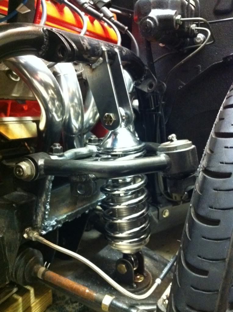

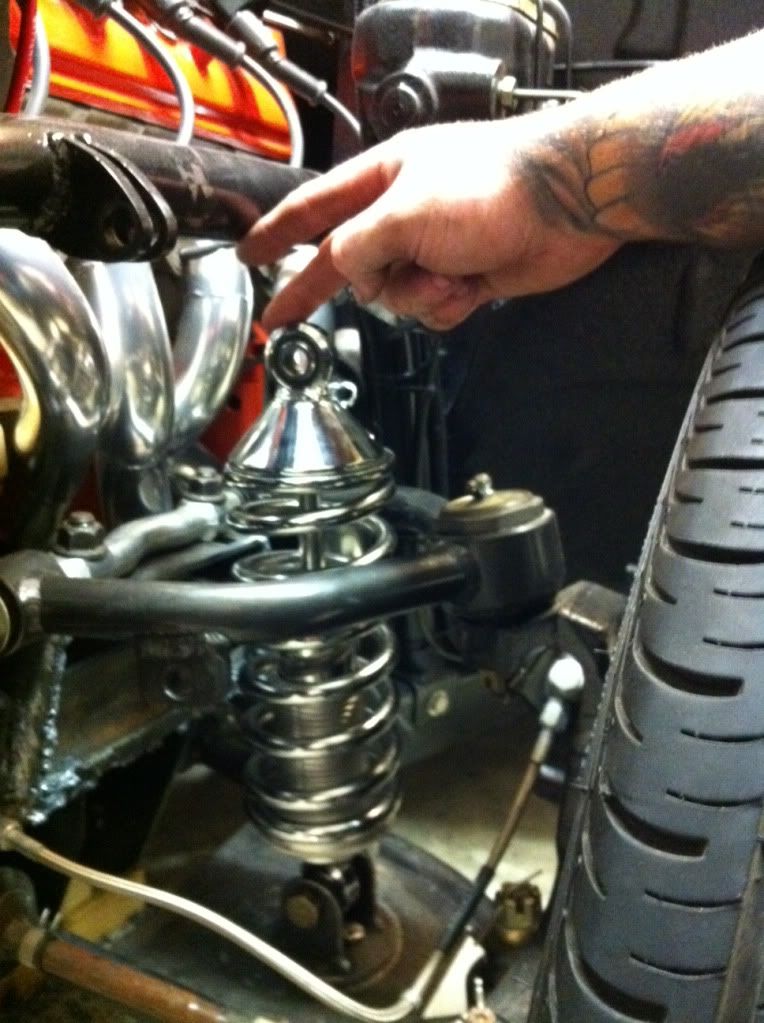

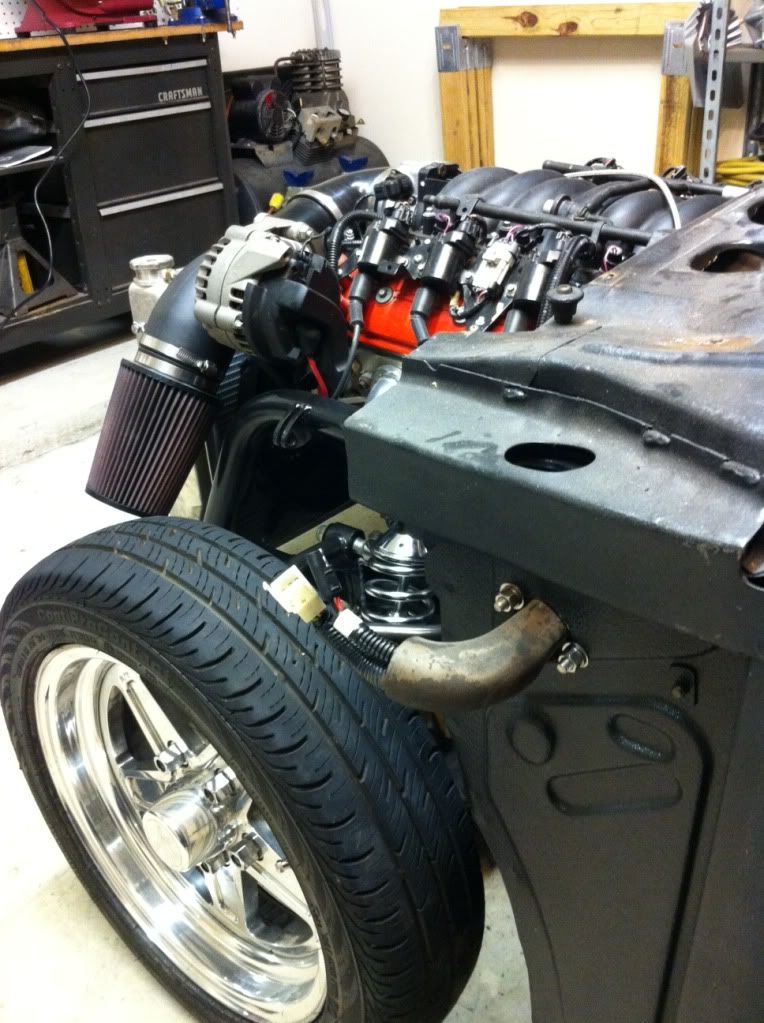

thanks guys. Im getting the tires swapped over for the fronts in a little bit. And sometime saturday im gonna start taking the front apart for coil over mounts.

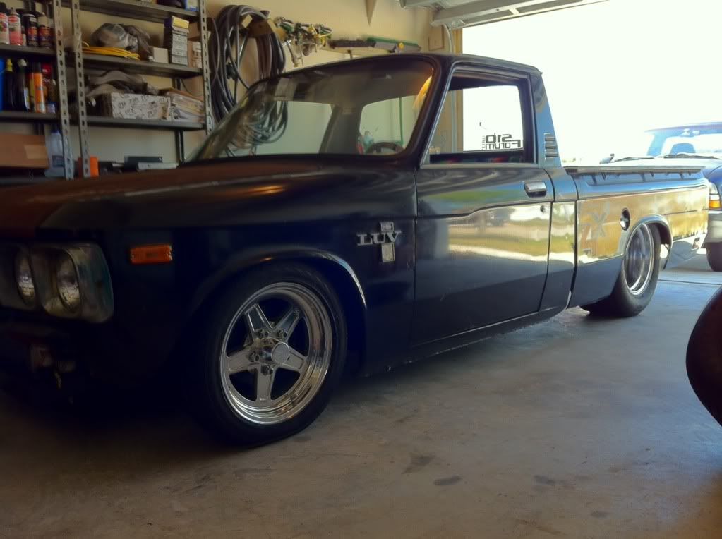

LSX LUV Owner
PostPosted: Fri Oct 14, 2011 1:03 pm

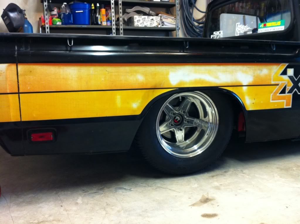

Bad-a-Bing! that looks sweet!
PostPosted: Fri Oct 14, 2011 1:21 pm
Thats exactly how I want mine to set if I can ever get around to the rebuild! I personally didnt like when you went with black on the rims, major droolage now!

Thanks! Could be yours for a price! :ebiggrin

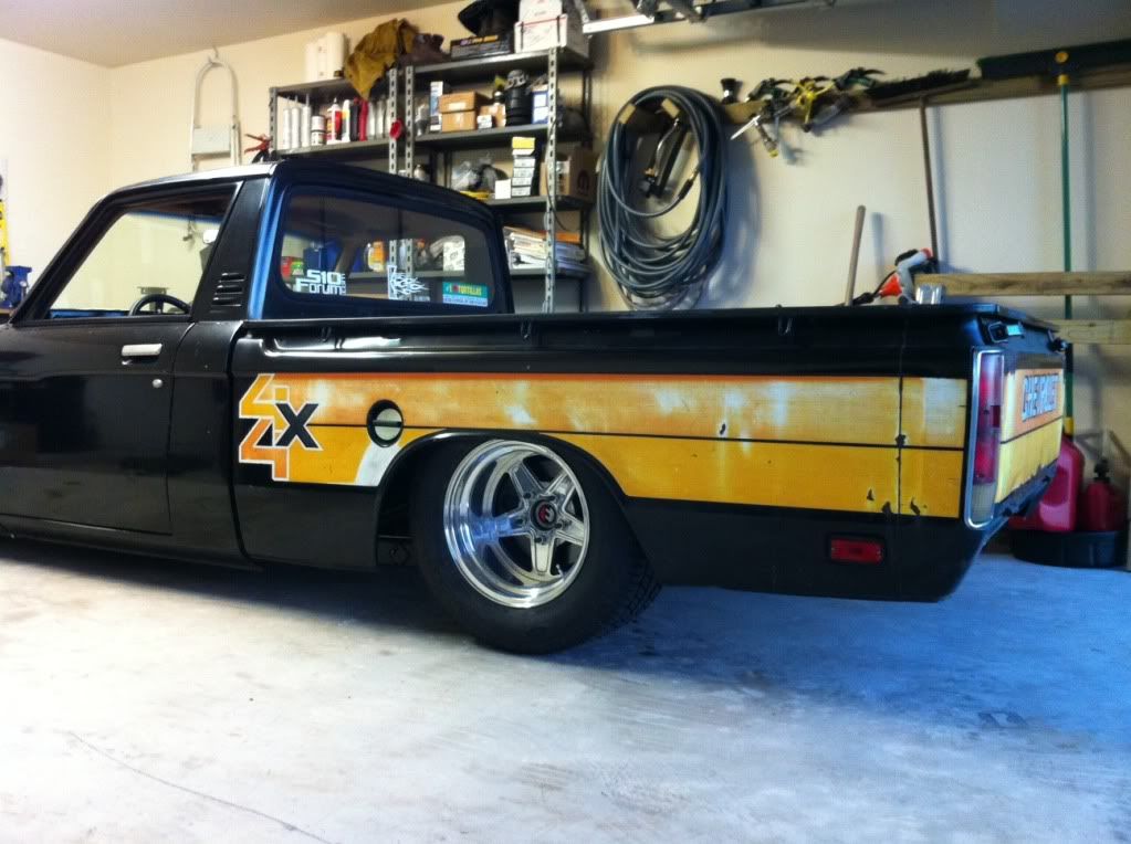

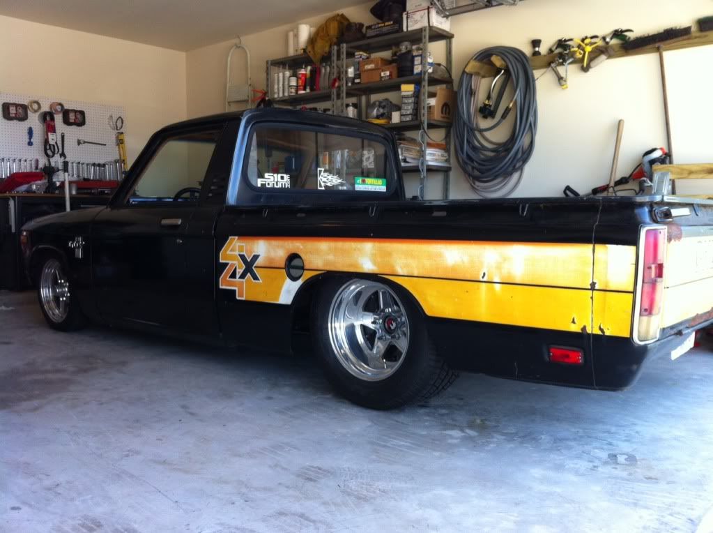

Lil work today..
PostPosted: Sat Oct 15, 2011 9:33 pm
Yep , totally different truck . Those 4x4 graphics are my favorite . Give me the scoop oon the black wheels ,, For sale ? size ? Brand ?
PostPosted: Sat Oct 15, 2011 10:08 pm
LSX LUV Owner
Posts: 1261
Location: Dickinson, Texas
15x4 1.75" bs. 15x10 4.5" bs summit wheels Powdercoated black. Not sure if I want to sell them yet

The wheels are nice, but personally I liked the murdered out look of the black ones.

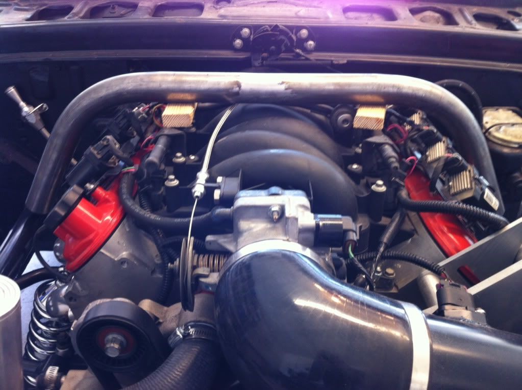

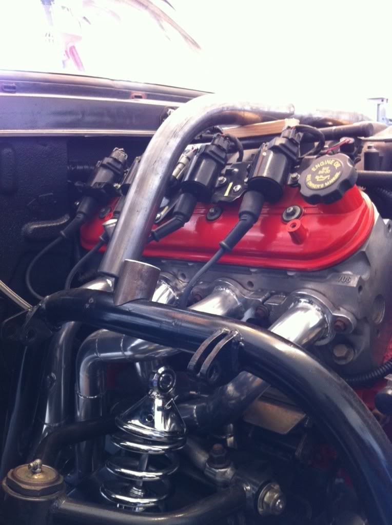

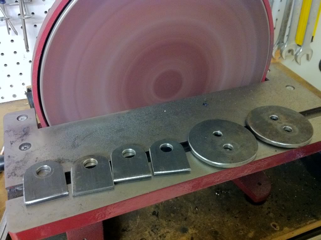

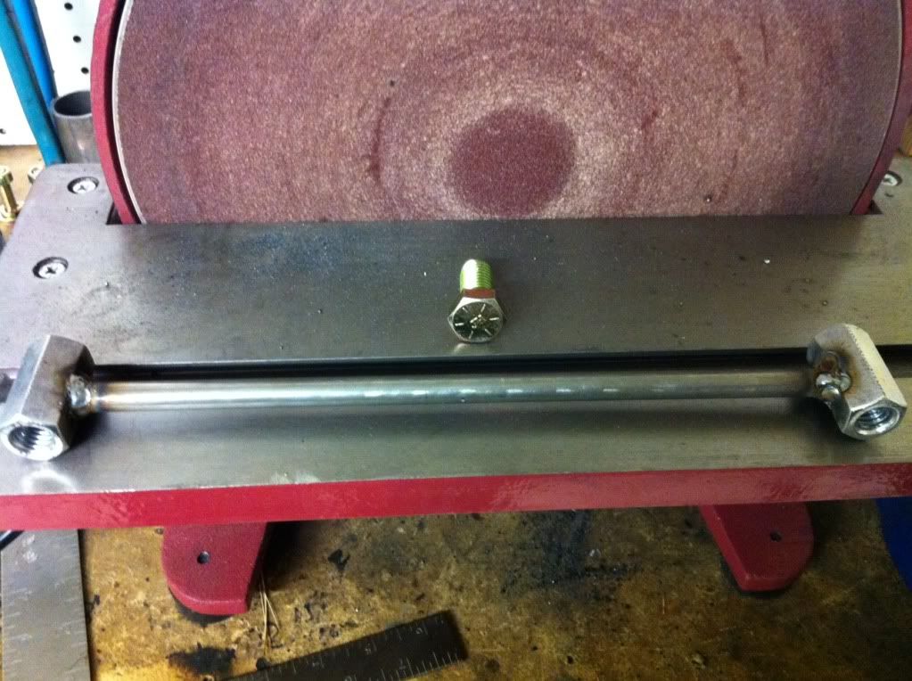

Not much got done today. Dad bent the crossover tube for me. Was a little wide so I cut it down. Then I cut the little pieces so I can weld them to the hoop. And I'll have a flange there to unbolt it all. Also bought grade 8 bolts to replace the stainless ones I have holding the hoop on, and bolts to finish off the rest of everything.

haha yeah ive had it for years

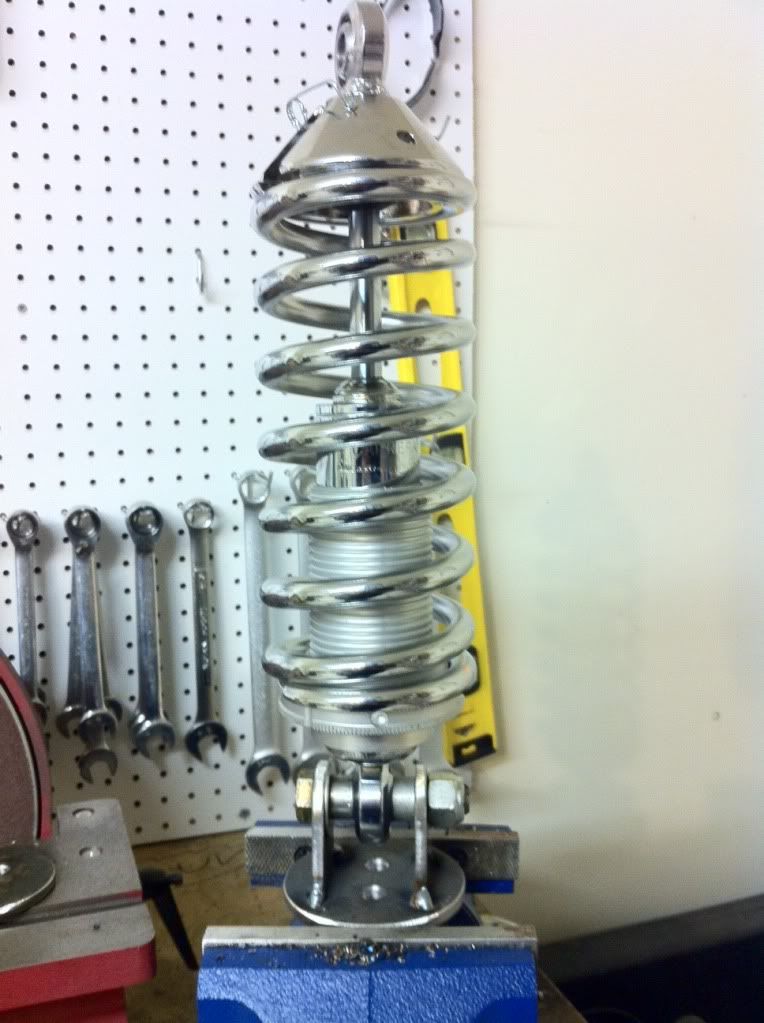

made this yesterday evening real quick.. mock up piece so i can setup upper tabs
PostPosted: Mon Oct 17, 2011 8:36 pm
LSX LUV Owner
Posts: 1261
PostPosted: Mon Oct 17, 2011 8:47 pm
Posts: 2030
Location: s/e ohio
Gahhhh. more freakin shiny :x
J/K man.....looks great.
