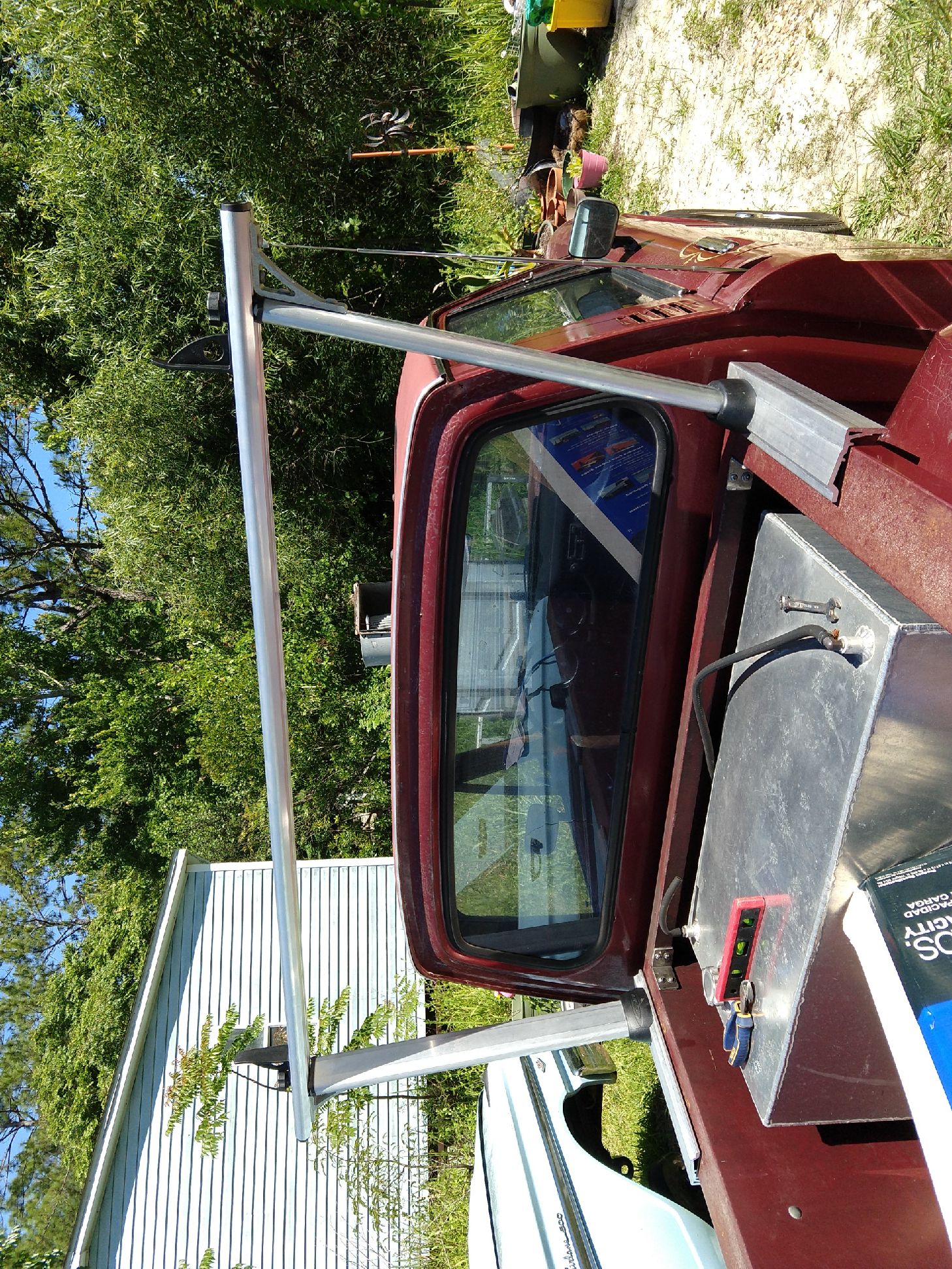

Next up, so I can carry ladders,and use it at work installing cameras an such.

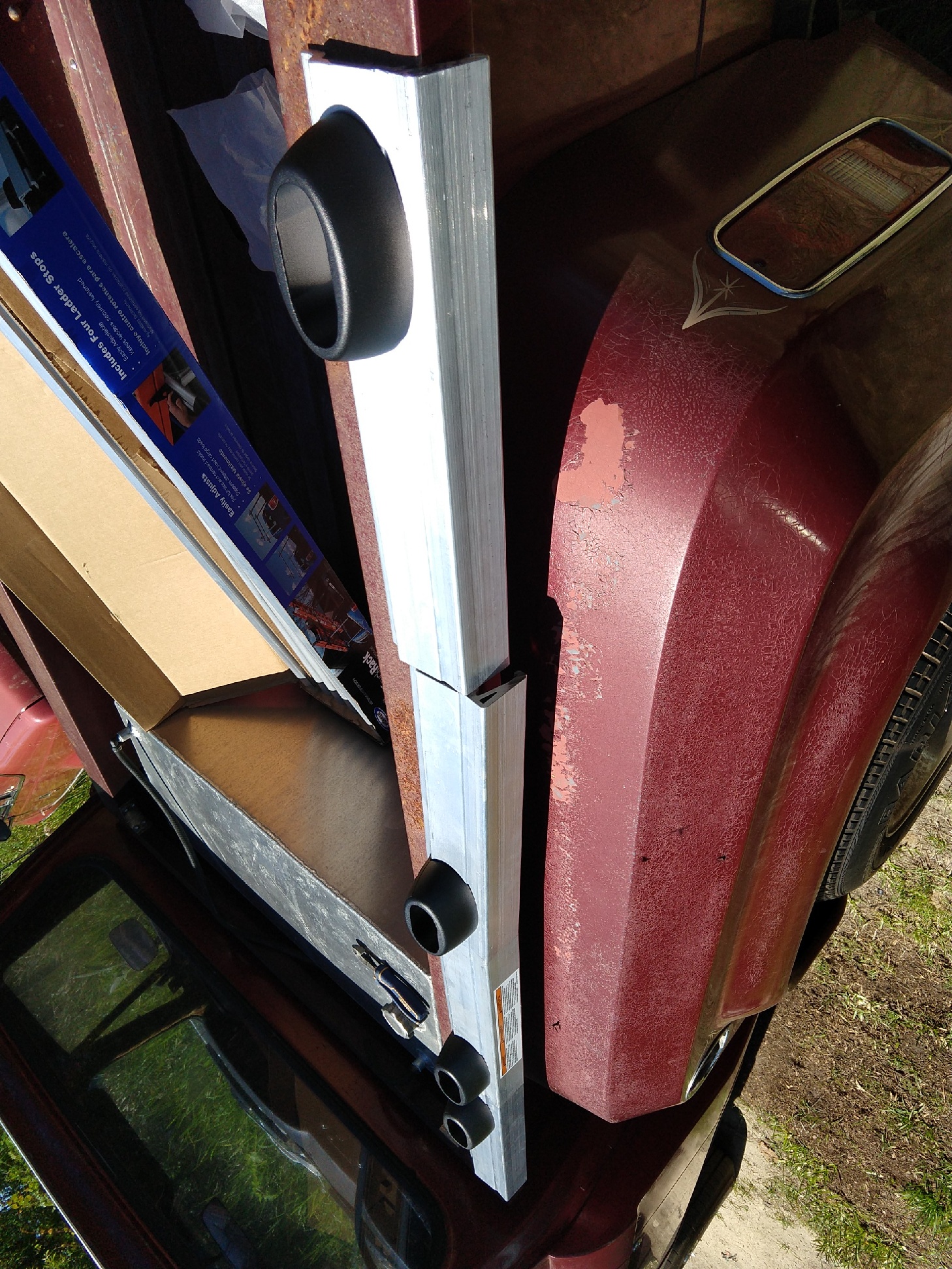

PostPosted: Mon Apr 29, 2019 11:21 am
Posts: 103
some assembly required .

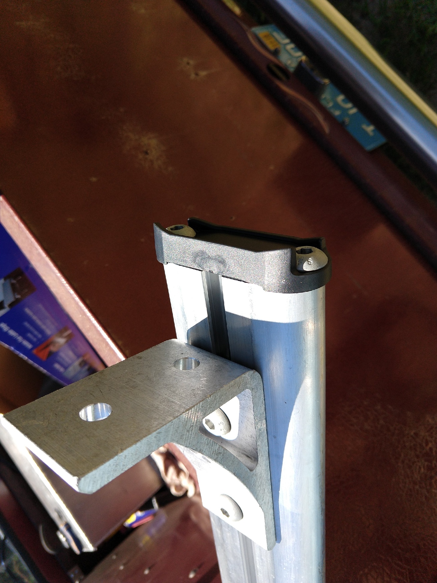

PostPosted: Mon Apr 29, 2019 7:17 pm
Posts: 103
more assembly

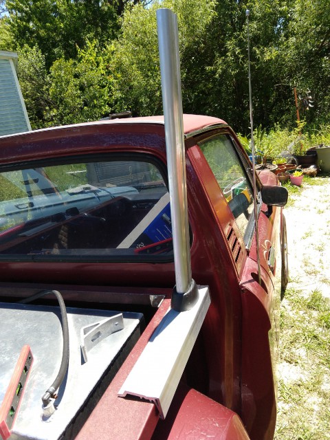

PostPosted: Sun May 19, 2019 6:17 pm
Posts: 103
I yo modify a few things slightly you get this.

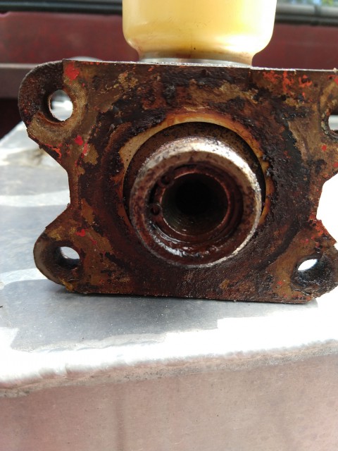

The master cylinder started leaking about a week ago. My sun has been driving it to the collage and back as a daily driver. he pulled in and the thing was smelt like burnt brake pads, and the rims were so hot we could not even touch them. He said it had been smelling all the way home. Guessing he was doing around 70 for about forty miles or so on the way home and forty five for ten miles extra to the house. After it cooled of I looked and there was break fluid leaking out of the mating surface between the power break booster and the master cylinder. After calling three parts stores nobody had a Master cylinder for a 1972 listed. We found out that AutoZone at 44 bucks with reservoir, discount at 65 with out reservoir. Orile at 52 with out reservoir, had a 1974 Master Cylinder. listed. I ordered the one from AutoZone and waited three days for it to get here.
When it arrived I noticed the ports for the lines were on the passenger side instead of the drivers side like the old one we took off. The following is some of the work that it took to get every thing lined up, and working again with the new product.
Brake fluid must have been a slow leak for a while for it to get all that rust. we just started to have to add fluid about four days or so ago.

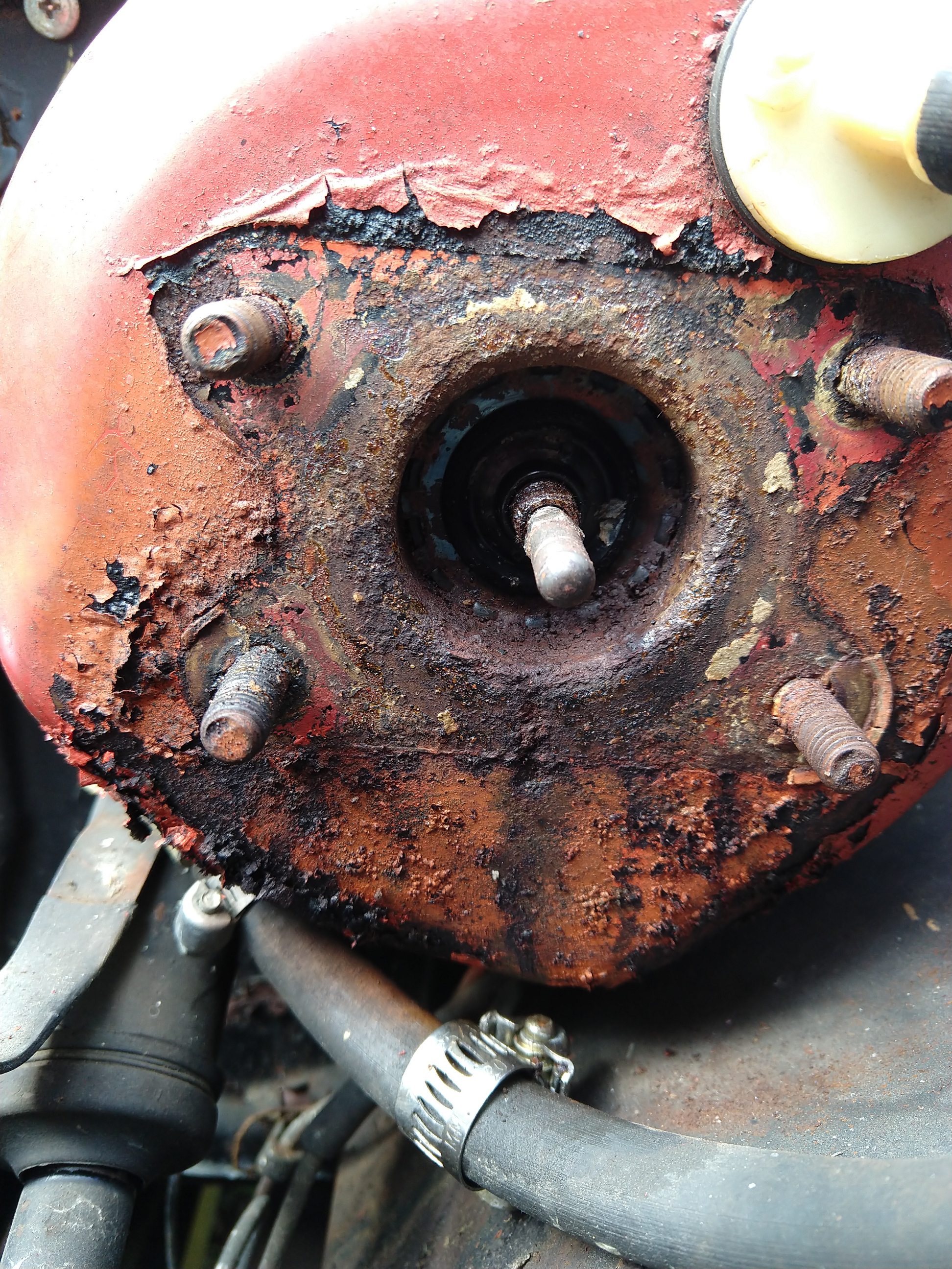

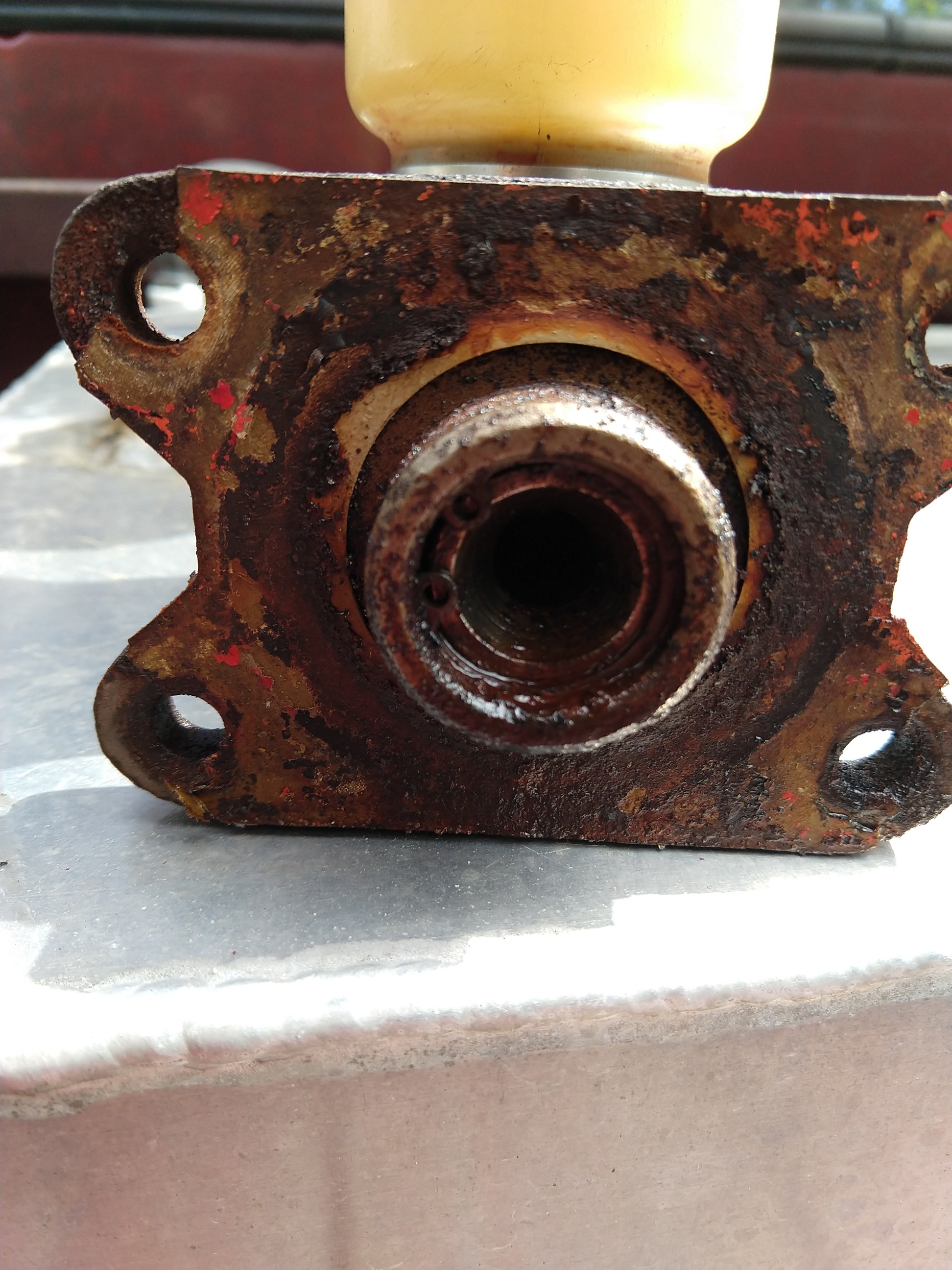

The back of the master cylinder has been leaking in to the booster it seems.

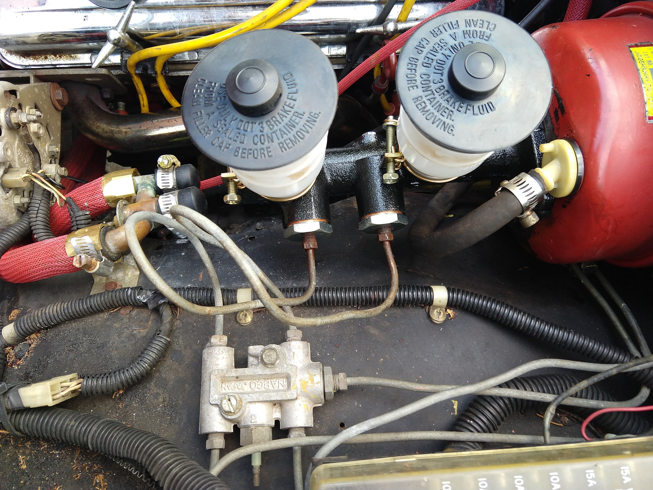

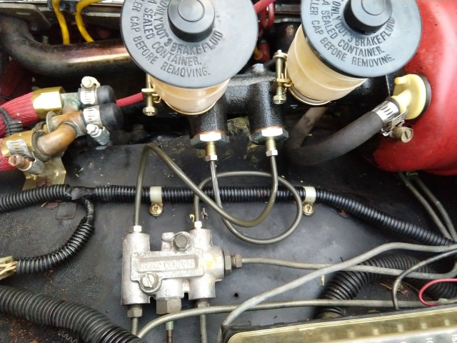

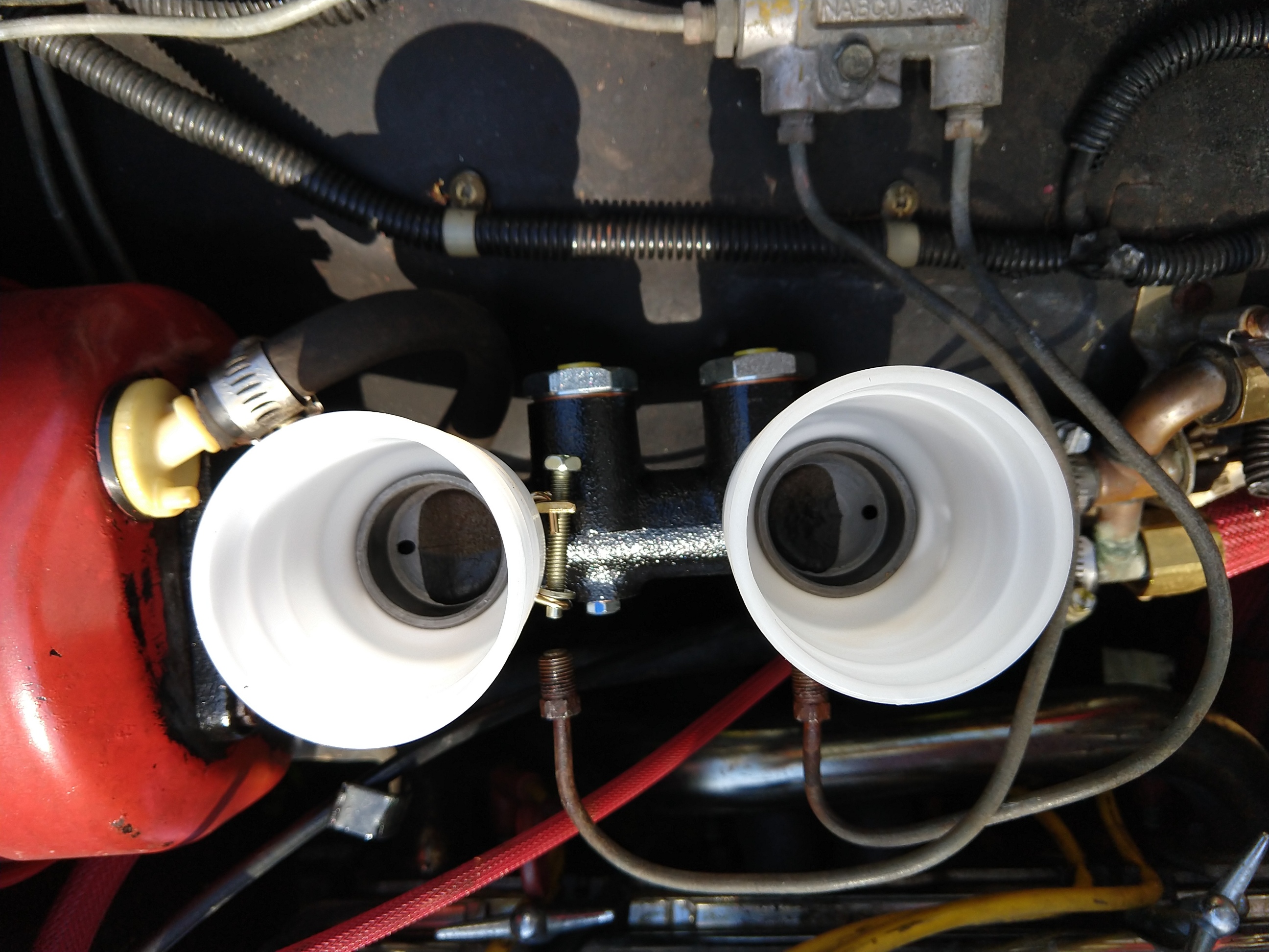

you can see the problem with the break lines in this photo.
PostPosted: Sun Sep 22, 2019 8:04 pm
Posts: 103
You could just bend the old lines around and reuse them, but I think it look bad doing it that way/

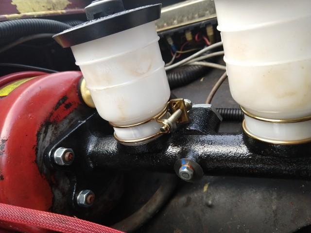

PostPosted: Sun Sep 22, 2019 8:08 pm

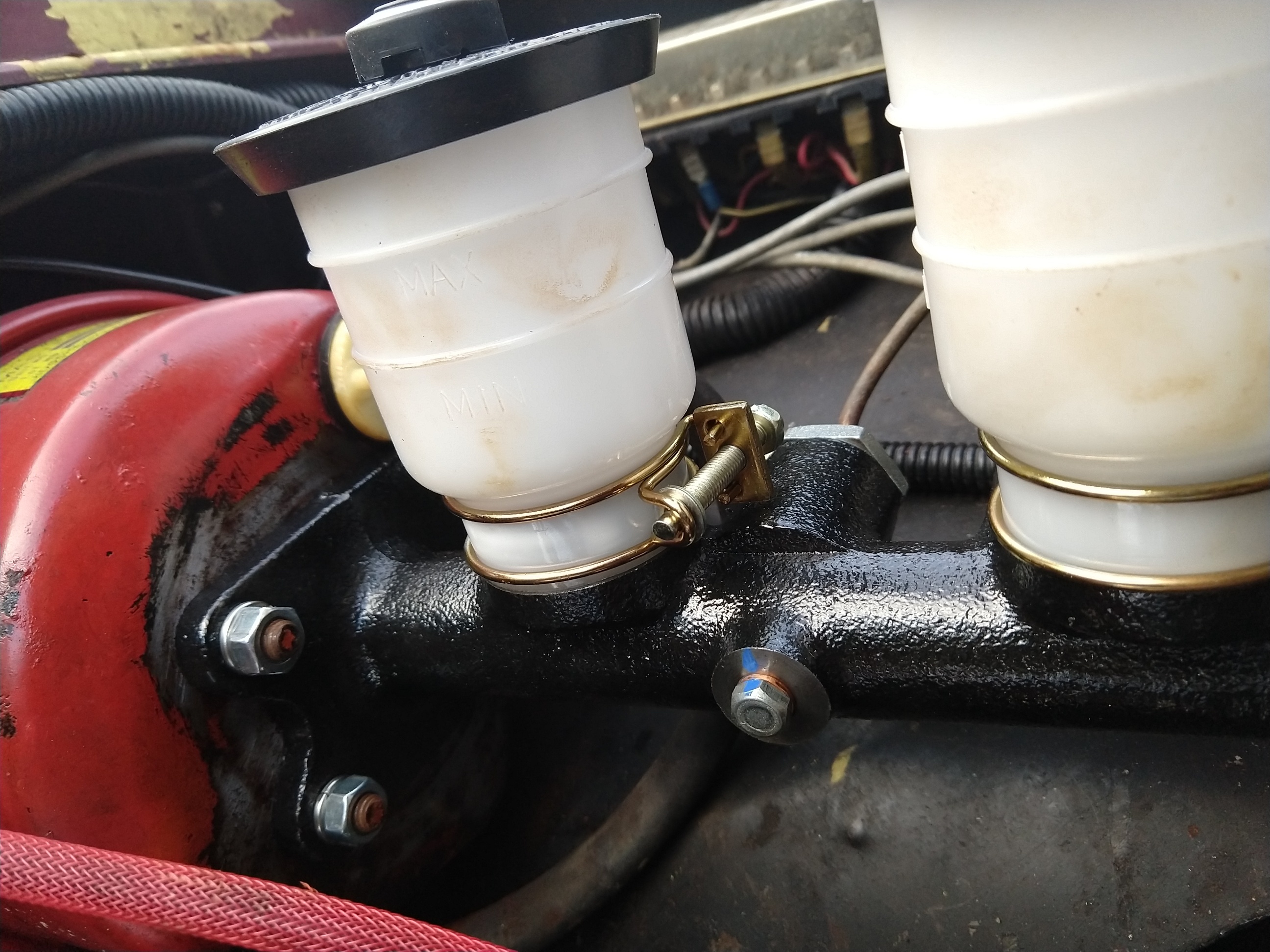

Posts: 103
I am going for that abused and used look. after I sanded down the rust on the booster and sprayed it with some high temp clear coat, I sprayed the new master with some clear coat also. least we forget new stainless steel nuts and washers.

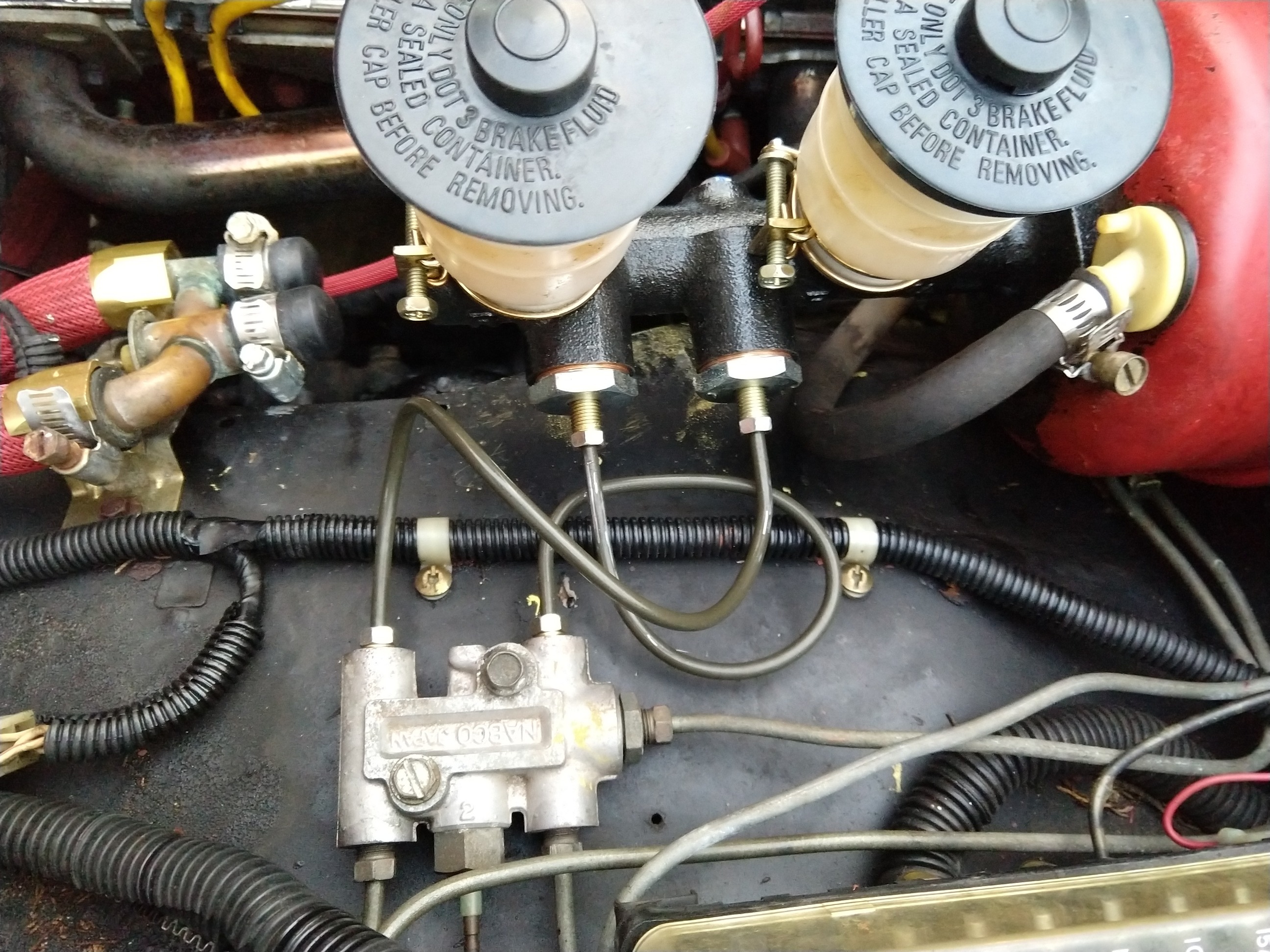

I just could not stand the old break lines looking so bad. out came some new line and the flaring tool so I can get them to look like this.

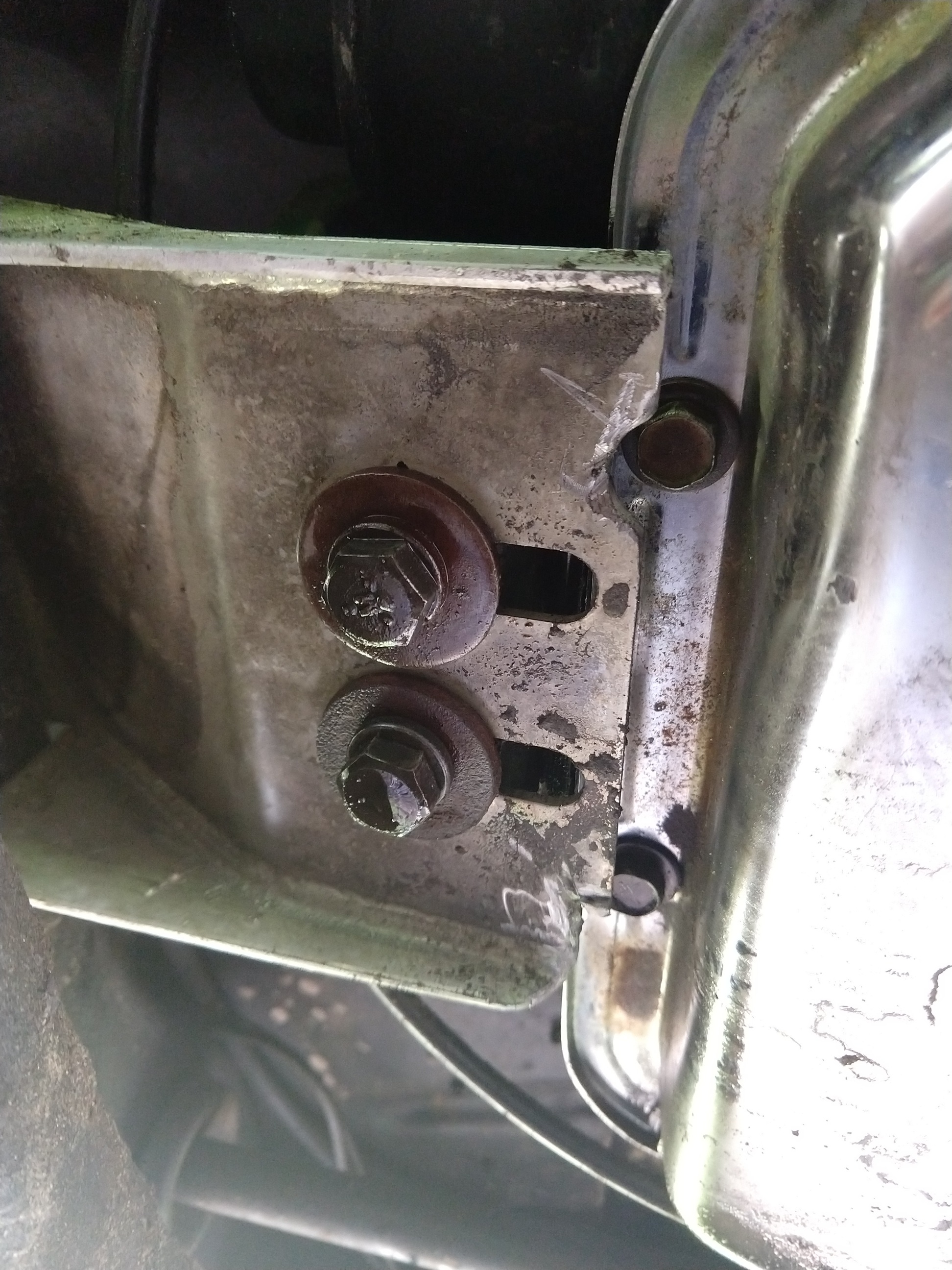

Posts: 103
Which led to having to notch onside and to cut a section out so I can get to the bolts.

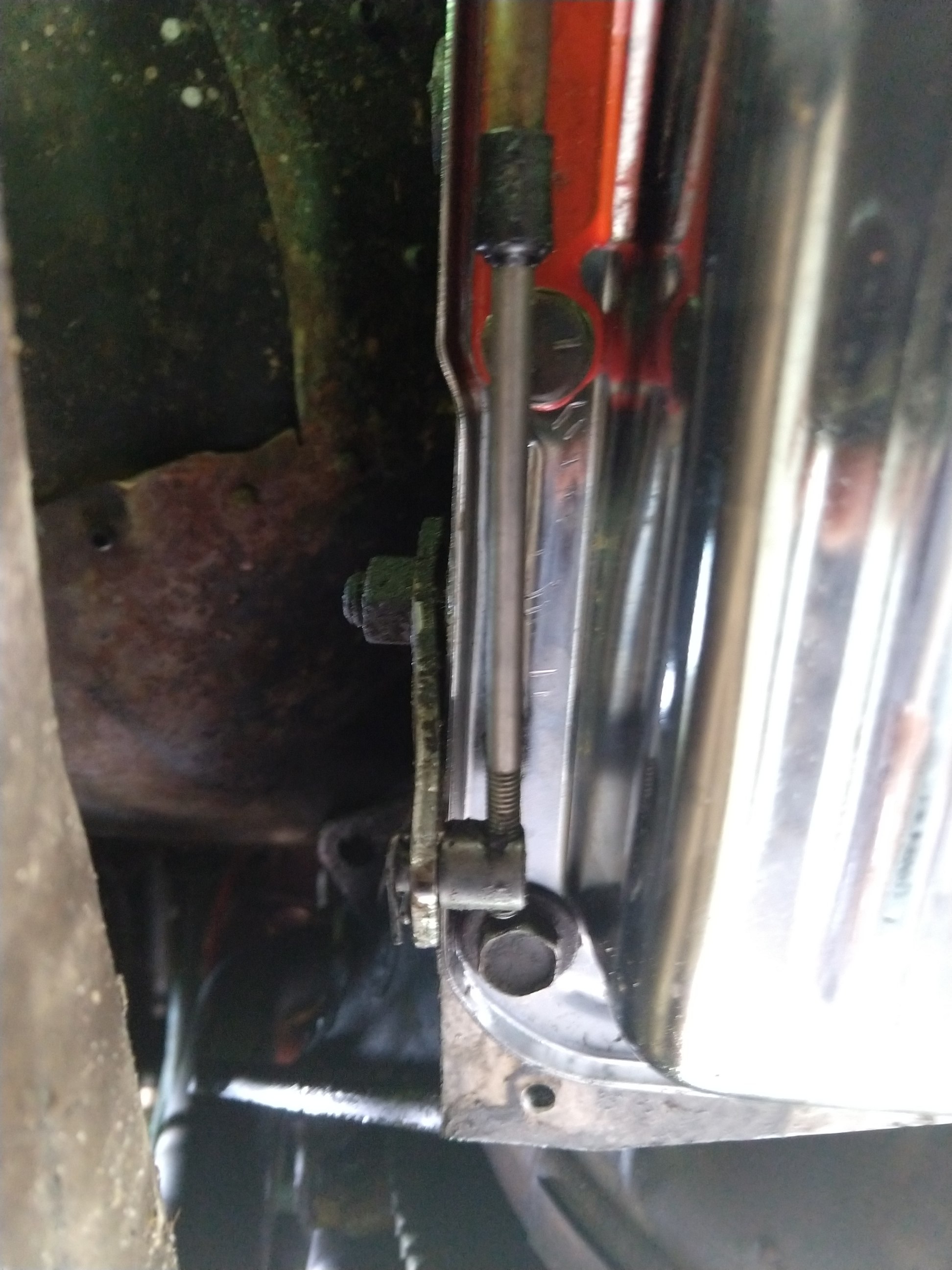

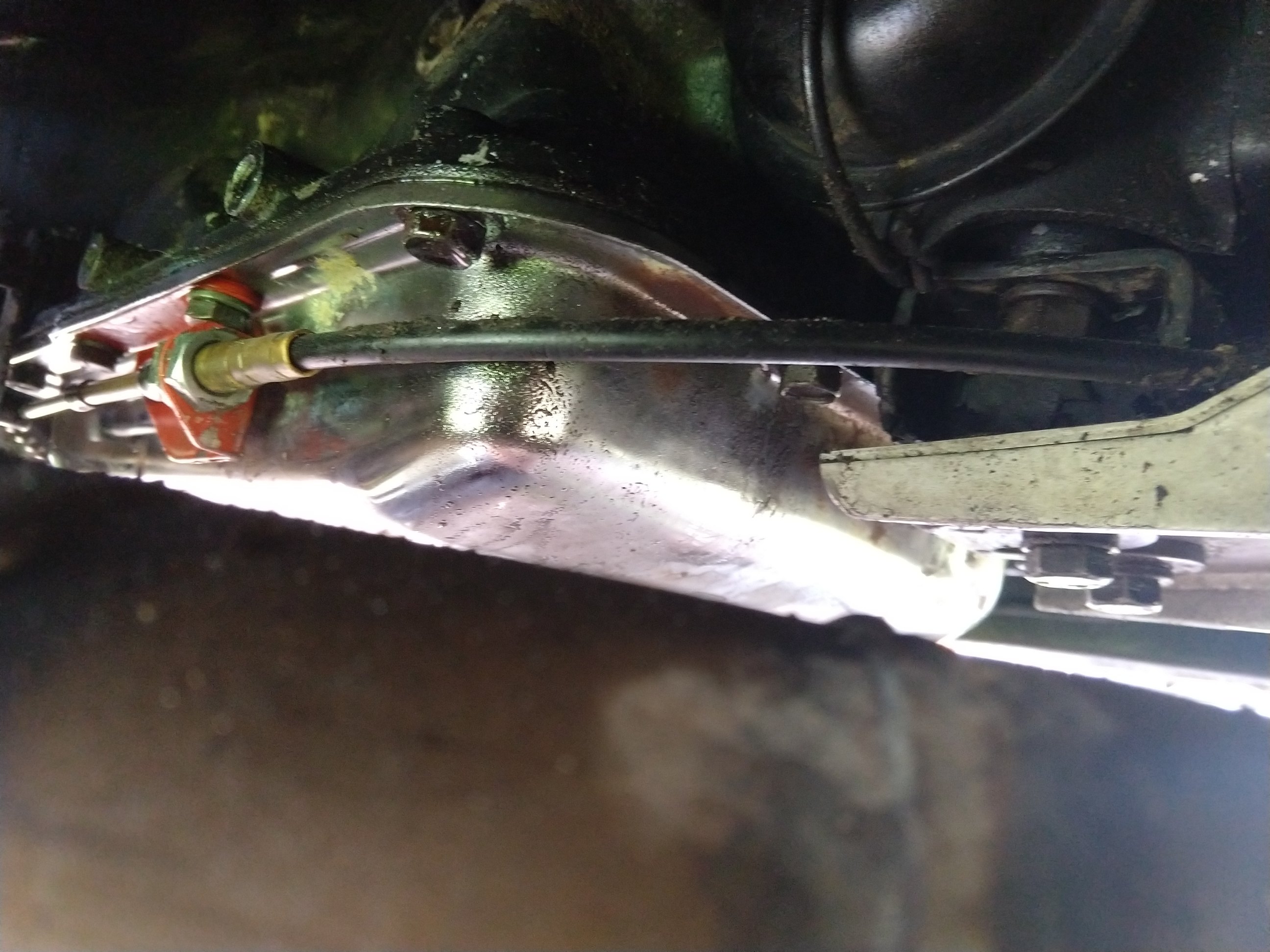

this shifter cable has to come off to get the pan off

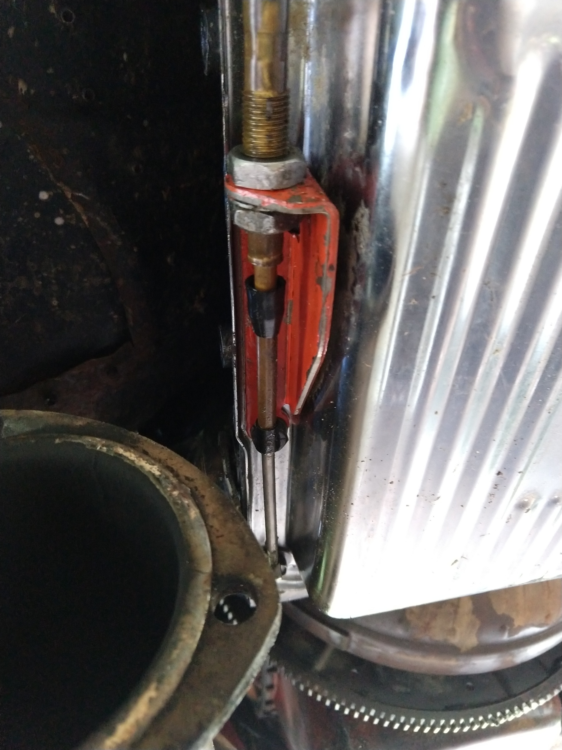

different angle view of cable

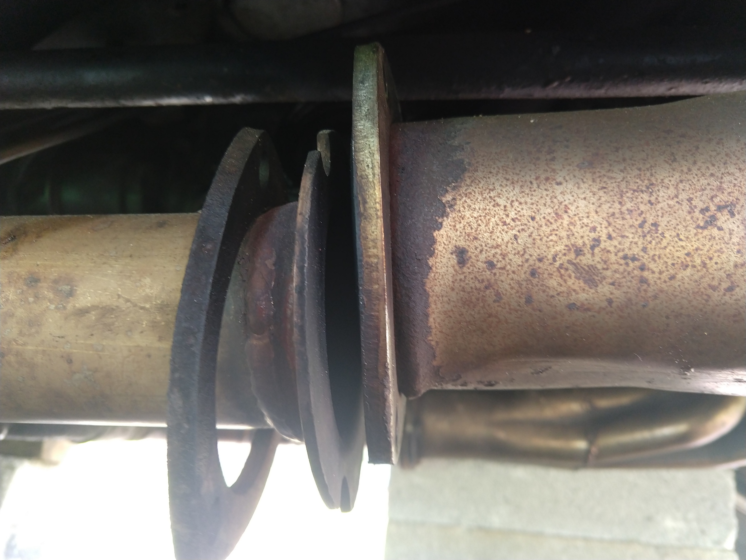

Posts: 103
you have to pull the exhaust pipes loos so you can get a wrench in to work on things. they both had bad gaskets that I was going to replace anyway. this is the passenger side
