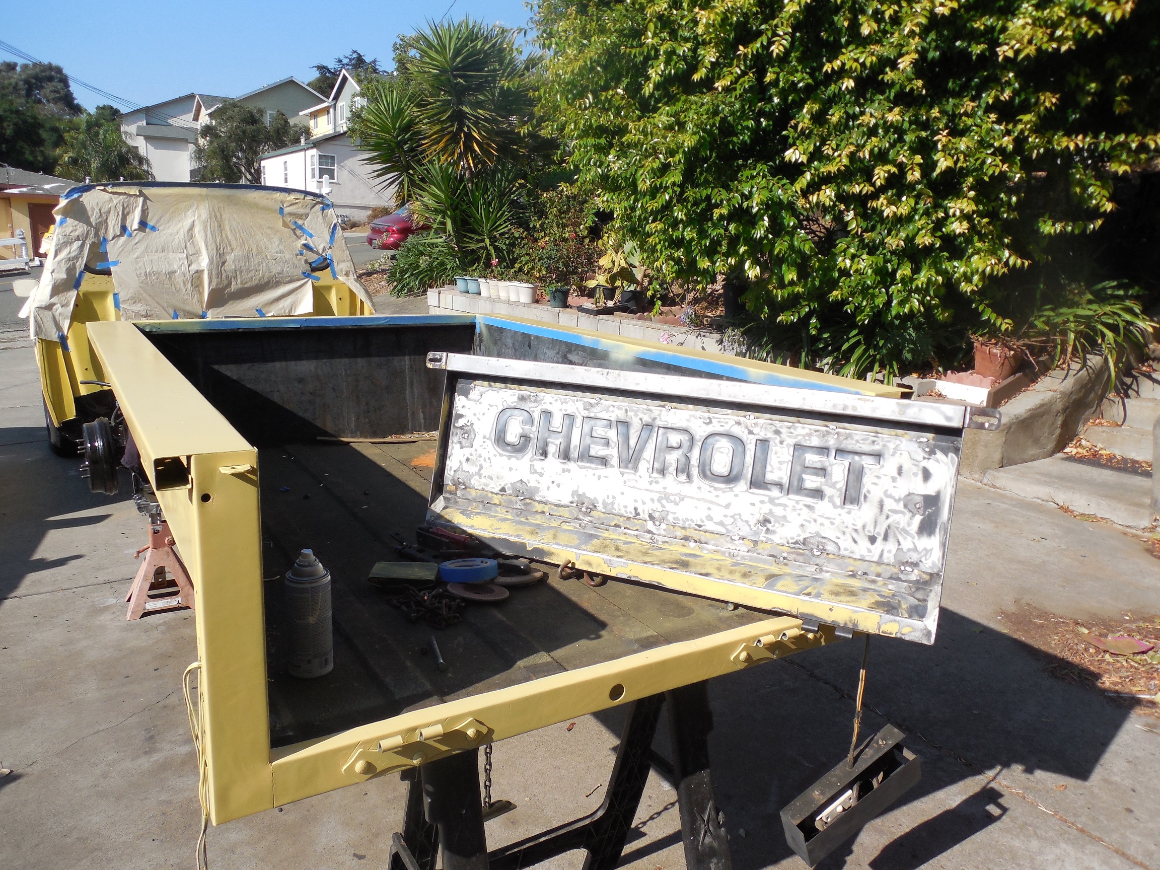

Still going on Ms Sunshine 8)

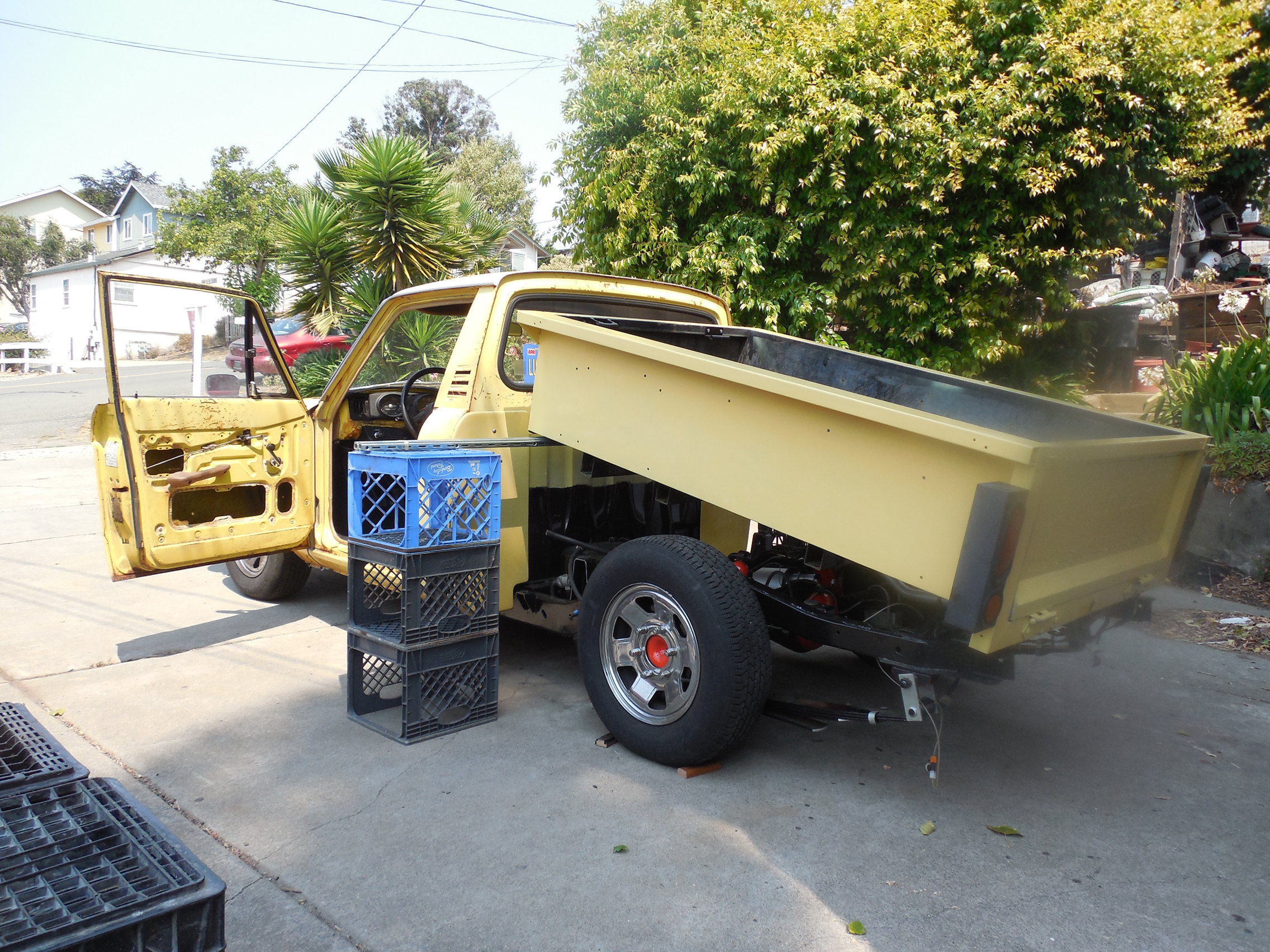

File comment: getting the bed back on...did someone say TILT BED?

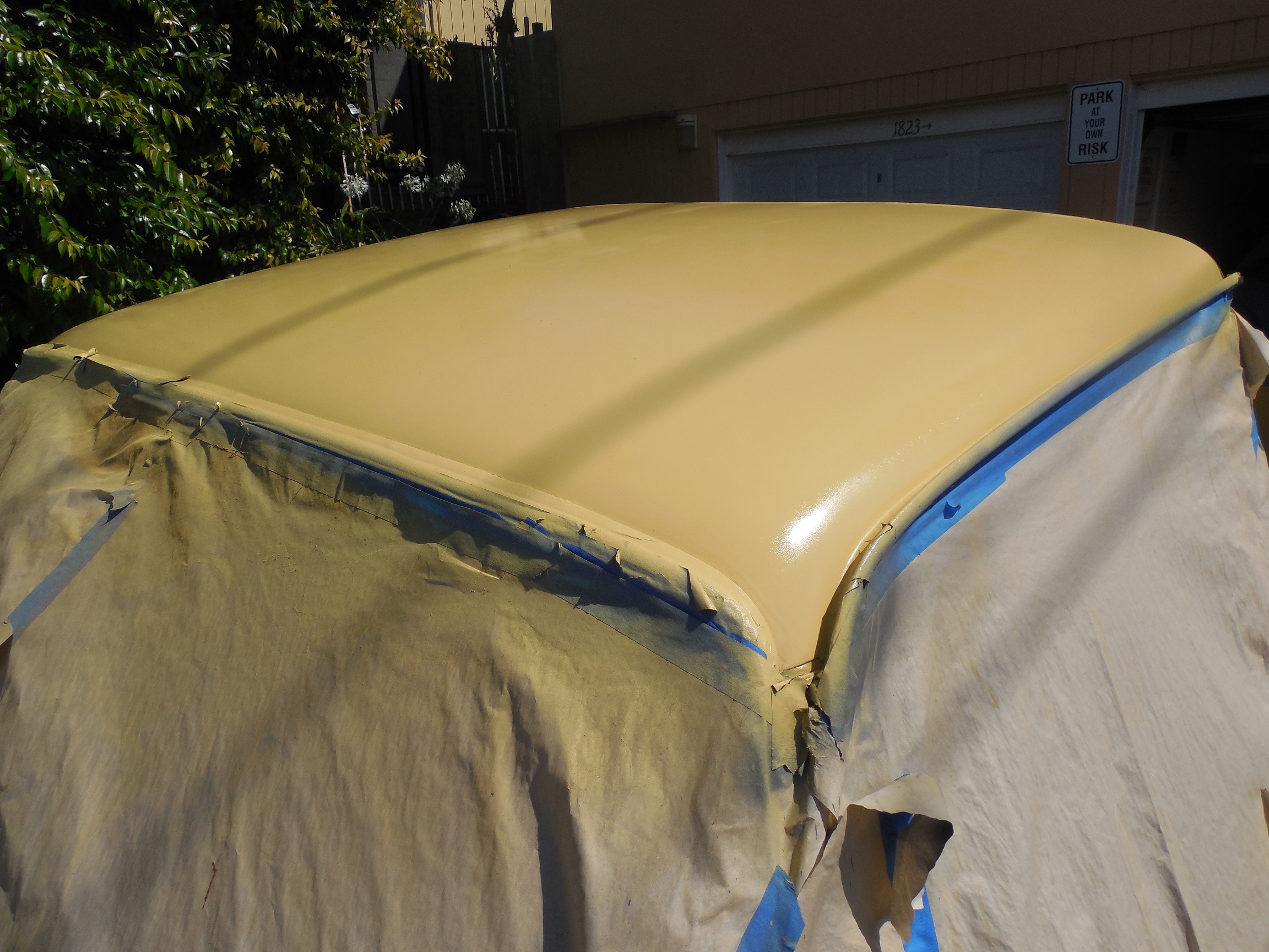

File comment: The top got a couple coats of warm yellow rattle can
File comment: Tail gate needed some attention tacked in a CHEVROLET panel

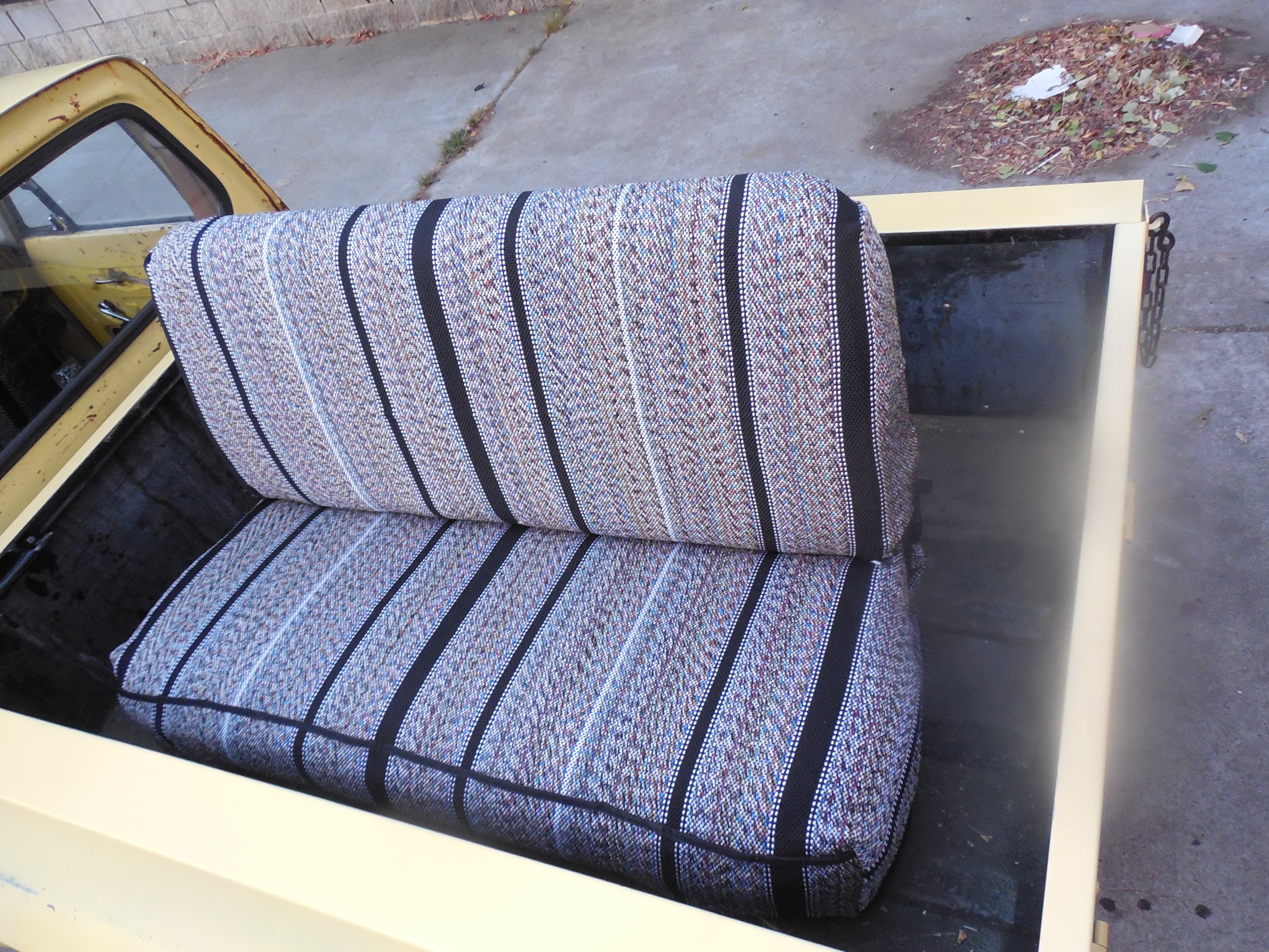

before wrapping this up back 1/2 clean up & while the seat is still out I plan on pulling the heater unit out and get it going again no heat & fan not working yet defrost works
4432

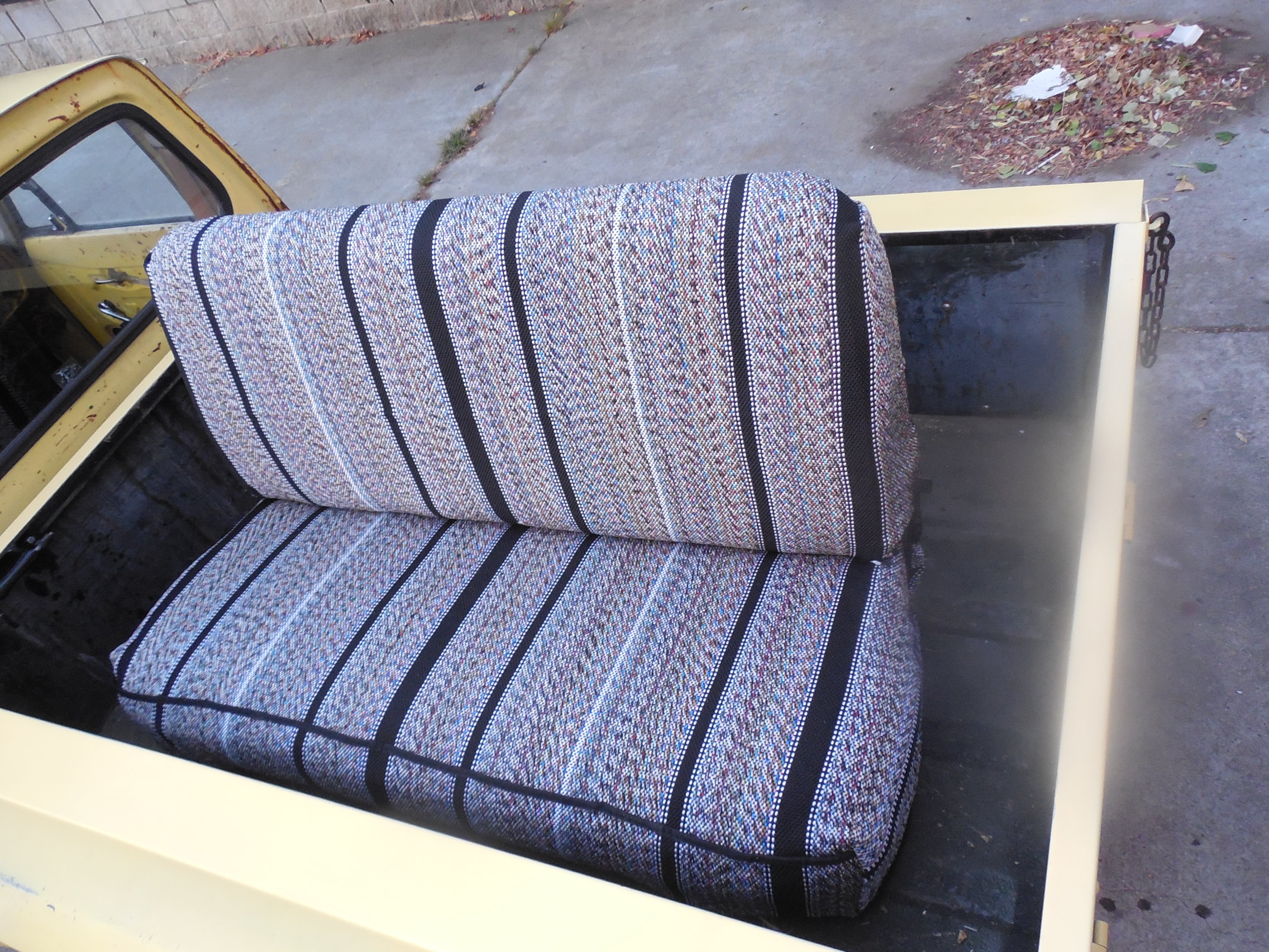

File comment: seat got a new cover..these don't fit the best but w/ a little cutting and hog rings will hold it on good

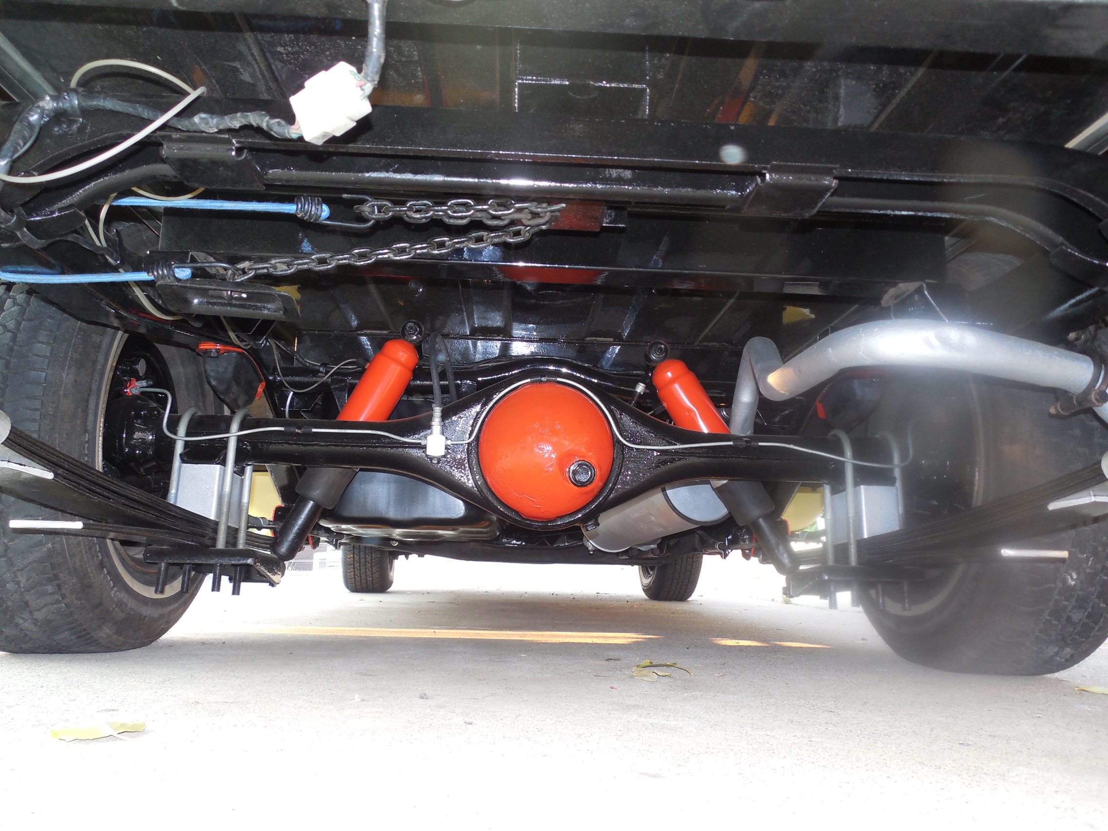

File comment: a peek underneath w/ the bed back on

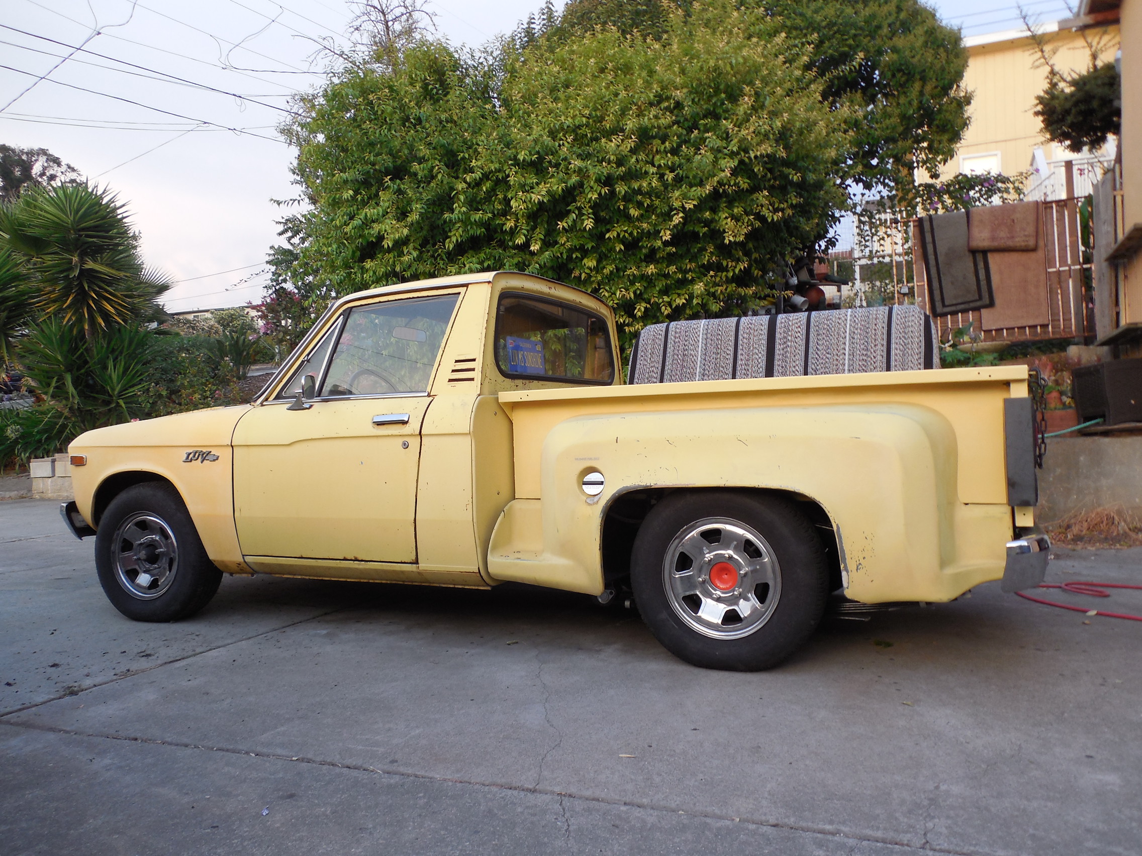

Great Job! I am assuming Stock rear diff, but what are your specs on tires and wheels? also 3" suspension drop on blocks?
PostPosted: Mon Aug 28, 2017 9:32 pm
Posts: 607
Thanks its been needing some attention & smog next moth so muffler had to be addressed, & 1 thing lead to another biut most was planned a while back.

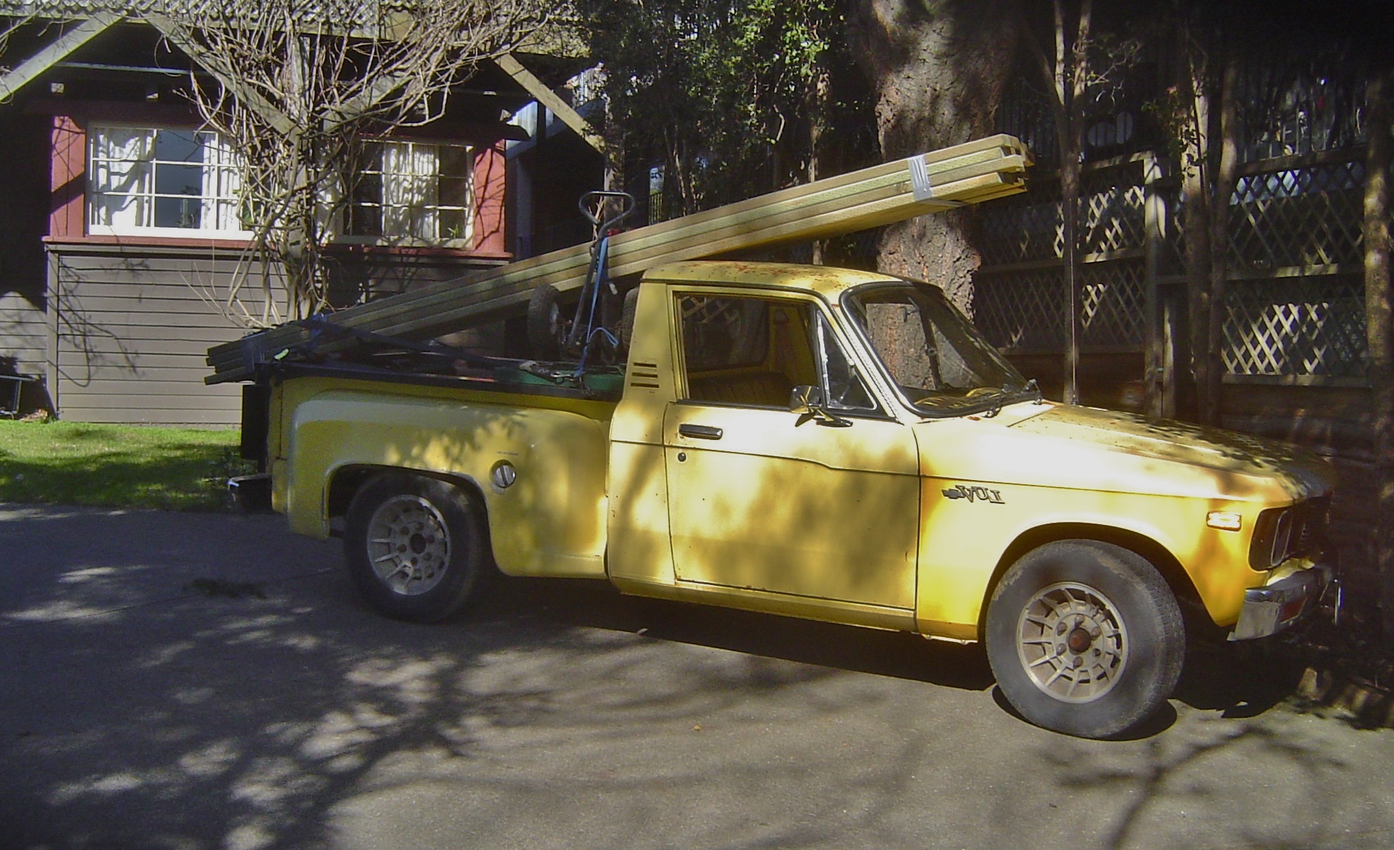

Yes, mostly stock parts on this Luv. tire , wheel specks are nothing special picked up these path finders wheels at Pick N Pull for my 75 Luv yrs ago, tires 195 75 R14. I think they are a pretty standard sm tire size .....had some turbine rims on there for a while. tires on them were splitting & bald so was using these as they had good tread left for now & I will be putting turbine rims back on when they get some detailing . They were a little wider tire...& rim ?...working on the heater core & been cleaning up all those rust freckles on the hood & rattle can paint for now

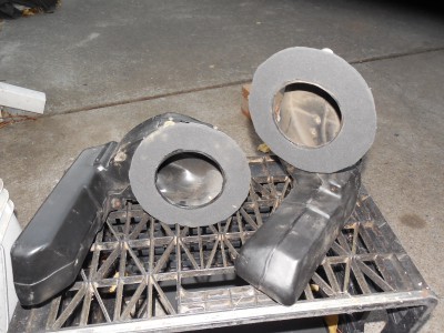

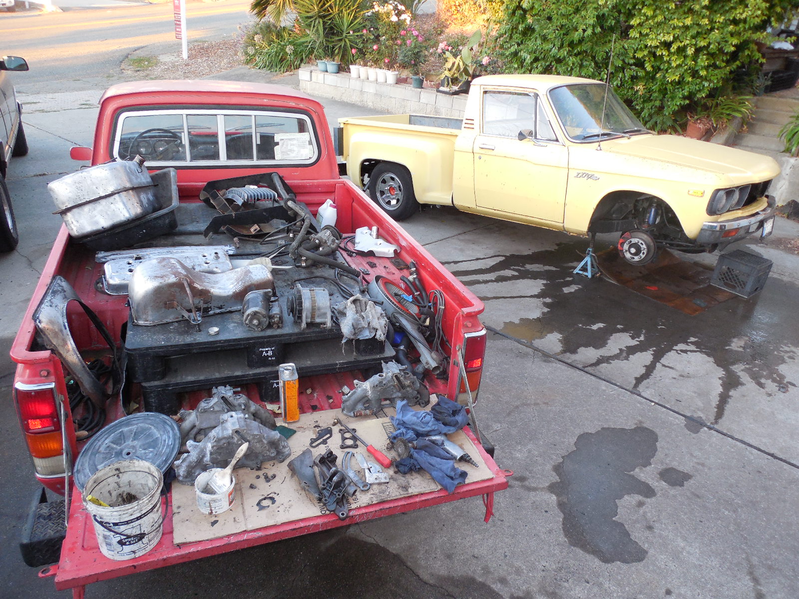

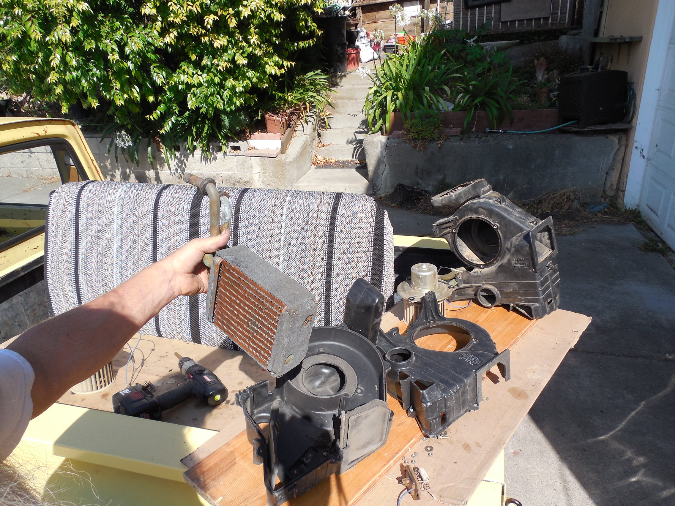

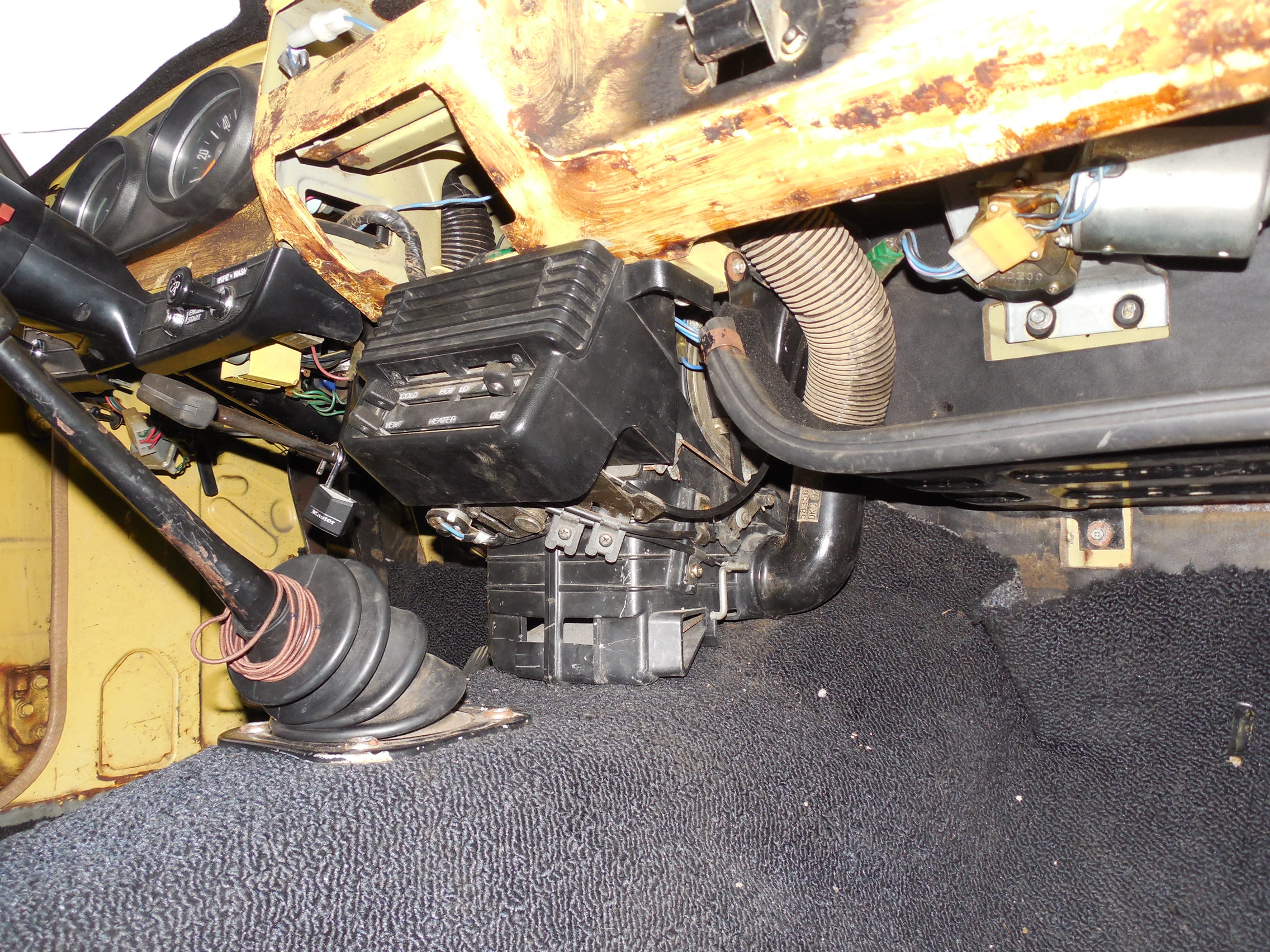

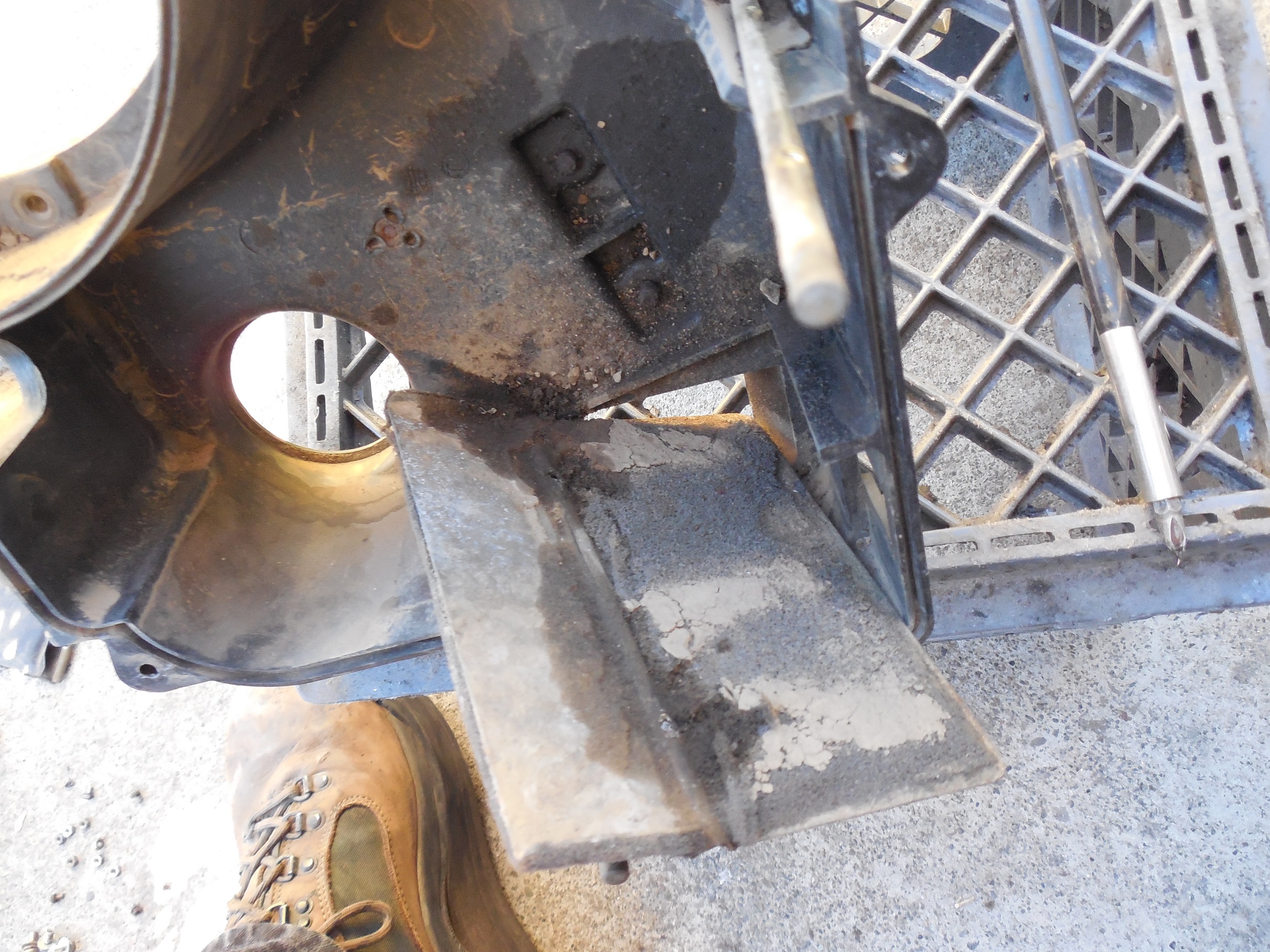

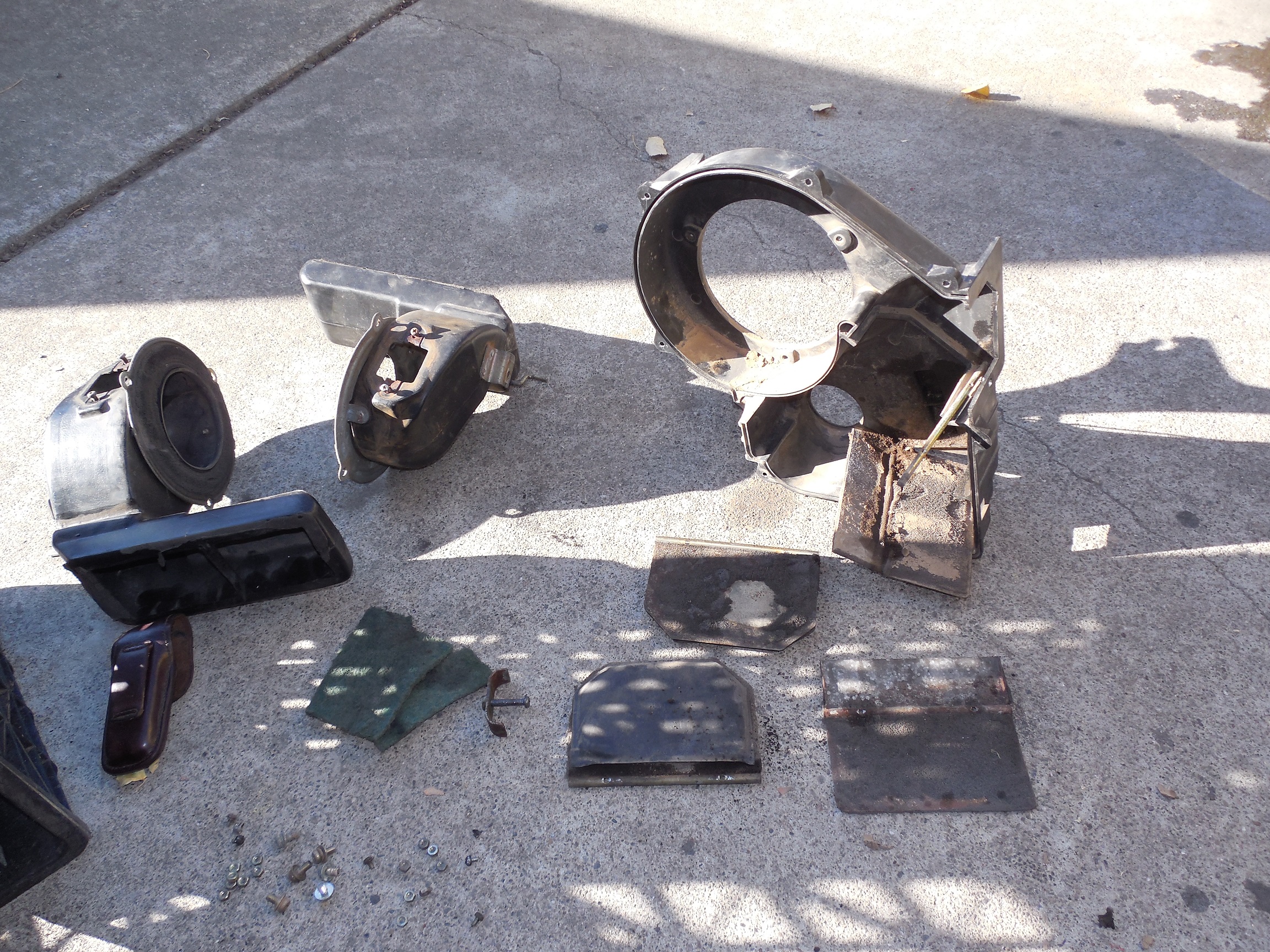

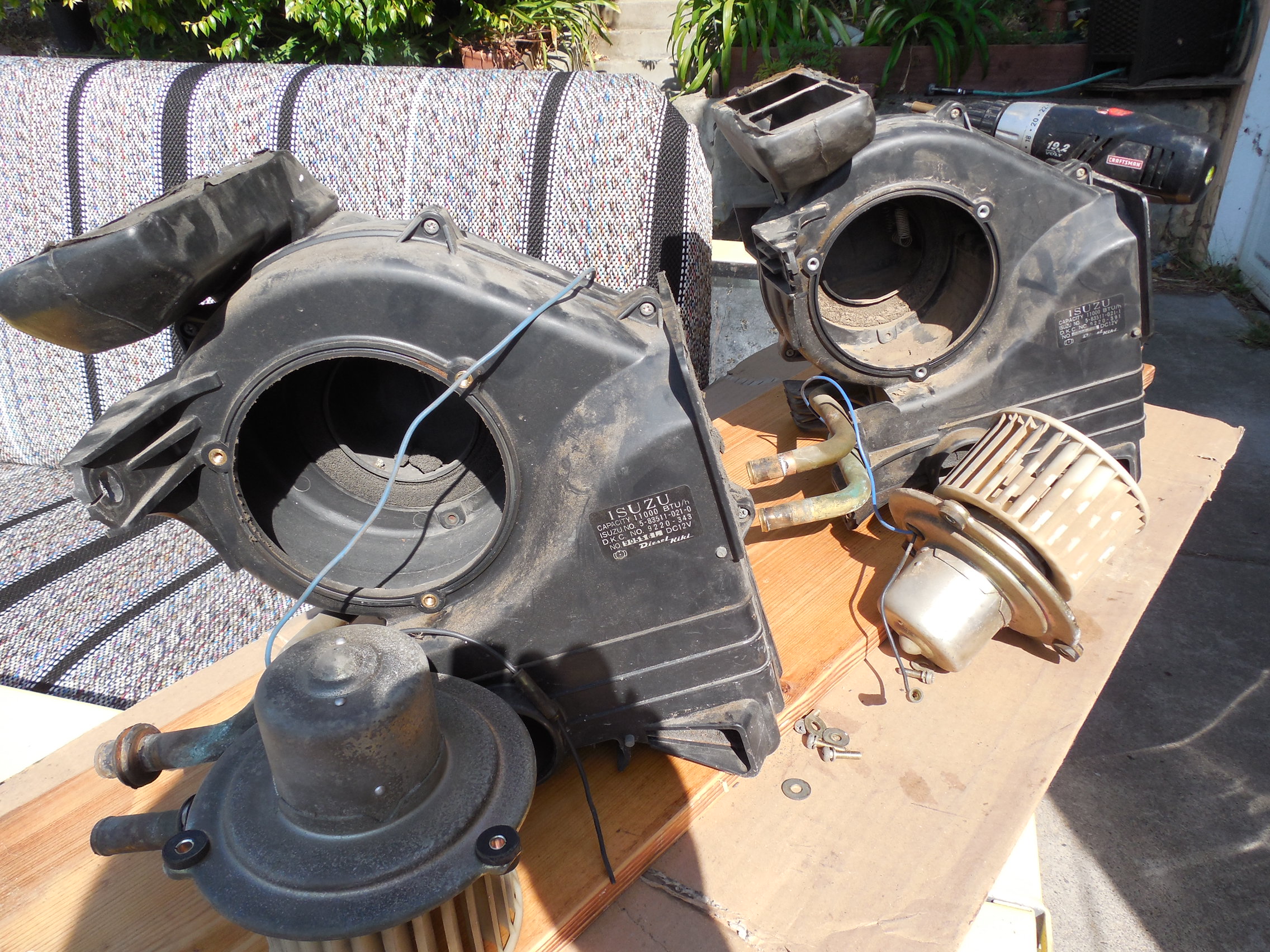

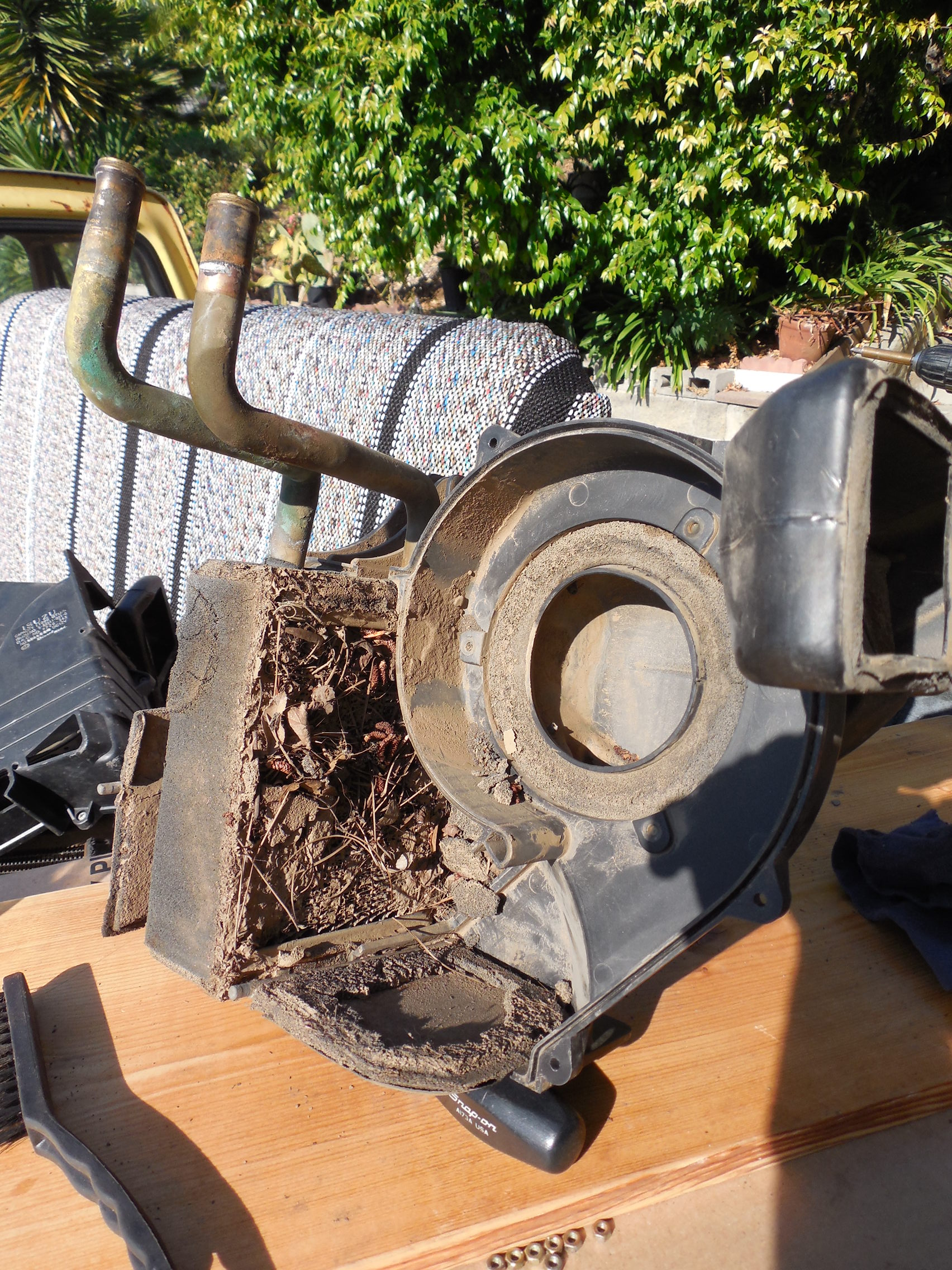

next up Heater core unit pulled it out and all apart couple pics below to share some details
File comment: pulling my spare unit part and picking te best working parts
File comment: realized the one item i didn't pull off this truck after the flood it was in was the heater unit...see all that mudd

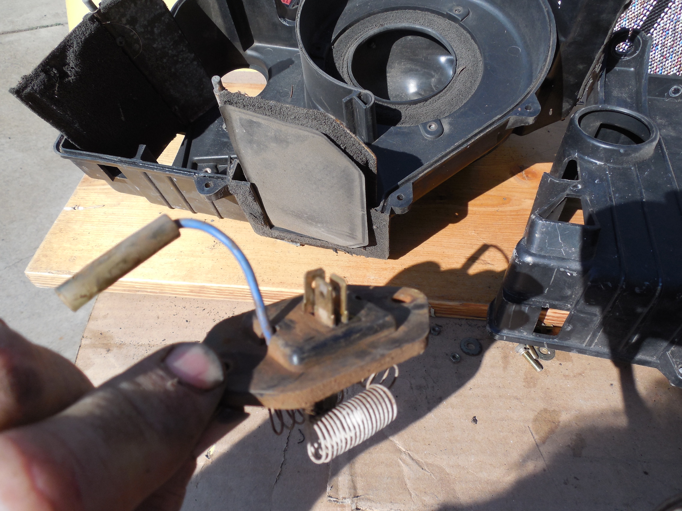

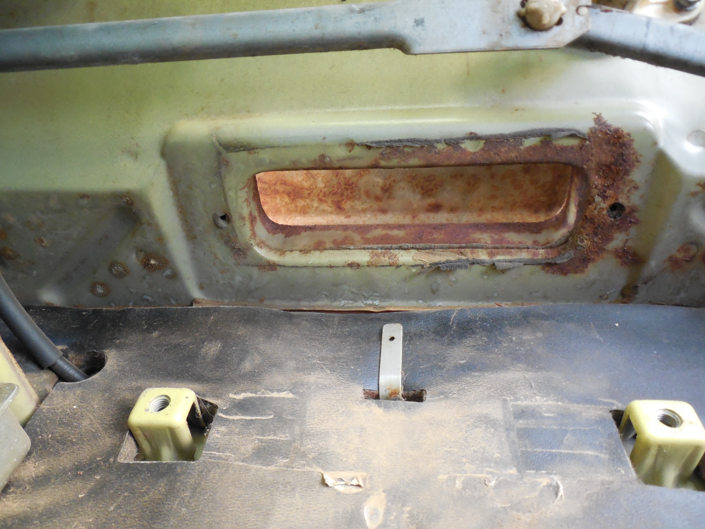

a few pics of the heater cor process
File comment: the vent where all the air comes in the cab

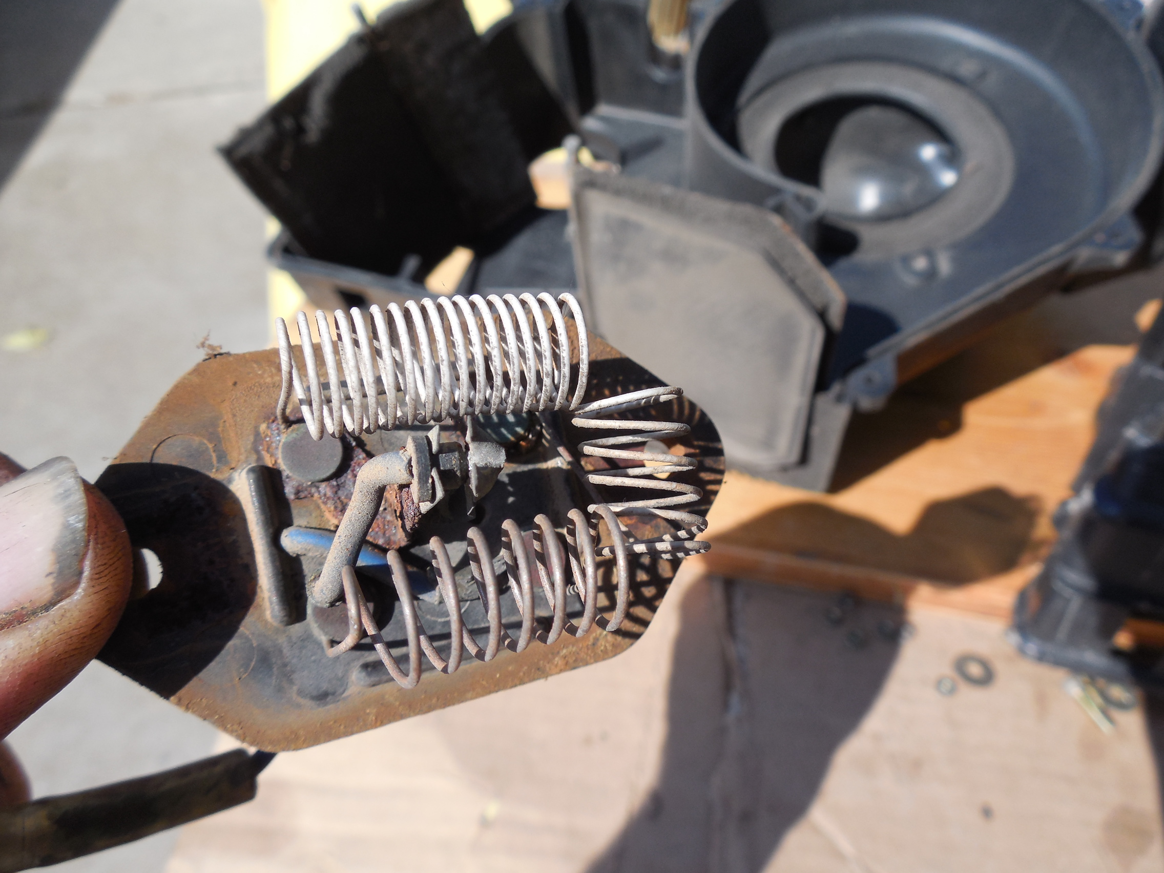

File comment: the resistor looks simple and all there . still not sure what it actually does thou :)

Well got the heater core all back in & No heat ...warm defrost but NO heat...
Anyone been done this path ? ...any suggestions ?
I GUESS I will double check if the doors are opening & closing right as the heater core didn't leak nor did it seem clogged.
Then back flush the core while still in w/ the motor as well

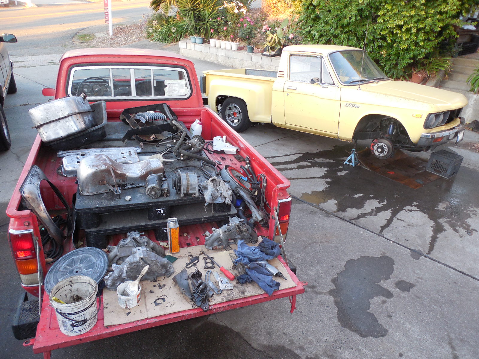

Well took it all out again :econfused to swap back to the one i pulled out as i thought it was just dirty from the flood...
getting quicker at a heater core change that's for sure :lol: done it in about 1 1/2 hrs out split the clam-shell case swap cores and all back in except for the passenger shelf

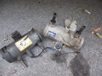

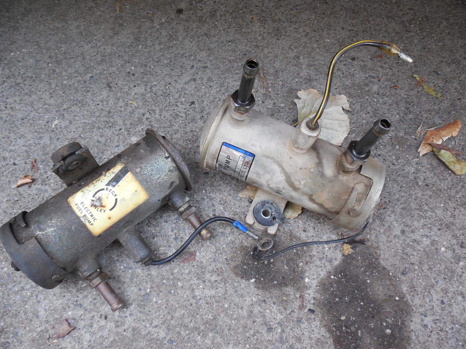

starting filling w/ water & the truck dies :esurprised so no checking for heat have to figured this out 1st...so started checking the obvious is it getting gas..seems like it do i have spark pulled a plug ground ...Yes spark is there pulled the cap check inside there i'm due for a tune up cap is a couple yrs old so scarped the contacts / along w/ sliding some sand paper between the points blew out the dust...& packed it all up for fresh eyes another day

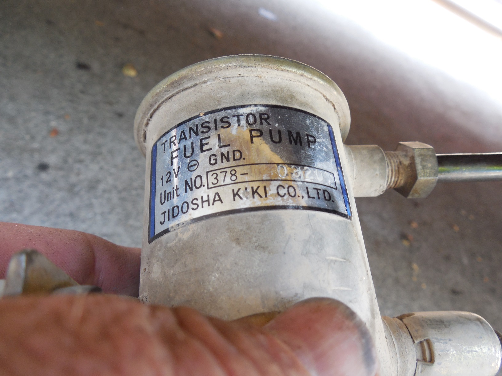

Today i gave it some gas manually and it will run ...so pulled the fuel filer by the carb its getting gas but seems weak pulled the pump of my 4x Luv, turns out it was the fuel pump.
it makes the reg pumping noise & looks like it pumps gas but not sure of the pressure...so now i'm looking for a fuel pump for the 4x......anyone have a stock WORKING fuel pump ?
today i see the heater core dripping inside the cab so by passed the core w/ hoses for now ITS COMING BACK OUT :lol:
File comment: specks on the working one IF anyone can use the info
File comment: Old failed one on the left newer working on the right

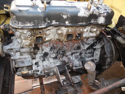

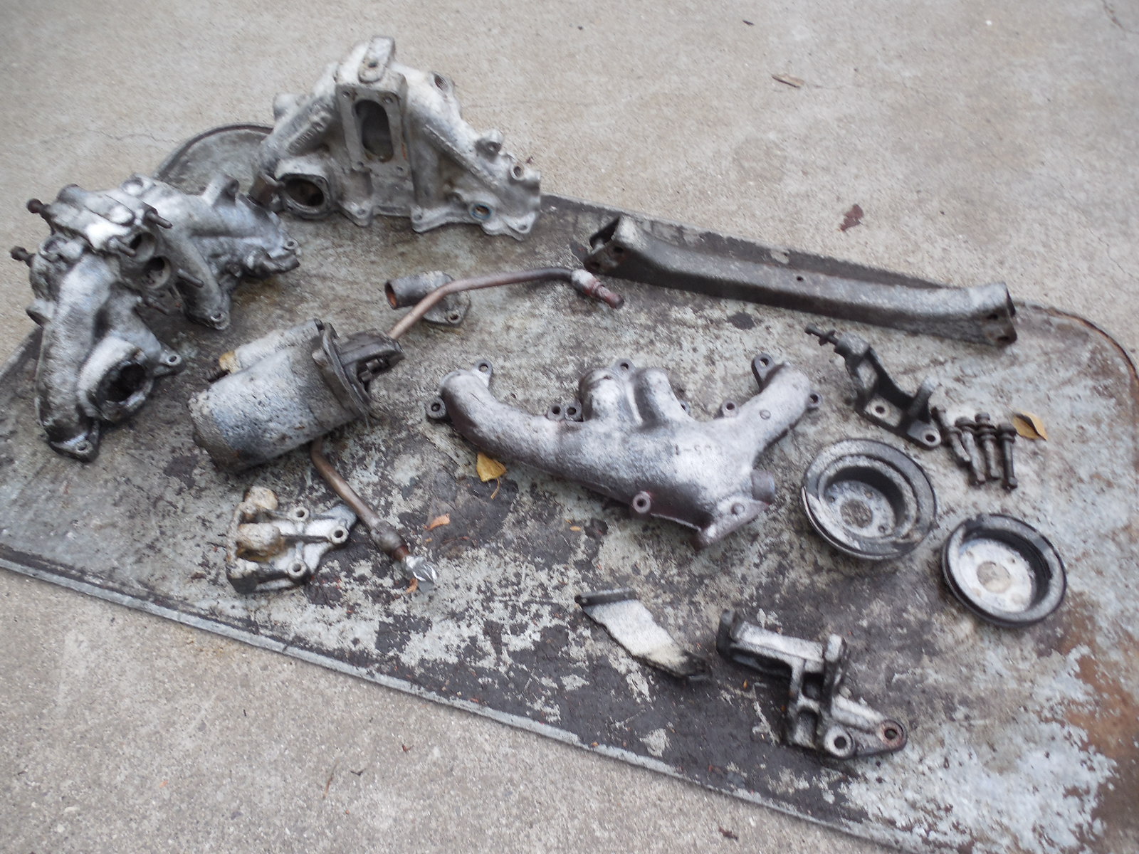

One of the stock pump started working but i can't rely on it so i went ahead & Picked up a Mr Gasket fuel pump, some new fuel line.

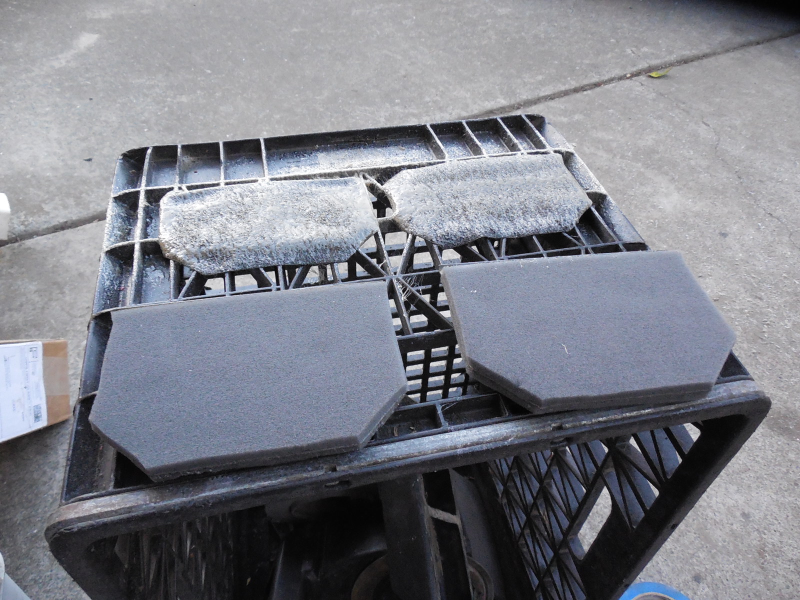

Heater is still by passed and out, I think i'm going to re foam the flaps inside. The foam isn't the best after 40yrs, beside the floods she was in 10yrs ago...also have the intake out and Now cleaning up the engine.. Hell I pulled the oil pan off to :) ...you just get carried away reworking an area...all i wanted to do was check the egr for carbon build up before smoging... :lol:

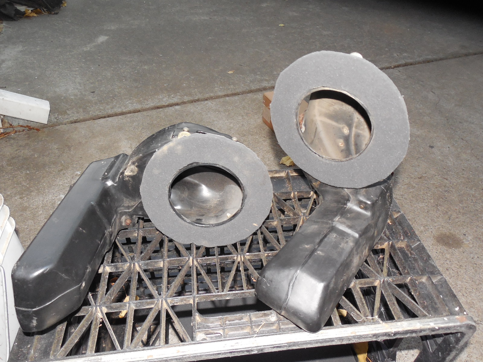

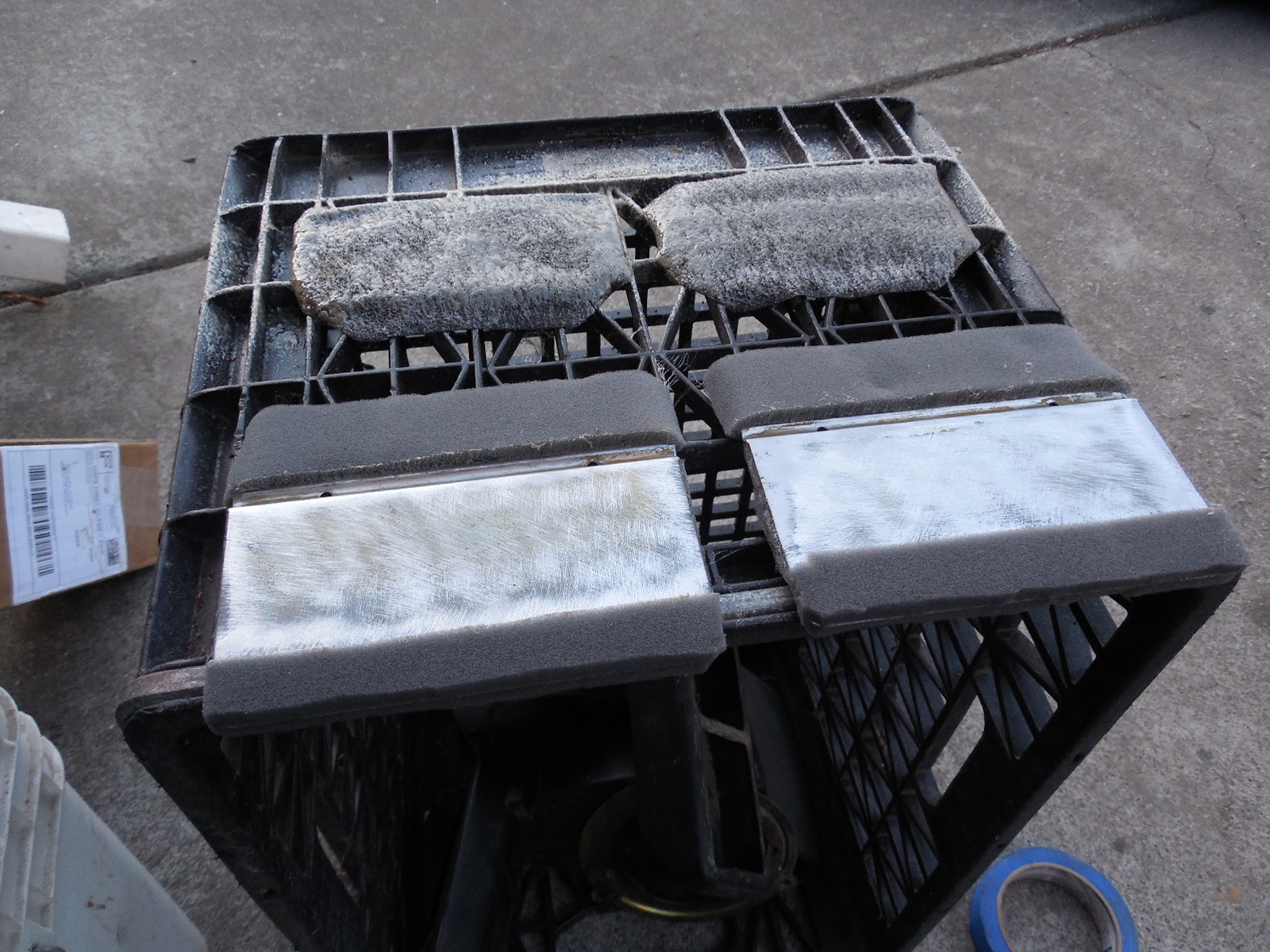

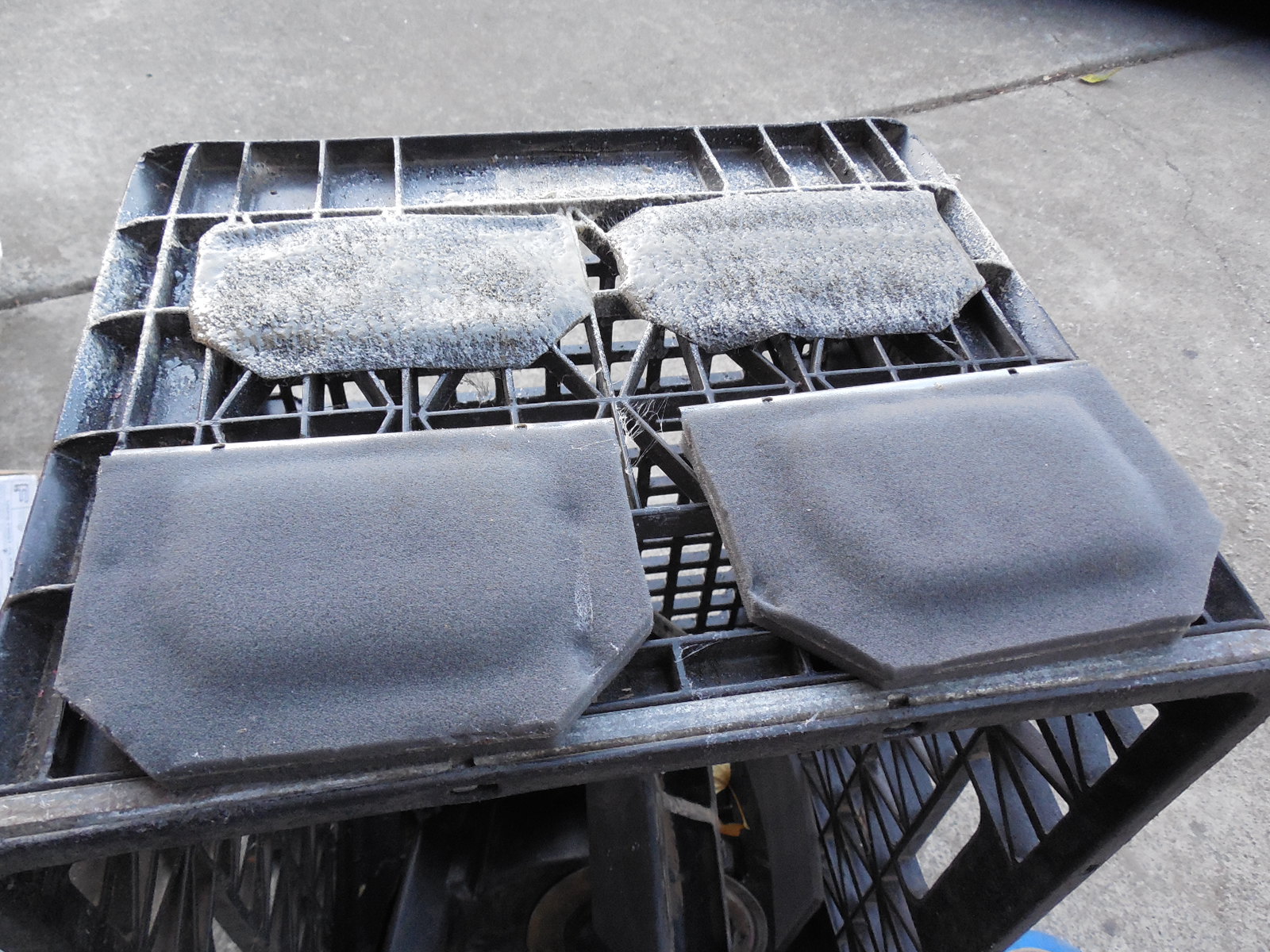

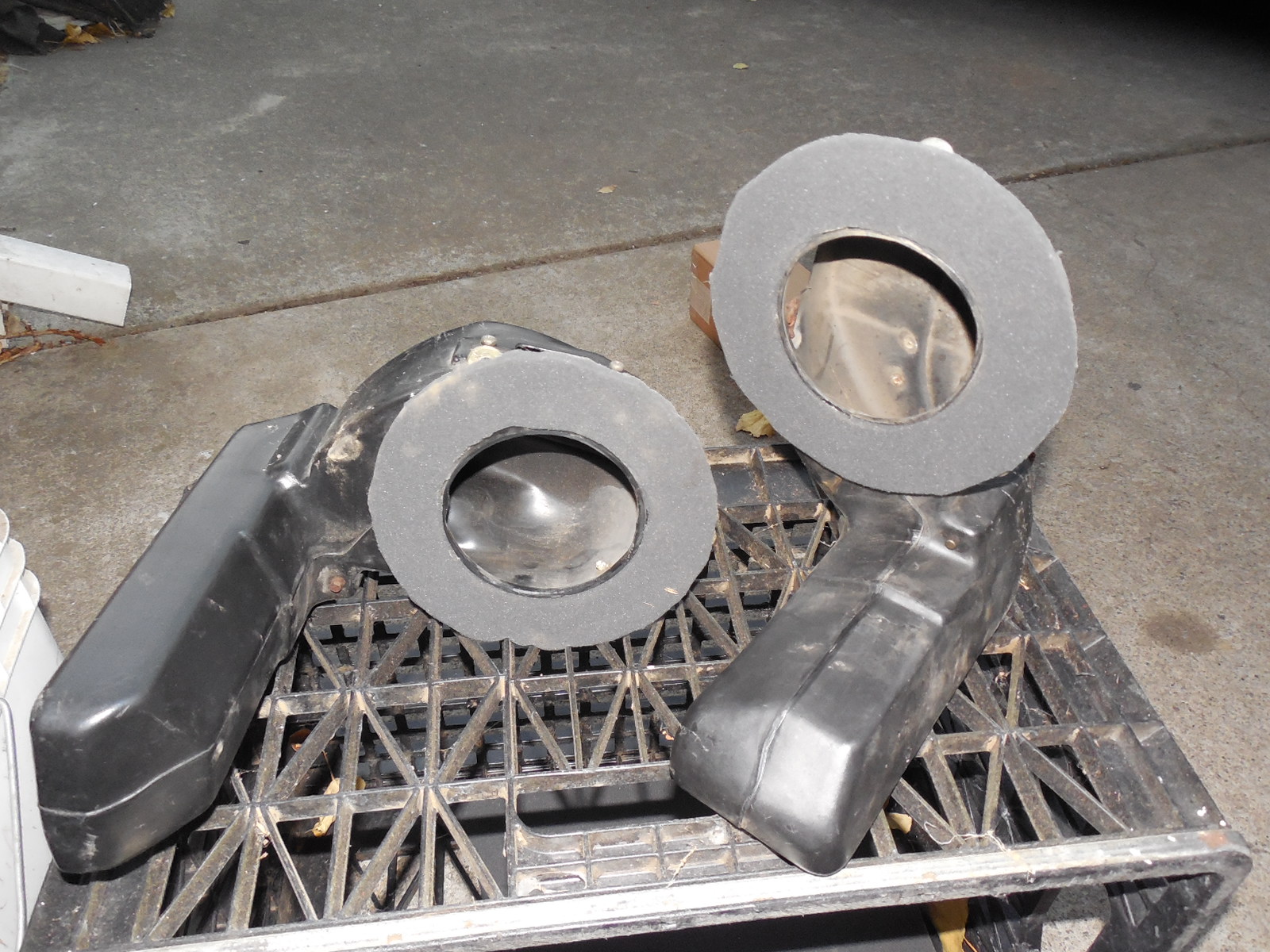

so 3rd time was the charm with the heater core took it ALL apart even them door flaps w/ deteriorated foam
PostPosted: Sun Oct 29, 2017 12:36 am
Posts: 607
got some foam and spray glued it to the door flaps and after all it was back together i have heat once again after 9 yrs

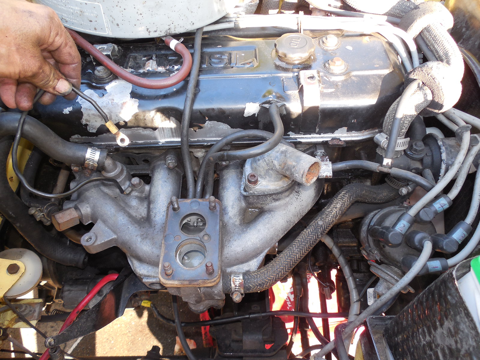

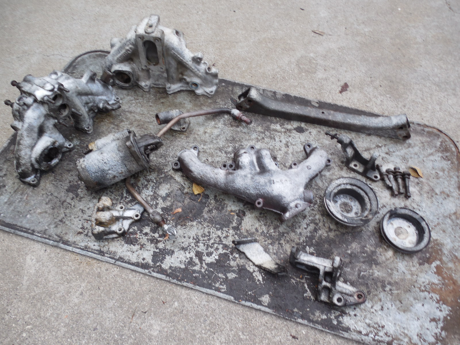

Posts: 607

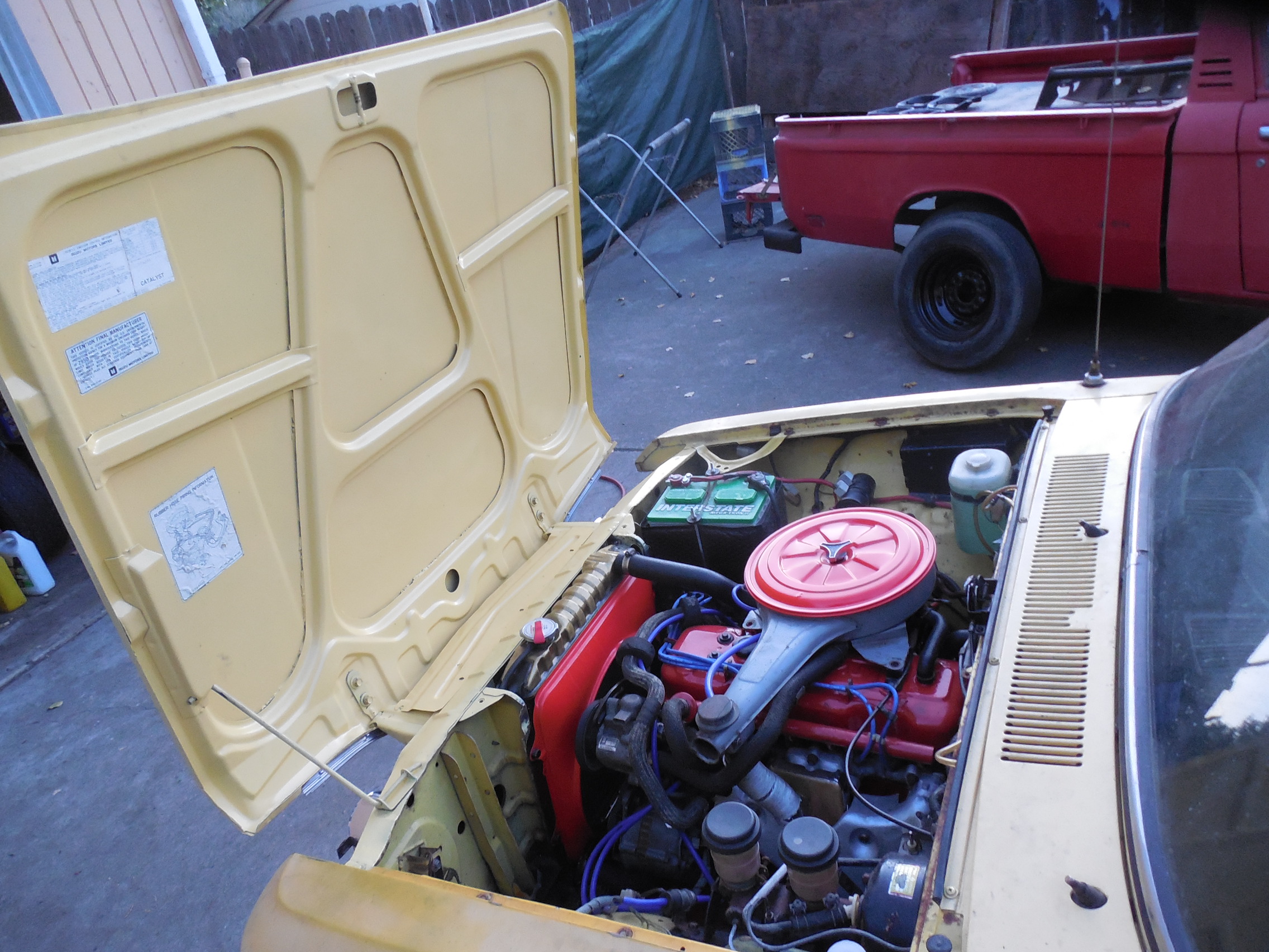

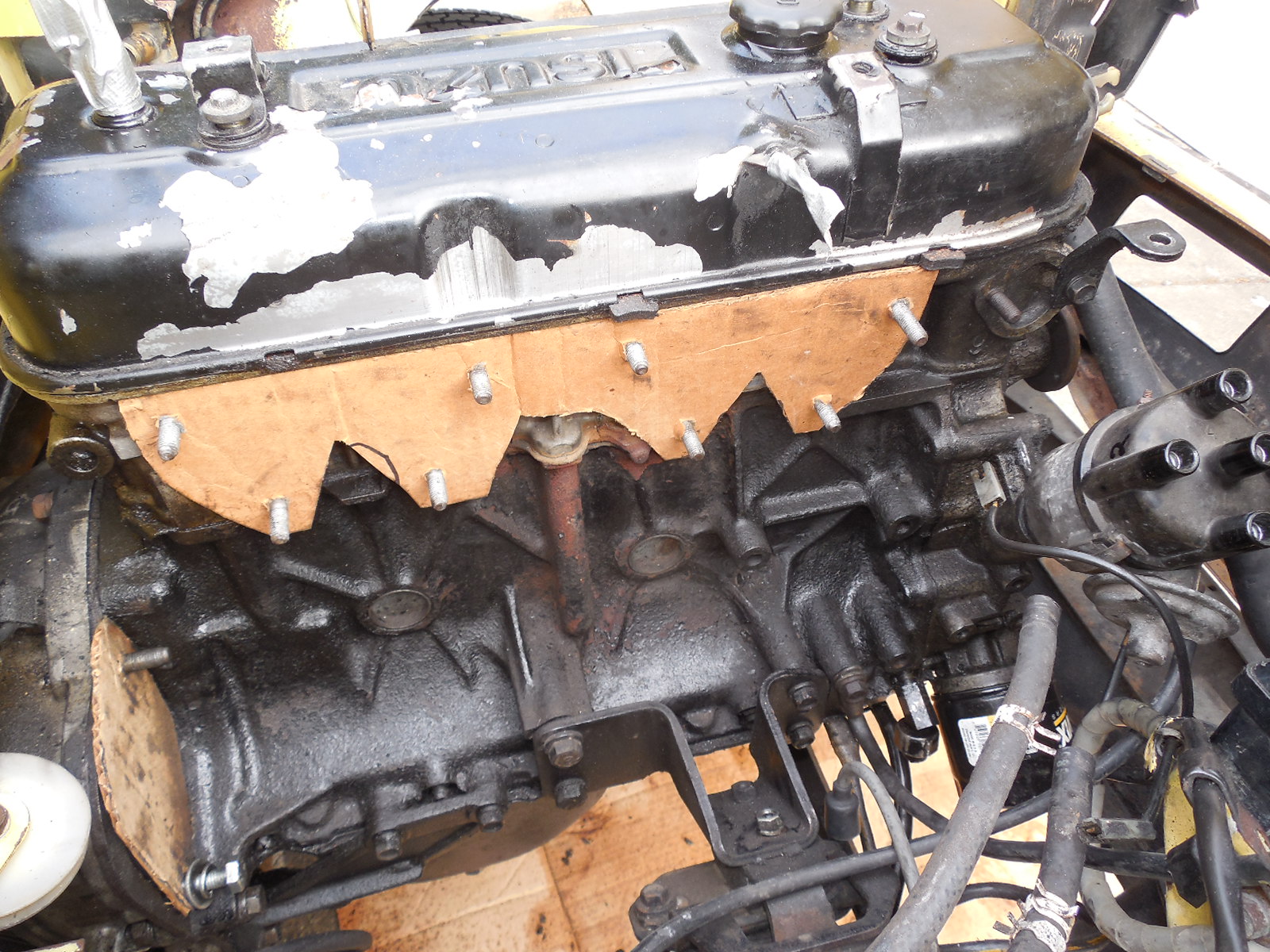

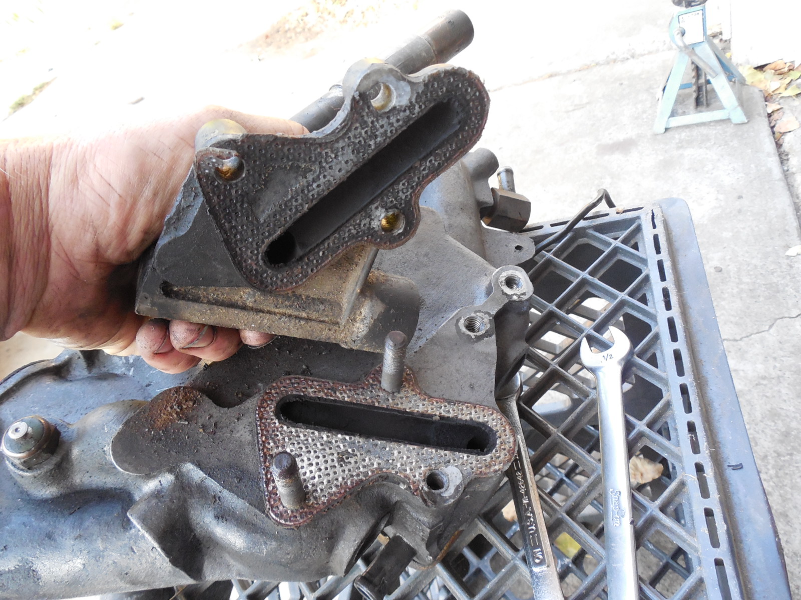

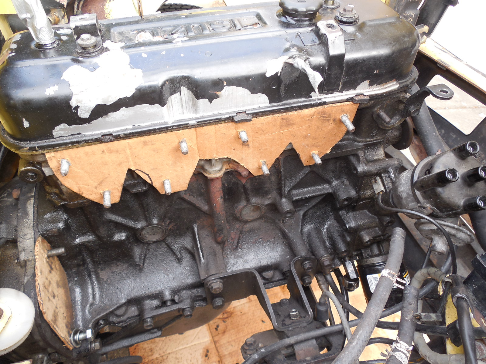

Well last month SMOG was due so wanted to make sure the egr was clear before doing smog test so pulled the carb intake and egr off figured i'd put some new gasgets and clear her up again..the egr was clear but running w/ a split muffler for a while i figured i needed to confirm this before the test
File comment: these EGR gaskets are NOT being made any more (Unless you but a whole engine gaskets set) so had to buy some material and make one.

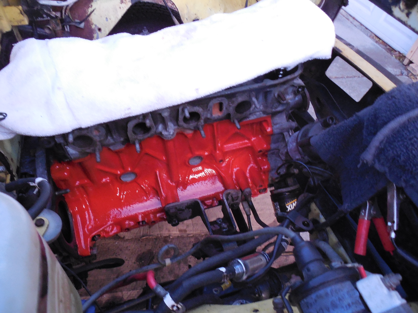

PostPosted: Sun Oct 29, 2017 12:54 am
Posts: 607

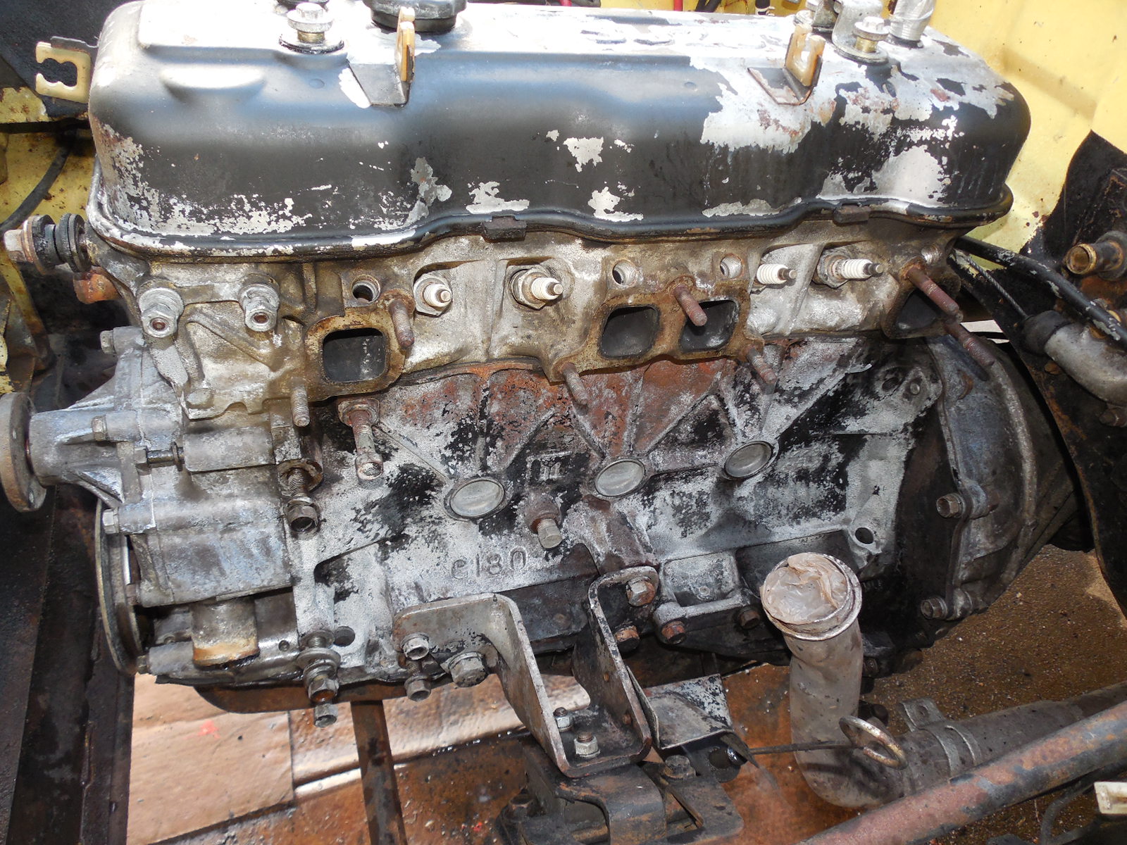

oh what the hell went ahead & clean up the whole block. i ordered all kinds of gaskets figured i haven't cleaned it up & after 20k it was due so oil pan, valve cover, intake, exhaust, thermostat & egr gaskets

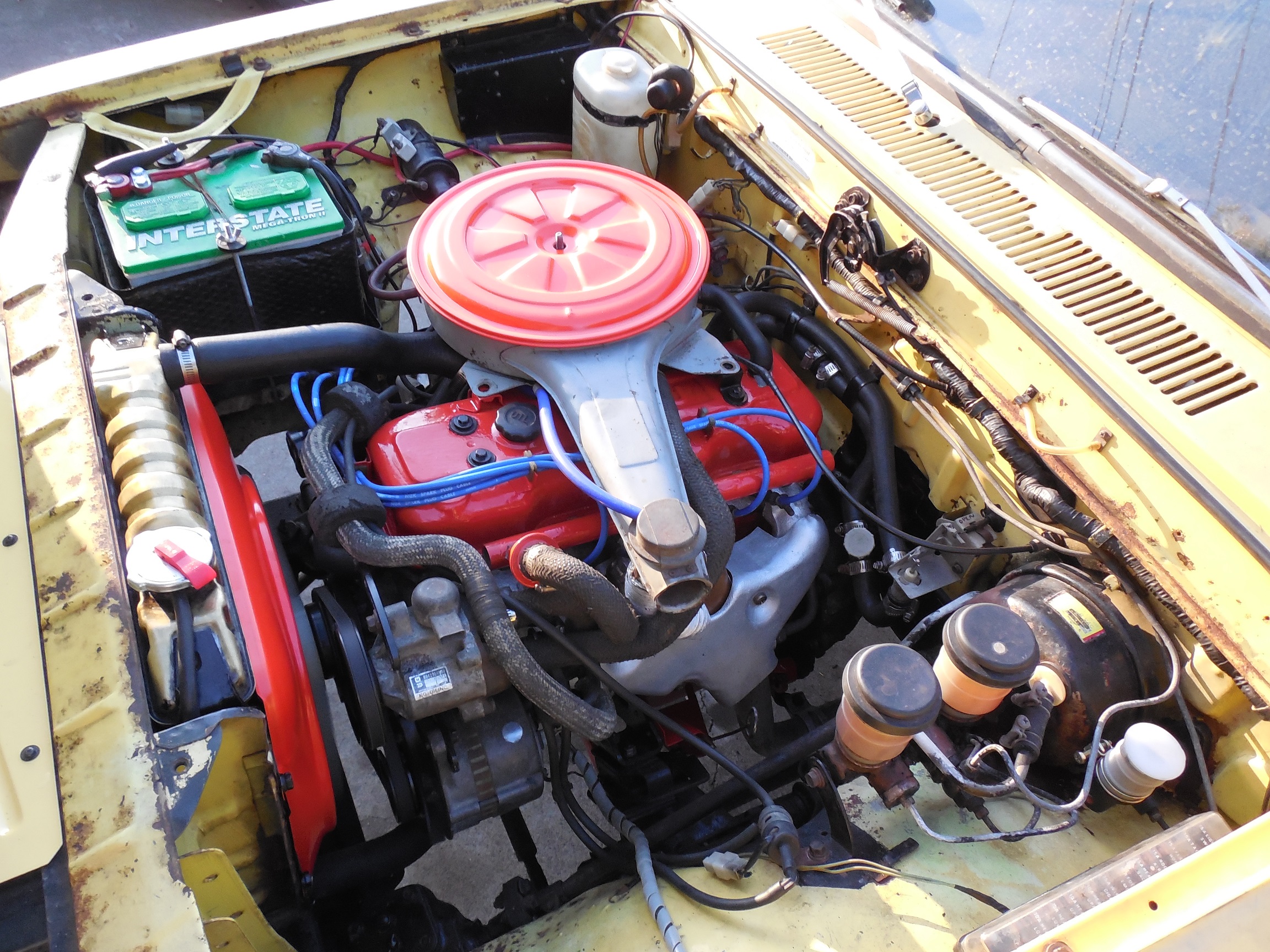

PostPosted: Sun Oct 29, 2017 1:01 am
Posts: 607

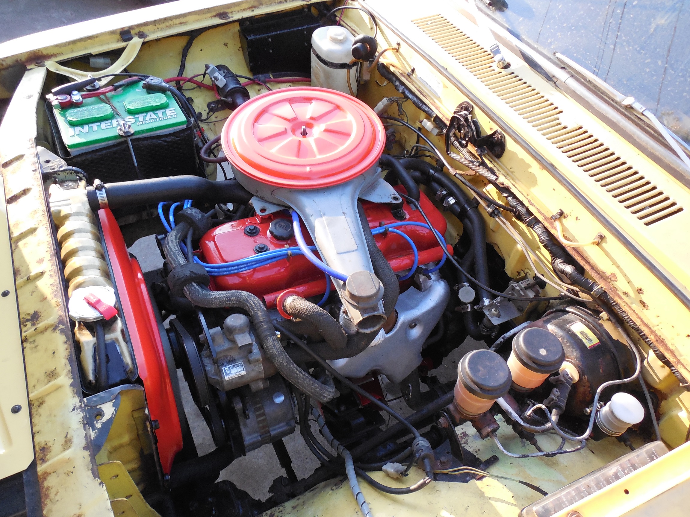

so clean the block swapped some gaskets, rebuild a Carb ....Ms SunShine is looking nice again

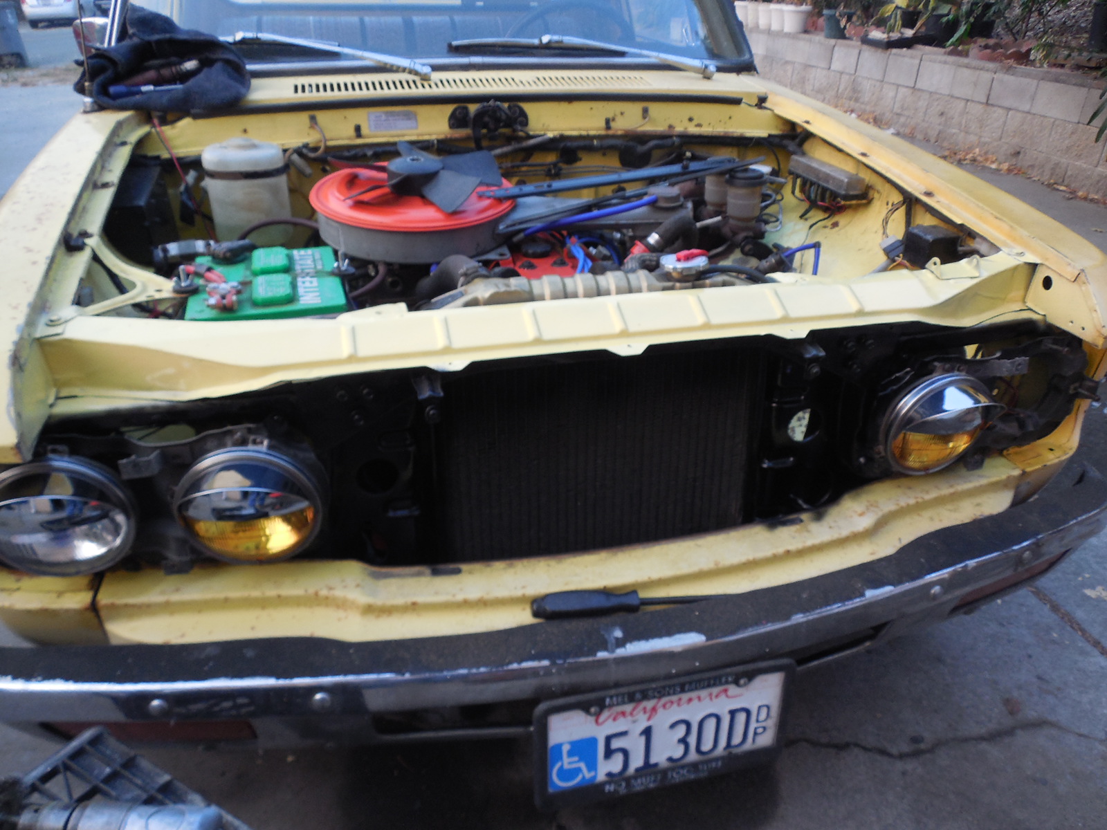

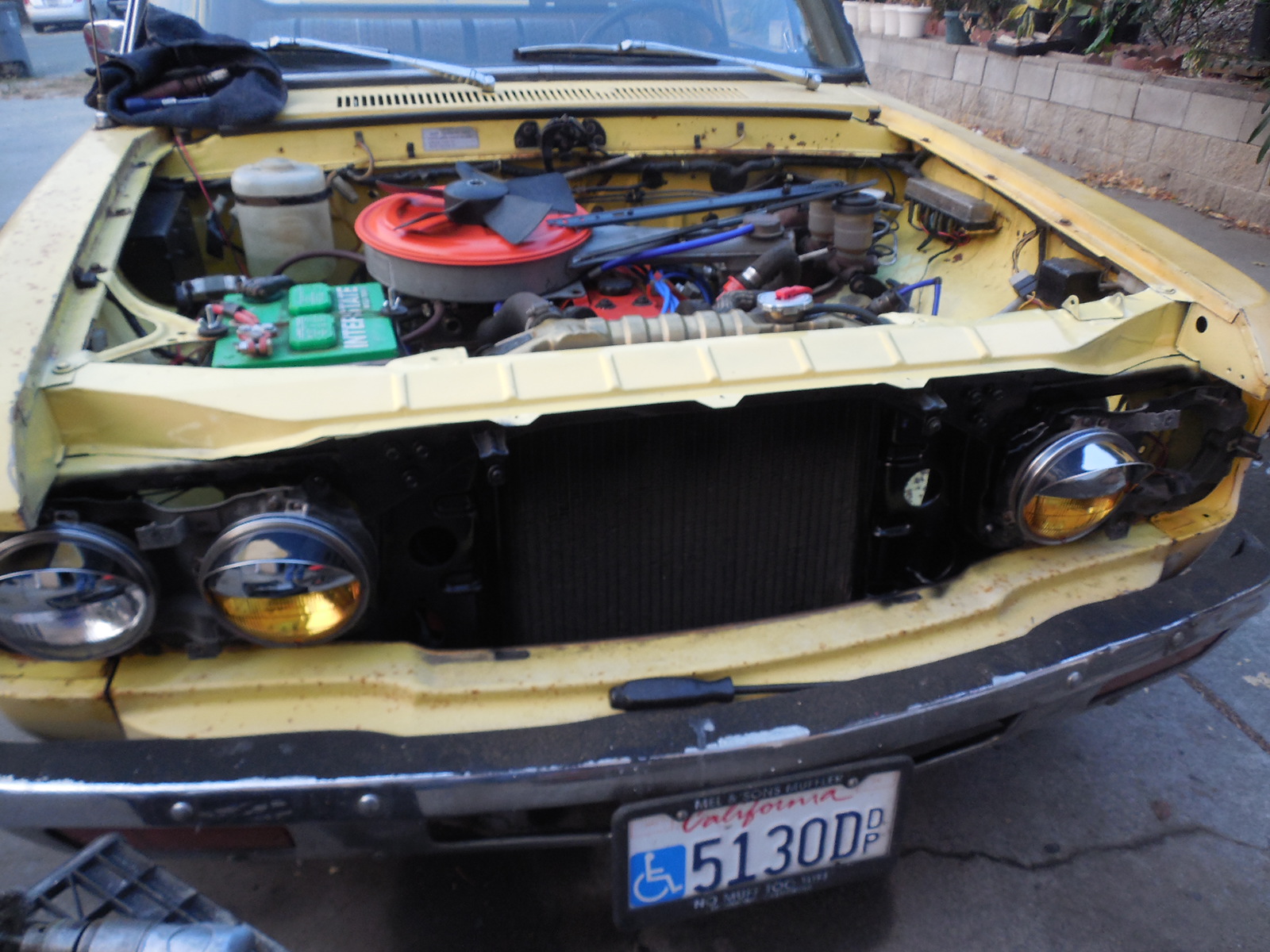

PostPosted: Sun Oct 29, 2017 1:09 am
Posts: 607
Its been a busy few months giving this LUV some LUV.

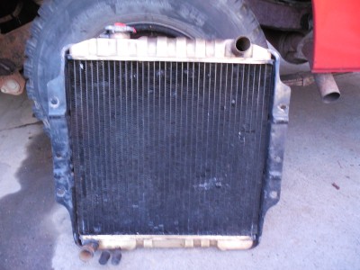

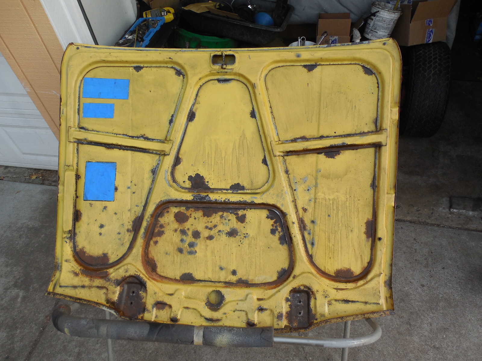

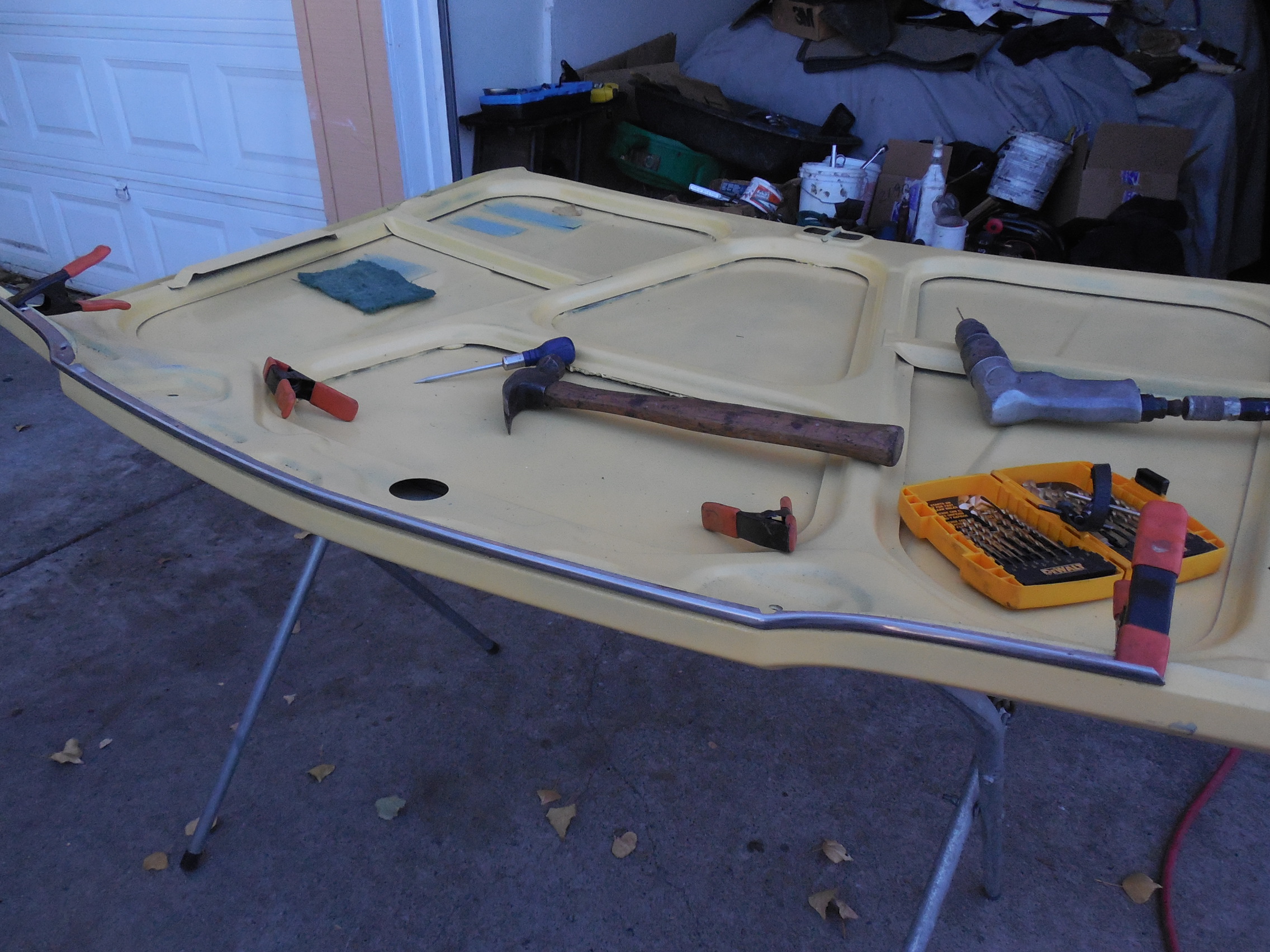

Next up radiator fan and some new head lights and take care of some more rust spots o the under side of the hood
PostPosted: Sun Oct 29, 2017 1:14 am
Posts: 607
oh got the hood trim on since i had it off and was cleaning it all up

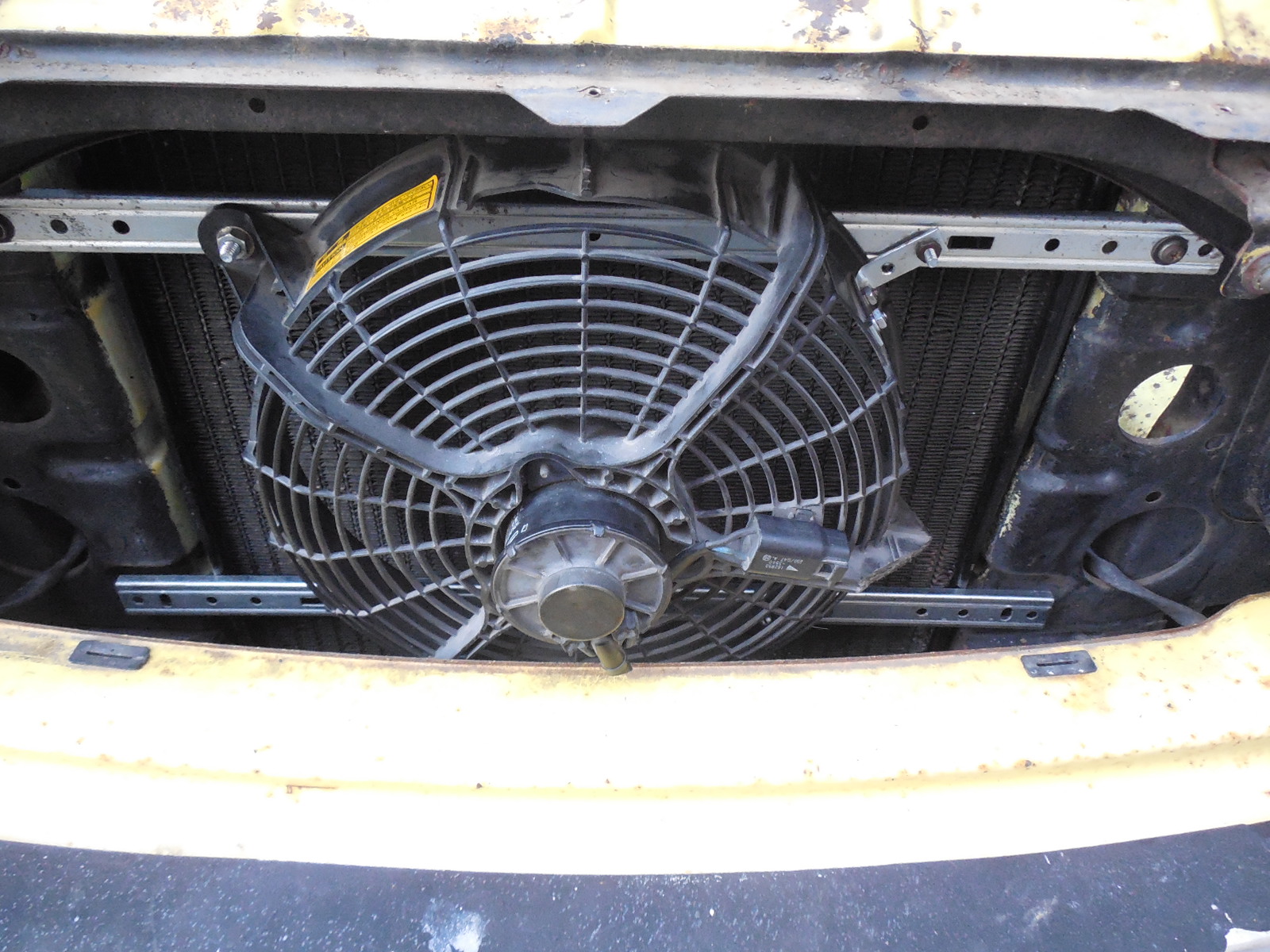

File comment: hood back on radiator support got cleaned up too
File comment: all new lights and well you can't even see the fan in there now
